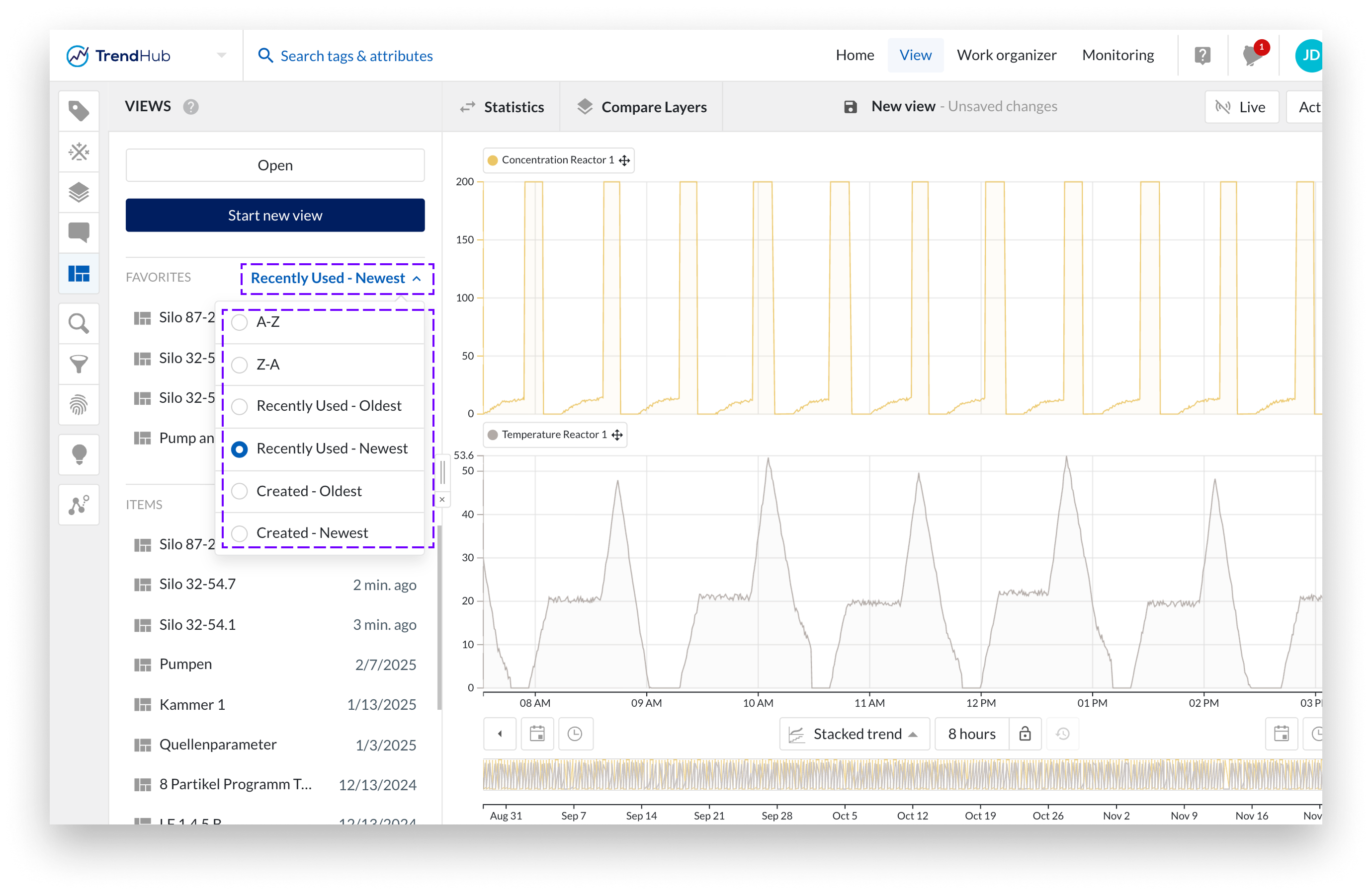

The Quick Start panel allows you to easily access your favorite, recently used, or other work items from anywhere in TrendMiner without navigating to the Work Organizer. If it is not currently visible, you can open it by clicking the icon in the left-hand menu.
The panel first displays a list of your favorite items if you have marked any. Below the favorites you will find a list of other work items. This list supports infinite scrolling and can be sorted by recently used both in ascending and descending order.
If the item you need is not listed in the quick start panel, you can click the Open button. This opens the Work Organizer panel on the right side, allowing you to quickly browse or search within the familiar tabs: My Work, Favorites, or Shared with Me.
Finally, you can also open a new item using the Start New action button.

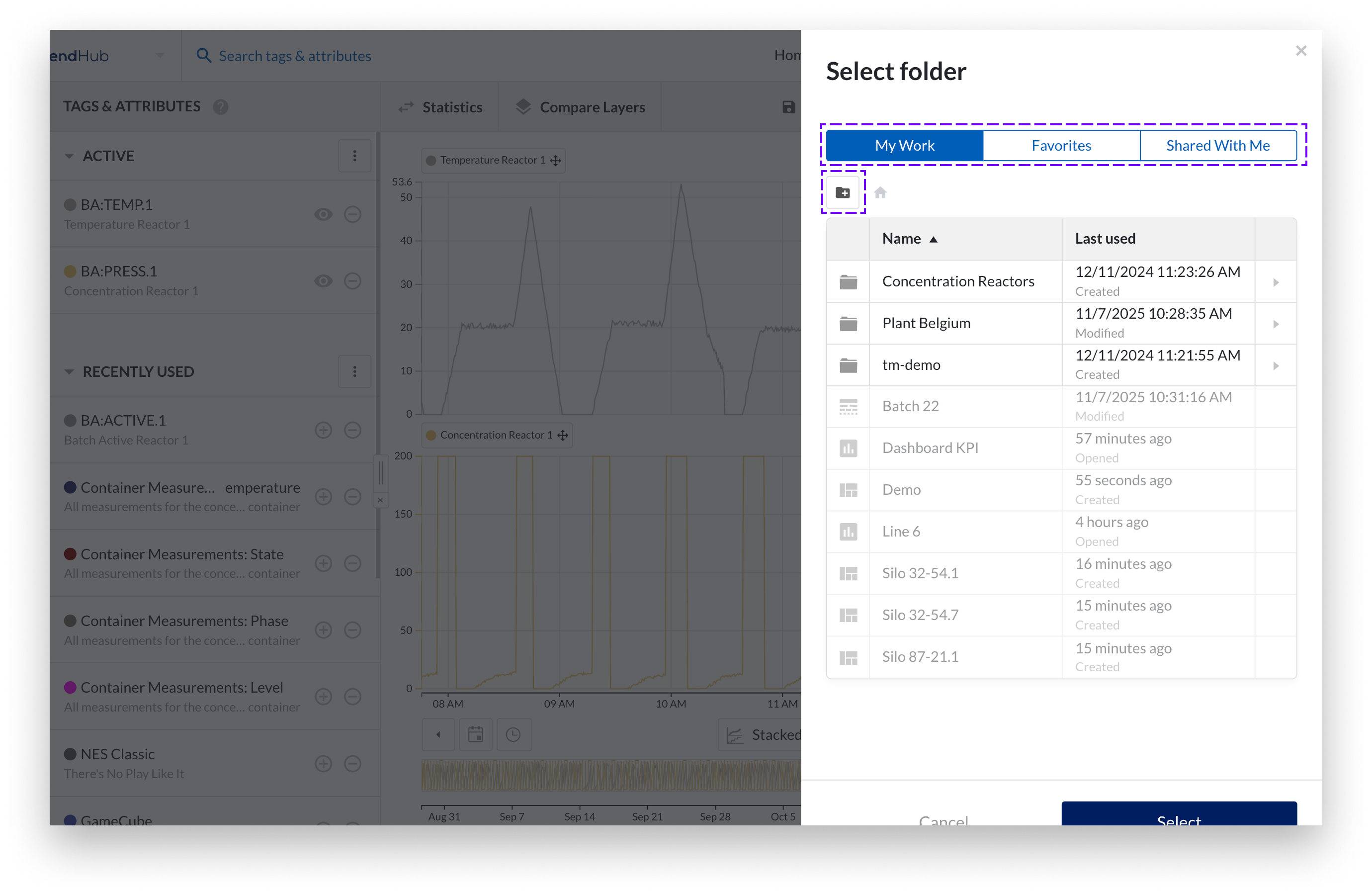

Save or Make a copy
The panel is also used across TrendMiner during Save or Make a copy actions. In this context, you can only store items in folders where you have the appropriate permissions, such as your home folder under My Work. By default, the system points to the root of your home folder when saving or copying an item.
Permissions may come from your own user account or from membership in a user group. In both cases, the highest permission level is applied.
