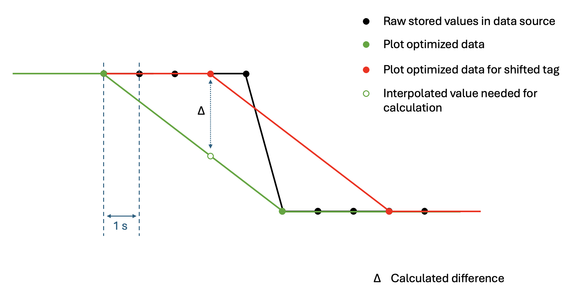

Consider the earlier calculation example: abs(TagA - TagA shifted by 3 seconds) . You might have created this tag to capture a sharp decrease within a second. By shifting this tag by 3 seconds, you expect a new time series tag - usually with a value around 0, that spikes to the difference value for a few seconds.
The following image shows how the difference is calculated when the visualized window is under 5 hours and the data source returns 300 plot-optimized points, which omit some raw data points. The figure shows the raw data points of Tag A, as stored in the data source as well as the plot-optimized data that gets returned for Tag A and its shifted counterpart.
Each time you update the visualized window (for example, using the navigation arrows), different plot-optimized points may be returned, causing different interpolation values and calculated results. Only when you zoom in deeply (in this example, visualizing a 5-minute period) will the data source return raw data points, making the calculated value exactly match the drop.
