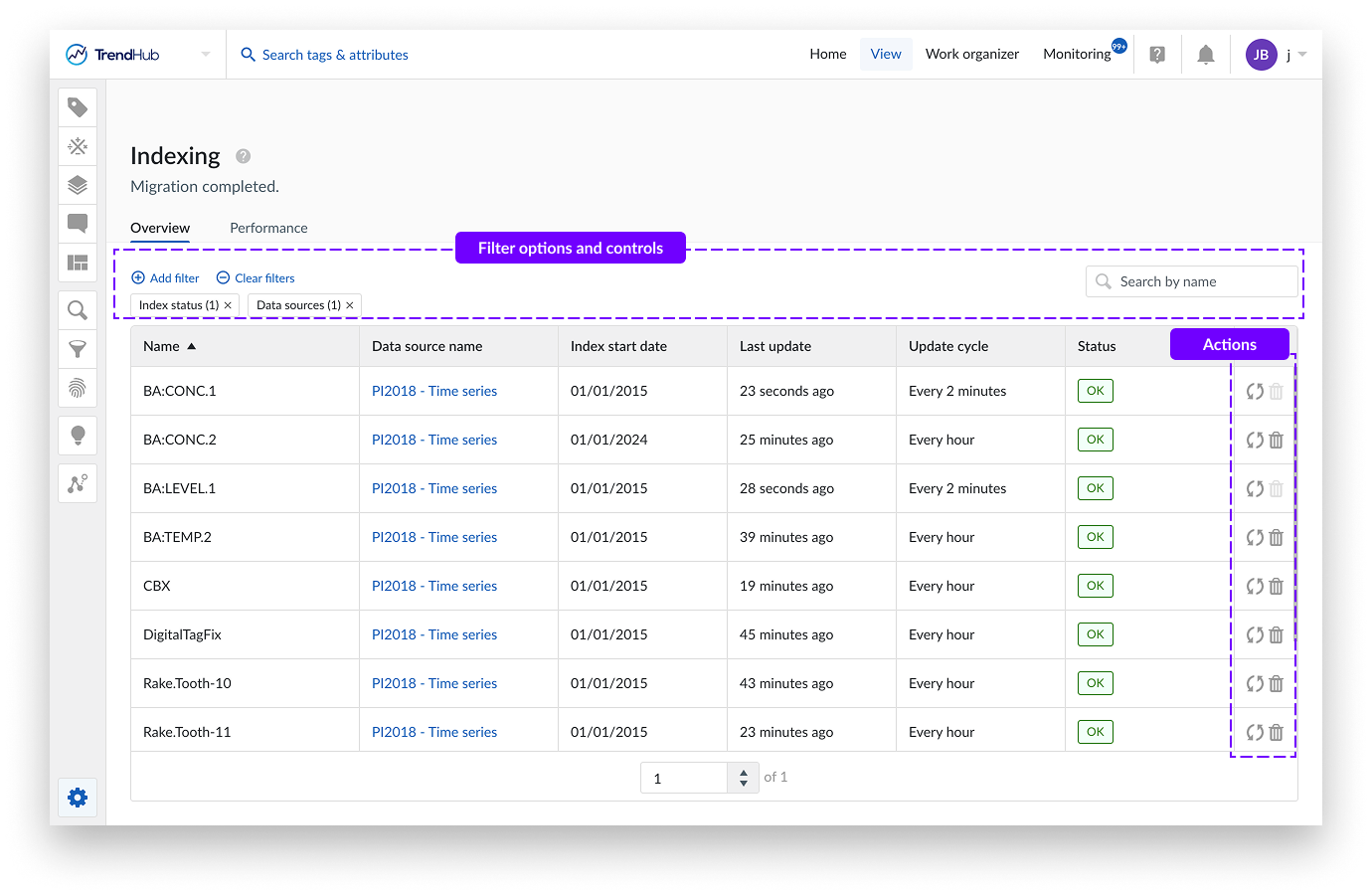

The Index Manager is divided into two main tabs, each serving a specific purpose:
The Index Overview tab offers a comprehensive summary of all tags indexed within the TrendMiner system. For each tag, the following details are provided:
  • Datasource name: This column indicates the name of the datasource linked to each tag, assisting administrators in pinpointing the data's origin. Tags created within TrendMiner are marked with an Internal label.
  • Index start date: The point in time up until we have indexed tag data. For tags that have been successfully indexed, this date should align with the configured horizon.
  • End of data: Date of the last known index point in the TrendMiner index storage. This date is updated when new data points are added to the index.
  • Last update: The latest attempt by TrendMiner to update the index, whether successful or not.
  • Update cycle: This column outlines the update frequency for each tag, indicating how often the datasource is checked for new data.
    • The default update cycle is 1 hour. Tags which are used in monitors (directly or indirectly through Tag Builder tags) show an update cycle of 2 minutes.
  • Status: An indication of the overall health of the tag (refer to the table below).
For a healthy system, the Last update period should be within or close to the specified update cycle. The Last update value shows when TrendMiner last attempted to update the index. The End of Data value, however, updates only if a new data point was received during this attempt.
For each tag, the following actions can be performed:
  • Refresh index: This action deletes and recalculates the index and the index policy of the current tag. It will also automatically delete the index of any Tag Builder tags constructed on top of the refreshed tag.
    A refresh of an index can be useful in case data has been modified/corrected in the datasource itself after the initial storage. Such updates are not automatically picked up by TrendMiner.
  • Delete index: This action deletes the index of the current tag and automatically deletes the index of any Tag Builder tags constructed on top of the deleted tag. Since tags which are used in monitors are required to have an index, they can not be deleted.
    Deleting an index can be useful to free up storage or to clean up Stale tags.

Filtering options
Administrators can filter the view based on the different columns to quickly locate specific tags or identify issues.
  • Index status
  • Delayed status
    • A tag is considered delayed when its latest update attempt exceeds four times the set update cycle duration. Stale and Dormant tags are ignored when filtering on Delayed tags.
  • Max update cycle time
  • Data source name
