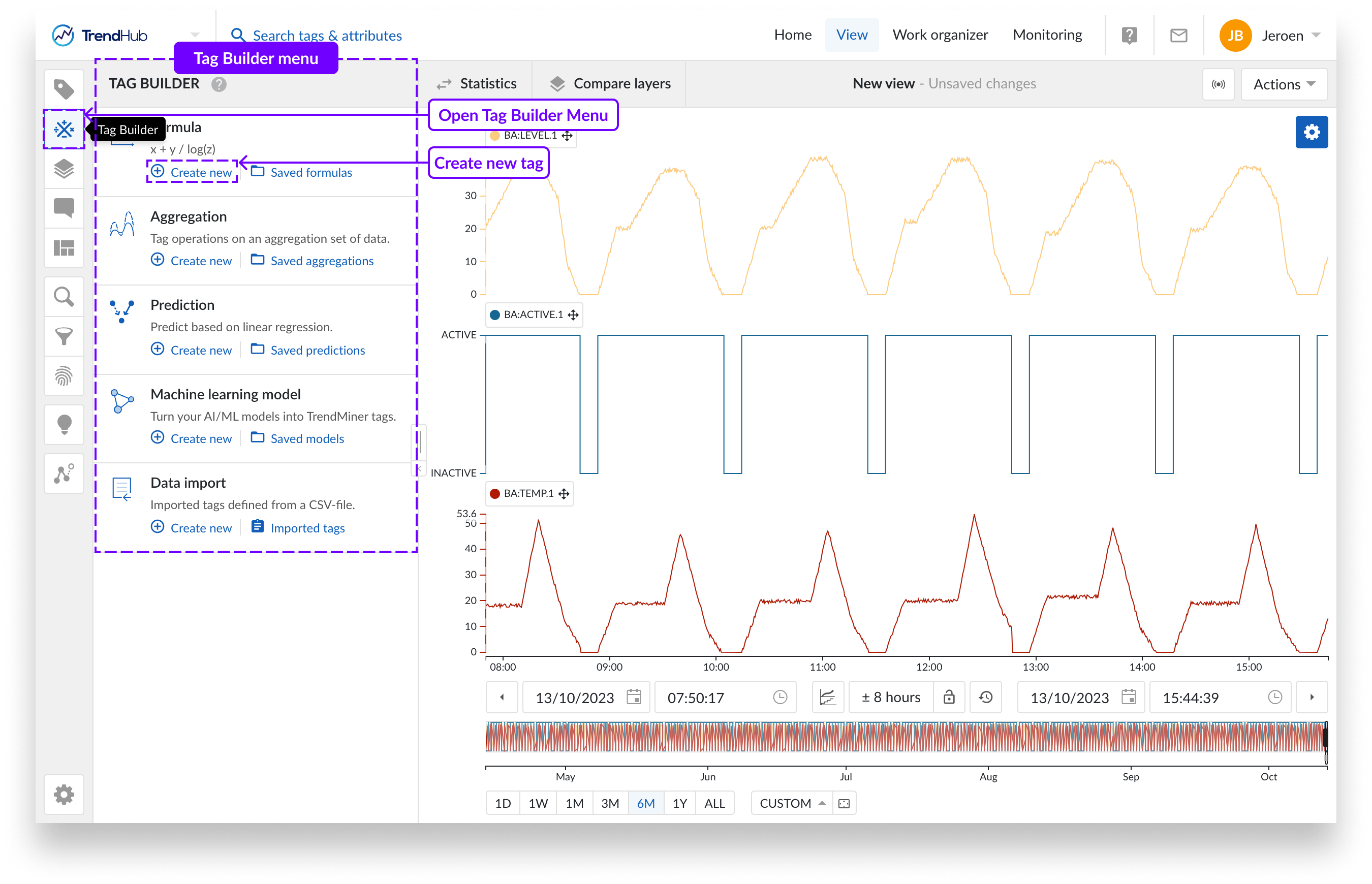

Opening the Tag Builder Menu will show you all available options as listed in the previous section. From here you can choose with which tag type to proceed with for further actions.
  1. Open the Tag Builder Menu.

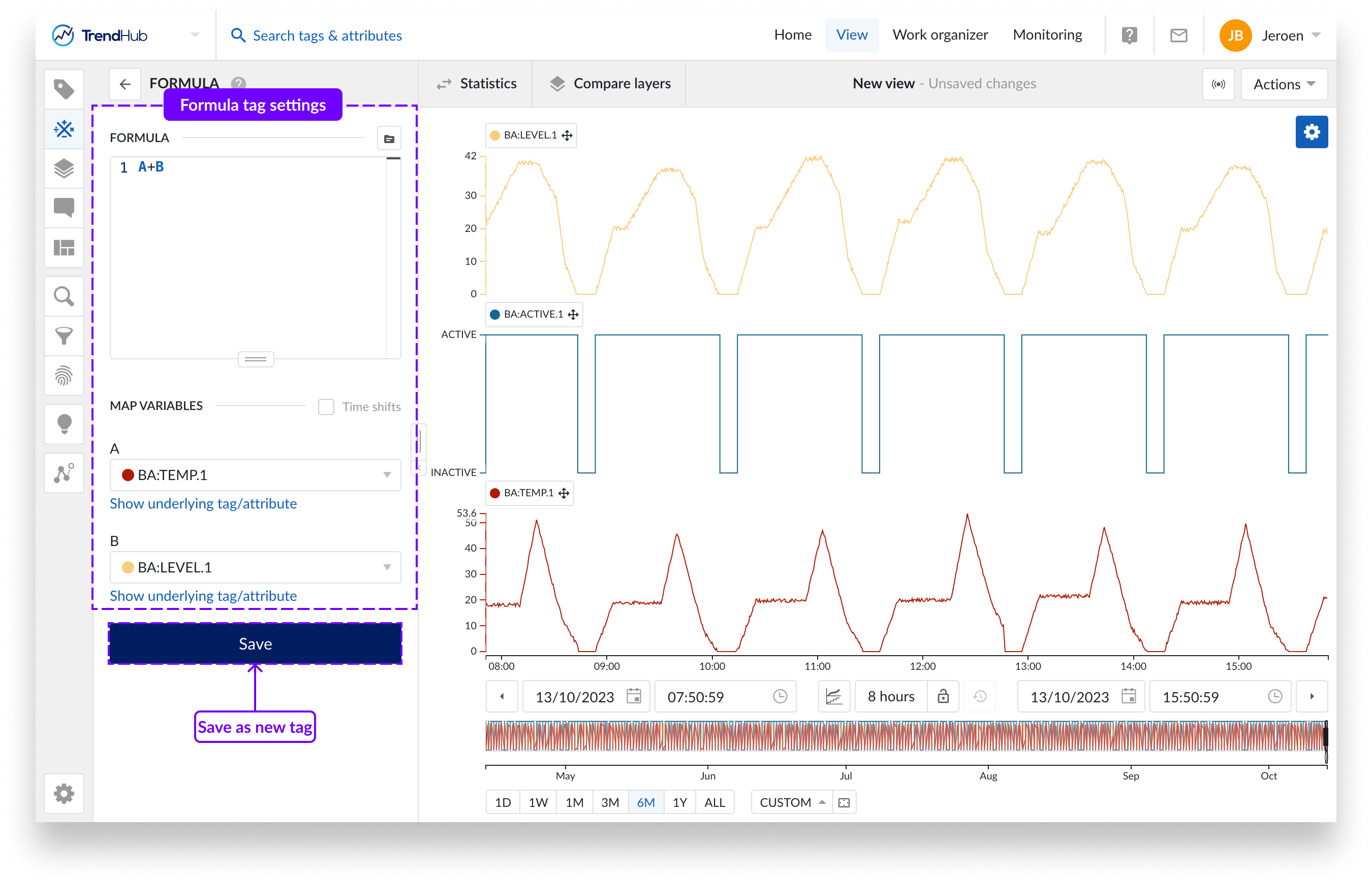

  2. Click on the "+ Create new"-button for your tag builder type of choice. A new submenu will be shown based on the selected tag type.
  3. Fill out the required fields. More information about the specific fields can be found on the respective page of each tag type as linked in the previous section.

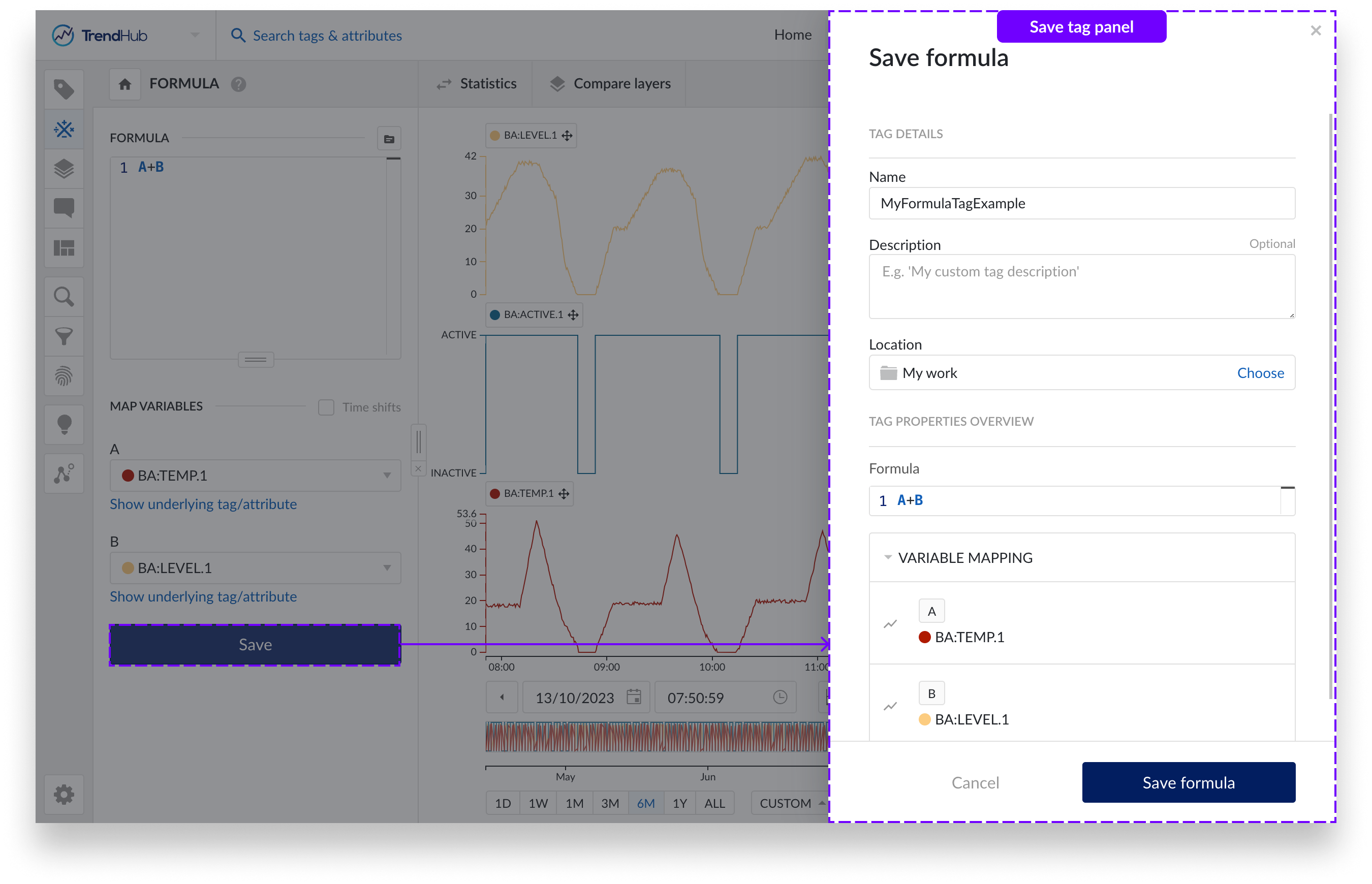

  4. Click the "save"-button. A new side-panel appears on the right side of your screen.
    • In the "tag details"-section you need to fill out:
      • Name: The name of the tag you want to create. The tag you created will be searchable with this name.
        Rules of limitations are applied so consider your tag name before committing the save, see below.
      • Description (optional): The description of your tag.
      • Location: The folder of your Work Organizer where you want to save the tag.
    • The "tag properties overview" - sections shows a summary of how the calculated tag is set up.
  5. Click on the "save Formula/Aggregation/..."-button in the side-panel. The created tags will be added to your screen automatically and a summary (tag definitions) will be shown in the tag builder menu.

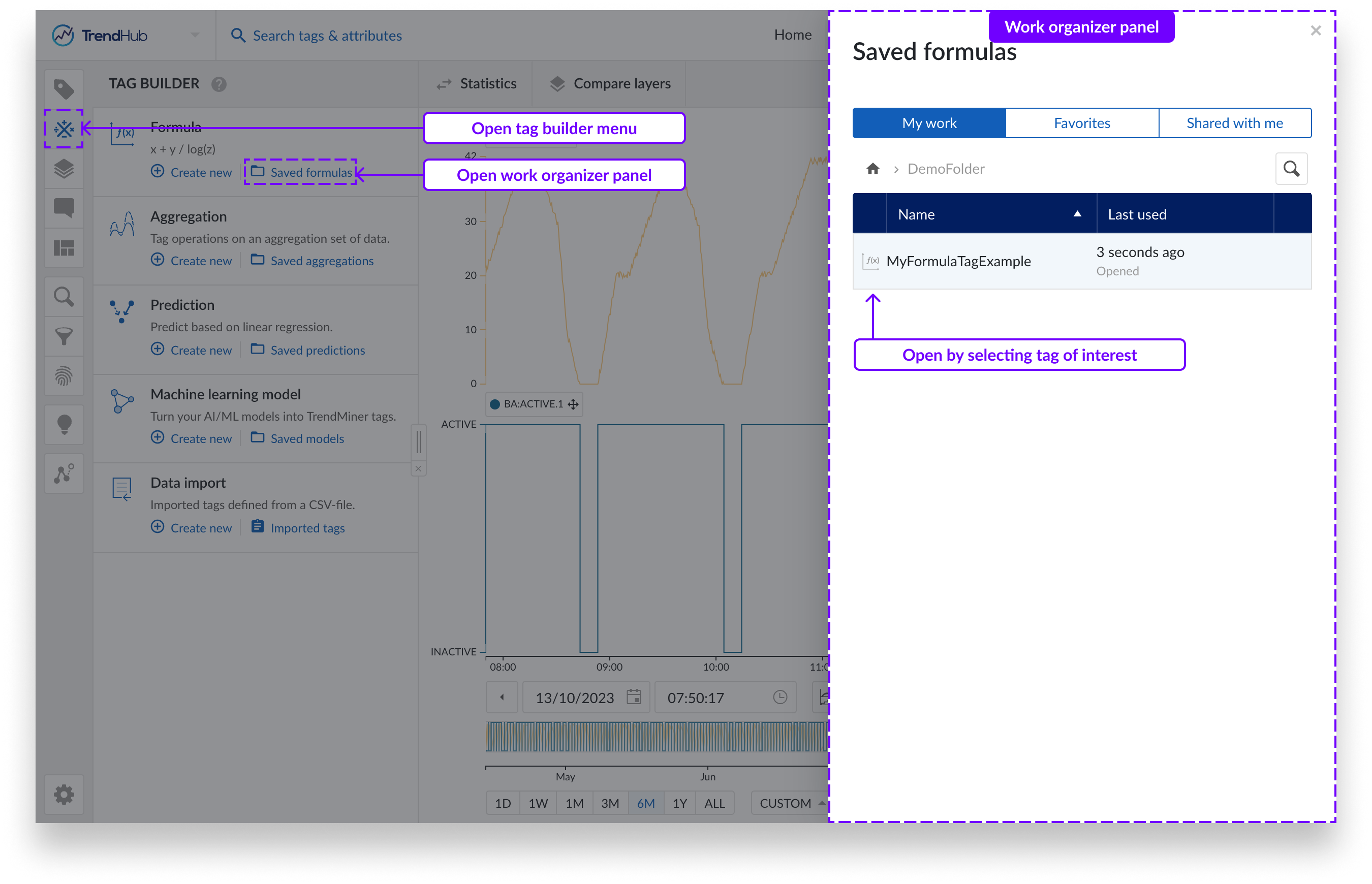

  2. Click on the "Saved Formula/Aggregation/..."-button.
  3. Select your desired tag from the side-panel, showing the work organizer, that appears on the right side of your screen.

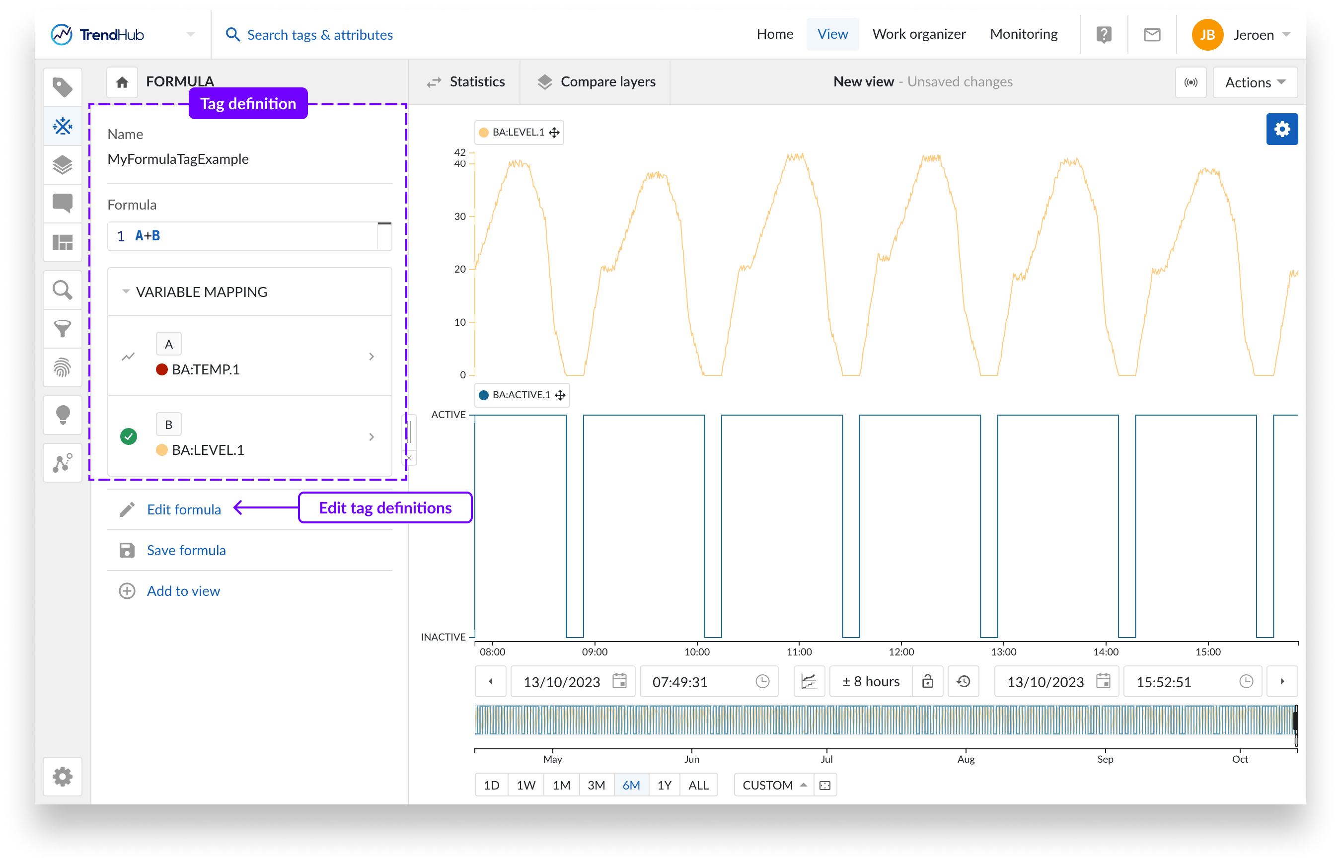

  4. A summary of the tag details (= tag definitions) will be shown in the menu on the left including options to:
    • Edit your tag.
    • Save your tag. This will allow you to create a copy or rename your tag.
    • Add/Remove your tag from the current view.
Alternatively, you can open the Work Organizer and select any of your saved tags instead. This option can also be used by other users when the tag definition is shared with another user.

If you are the owner of a tag, you can edit the tag as follows:
  1. Follow the steps from the "Showing tag details" section.
  2. Choose the "Edit tag" option.
  3. Make the desired changes.
