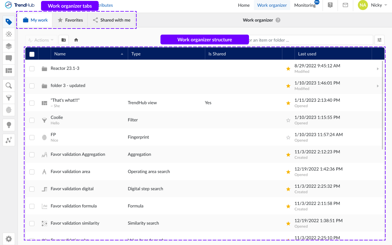

There are two tabs in the work organizer; 'My work' and 'Shared with me'.
The overall layout of both tabs is very similar.
My work: shows a tabular overview of all the folders, views and a variety of work items of which you are the owner, including the last updated date.
Shared with me: contains only the work items shared with you by other users. It also indicates the owner of the items, and the date items were last updated.

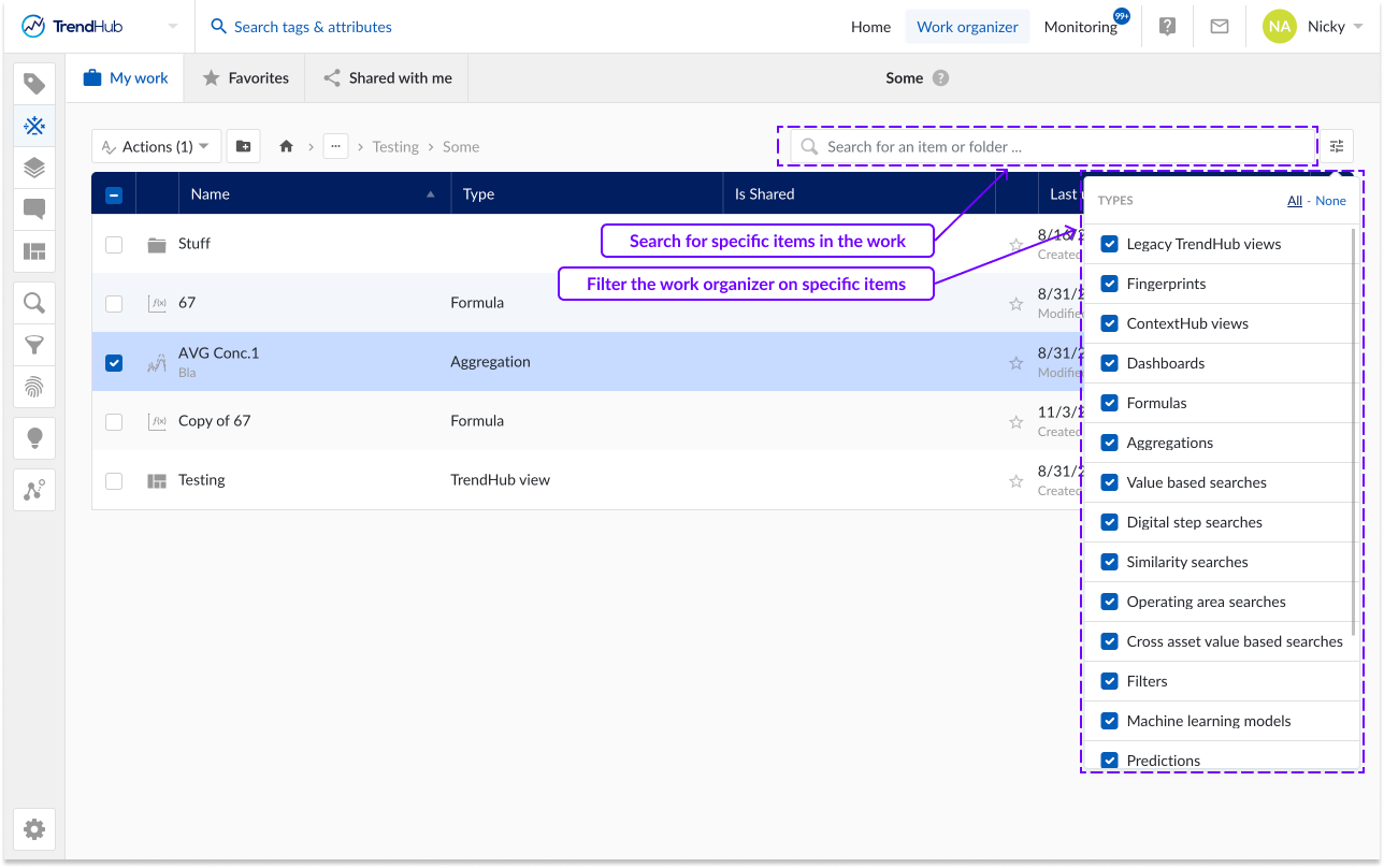

At the top right, you can easily search for specific items, or you can filter the visualized work items by type, by clicking the icon with three horizontal lines.

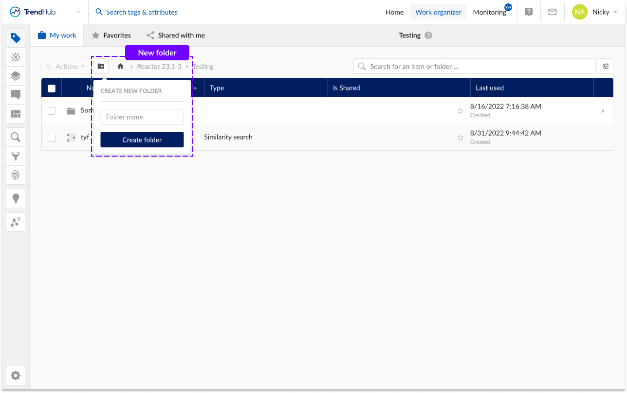

Select "Work Organizer" located left of the user profile menu.
Click on the create folder icon.
Enter folder name and click "Create folder" in the drop down.
The folder will be created within the currently opened folder.
When saving a new item, the save panel will always provide an option to specify the location. If not specified, the item will be saved in the root level of the work organizer. When selecting a location, a folder can also be created in the work organizer side panel in a similar fashion.

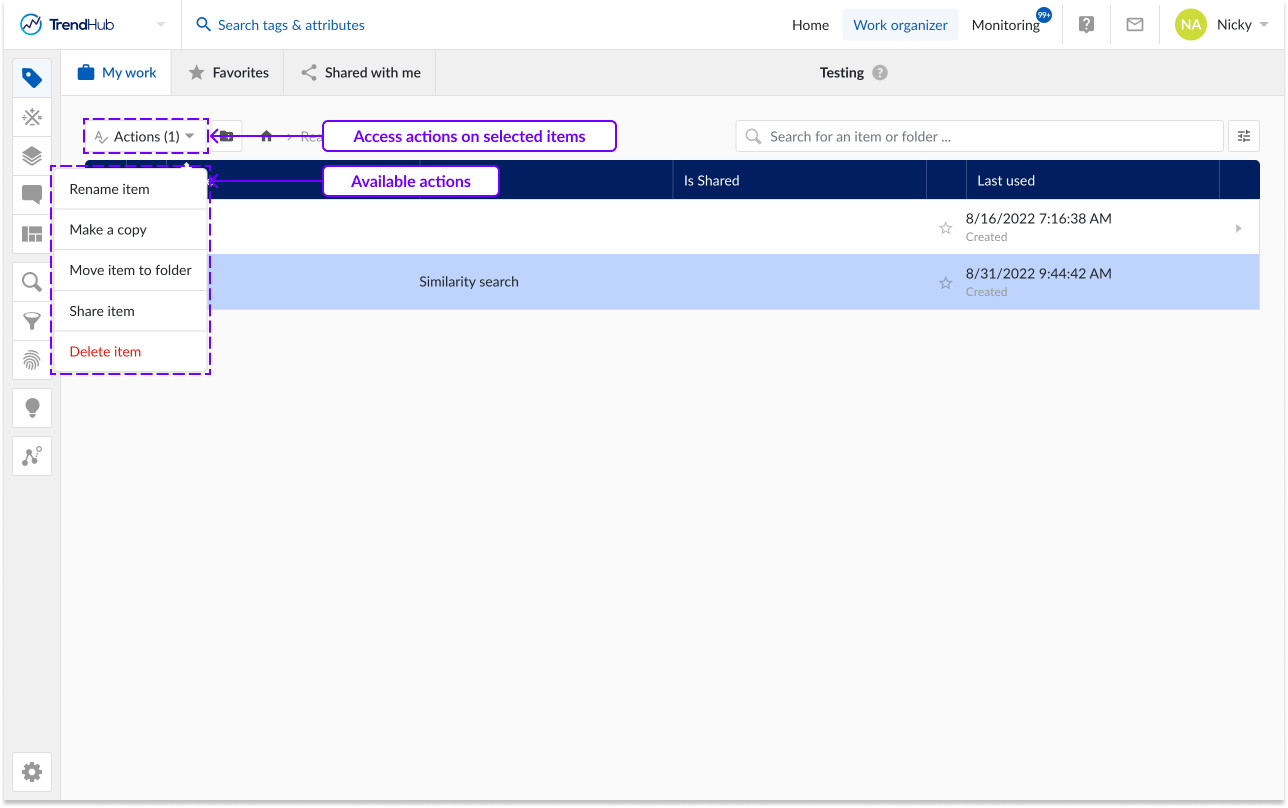

By selecting folders or work items, the "Action" button at the top becomes available.
The following actions are available:
Rename
Make a copy
Move item to folder
Share item
Delete item
When selecting multiple items, renaming and making a copy is not available.
Rename: When you select rename, a right-side panel opens to facilitate the action. Enter name and press 'rename item' button.
Copy: When you make a copy a right-side panel opens where you will be asked to name your new copied item. The copied item will be stored in the same folder as the original item.
Move: Selecting the move option also opens the right-side panel. Here you can navigate through folders to find the optimal location. When located in the correct folder, click 'Move' to execute the transfer.
Share: You can also share your work items (except folders) by selecting the items to share and clicking the Share item option under the actions button. More detail about sharing is provided in sharing work items section below.
Delete: You can delete your work items. A pop-up modal will appear to confirm the deletion of the selected items. When you select a folder for deletion, all items included in the folder (all work items and other folders) are deleted as well.

The search is not limited to the current folder. The search feature will search all folders and other items within the 'My work' space and present all results in one list. You can search both in 'My work' and in 'Shared with me' but not simultaneously.
Wildcards (*) are available to specify more advanced naming patterns. e.g. 'Project*optimization' will match all items for which the name or description starts with 'Project' and end with 'optimization'.
The search will not show filtered item types.

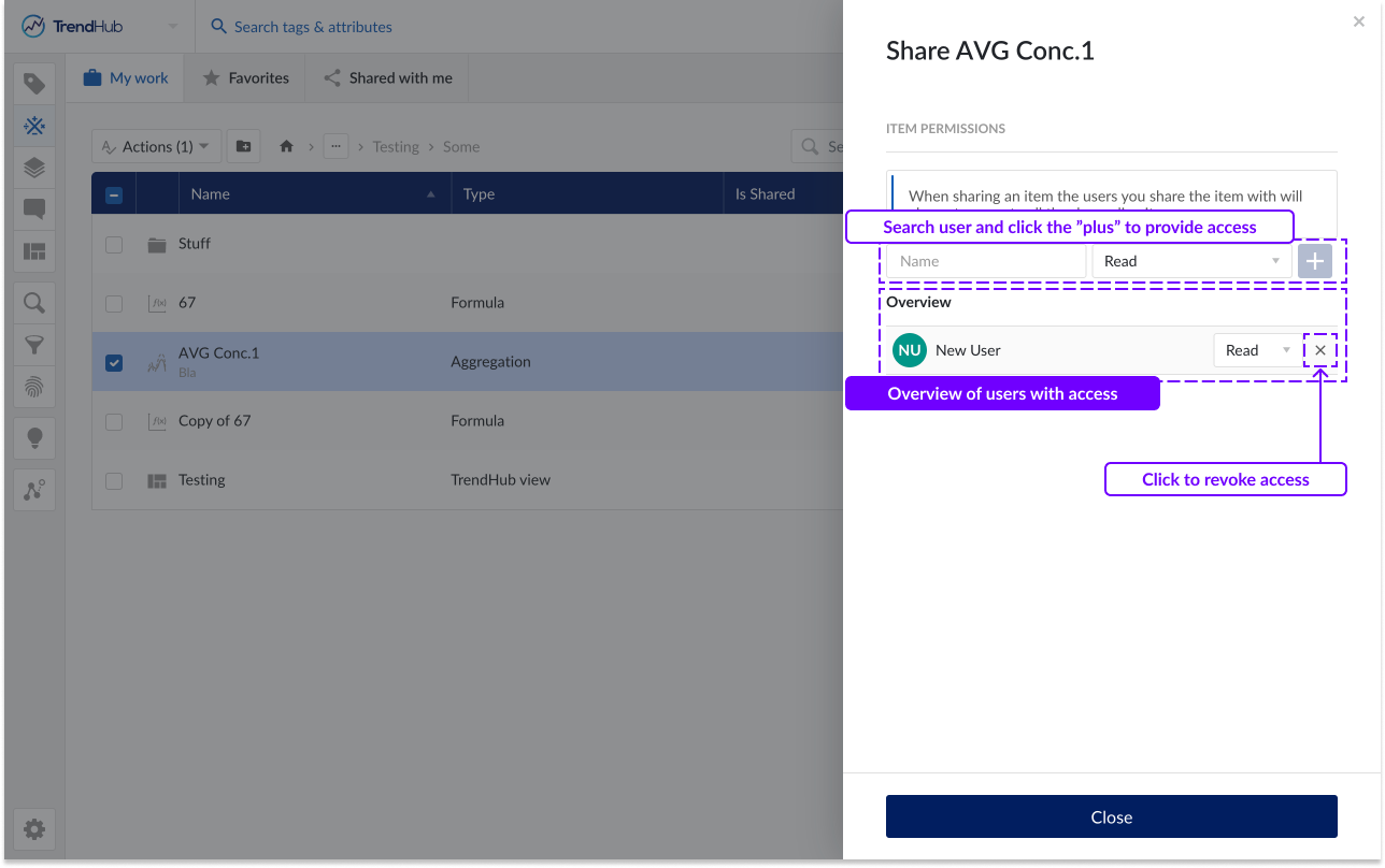

Click on the checkbox of the item row(s) you wish to share. The action button at the top will indicate the number of items that are selected.
Click "Share item(s)" in the drop-down menu. A side panel will appear from the right.
In the side panel enter the name of an individual(s) you wish to share your work with.
You can search on username or full name.
Click the + button and the names will be added to the "Overview" list.
Close the panel.
Your chosen work has been shared with your selected colleagues. The items will be marked as shared in the work organizer overview.
To stop sharing the item(s), select the item you want to update the sharing settings for, then do the following:
Click the checkbox of the item for which you wish to revoke the share rights.
In the dropdown list that appears under the "Actions" bubble, select "Share item". A share panel appears from the right side of the screen.
In the "Overview" list that appears from the right, click on the x button to the right of the user's name to revoke the permission.
Close the panel.

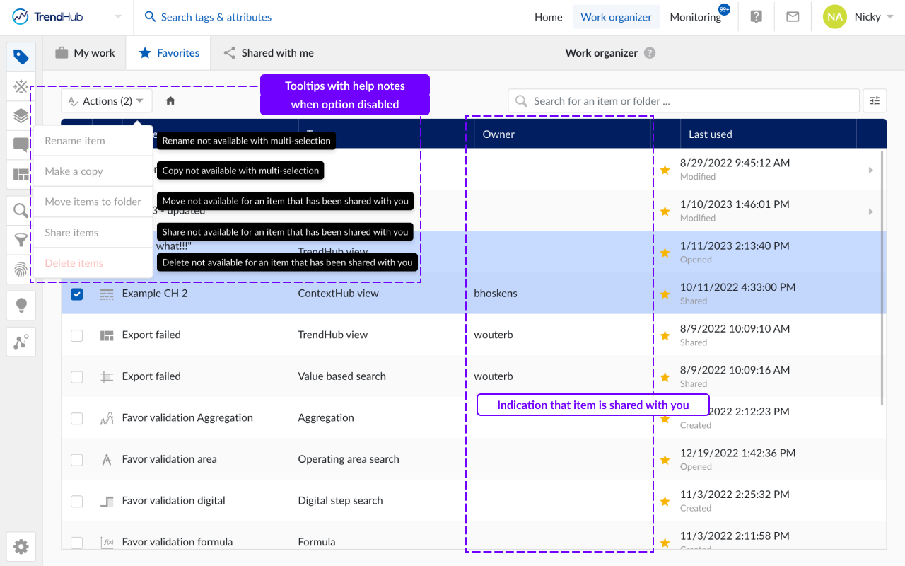

With the help of items you can quickly find the information and documents that are most important for you. To make your work easier, we have added another section to the work organizer called "Favorites". In this area, all your favorite items are grouped together so that you can easily access them.
You can mark an item as a favorite by clicking the star icon on any of the work organizer tabs, including the "Shared with me" folder. To mark or unmark an item as a favorite, simply click the star in the row of the item you want to consider as a favorite.
The Favorites tab lists all the items that you have marked as favorites. From here you can perform actions on these items, such as delete or move (depending on the permission).
If you are the owner of an item, you can perform actions on that item. If someone has created an item and shared it with you (permission to view), you can ask for further permissions to act. You can see the name of the owner in the "Owner" column.
