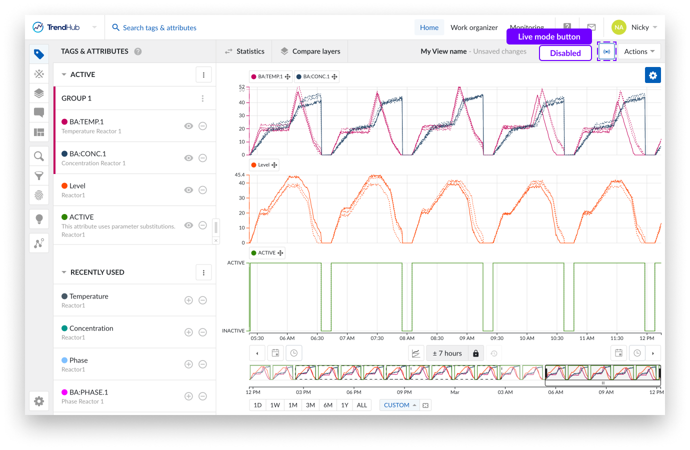

Entering live mode enables you to visualize data as it arrives in real-time. This helps you to follow the process and enables you to visually compare process data to assess process conditions.

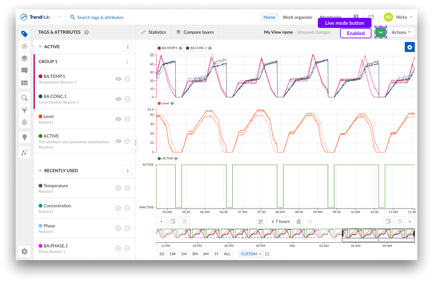

To enter "Live mode", click the live mode button which is situated in the view bar on the right. The button will turn green for On, and the focus window will show the most recent data updating every 10 seconds.
The status of the "Lock" button of the focus chart controls, defines which time period will be visualized.
  • When closed, the focus chart will keep jumping to the most recent data while keeping the selected time span. The timespan will remain fixed while new data comes in.
  • When opened, the focus chart start date and time will remain fixed and newer data is added up until the now moment. When live mode is on, the view will keep on "growing".
    To exit "Live mode", press the green live mode button a second time to return to a historical view.

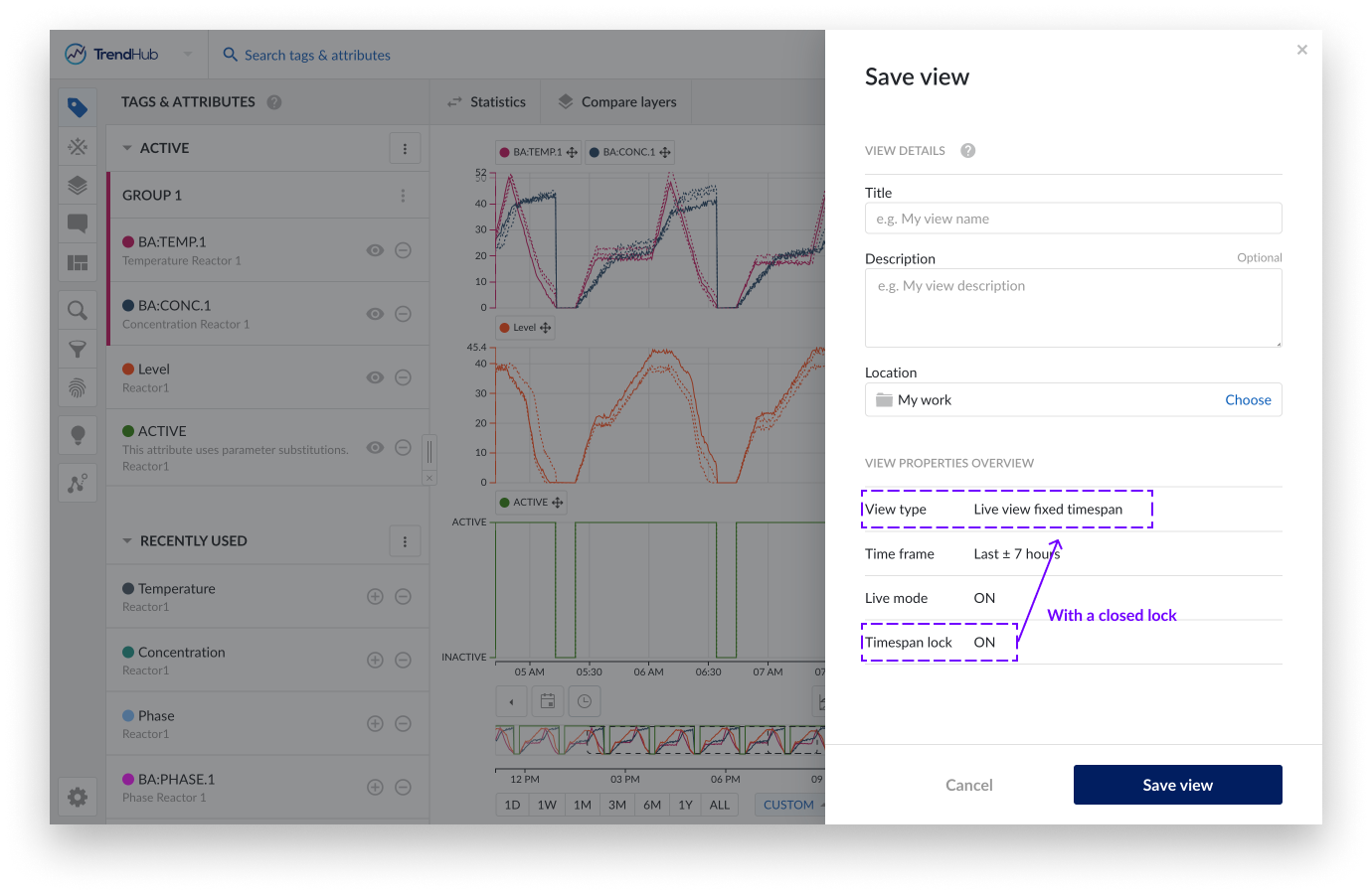

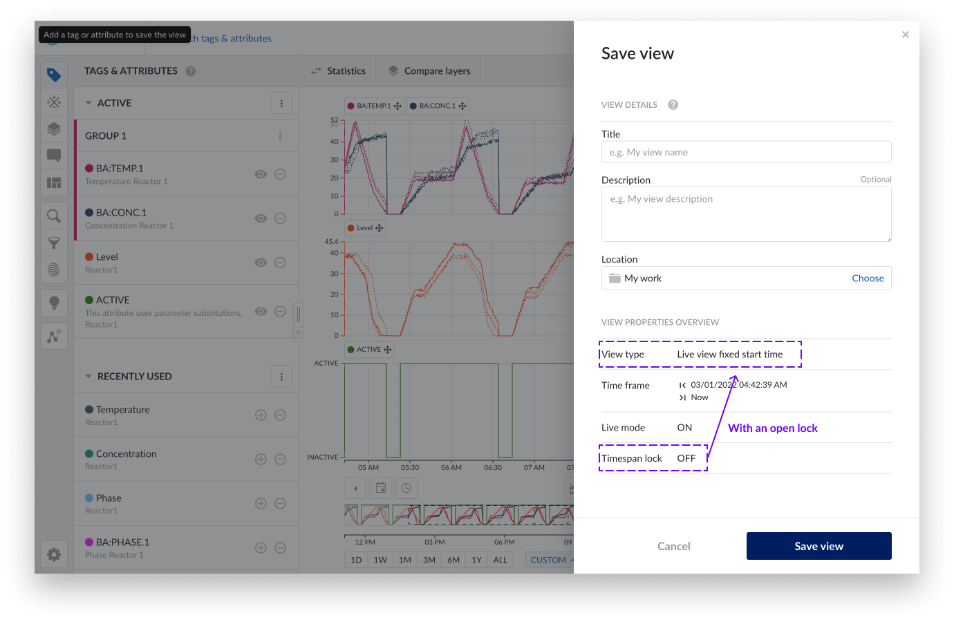

It is possible to save the view with the live mode option enabled. Simply save the view as you would normally do by clicking the actions button in the view bar and selecting the "Save as" option in the drop-down menu. Fill in the Save view side panel and click the "Save view" confirm button.
Depending on the state of the lock button, two views can be created. The view will be saved as a "Live view with fixed timespan" when the lock button is closed. With the lock button open the view is saved as a "Live view with fixed start time".
In the view details you can see the view-type is now a live view with a time period that includes Now as the end point. Live mode is also stated as On.
