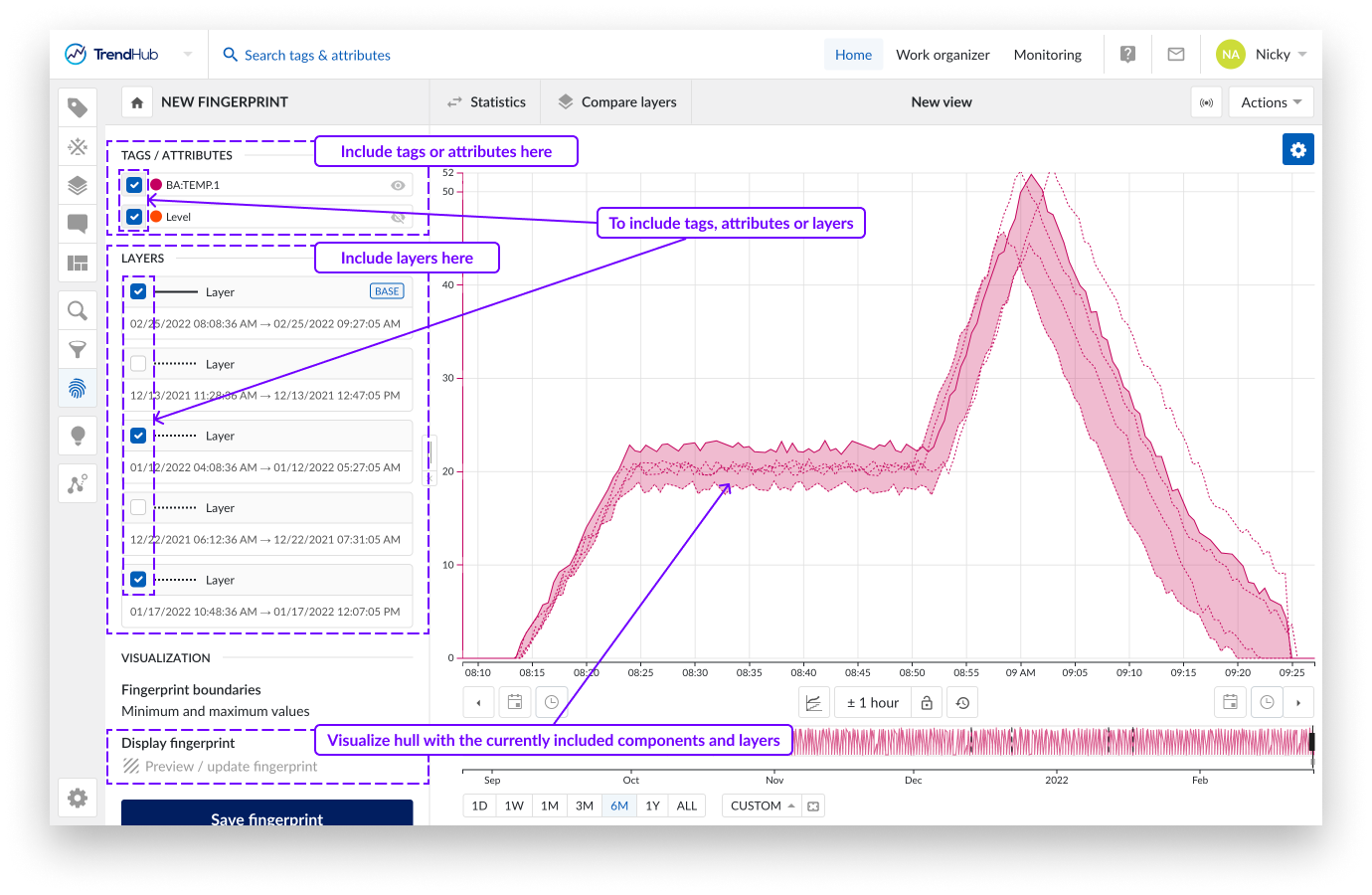

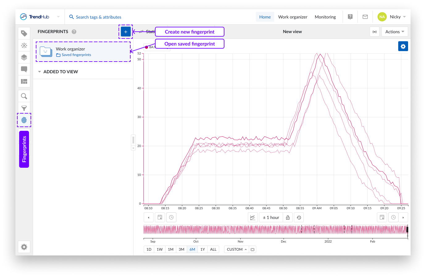

On the fingerprint's menu, clicking the blue plus icon situated at the top right of the menu header results in the creation of a fingerprint.
Once the "Add fingerprint" button is clicked, a setup menu (on the left) is shown where you can first define which active tags should be included in the fingerprint.
In a fingerprint, tags and attributes can be included as a visual component or a hidden component. The blue checkmark in front of the tag defines if the tag is included. The state of the eye icon on the right denotes a tag included as a visual or a hidden component.
A hidden component can be suggested in the diagnose functionality when there is a pattern that correlates. When setting up a monitor for a fingerprint, only the visual tags will be considered to detect matches or deviations.
Only "Analog" tags or "Discreet" tags are currently supported in a fingerprint.
Below the tags section you can define which layers should be included in the fingerprint.
To see a preview of a fingerprint you have the option "Preview / update fingerprint" in the visualization section below the layers. Here you can see the current settings of the fingerprint before saving it. The fingerprint hull is created by using the maximum and minimum value throughout all layers over a specific time stamp.

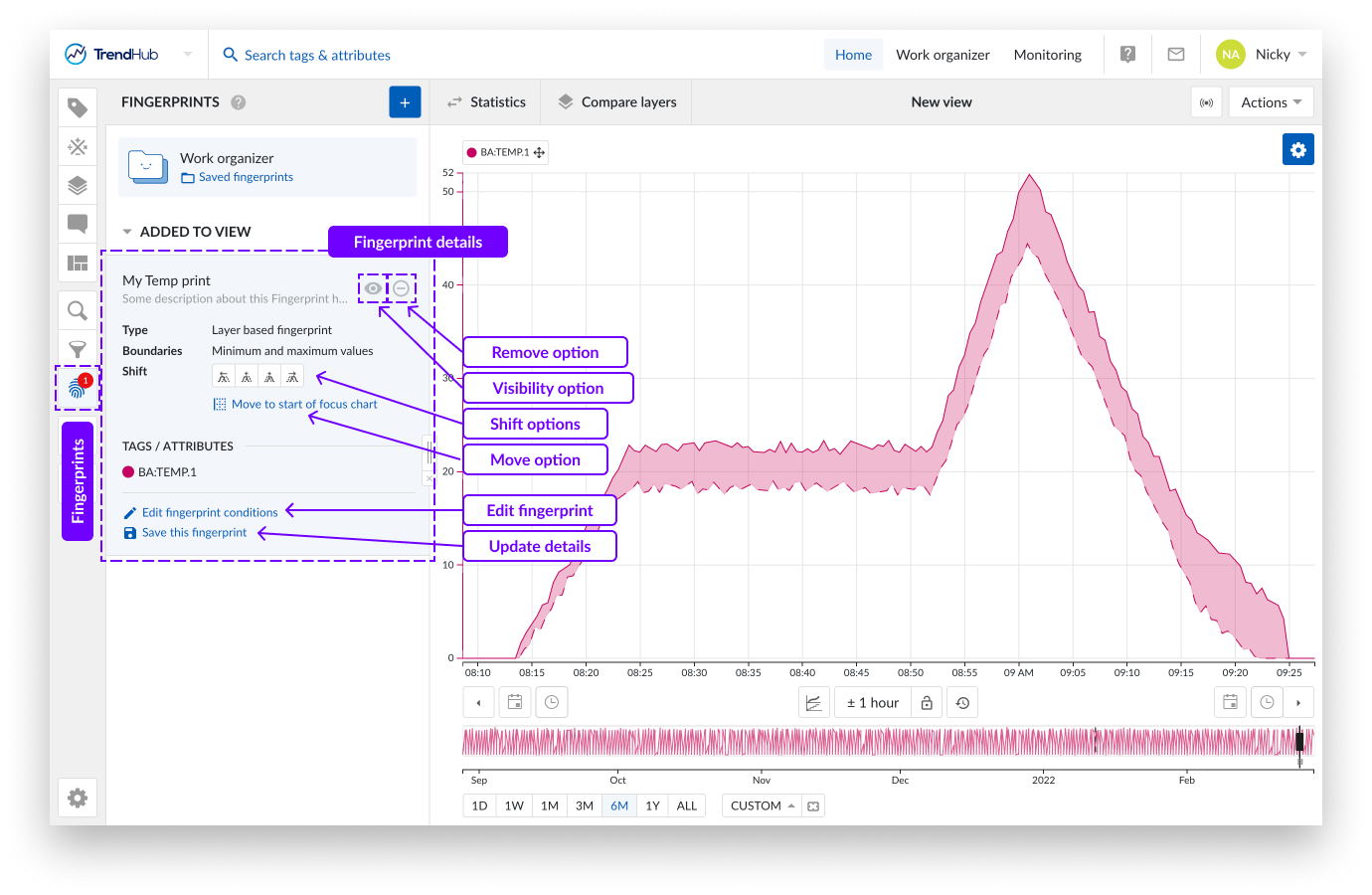

When a fingerprint is created, it is automatically added to the view in the "Added to view" section on the fingerprint menu. The fingerprint is also by default visualized.
When fingerprints are present in the Added to view section, you can see the name and description for each, together with two options:
  • Toggle the visibility
  • Remove fingerprint from the view
More than one fingerprint can be added to the Added to view section and saved in a view.
Only one fingerprint can be enabled at any given moment. When enabling another fingerprint, the previously visualized fingerprint is hidden.
To open the details of fingerprint, simply click on the fingerprint.
The extra details contain more information on the type of fingerprint and the boundary calculation used for the fingerprint hull. The included tags / attributes are also mentioned in the details overview.
In the details section you can also find and perform the following options and actions.

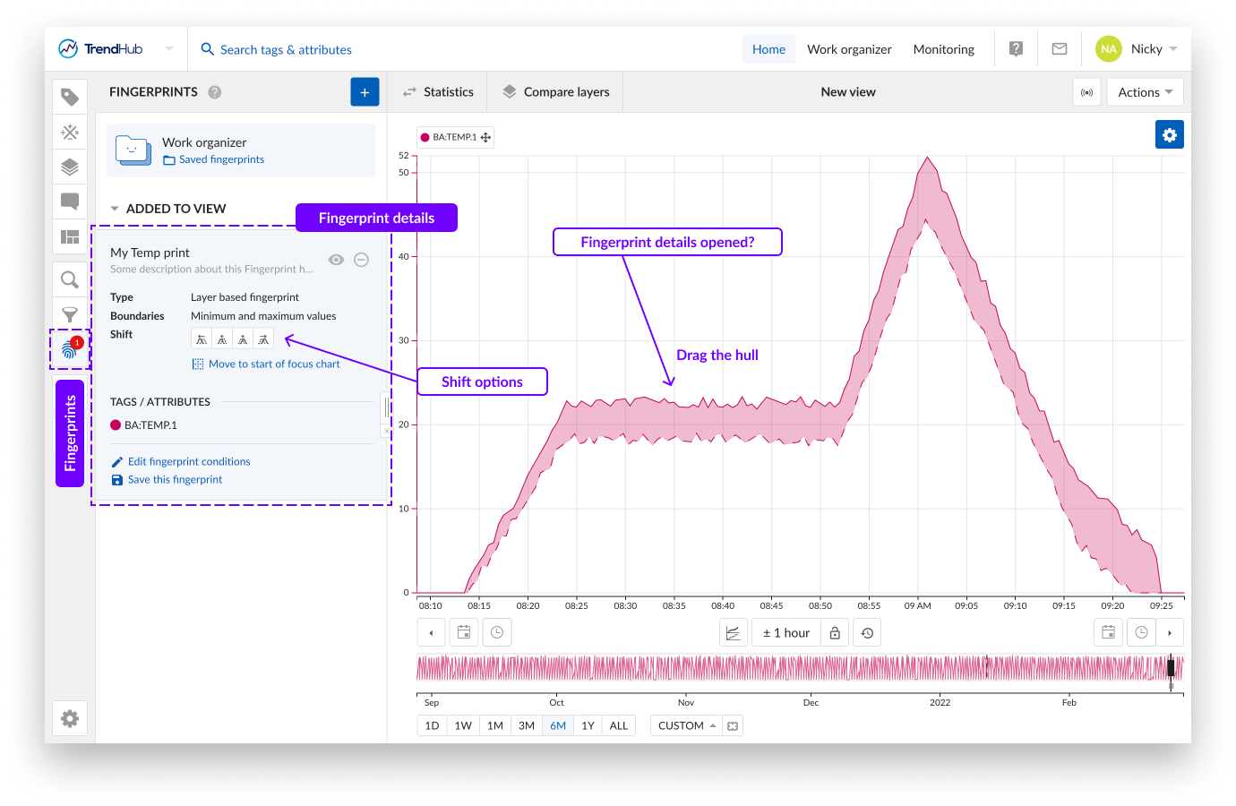

You can move the enabled fingerprint in three ways:
  • You can shift the fingerprint using the shift buttons. The outer buttons correspond to a shift of 5% of the current period and the inner buttons to a shift of 0.5% of the current period.
  • Under the shifting buttons is the option to move the fingerprint to the start of the current focus plot.
  • You can also move the fingerprint by dragging the hull over the chart to the position of interest. To do this, the fingerprint must be visualized, and the fingerprint's details must be opened. The option to drag the fingerprint appears when hovering over a shaded area on the focus chart.
At the bottom of the fingerprint's overview, the option "Edit fingerprint conditions" can be clicked to start updating the fingerprint.
The setup panel is shown again when clicked. By default, included tags and layers are automatically selected. Additional tags and layers can now be included or excluded.

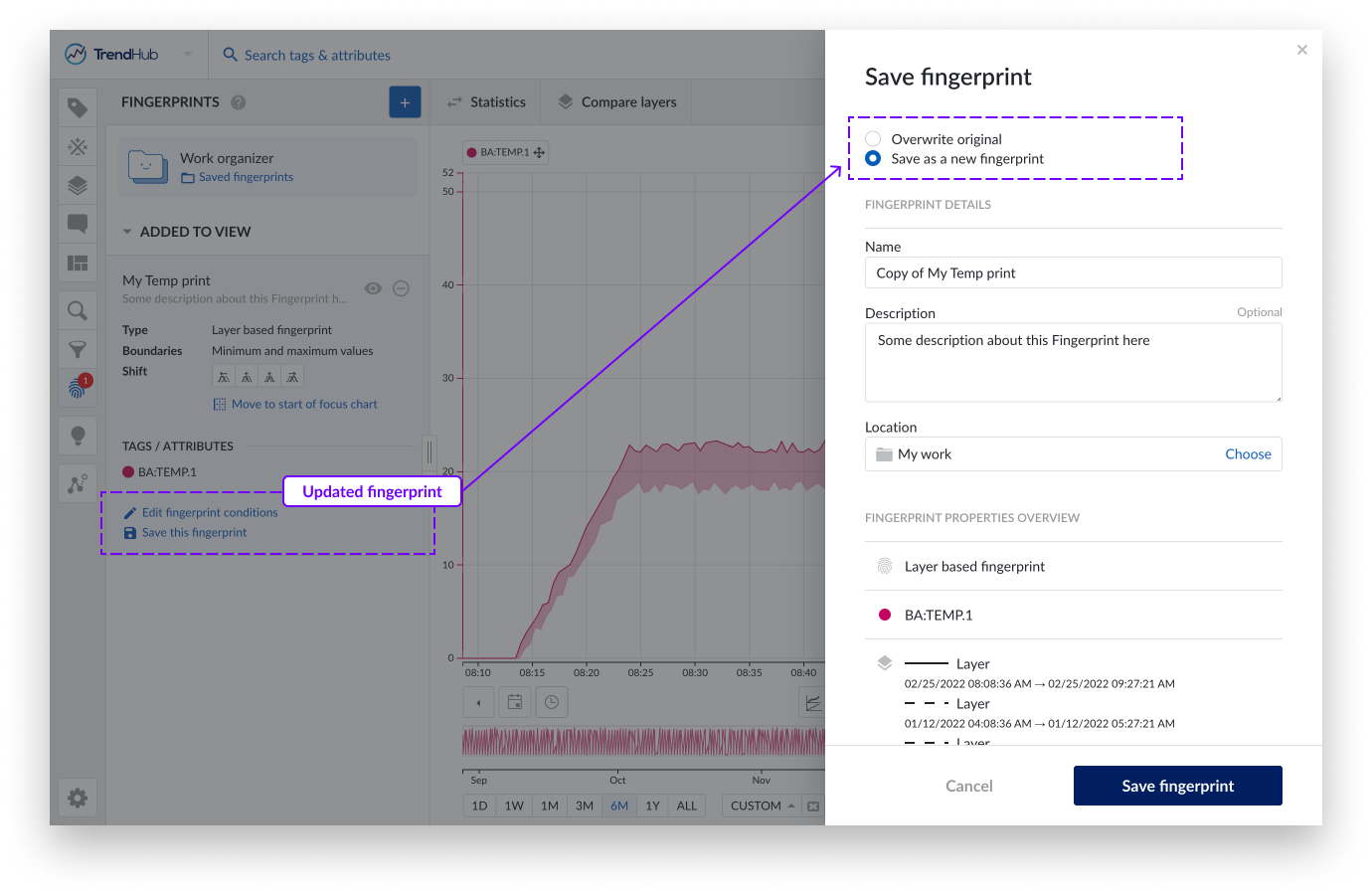

When saving a modified fingerprint, the save side panel has an extra option. You can choose to "Overwrite original" or to "Save as a new fingerprint".
The "Save this fingerprint" option allows you to update the name or description of the fingerprint directly or to make a copy of the fingerprint.
In this case, the save fingerprint side panel which is shown has an extra option. You can choose to "Overwrite original" or to "Save as a new fingerprint".

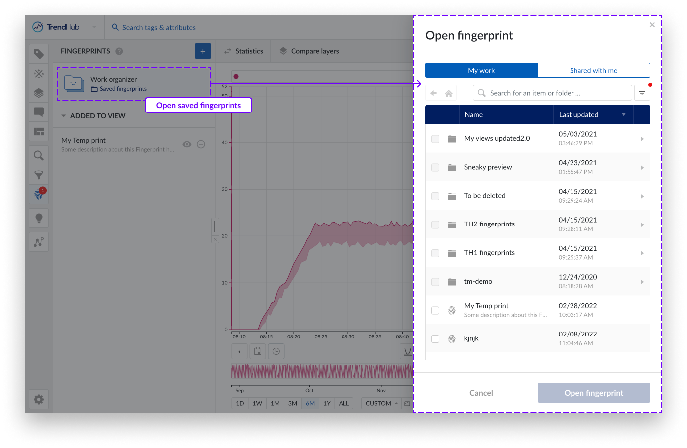

When a fingerprint is saved, you can open by selecting the light blue Work organizer section. Clicking this option opens a side panel where you can search for a fingerprint. A fingerprint is automatically visualized once it is added to the view (visible in the Added to view section).
