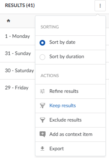

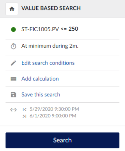

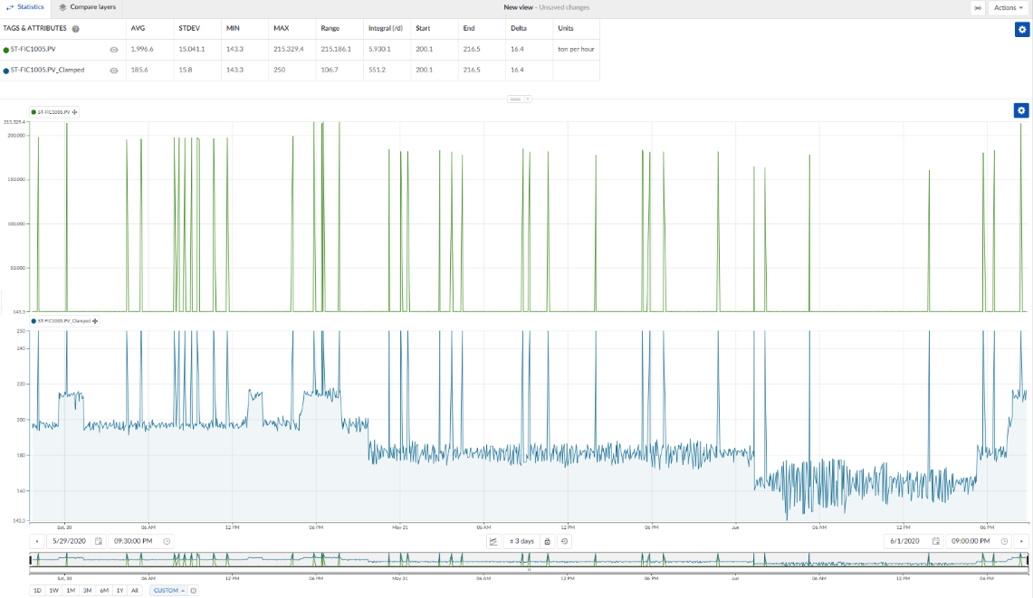

Perform a value-based search to look for values smaller than the spikes.
Keep results to exclude the spikes.
When looking at the statistics table, the values are now displayed without considering the spikes.

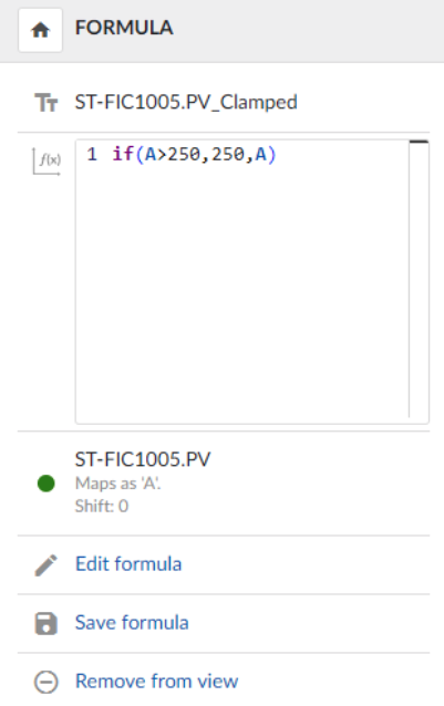

Create a formula to over clamp the spikes to a lower value (threshold for maximum of spikes).
if(A>250,250,A)
Variable mapping:
A = Original tag with spikes
When looking at the statistics table, the values are now displayed with an upper limit for the spikes.
Advantages: Simple concept, Flexible
Disadvantage: Small loss of accuracy

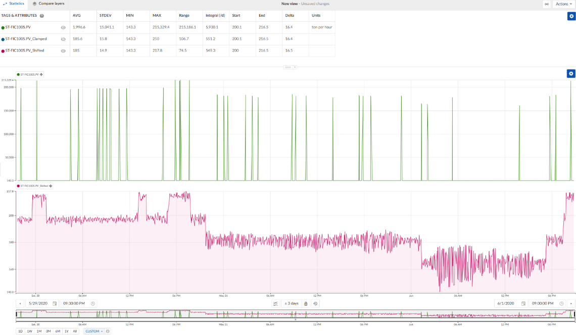

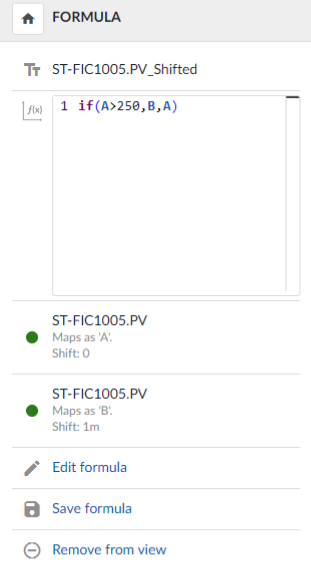

Create another formula to use the last good point as a reference point.
if(A>250,B,A)
Variable mapping:
B = Original tag with spikes, shifted by 1 minute
When looking at the statistics table, the values are now displayed precisely.

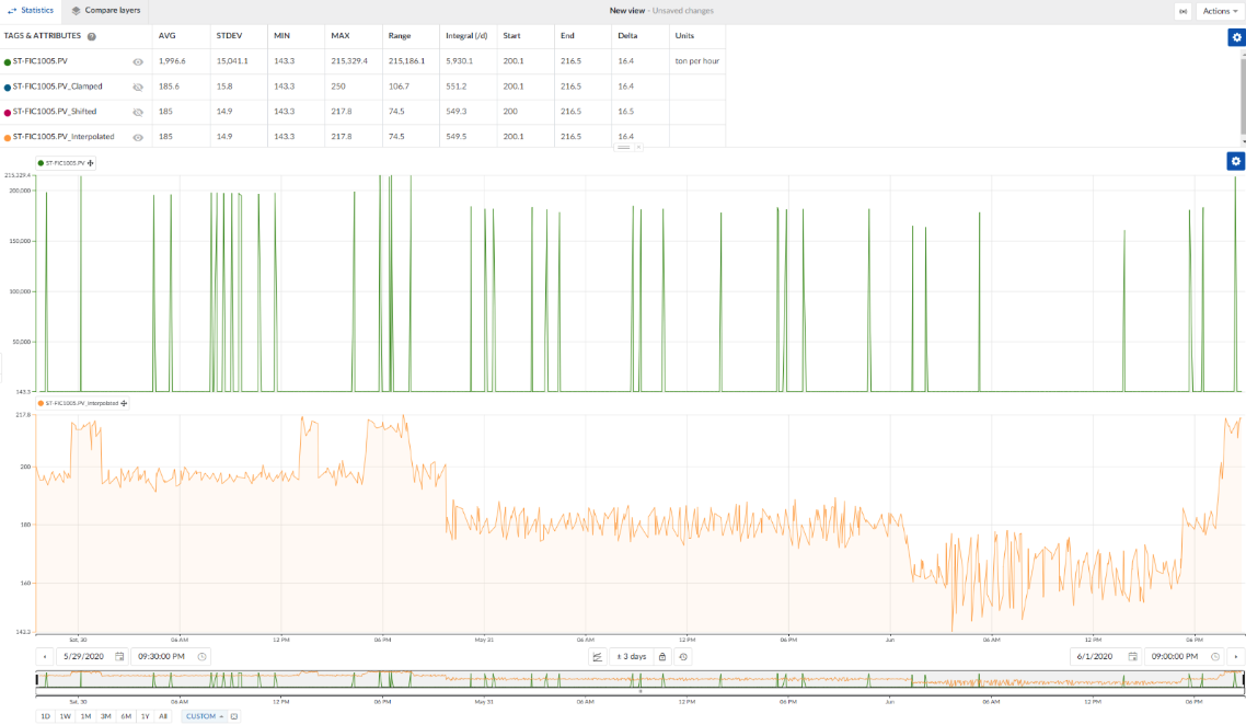

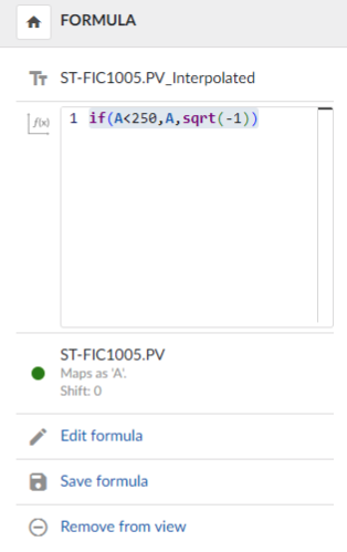

Create a formula to linearly interpolate between the start and the end value of an interval when the if-condition is not true.
if(A<250,A,sqrt(-1))
Variable mapping:
When looking at the statistics table, the values are now displayed precisely like in option C.
Advantage: Accurate
Disadvantage: May require fine-tuning
