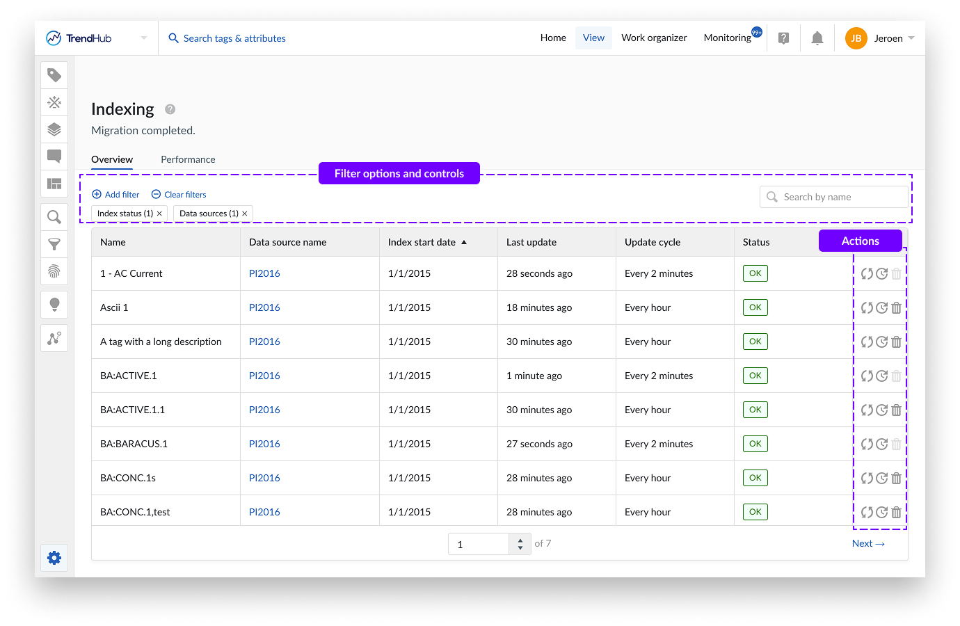

The Index Manager is divided into two main tabs, each serving a specific purpose:
The Index Overview tab offers a comprehensive summary of all tags indexed within the TrendMiner system. For each tag, the following details are provided:
  • Datasource Name: This column indicates the name of the datasource linked to each tag, assisting administrators in pinpointing the data's origin. Tags created within TrendMiner are marked with an Internal label.
  • Index Start Date: The point in time up until we have indexed tag data. For tags that have been successfully indexed, this date should align with the configured horizon.
  • Last Update: The most recent attempt by TrendMiner to update the index.
  • Update Cycle: This column outlines the update frequency for each tag, revealing how often recent data is appended to the index.
  • Status: An indication of the overall health of the tag (refer to the table below).
For each tag, the following actions can be performed:
  • Refresh index: This action deletes and recalculates the index and the index policy of the current tag. It will also automatically delete the index of any Tag Builder tags constructed on top of the refreshed tag.
    A refresh of an index can be useful in case data has been modified/corrected in the datasource itself after the initial storage. Such updates are not automatically picked up by TrendMiner.
  • Refresh index policy: This action clears indexing policies and queries the system for policies. It should only be used when the update cycle does not represent the expected value.
    The default update cycle is 1 hour. Tags which are used in monitors (directly or indirectly through Tag Builder tags) should have an update cycle of 2 minutes.
  • Delete index: This action deletes the index of the current tag and automatically deletes the index of any Tag Builder tags constructed on top of the deleted tag. Since tags which are used in monitors are required to have an index, they can not be deleted.
    Deleting an index can be useful to free up storage or to clean up Stale tags.

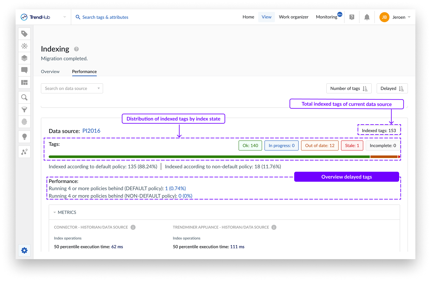

The Performance tab visualises a card for each connected and internal time-series datasource. Each card provides the following detailed information:
  • Number of Indexed Tags: Displays the total number of tags that have been indexed for this specific datasource.
  • Number of Tags per Index State: Shows the distribution of tags across different index states.
  • Number of Tags per Index Refresh Policy: Shows the distribution of tags which should be indexed hourly of every 2 minutes.
  • Number of Delayed Tags: Indicates the number of tags that are delayed in their indexing process.
  • Dropdown with Metrics: Provides additional metrics on historian performance, offering deeper insights into the datasource's indexing efficiency. More information on how to interpret these metrics can be found here.

Index refresh policy and delayed tags
Once a tag is used, an index is created, and the tag is updated automatically. By default, tags are updated every hour to ensure data freshness. Tags used in monitors (either directly or indirectly through a tag builder tag) have a more frequent update cycle of 2 minutes. This ensures that monitors can provide the most recent results. A tag is marked as delayed if it hasn't been updated for a period 4 times longer than its defined update cycle. For monitor tags, this means 8 minutes, and for other tags, it means 4 hours. Tags with higher (percentual) delays are prioritized for indexing to minimise indexing delay for tags used in monitors.
Delayed tags are an interesting KPI to assess the overall performance of the specific datasource or the overall TrendMiner system. See the section which provides advice on how to interpret these values and to identify specific bottlenecks.
