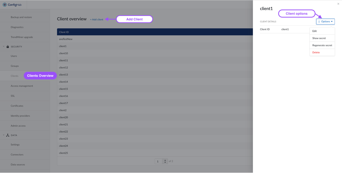

Creating Clients
TrendMiner allows the creation of a client and secret in order to generate a token to be used in external API calls.
To create a new client you will need to go to the clients-menu under the "security" section. From there clients can be created via the "+add client"-button.
You will be asked to enter a name (client ID) for your client which will be used for external references. Once the client is created you can click on it to:
  • Edit the client ID
  • Show the secret of the client
  • Generate a new secret
  • Delete the client
Regenerating a secret will invalidate your old secret and tokens. This action cannot be undone.

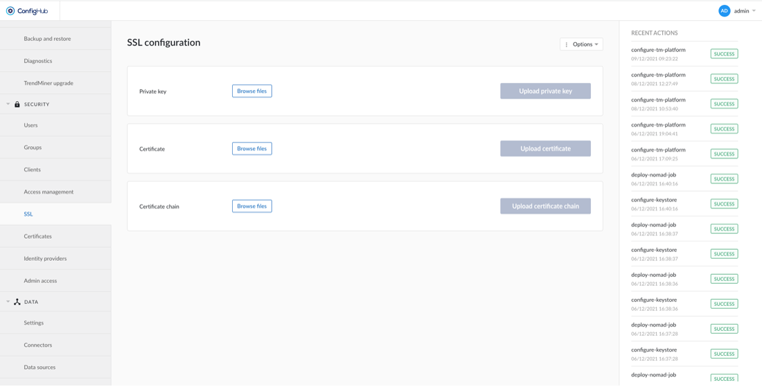

  • Private key
  • CSR for that private key
  • Certificate chain
Generating a CSR is the responsibility of the customer. It's not feasible for TrendMiner to do this.
The web server software (Apache) only supports PEM certificates. OpenSSL can be used to convert certificates in a different format to PEM.
Once these prerequisites are fulfilled, HTTPS can be enabled via the "Options" menu on the top right.
For a more detailed guide of what is, why and how to use SSL in TrendMiner, please look to this document.SSL configuration

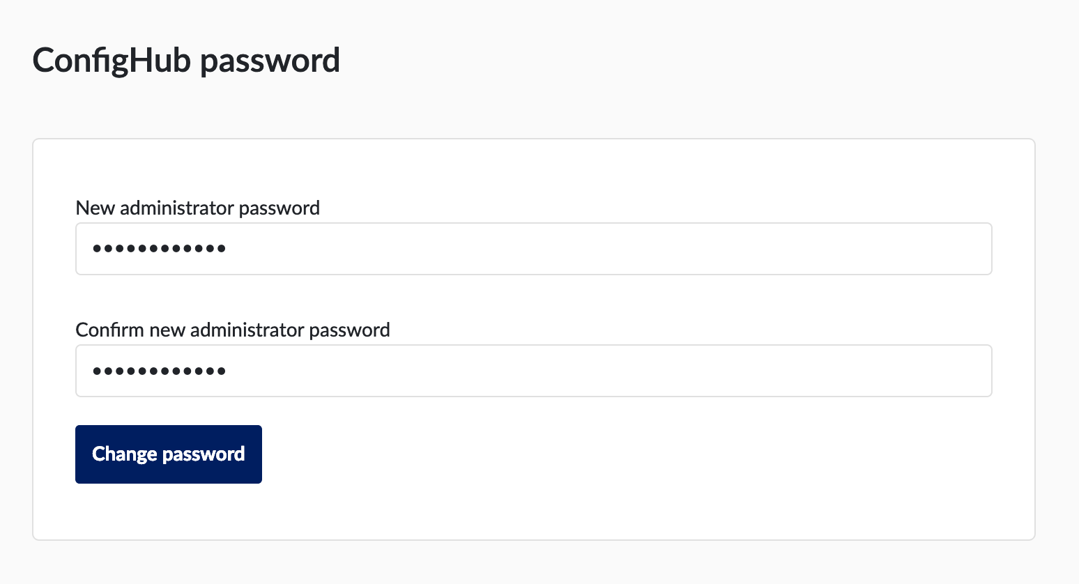

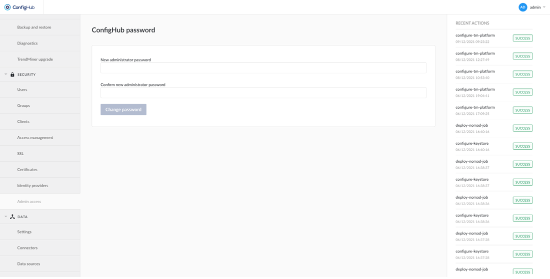

Via Admin Access the password for the ConfigHub admin user can be changed.
To change the Administrator password of ConfigHub, navigate to the security menu and click ‘Admin access’. Enter the new password twice and click ‘Change password’.
