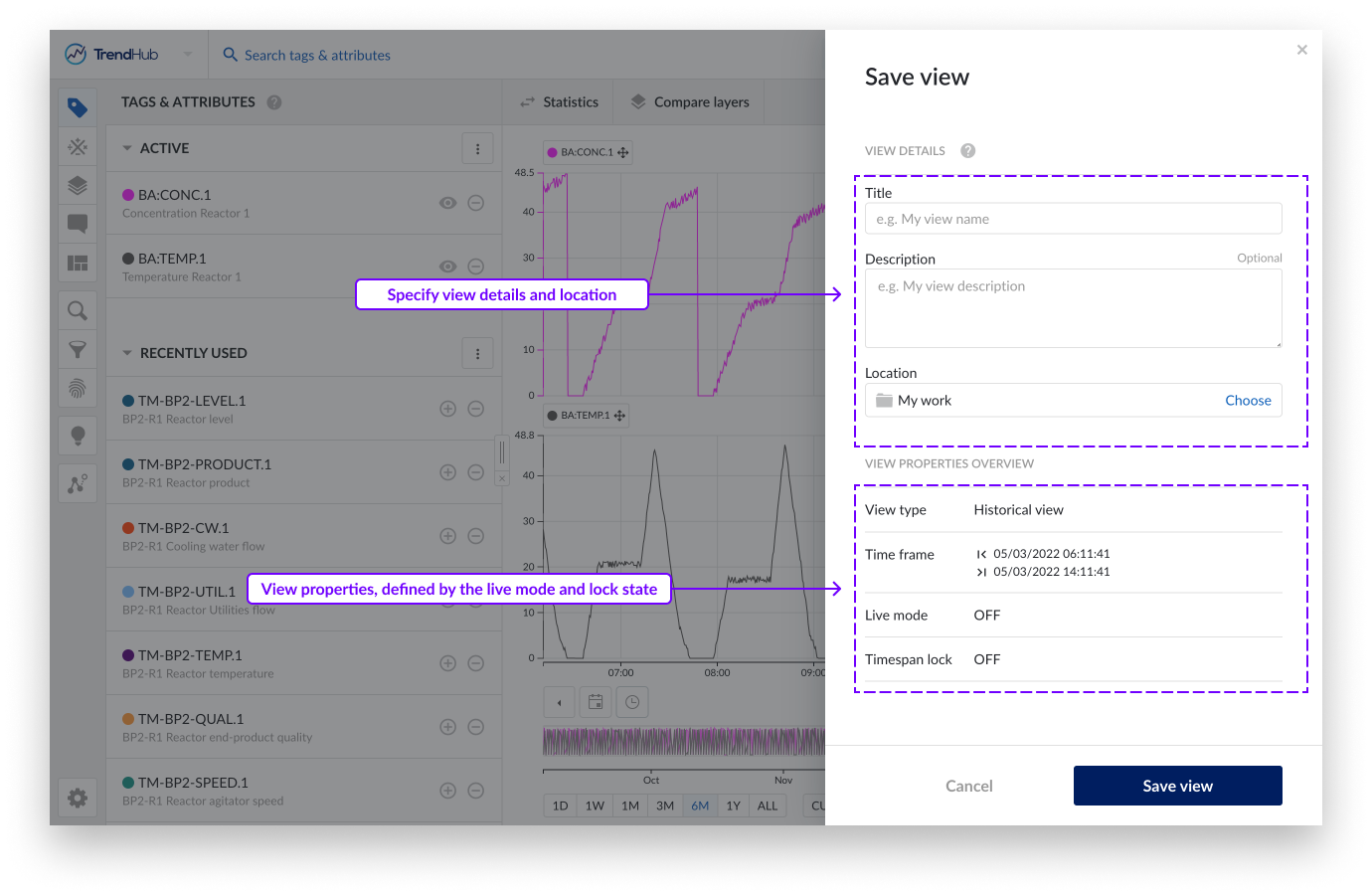

Follow the steps below to save a view:
  1. Add tags or attributes to your view (e.g. through the tag and asset browser) and see them displayed in the focus chart. Customise the chart to your liking (set time frame, chart configuration, tag settings, ...)
  2. Click on the "Actions" button located at the top right of the focus chart and select "Save as" from the dropdown, or click directly on the save icon next to the view name to open the save panel.
  3. A "Save view" panel will appear from the right side of the screen. Fill out the open fields and choose a location to save your view.
  4. Click the "Save view" button. The name of the saved view will now be indicated in the view bar.

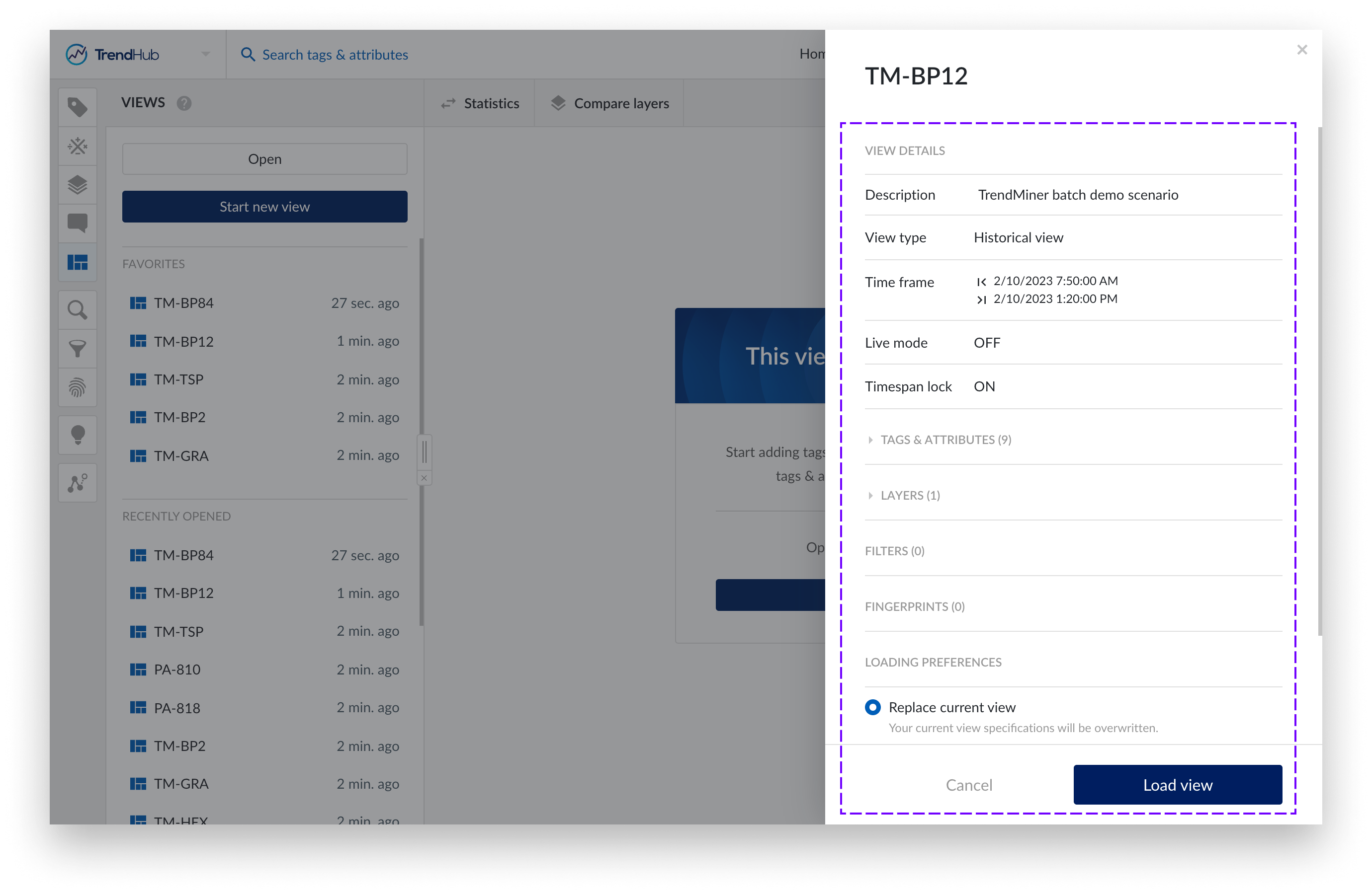

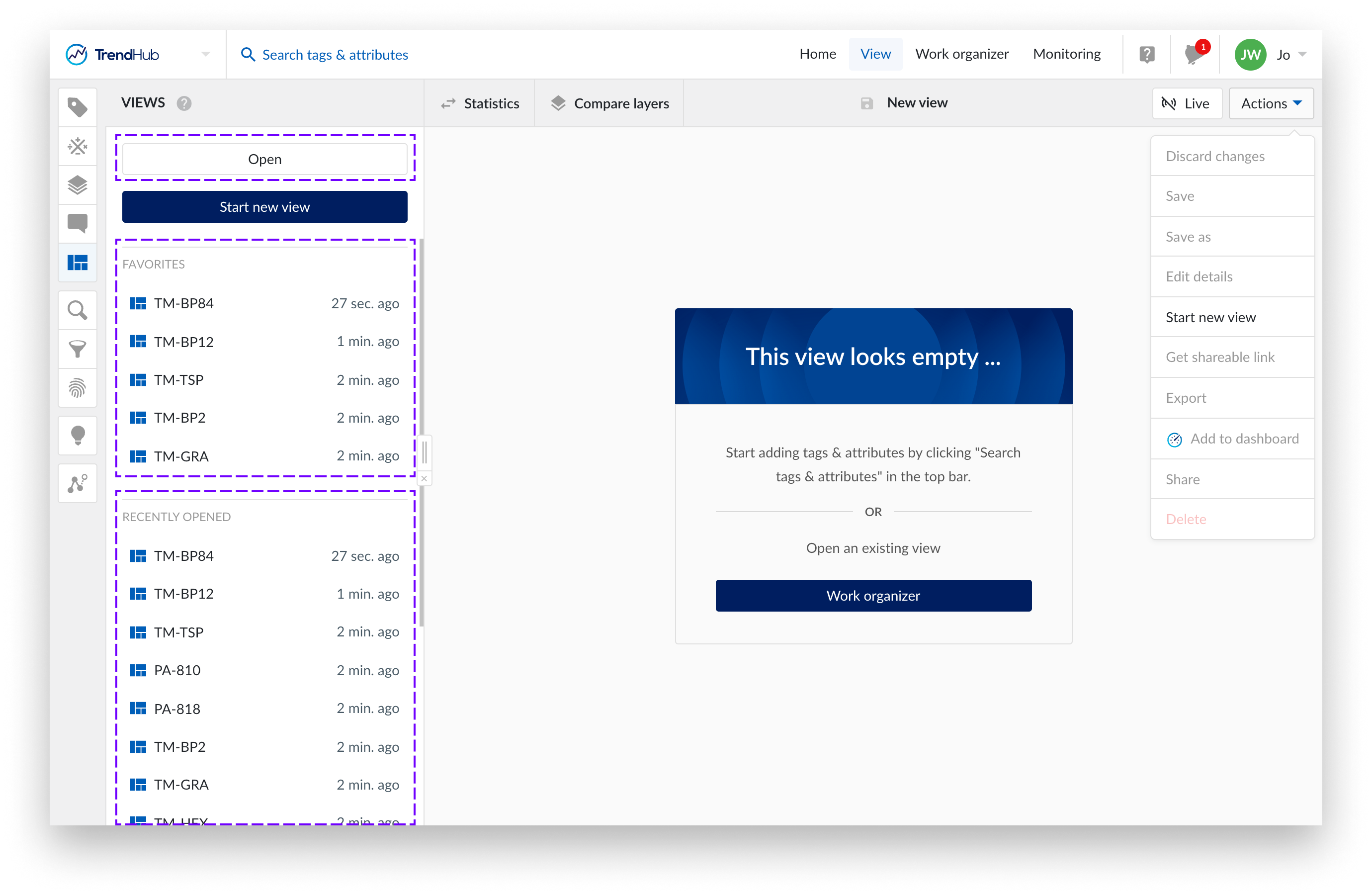

  1. Click on "Views" in the TrendHub menu SL1_Icon.png. A panel will open left of the focus chart.
  2. Click on the "Open" button located within the panel. This action will open the side panel of the work organizer, filtered by the TrendHub View type. Alternatively, you can directly access a view from your "Favorites" or "Recently opened" lists.
  3. Select the view you wish to open. A details panel will open for the chosen view containing all info of the saved view.

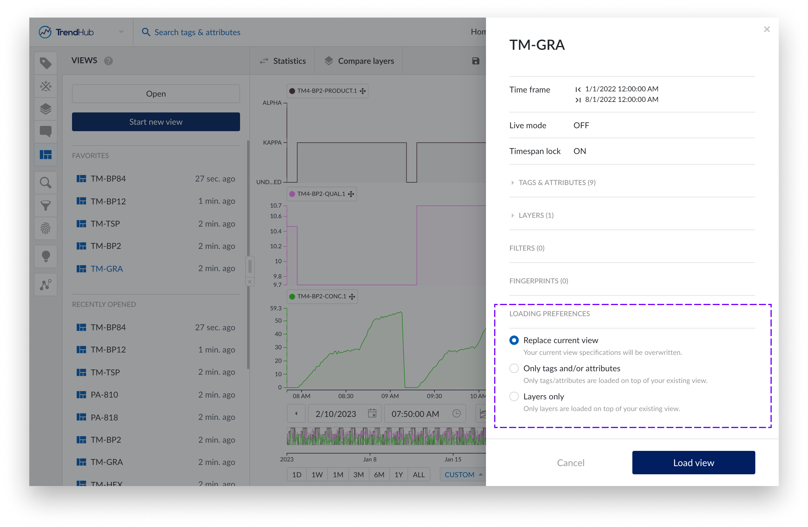

  4. Select the load action that needs to be performed in the loading preference section and click "Load view" to execute the loading action.
    1. Replace current view: Everything that is currently on the screen will be removed and all settings of the saved view will be loaded.
    2. Only tags and/or attributes: The current visualized time frame and layers will remain unchanged. The tags of the saved view will be added to the current active tag list.
    3. Layers only: The current visualized time frame, layers and active tags will remain unchanged. The layers of the saved view will be added as additional sublayers.

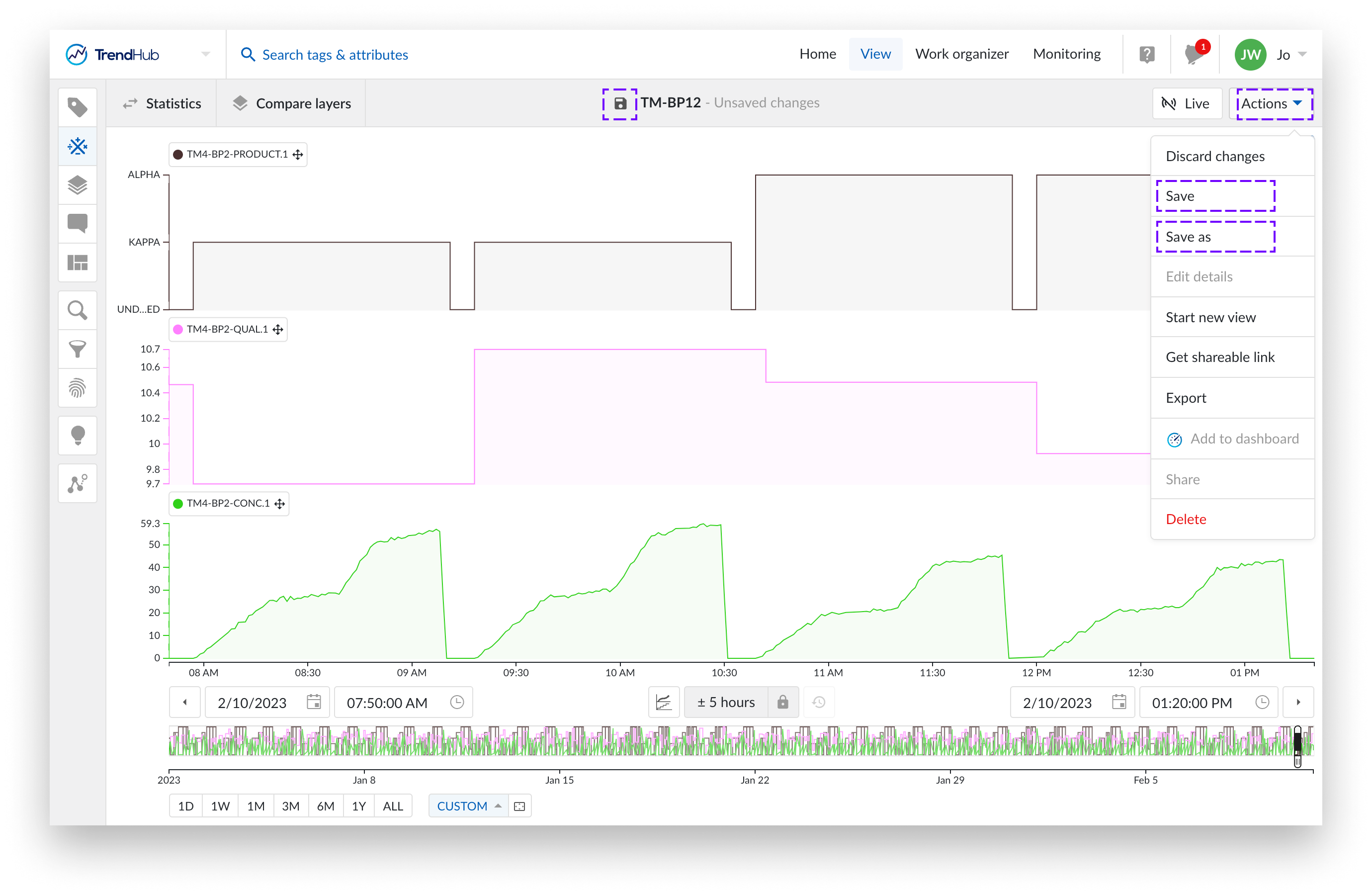

The name of a currently opened view is indicated in the view bar. As soon as any changes are performed (e.g., visualized time frame is altered, new tags are added, ...), TrendMiner will indicate that the view contains unsaved changes.
Click on the "Actions" button and select "Save" in the dropdown to save the applied changes, or click directly on the save icon next to the view name. Select "Save as" to save the current visualization as a new view.

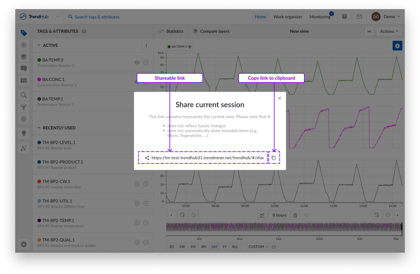

A shareable link, on the other hand, is a static reference to everything that was visualized at the time the link was created. Future changes are not considered. A shareable link can also be created for non-saved views.
To create a shareable link, click "Actions" and select "Get shareable link" in the dropdown. You can easily copy the link from the pop-up window.
All details about a view, tags, attributes, colors, scalers, shifts, groups, selected focus periods, layers as well as graphical displays (incl. Chart settings), except for possible included items (filters, and fingerprints) are included within a shareable link.
