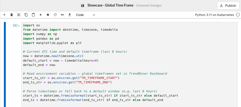

Example:
import os
from datetime import datetime, timezone, timedelta
import numpy as np
import pandas as pd
import matplotlib.pyplot as plt
# Current UTC time and default timeframe (last 8 hours)
now = datetime.now(timezone.utc)
default_start = now - timedelta(hours=8)
default_end = now
# Read environment variables — global timeframes set in TrendMiner Dashboard
start_ts_str = os.environ.get("TM_TIMEFRAME_START")
end_ts_str = os.environ.get("TM_TIMEFRAME_END")
# Parse timestamps or fall back to a default window (e.g. last 8 hours)
start_ts = datetime.fromisoformat(start_ts_str) if start_ts_str else default_start
end_ts = datetime.fromisoformat(end_ts_str) if end_ts_str else default_end
# Generate synthetic data
timestamps = pd.date_range(start=start_ts, end=end_ts, freq="1min")
values = np.random.random(len(timestamps))
# Create DataFrame and plot
df = pd.DataFrame({"ts": timestamps, "value": values})
df.set_index('ts').plot(title="Synthetic Time Series")
plt.xlabel("Timestamp")
plt.ylabel("Value")
plt.tight_layout()
plt.show()
print("end")
