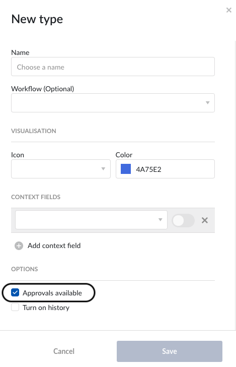

  1. Create a context item type as normal.
  2. Tick the "Approvals available" button.

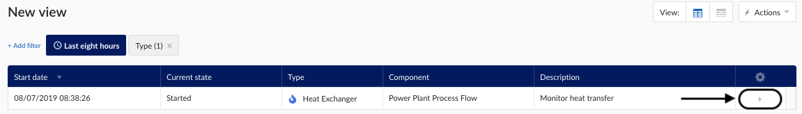

  3. Click the + sign at the top of the views menu.
  4. Filter your view to locate your new context item.

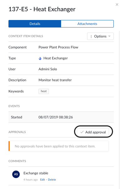

  5. Click the small greyed arrow that points right at the far right of your new context item. A side panel will appear from the right.
  6. Click on the "Add approval" button.
When you add your approval, you are essentially authenticating the context item you have created. You approval will be publicly available. When others given authority to approval approve, you will see this highlighted under the "APPROVALS" section in the context item.
If necessary you can remove the approval by clicking the "Remove approval" button.
