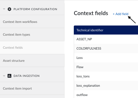

  1. Select the gear icon located in the top bar of ContextHub.
  2. Go to the PLATFORM CONFIGURATION menu.
  3. Select "Context fields".
  4. Click "Add field".

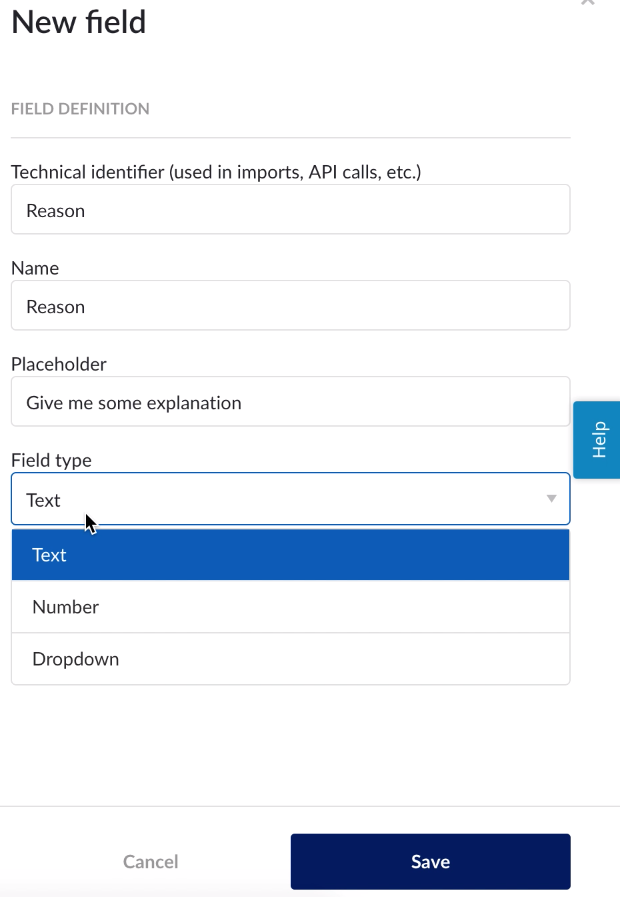

    A side panel appears from the right called, "New field".
  5. Fill in the fields provided in the side panel.
  6. Click "Save".

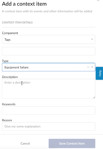

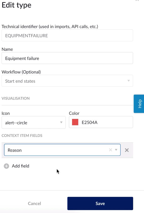

    In the example above (left), a new field called "Reason" has been created. Now when you edit or create a new context item type (above right) you can add your new field. In this example, the context type "Equipment failure" is being edited so that a new field is required for completion. The new field added, is "Reason".
  7. Click on "CONTEXT ITEM FIELDS" to search for and select your new field.
    When you now add a new context item and you select the type "Equipment Failure" the new field "Reason" automatically appears as a necessary field.
To prevent any issues with the newly created field make sure that the “Technical identifier” consists of at least 4 characters, does not start with a number, does not include any spaces and uses only capital letters.

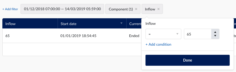

The newly made custom items can be added to the item view tables in the form of columns. If a number type custom field is added to a table, it will be possible to filter your new context type down to numerical ranges, data allowing.
