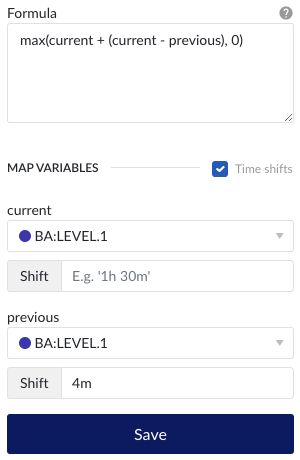

Figure 3. Linear extrapolation example
We estimate what the level will be 4 minutes. Since we know the level cannot be negative, we use the max function to have 0 as the lower limit.
Linear extrapolation will always be a simplification of your process. If you think a more custom formula can predict future values better, don't hesitate to try that.
