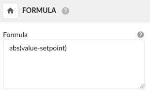

When we are interested in the delta between two metrics, we can create a formula tag calculating the difference. Some typical calculations are given below.

Tip
Depending on the use case you might want to work with the absolute value of the difference. A typical example would be when we want to quantify the average or total deviation later.
