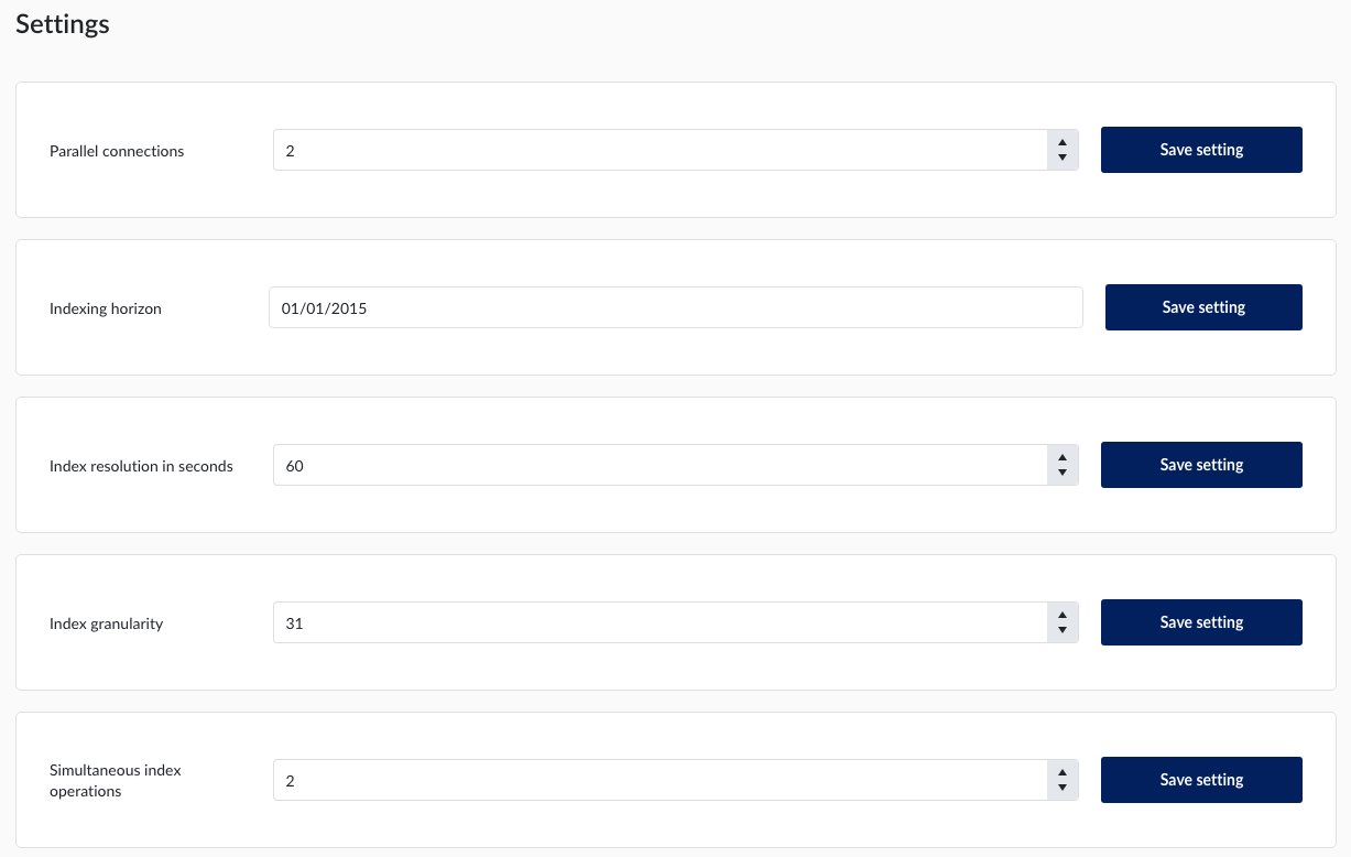

TrendMiner uses certain connection settings to optimize the performance of the historian connection. By default, 2 parallel connections are used. In most cases, the value for the “Historian Parallelism” setting should equal the number of cores on your Historian server.
The setting is a global setting, but parallel connections can also be set per datasource (in the datqa > datasource menu) as an override. Changing the global default will not update the existing overrides. They will keep the current value set as override.
Consult TrendMiner support at support@trendminer.com if you are experiencing performance issues or believe it would be appropriate to change this setting.
The indexing horizon shows the earliest date from where tags are indexed. Tag data before this date will not be available for TrendMiner analysis. The default indexing horizon is January 1st, 2015( reference 1). When increasing the index horizon (e.g. from 2015 to 2010), already indexed tags will automatically resume indexing up until the new horizon whenever these tags are used in charting or by monitors. When decreasing the index horizon (e.g. from 2010 to 2015), existing indexes will not automatically be deleted but new tags (or when re-indexing already indexed tags) will index only up till the new index horizon.
The index resolution defines the level of detail of the index. For a resolution of 1 minute (the default) the index contains up to 4 points per minute.
Valid, supported index resolutions are:
Minimum: 5 (5 seconds)
Maximum: 86400 (one day)
86400 has to be divisible by the index resolution
Caution
If required, an index resolution of 1 second can be configured, though this is not officially supported and might lead to performance issues
Changing the index resolution will delete all existing tag indexes
The index granularity defines the time periods which are fetched from the datasource to build the index, during the backward indexing process. The smaller the time periods, the more calls have to be made to the datasource, causing greater overheads and slower indexing. The larger the granularity, the greater the risk on connection time-outs and the higher the memory consumption.
The default granularity is 1 month ("1M").
Valid index granularities include, for example, "1D" (1 day), "5D" (5 days) or "2M" (2 months). Changing the granularity will not impact tags which are already indexed.
This value sets the number of simultaneous index operations. The default value is 2, which means only 2 indexing tasks can be running at any given time. Periods of different tags will be interleaved, giving higher priority to most recent periods, ensuring all tags will index at a similar pace.
Please contact TrendMiner support before changing this setting - support@trendminer.com

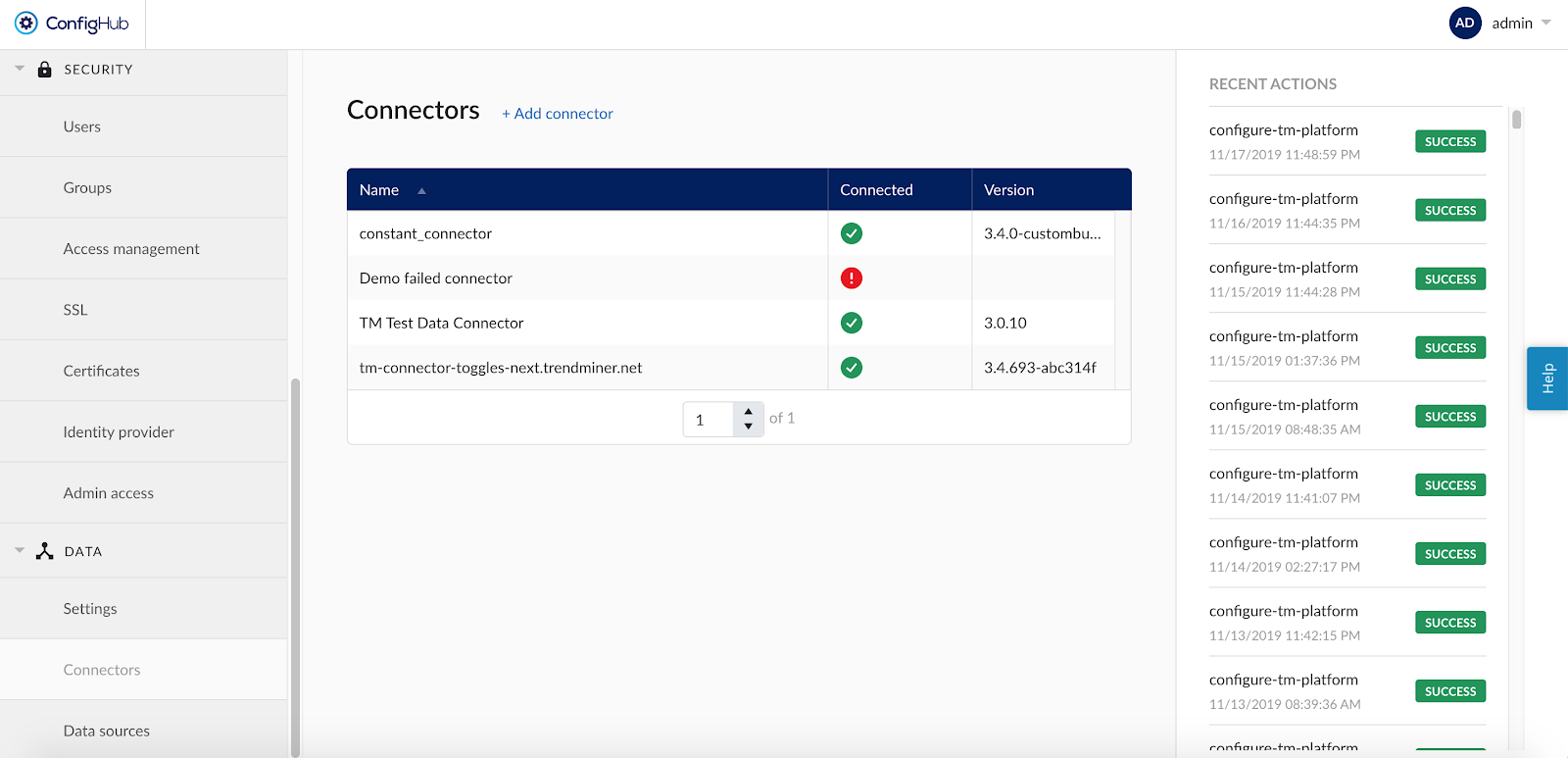

Add a new connector by clicking the (+ Add connector) label next to the title and fill in the fields for connector details:
Name: free to choose name. The only restriction is that each connector name should be unique.
Host: hostname of the connector.
Username and Password: should only be filled in when they are configured on the connector installation.
As soon as a new connector is successfully added it will start syncing all the data sources which are configured to the connector.
If a connector cannot be synced it will show a red exclamation mark in the connector list. To learn more about the cause of failure, open the connector details by clicking on the connector name. The error feedback will be shown under 'Last sync'.
For connectors which are successfully connected the 'Last sync' field in the connector details will show the last sync date and time. The last sync date and time will be updated when a manual sync is triggered or when TrendMiner synchronises the tag cache for that connector, typically during a nightly tag cache refresh.
A green checkmark in the connector list indicates that TrendMiner is connected successfully to the connector, but it does not indicate if there are syncing issues between the connector and the data source. The health status for connected data sources should be consulted in the 'Data sources' menu. Also note that the status will not automatically update when the page is loaded. Refresh the page or choose the 'Test connection' option to update the connection status of a connector.

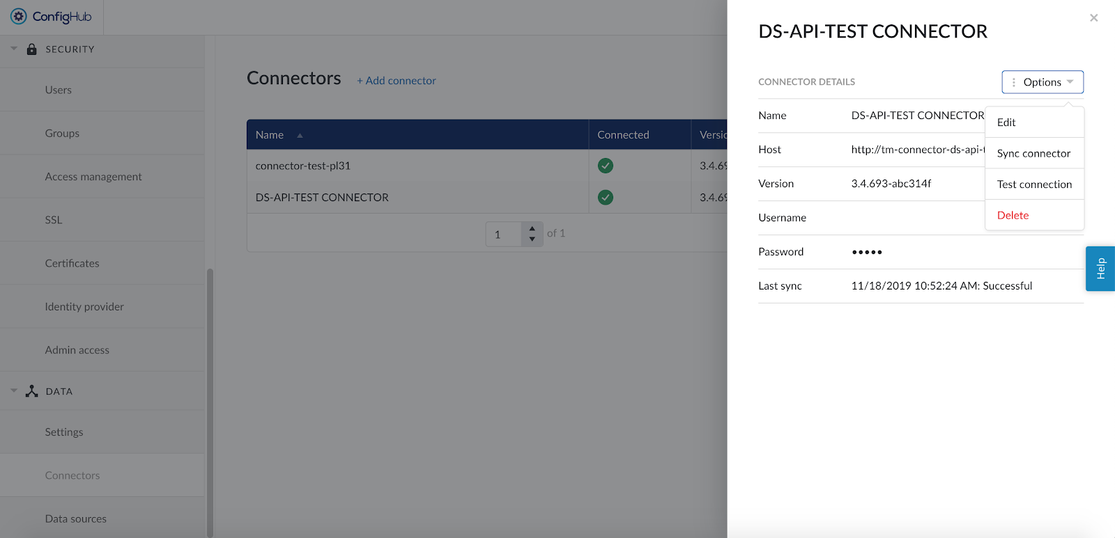

To edit the details of a connector click on its name to open the details and then choose 'Options' -> 'Edit'In the connector overview, the version of each connector is listed. This information is important in case a newer connector version supports new features or improvements for a specific data source.
Changing the name of the connector will not affect the tags from the connected data sources but changing the host, username or password to an incorrect value will render - tags from the connected data sources inaccessible.
Other options available are:
Sync connector: this will trigger a manual (re-)sync of all data sources which are configured on this connector. Choose this option to update all tags from all connected data sources at once.
Test connection: this option will test the connection to the connector without triggering a sync and update the health status of the connector.
Delete: this option will remove the connector from the configuration and remove all data sources which are using this connector, until the data sources are reconnected via a correctly configured connector.

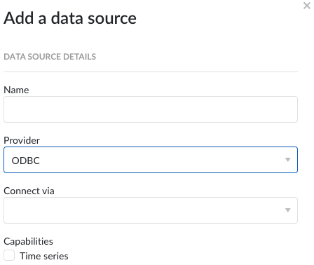

Add a new data source by clicking the (+ Add data source) label next to the title. An "Add data source" side panel will appear from the right of the screen:
Data source details
Populate the fields in the "Add data source" side panel:
Name: you are free to choose data source names but they are mandatory, case insensitive and unique. The name of a data source identifies the data source.
Provider: TrendMiner provides some out of the box connectivity to data sources via specific vendor implementations (e.g. OSIsoft PI, Honeywell PHD, ...) and via more generic alternatives (e.g. ODBC, OleDB, ...).The provider 'TM connector' enables the connection of data sources via a connector to connector setup. To connect a data source via multiple connectors, extra configuration is needed via the TrendMiner Connector API.
Connect via: this mandatory field is used to select the connector which is used to connect to the data source. All data sources need to be connected via a connector. To add a data source at least 1 connector needs to be added first.
Duplicate tag names are not supported. If 2 tags with exactly the same name are synced to TrendMiner, analytics, calculations and indexing on/for these tags might fail. Use data source prefixes to avoid possible duplicate tag name issues.
Depending on the provider you select, the connection details required for completion may differ. The data managed can be one of two types (or both):

When you click on the Time series check box, further fields display for completion.
Connection details:
Host: the hostname of the data source, e.g. myhistorian.mycompany.com
Username and password: username and password of the account configured in the data source.
Password
Prefix: you are free to choose prefixes. They are case insensitive but unique strings and have a maximum length of 5 characters. When synchronising a data source, all tag names of that data source will be prepended with the prefix to ensure tag name uniqueness in TrendMiner. Prefixes are optional but we highly recommend the provision of a prefix when connecting a data source to avoid duplicate tag names.

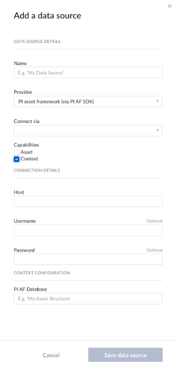

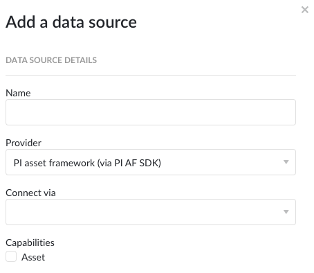

Asset data
The process when dealing with asset data sources, is somewhat similar to the time series details, but much fewer fields are required for completion.
It is not permitted to add the same connection multiple times with asset capabilities enabled on both instances! Asset tree permissions need to be managed in the asset permission section (ContextHub).
Context data
Context data sources are managed the same way as asset data sources. When a data source is context capable, the context capability checkbox can be checked, after which the correct database for context data needs to be specified.
Context data synchronized from a data source in OSISoft PI will be related to asset data in TrendMiner based on the "referenced elements" on the PI event frames. The system will always attempt to relate the context item to the asset corresponding to the primary referenced element in PI (if it exists). Otherwise it will default to the first referenced element for which a corresponding asset is known in TrendMiner.
It is not permitted to add the same connection multiple times with context capabilities enabled on both instances! This will result in the creation of duplicate context items.

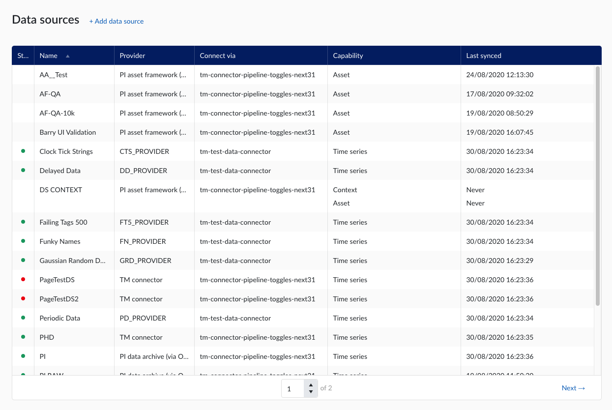

Data source menu

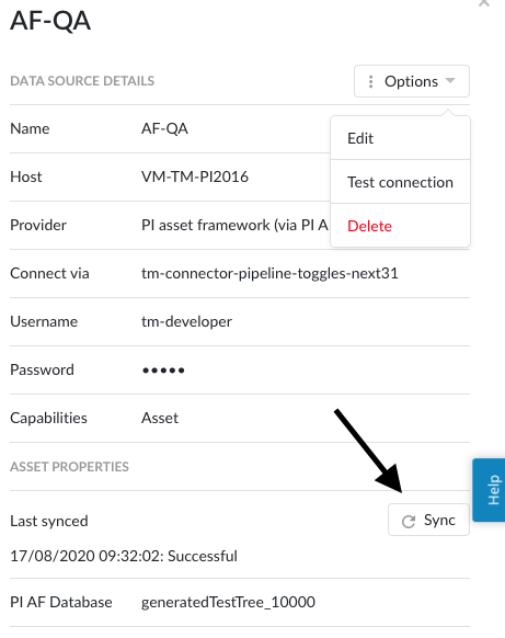

As soon as a new data source is successfully added it will start syncing all the tags from the data source, and can be found in the Data source menu.
To manually synchronise the data source, simply:
Click on the data source of choice within the data source menu. A side panel will appear from the right.
Click on the sync button.
If a data source cannot be synced it will show in the data source list. To learn more about the cause of the failure, open the data source details by clicking on the data source name. The error feedback will be shown under 'Last synced'.
For data sources which are successfully connected the 'Last synced' field in the data source details will show the last synced date and time. The last sync date and time will be updated when a manual sync is triggered or when TrendMiner synchronises the tag cache for that data source, typically during a nightly tag cache refresh.
The status will not automatically update when the page is loaded. Refresh the page or choose the 'Test connection' option (for time series to update the connection status of a data source.
To edit the details of a data source click on its name to open the details and then choose 'Options' -> 'Edit'
It is prohibited to edit the prefix of an existing data source because it would break existing views, formulas, etc. It is also prohibited to edit the 'Connect via'. All other fields can be updated after which the data source is synced again.
Test connection (only for timeseries datasources): this option will test the connection to the data source without triggering a sync and update the health status of the data source.
Delete: this option will remove the data source and all tags from this data source until it is connected again via a correctly configured connector.
When a data source is deleted, all tags from that data source will become unavailable immediately, as well as breaking views and calculations which depend on these tags. It is possible to restore these tags and dependent views and formulas by adding the data source again, using the exact same name and prefix via the same or alternate connector.

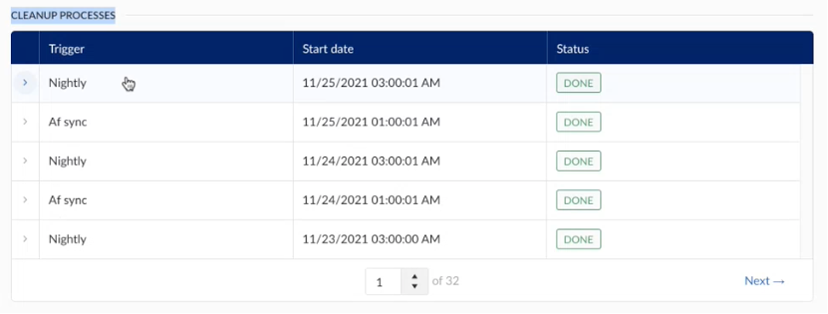

Cleanup Processes
There are two triggers for cleanup processes available, the nightly cleanup process triggered each night at a pre-set time, and an automatic resync of items without a component.
The automatic resyncs are monitored and managed exclusively by ConfigHub administrators, in the "Data source" under the "Settings" option in ConfigHub. Look to the "Data Source" section above.
Nightly sync
The automatic nightly resync of open items will appear in the diagnostics screen as an active job, once it starts. This sync is scheduled in Settings under the Data Section of ConfigHub.
Every night the system will check if there are context items open for more than 24 hours. This means that the context items have a start date present but no end time/date indicated. This implies the context items are still open.
Items open longer than 24 hours may be an indication, that the start event was good, but something went wrong during the closing event, preventing the closure of the context item.
Context items due to be closed will be properly updated as part of the nightly cleanup. If not, the context items will remain open until an end event appears from the source.
A manual cleanup can be triggered from the datasource, under settings in ConfigHub. Look to the "Data source" section above.
