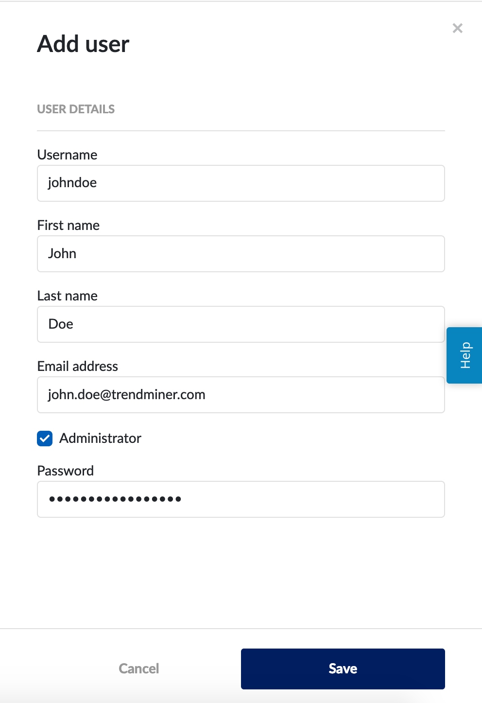

Creating users
  • Contain at least one digit
Configuring User details
From the user overview an user can be clicked to see more detail in the side-panel. Here more options can be performed such as:

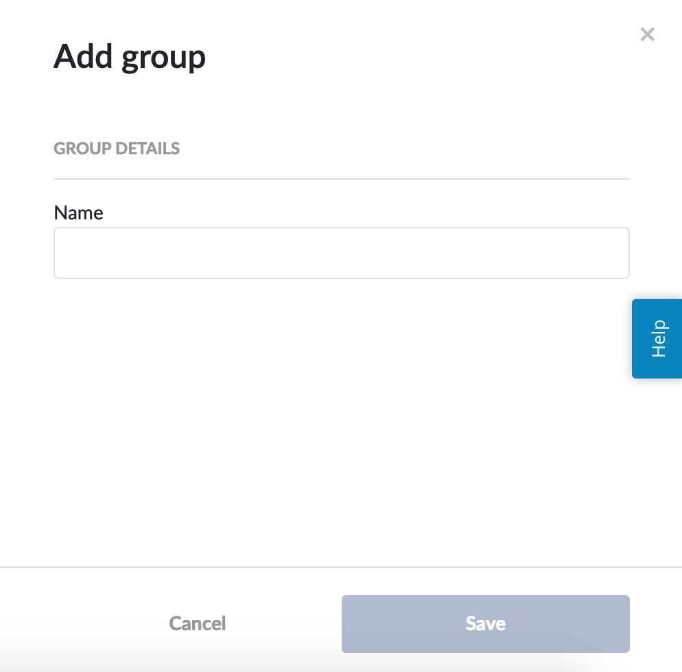

Creating Groups
To create a new group you will need to go to the groups-menu under the "security" section. From there groups can be added via the "+add group"-button.

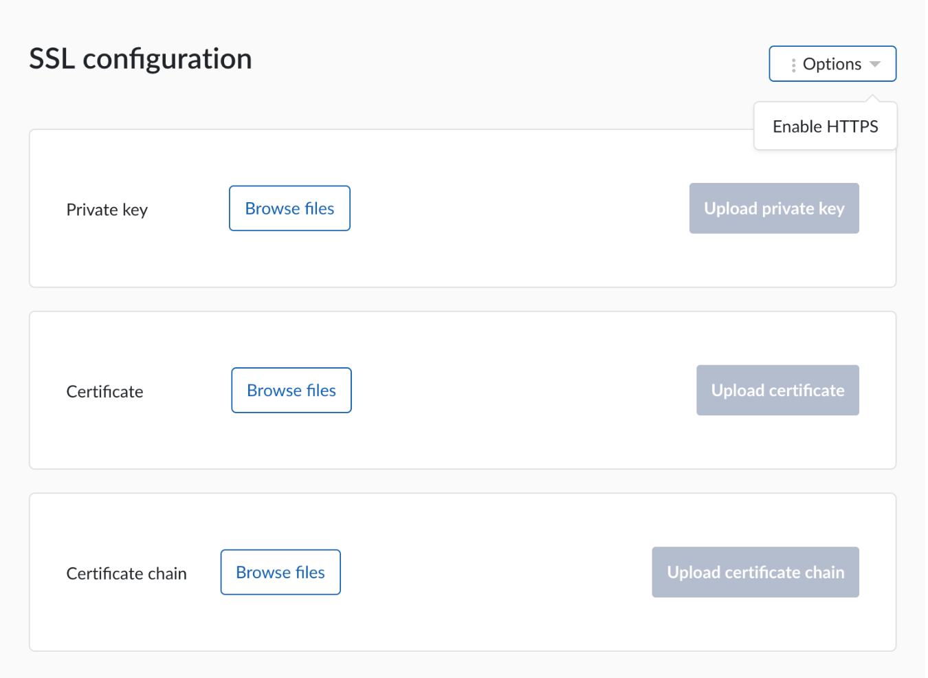

  • Private key
  • CSR for that private key
  • Certificate chain
Generating a CSR is the responsibility of the customer. It's not feasible for TrendMiner to do this.
The web server software (Apache) only supports PEM certificates. OpenSSL can be used to convert certificates in a different format to PEM.
Once these prerequisites are fulfilled, HTTPS can be enabled via the "Options" menu on the top right.
For a more detailed guide of what is, why and how to use SSL in TrendMiner, please look to this document.

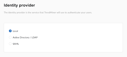

Everyone who needs to access TrendMiner software must be represented as a user in TrendMiner. The identity provider is the service that TrendMiner will use to verify access rights.
By default, user management and authentication is performed by TrendMiner itself, i.e. “Local” identity provider. TrendMiner also supports authentication by an external identity provider. In this case, the credentials are managed and verified by the external IdP: when a user logs onto TrendMiner, the credentials are passed through to the IdP, which then verifies them and sends an access token to TrendMiner to grant access to this user.
Multiple providers can be assigned to one TrendMiner installation.

Create a new user by clicking the (+ Add user) label next to the title and filling in the fields for user details: username and password.
Update an existing user by selecting the user in the table and clicking 'Edit' under the 'Options' menu. With the 'Delete' option the user account can be deleted. When a user is deleted his saved work remains available to other users. The user can be added again to get access again to his work.
Check the 'Administrator' checkbox in the panel to give a user access to the settings menus in the different TrendMiner applications.

Create a new group by clicking the (+ Add group) icon next to the title and completing the group name.
Update an existing group by selecting the group in the table and clicking 'Edit' in the options menu. With the 'Delete' option the groups can be deleted.

  • Private key
  • Certificate chain
Enabling HTTPS will temporarily render ConfigHub unusable until the service restart has completed. A manual refresh of ConfigHub is necessary. Press F5 to try to load the interface again. Retry until this succeeds.

Everyone who needs to access TrendMiner software must be represented as a user in TrendMiner Security. The identity provider is the service that TrendMiner will use to verify access rights.
TrendMiner supports switching to authentication by Active Directory/LDAP. When TrendMiner is configured to use AD/LDAP authentication, the credentials are managed and verified by Active Directory. When a user logs onto TrendMiner, the credentials are passed through to the Active Directory, which on verification of the credentials sends an access token to TrendMiner, to grant access to the user. In this scenario, TrendMiner will sync user metadata from the Active Directory to TrendMiner Security. You do not have to add users manually.

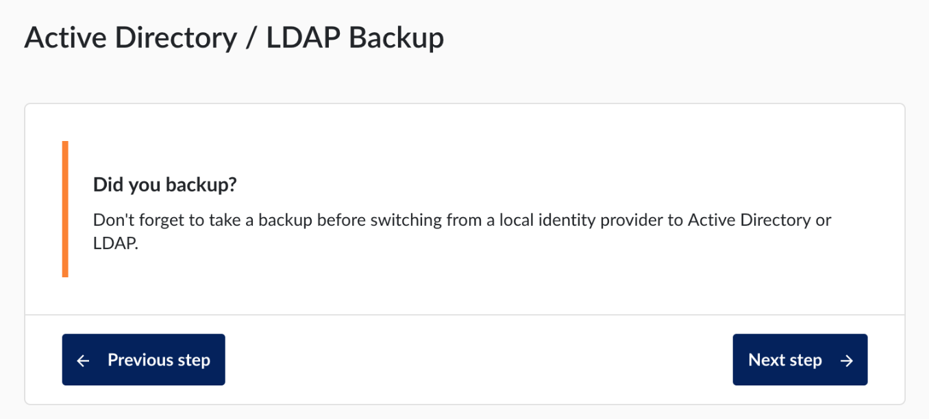

Backup
When switching from local to AD/LDAP authentication, TrendMiner will configure the various components for this new authentication method. After the configuration and initial mapping is complete, you will not be able to change the authentication method back to Local. TrendMiner user-accounts which have not been mapped to an AD/LDAP-account will be deleted. Mapped users will no longer be editable in ConfigHub, with the exception of the admin flag, which means it is still possible to give a TrendMiner user admin rights or take away his admin rights when the AD/LDAP is active.
We highly recommend you to take a backup in case of issues during the switch, we can support you in reverting to the application state at the moment of the backup.

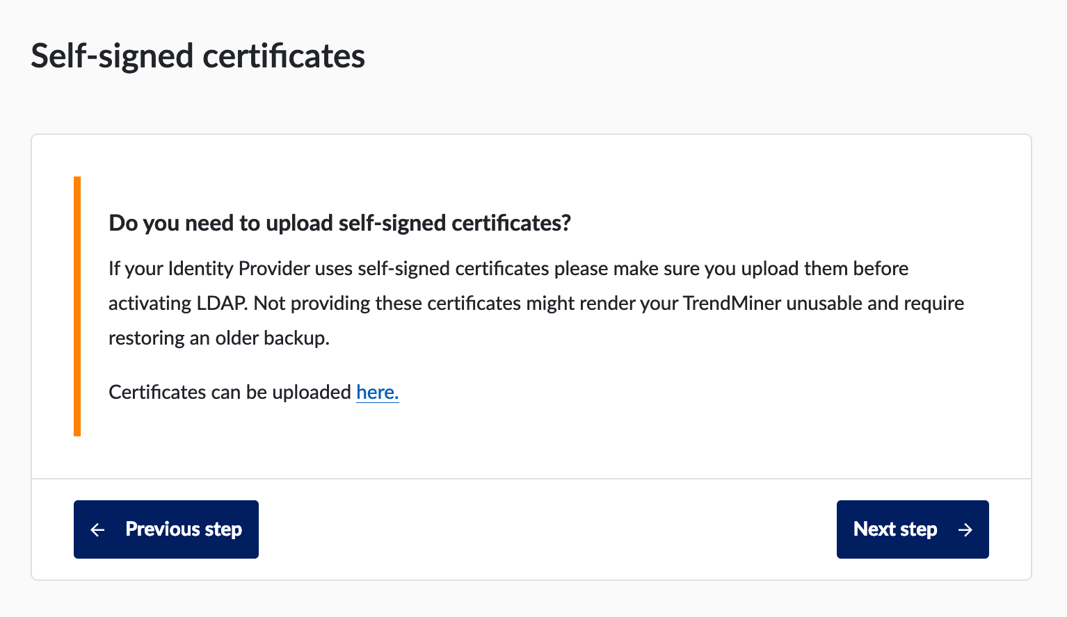

Self-signed certificates
More info on self-signed certificates can be found under the 'Certificates' menu.

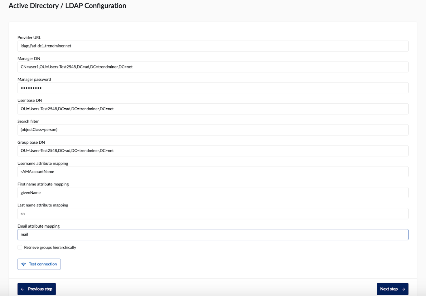

Connect to AD/LDAP
The following attributes have to be configured to allow successful integration with AD/LDAP:
  • Provider URL: The hostname of the LDAP server, including the protocol ldap://
  • Manager DN: The user that lists the users that will receive access to TrendMiner, must have query permissions on this server. It can be specified by full DN or by domain\user notation. Typically a ‘service’ account with a password that does not expire is used.
  • Manager password: Password of the user.
  • User base DN: The DN of the starting point of tree walking for users. All users must be descendants of this node.
  • Search filter: Filter to restrict the users that are permitted to access TrendMiner eg. objectCategory=Person will select all users.
  • Group base DN: The DN of the starting point of tree walking for groups.
Groups can be used for permission management in TrendMiner. This does not influence which users are allowed access.
  • Username attribute mapping: The name of the attribute that represents the username of the user.
  • First name attribute mapping: This attribute points to the user's first name.
  • Last name attribute mapping: This attribute points to the user's surname or last name.
  • E-Mail attribute mapping: Mail address of the user.
  • Retrieve groups hierarchically: Enable to descend the tree for groups starting at the Group base DN.
Click “Test Connection” to verify that the supplied attributes result in a successful connection to your AD/LDAP server.
Click “Save” to save the changes to your configuration.
You can click on 'User' menu to see the list of users granted access to TrendMiner. The 'group' menu will be grayed out.
We highly recommend that you create a separate AD/LDAP-group for TrendMiner users such that only the users that you really want to grant access to TrendMiner are being synced to TrendMiner.

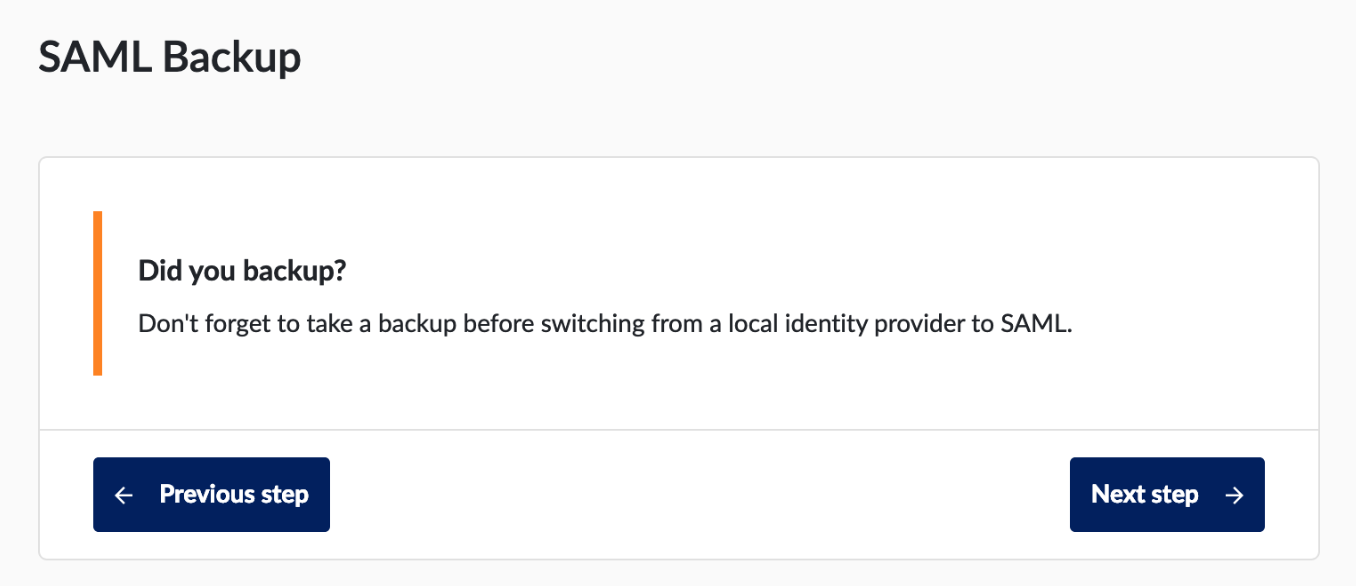

Backup
When switching from local IdP to SAML IdP, TrendMiner will configure the various components for this new authentication method. After the configuration and initial mapping is complete, you will not be able to change the authentication method back to Local.
TrendMiner user-accounts which have not been mapped to an external-account will be deleted. We advise you to take a back-up in case of issues that may arise during the switch, we can support you in reverting to the application state at the moment of the backup.

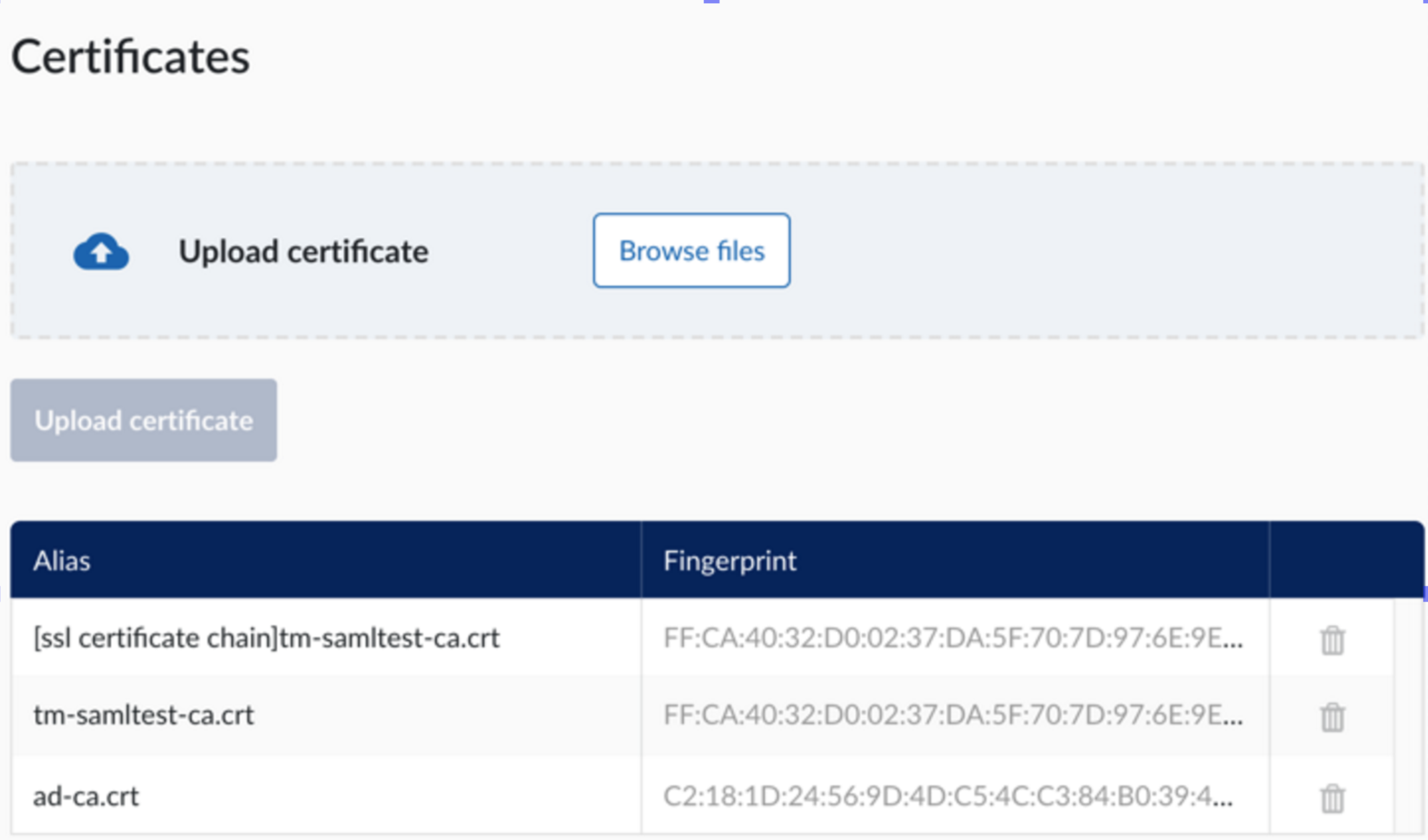

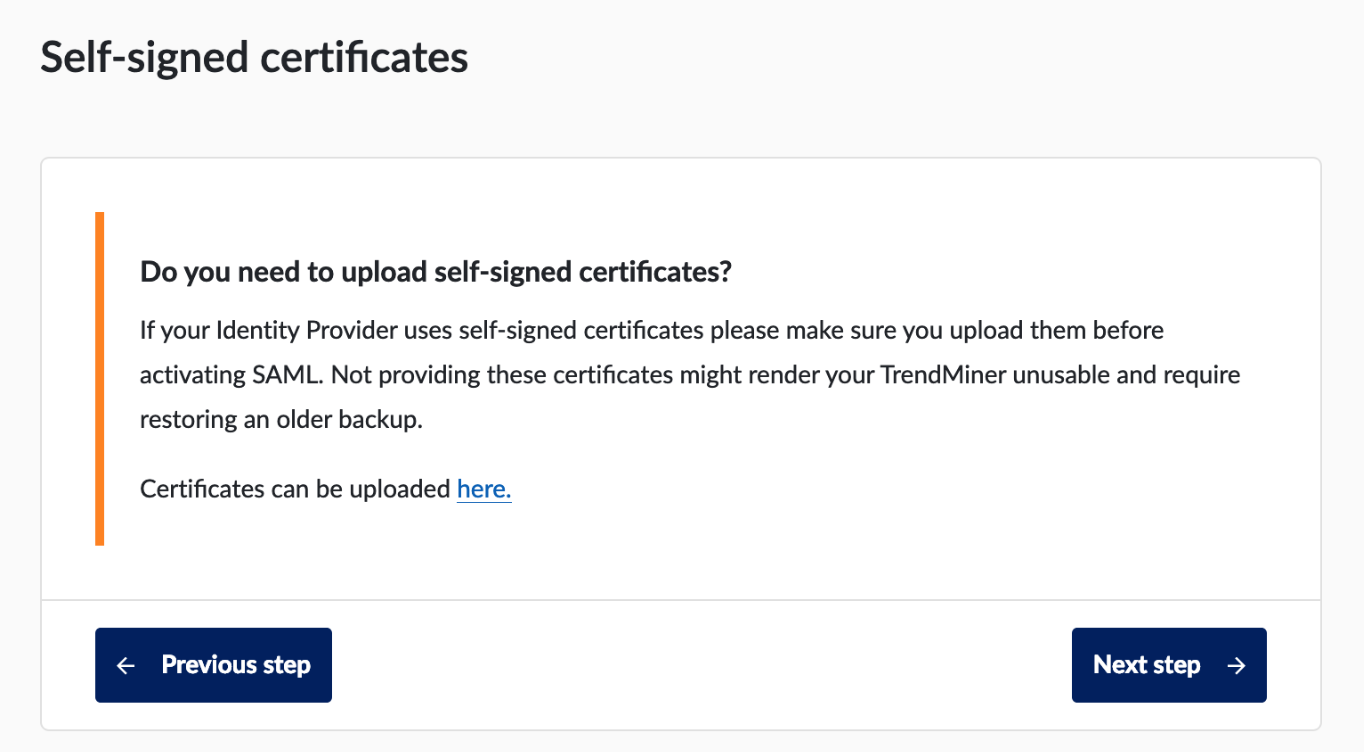

If your Identity Provider uses self-signed certificates please make sure you upload them before activating SAML. Not providing these certificates might render your TrendMiner unusable and require restoring an older backup.
Click on the "here" link to open the ConfigHub certificates menu where you can upload your self-signed certificates.
Choose certificate file and click on 'Upload Certificate'. Upload all the certificates needed to establish trust from the root CA to the certificate used by the IdP.

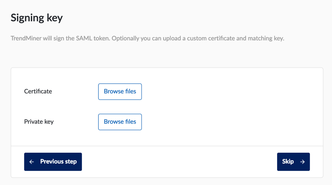

Signing key
If the IdP administrators have chosen to configure their IDP very strictly, and they prefer the use of a certificate/key pair issued by them instead of the one auto-generated by TrendMiner, they can be imported in the next optional step.

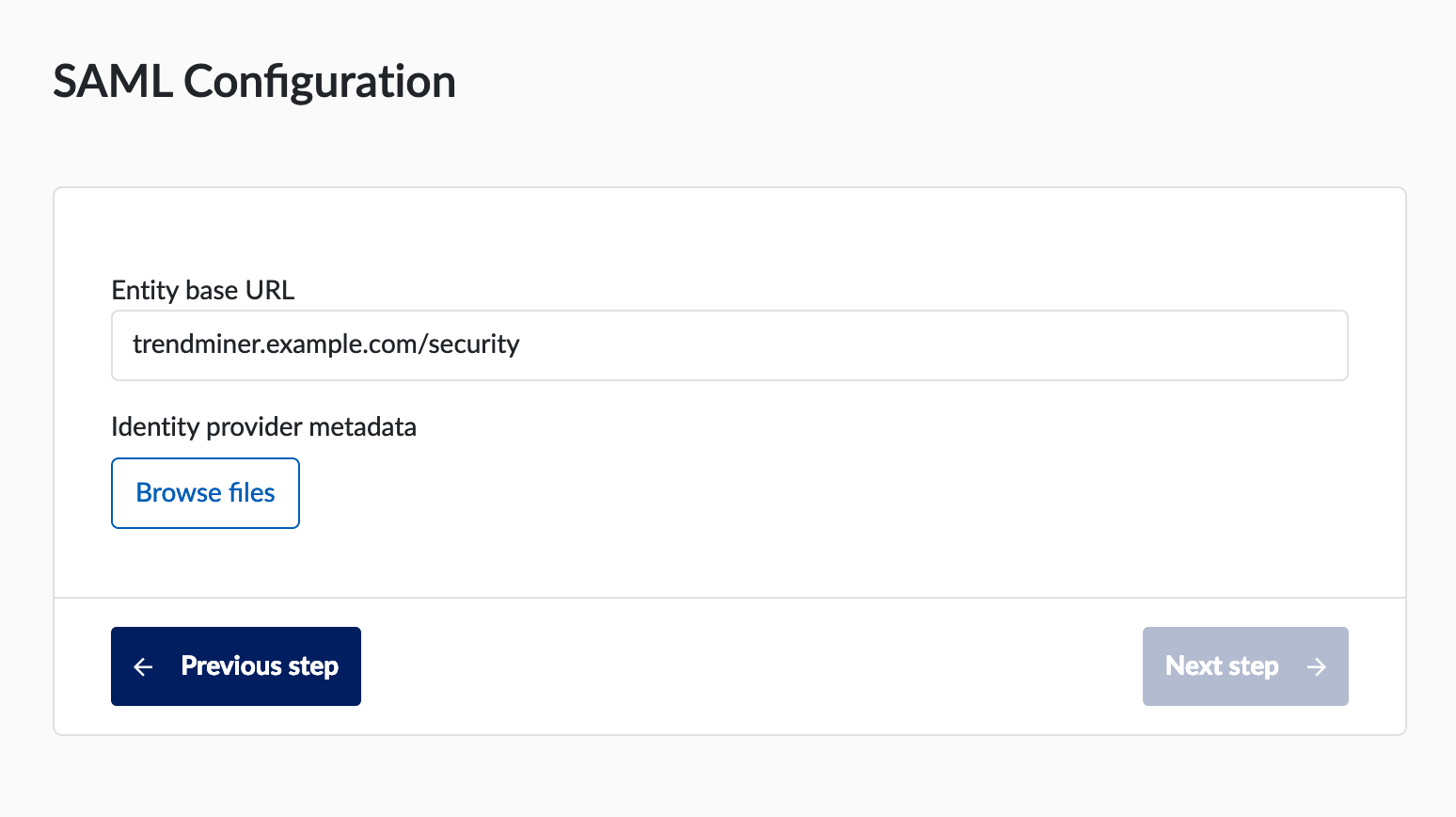

The following attributes have to be configured to enable successful integration with an external SAML Identity Provider:
  • Entity Base url: The entity base URL defines the access point of the TrendMiner security application, i.e. -> TrendMiner domain>/security.
From this URL two properties are derived, which should be configured in your IdP: the entity id, which is an identifier for the TrendMiner service provider: {entityBaseUrl}/saml/metadata and the Single Sign-On URL, which defines the entry point for redirecting after a successful login.
  • Identity provider metadata: Upload an XML file containing your SAML IdP's metadata. Your IdP’s documentation will guide you to provide metadata to a service provider. It will instruct you to download a metadata file, or it will display XML code that you can copy and paste into a new text file and save with an .xml extension.
In case an AuthnStatements is included in the SAML response from the IdP, an audience restriction should be included in the response as well, as required by the SAML library which is used by TrendMiner (https://projects.spring.io/spring-security-saml/).
Click “Next step” to save the changes to your configuration and continue.
