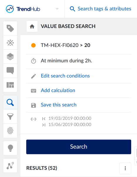

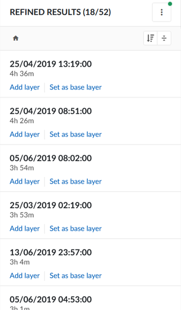

Run you search for the events

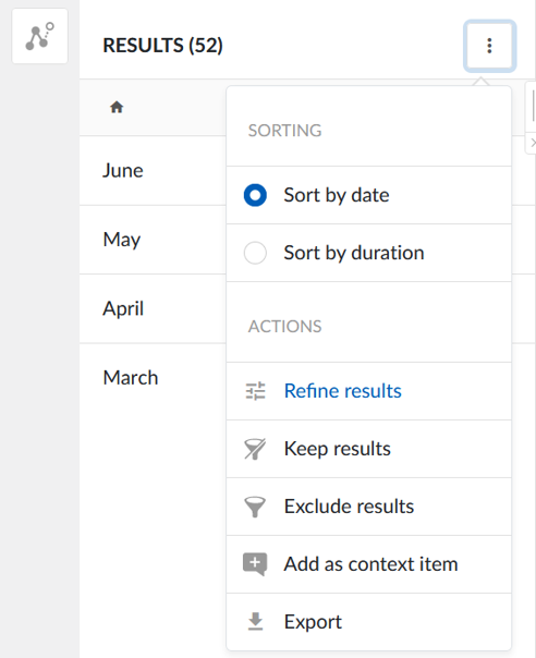

Open the search option and start to refine results

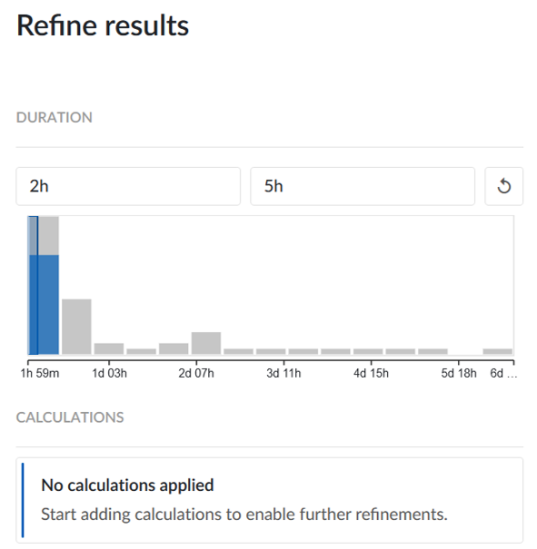

Type in or select you lower and upper duration limit of interest
The refined results list should show
Search for the events with the longer duration of 5 hours.

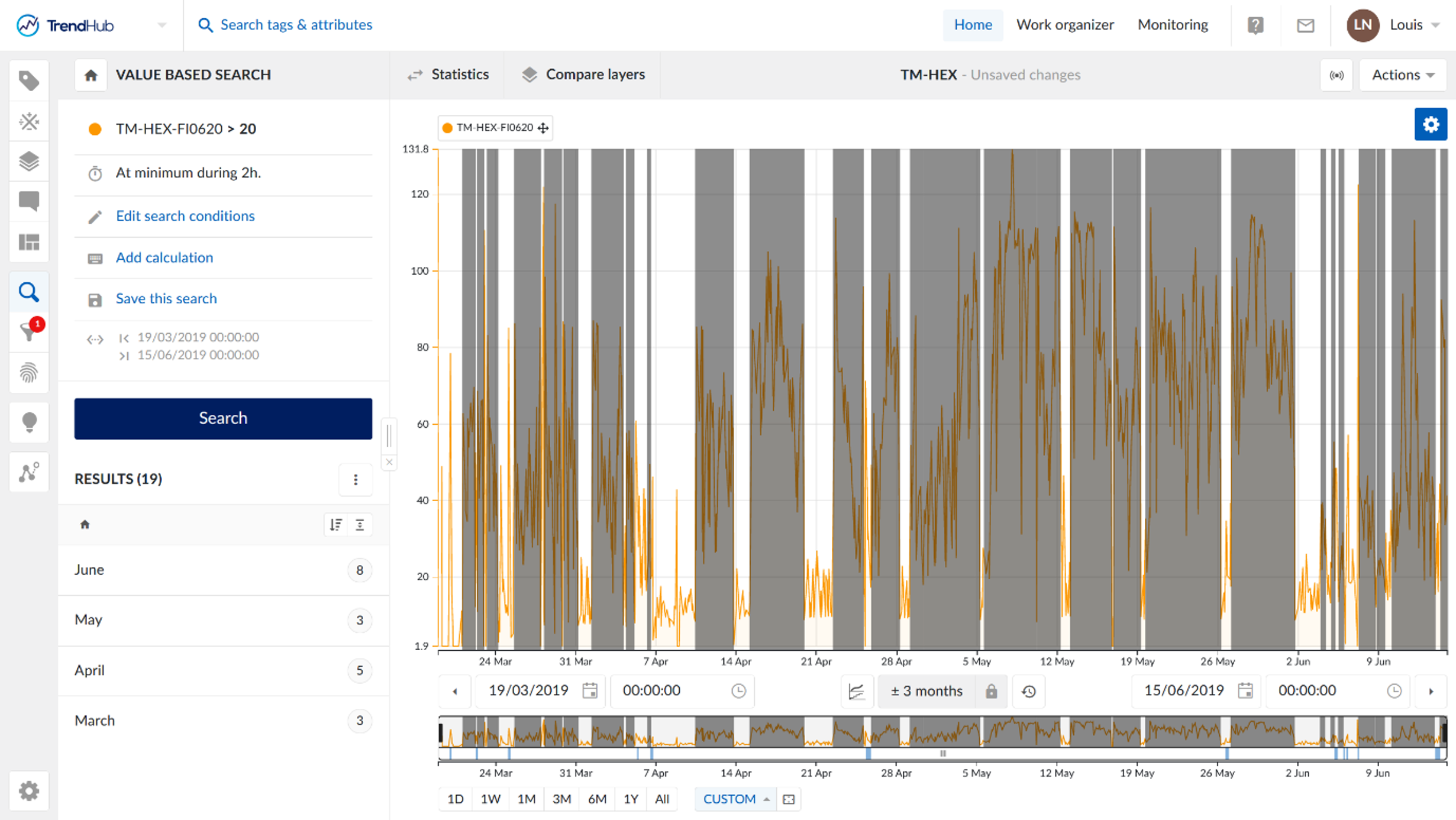

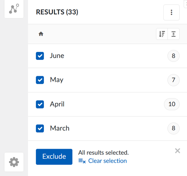

Create a static filter excluding the results with a duration higher than 5 hours.

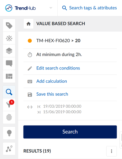

Edit the search conditions and set the minimum duration to the lower duration limit of 2 hours.
Now, you see only search results with a duration between 2 and 5 hours.
