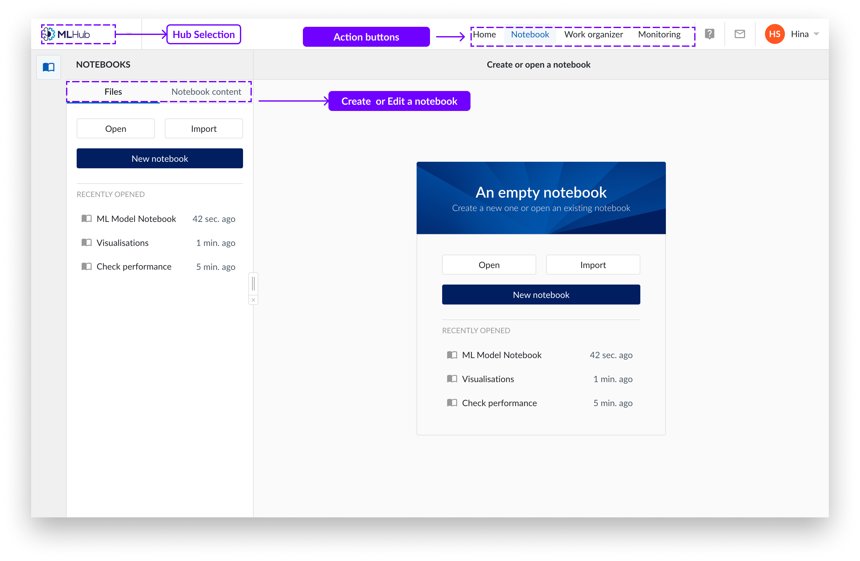

In the top left corner of the TrendMiner environment you find the Hub selection button. Here you can select the hub you want to navigate.
Click on the "MLHub" button. To close the home screen and access the “Files” or “Notebook content”, click on them. “Files” allow you to create, open or import notebooks. “Notebook content” allows you to edit notebooks.
The top bar allows you to go back to Home, Notebooks, Work Organiser and Monitoring.

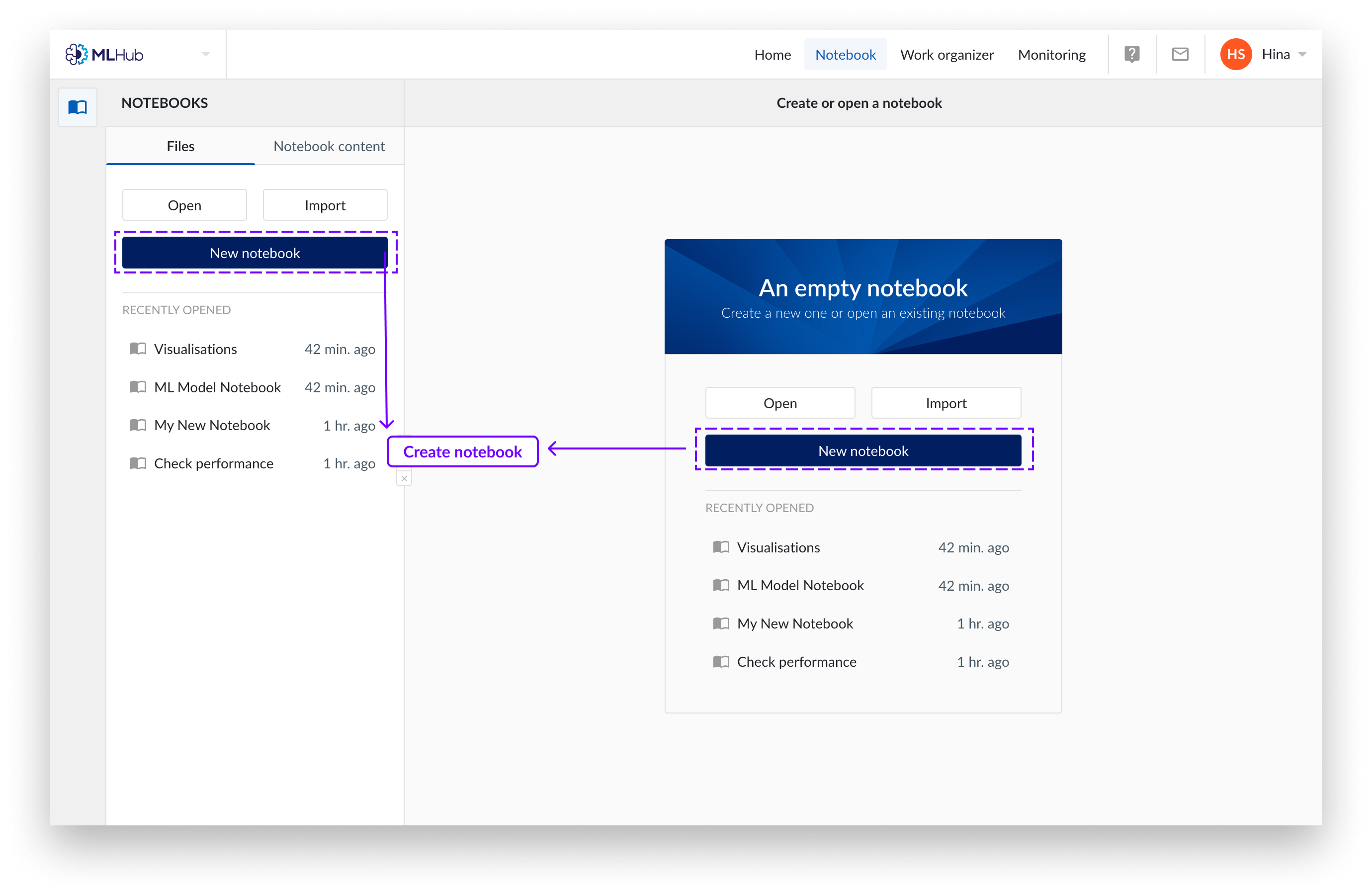

On the Notebook tab of MLHub, you can either create a new notebook, load or import an existing note. A new notebook will always be empty.

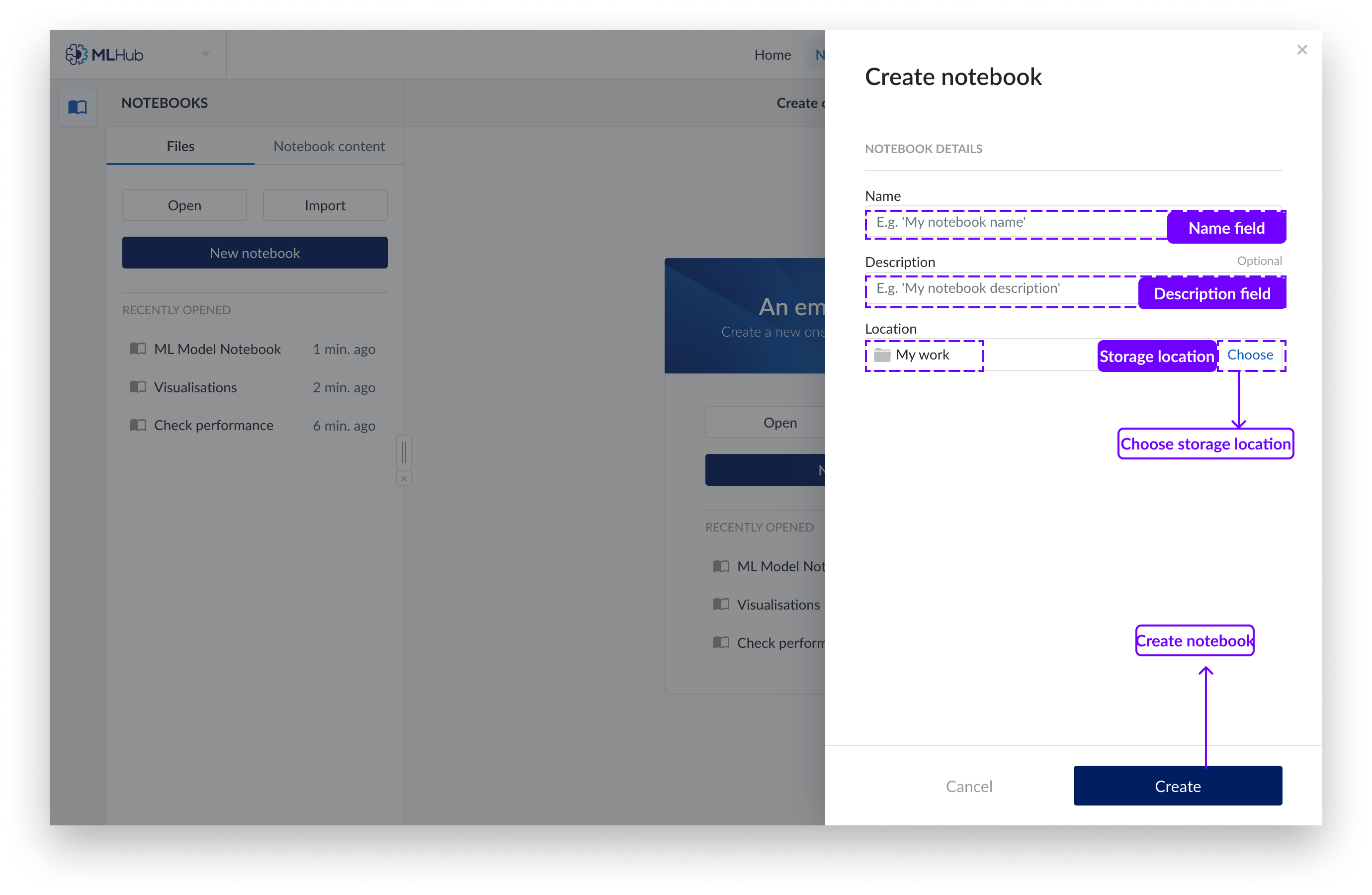

  1. Click on the Files Tab of MLHub.
  2. Click on  “New notebook”.
  3. Populate the open fields and select a work organizer folder to store your new notebook.
  4. Click on the "Create" button.

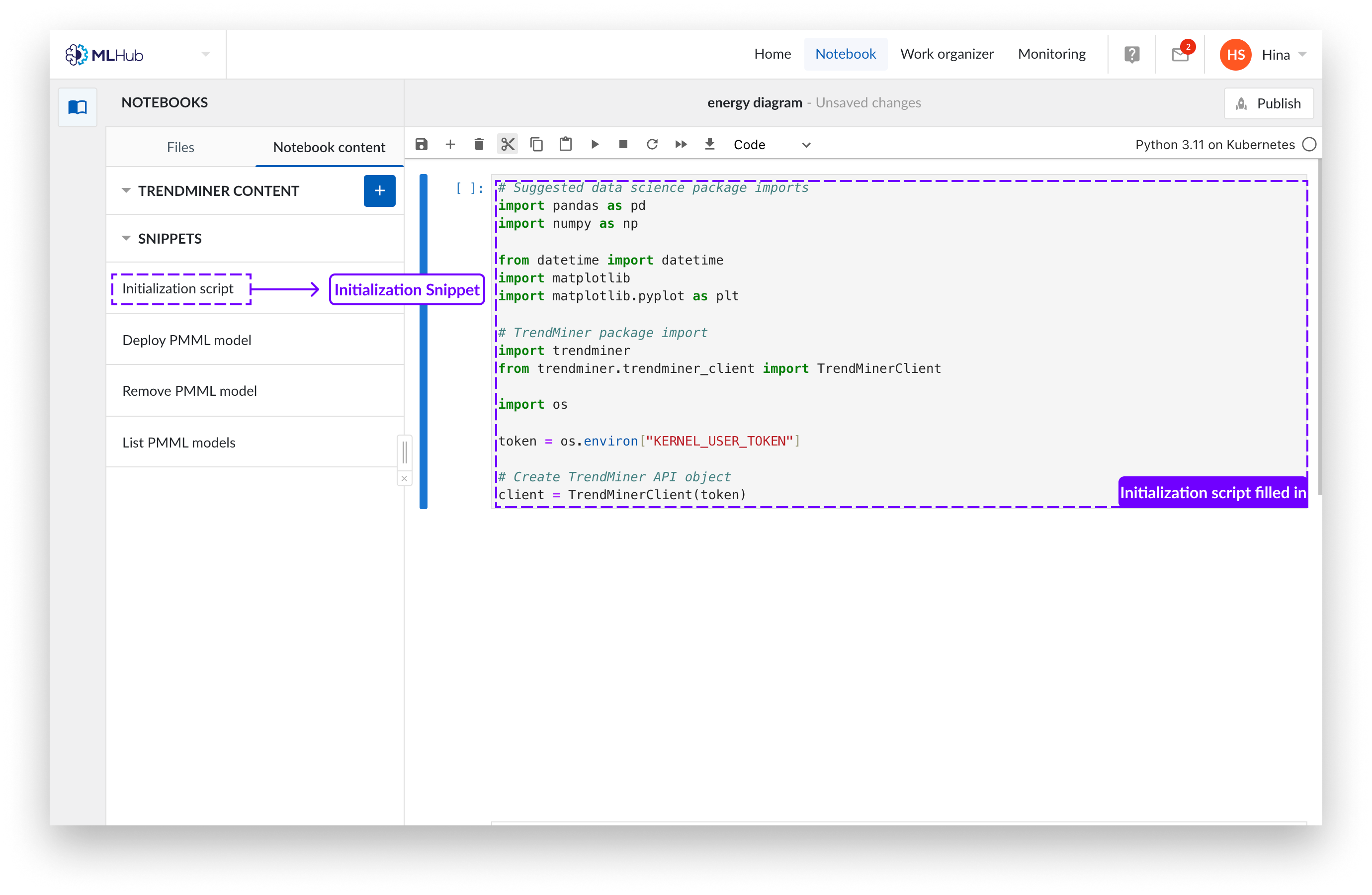

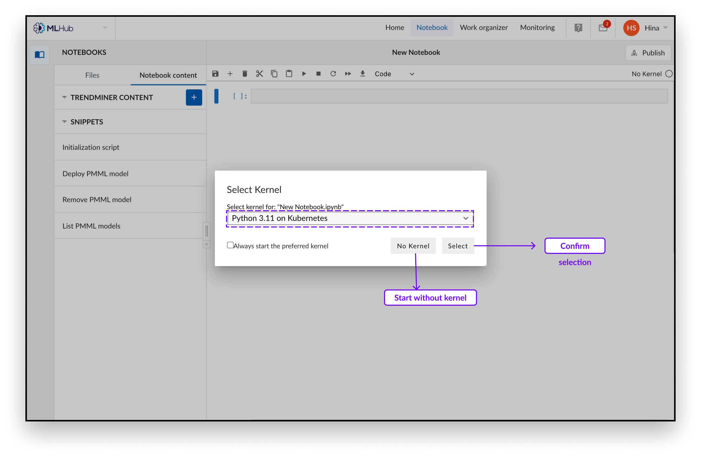

  5. You will now enter “Notebook content” mode with code snippets in the left, side panel. These are predefined code blocks to use in your notebooks. See “code snippets” below for more details.
  6. Choose the kernel configuration you would like to launch. We offer kernels including preinstalled visualization packages. We recommend you launch with the “Python 3.11 on Kubernetes” kernel.
  7. Confirm your selection by clicking “Select”.
You can now write your python code in the created notebook. You may like to introduce our boiler-plate code which loads highly recommended packages, as you will need it to read in the TrendMiner content. You can add this code by clicking the snippet button  “initialization script” from the snippet menu on the left.

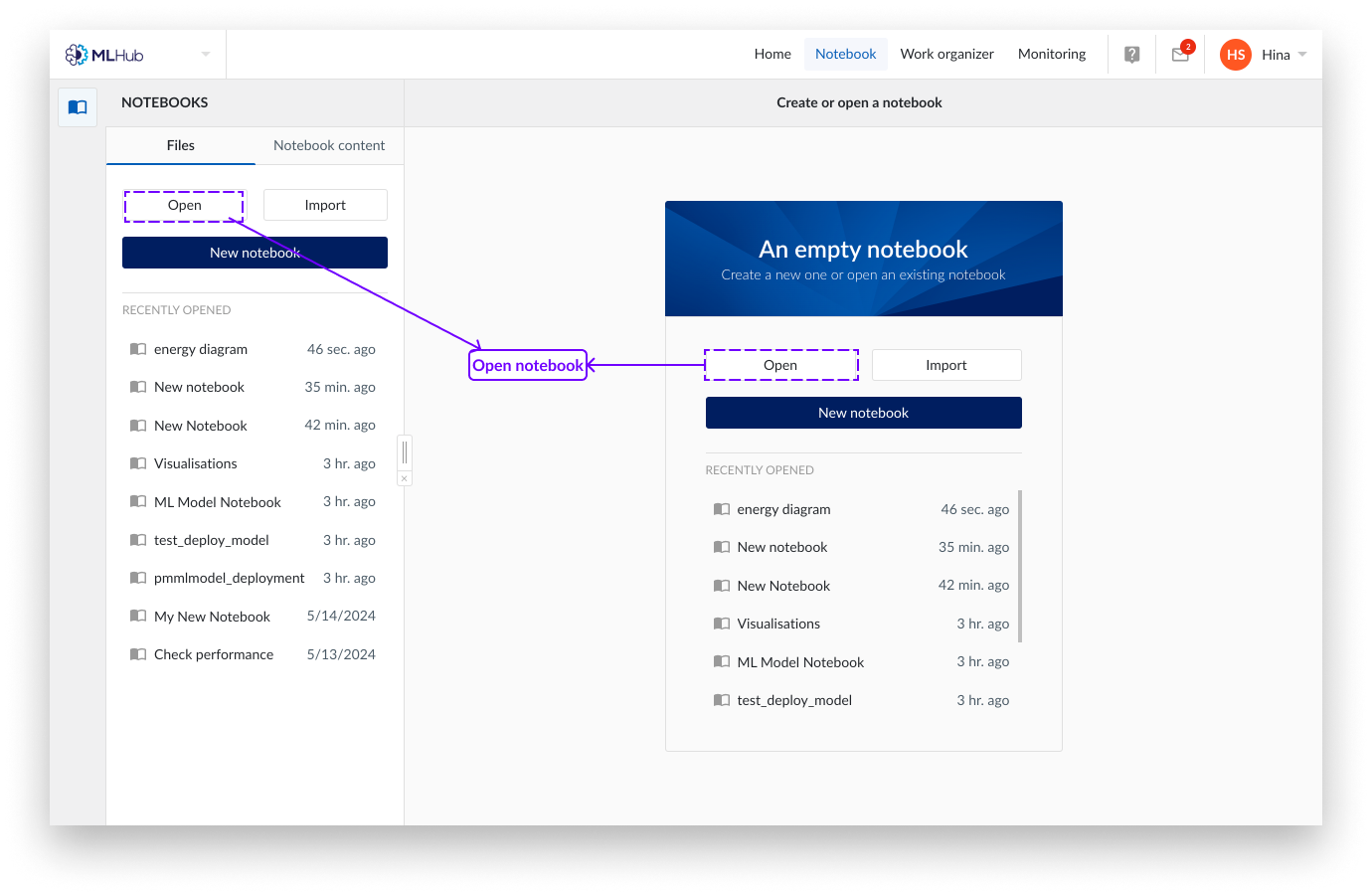

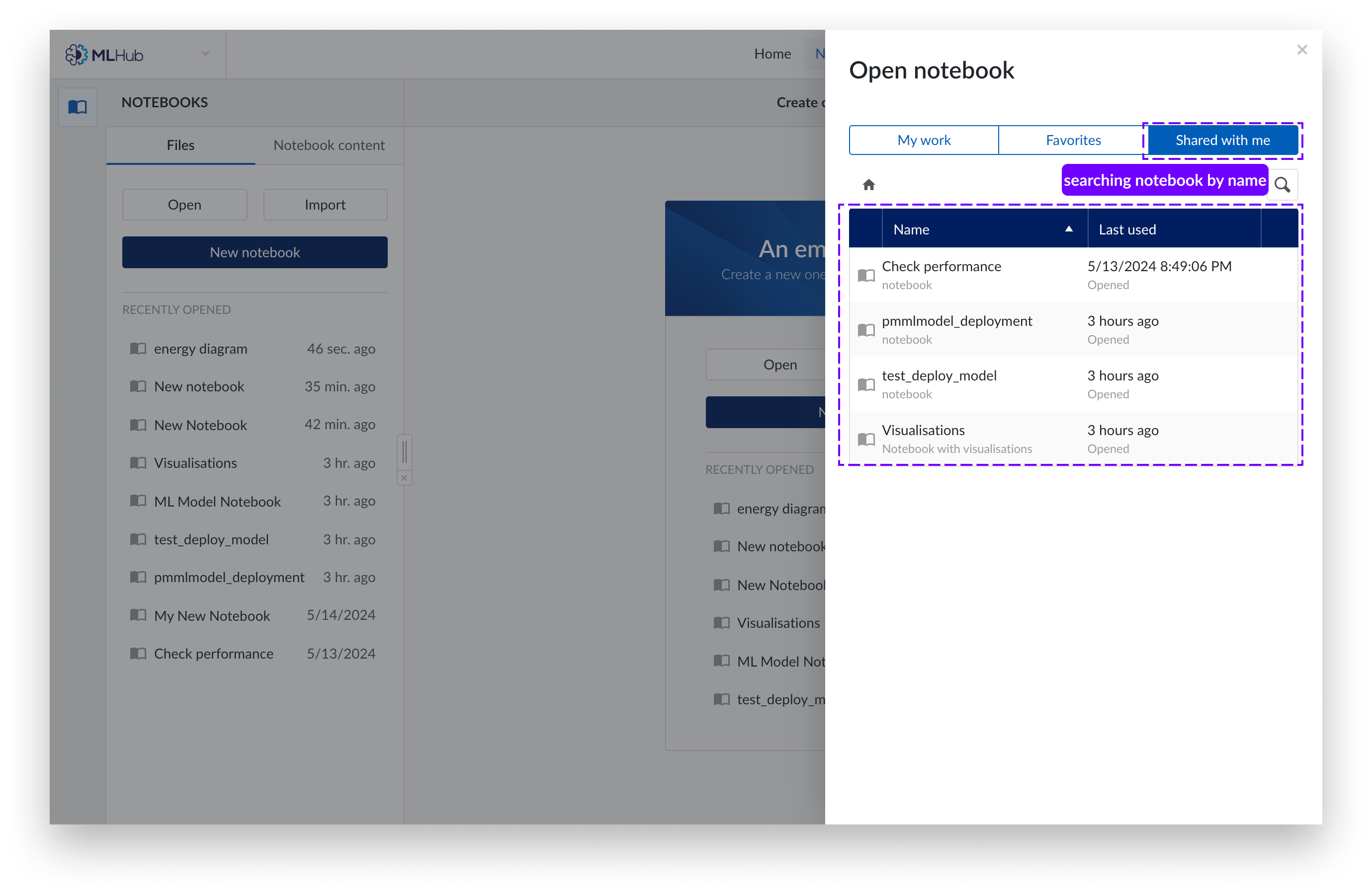

Opening a Notebook
  1. Click on the “Files” Tab of MLHub.
  2. Click on  “Open”.

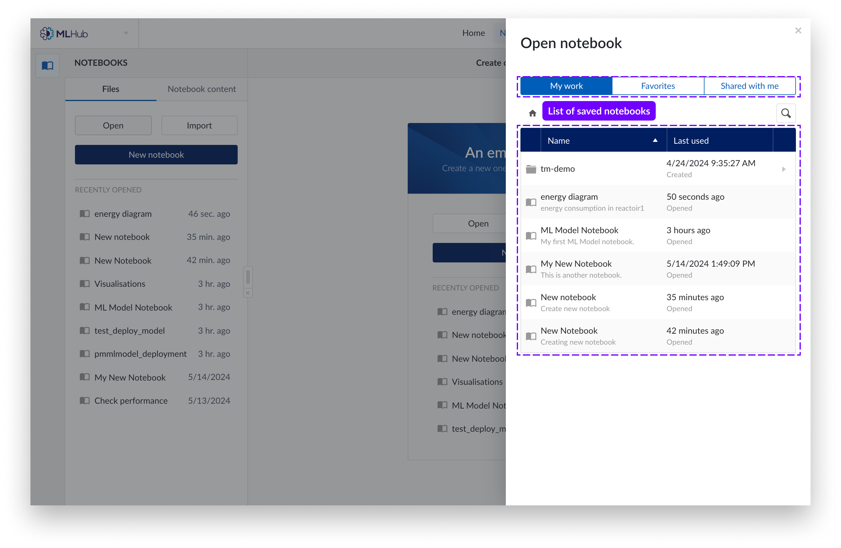

  3. You can now view your notebooks in “My Work” or  “Favorites” . Click the notebook you want to open.
  4. You may also access notebooks shared with you by other users in “Shared with me” .

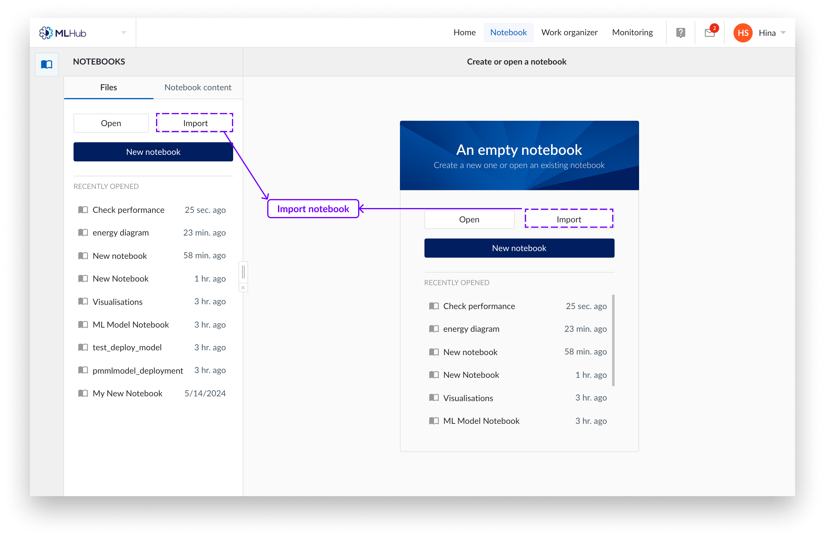

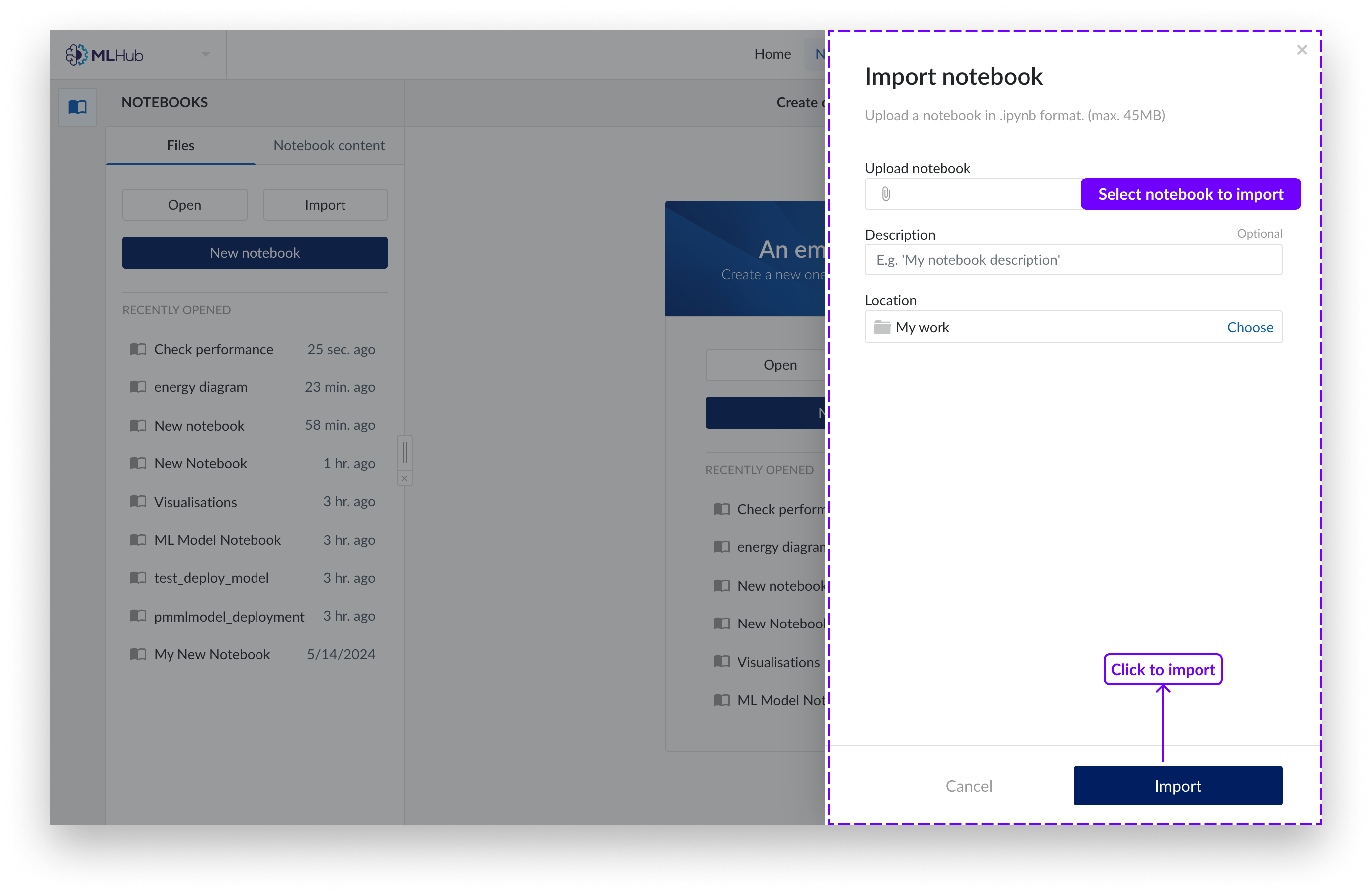

  1. Click on the “Files” tab of MLHub.
  2. Click on the "Import" button.
  3. A panel appears from the right of the screen. Choose to upload a notebook with your local file browser system or choose to use the work organizer. Only Jupyter notebooks (file extension .ipynb) are supported.
  4. Select "Import".

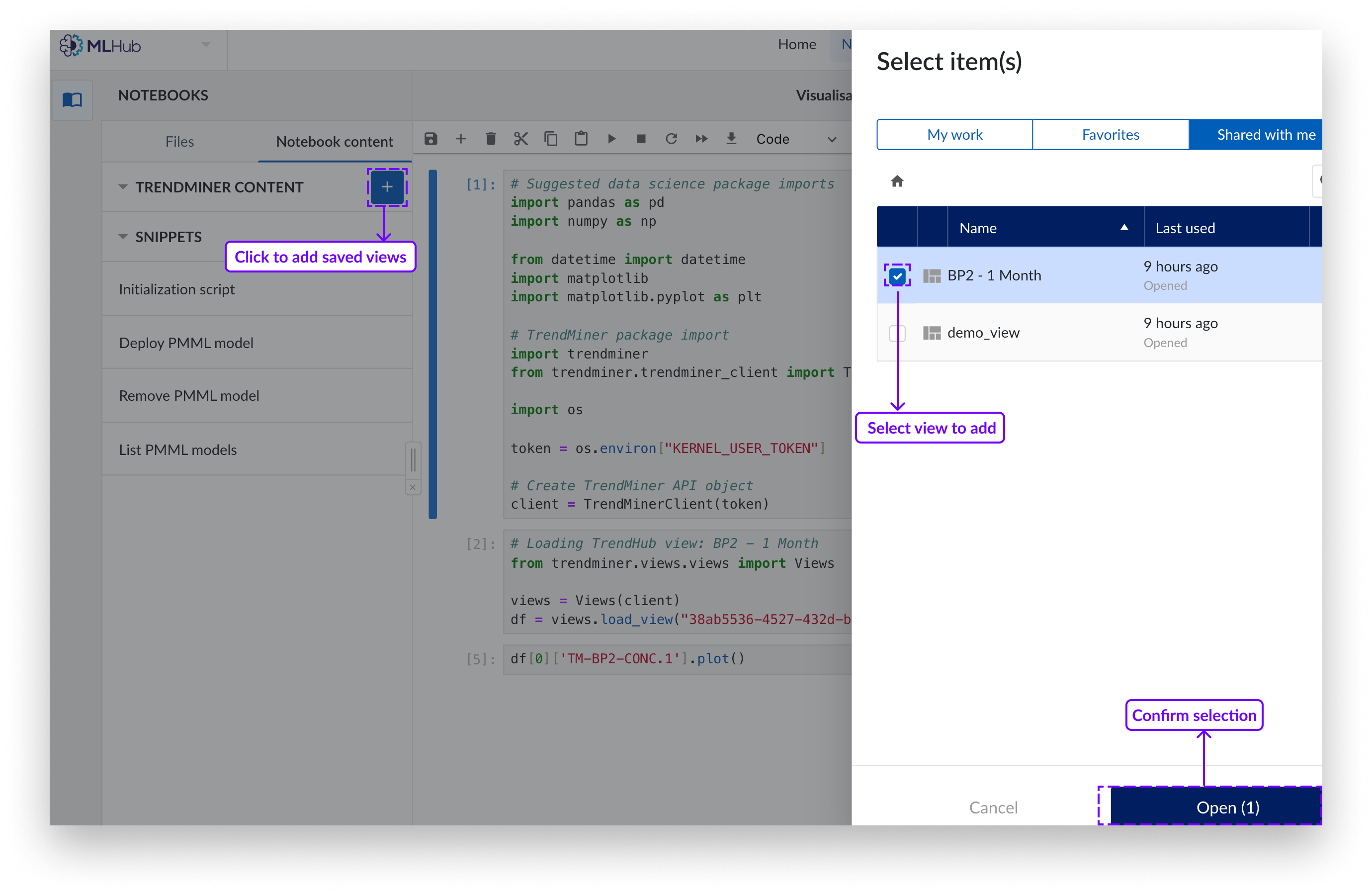

You can load TrendHub or ContextHub views, for example, of good and/or abnormal operation periods and compare them using advanced analytics, add them to your TRENDMINER CONTENT list.
  1. Click on the blue “+" button. A side panel will appear from the right.
  2. Select the saved view item(s) you wish to add as a dataset.
  3. Click "Load".
Items in the content menu list can be either opened or deleted. To delete click on the "x in the menu located on the right of the item to be deleted.
  • Click on the new content to open. This will add the relevant python-code into a new cell at the end of the Notebook.

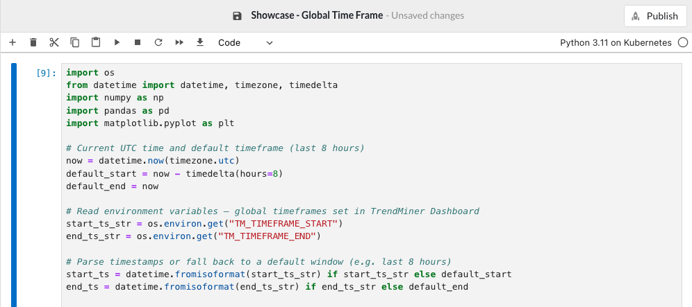

Use os.environ.get() to safely read the variables. Always provide a sensible fallback in case the notebook is run outside of a dashboard context.
The environment variables are only set when the notebook is triggered from a dashboard tile that has a global timeframe configured. When opening a notebook directly in MLHub, or when no global timeframe is set on the dashboard, TM_TIMEFRAME_START and TM_TIMEFRAME_END will be NONE. Always handle this case with a fallback in your code (see examples below). The timeframe is also fixed for the lifetime of the kernel, it will not update automatically if the user changes the dashboard timeframe. It will on refresh of the dashboard
Example:
import os
from datetime import datetime, timezone, timedelta
import numpy as np
import pandas as pd
import matplotlib.pyplot as plt
# Current UTC time and default timeframe (last 8 hours)
now = datetime.now(timezone.utc)
default_start = now - timedelta(hours=8)
default_end = now
# Read environment variables — global timeframes set in TrendMiner Dashboard
start_ts_str = os.environ.get("TM_TIMEFRAME_START")
end_ts_str = os.environ.get("TM_TIMEFRAME_END")
# Parse timestamps or fall back to a default window (e.g. last 8 hours)
start_ts = datetime.fromisoformat(start_ts_str) if start_ts_str else default_start
end_ts = datetime.fromisoformat(end_ts_str) if end_ts_str else default_end

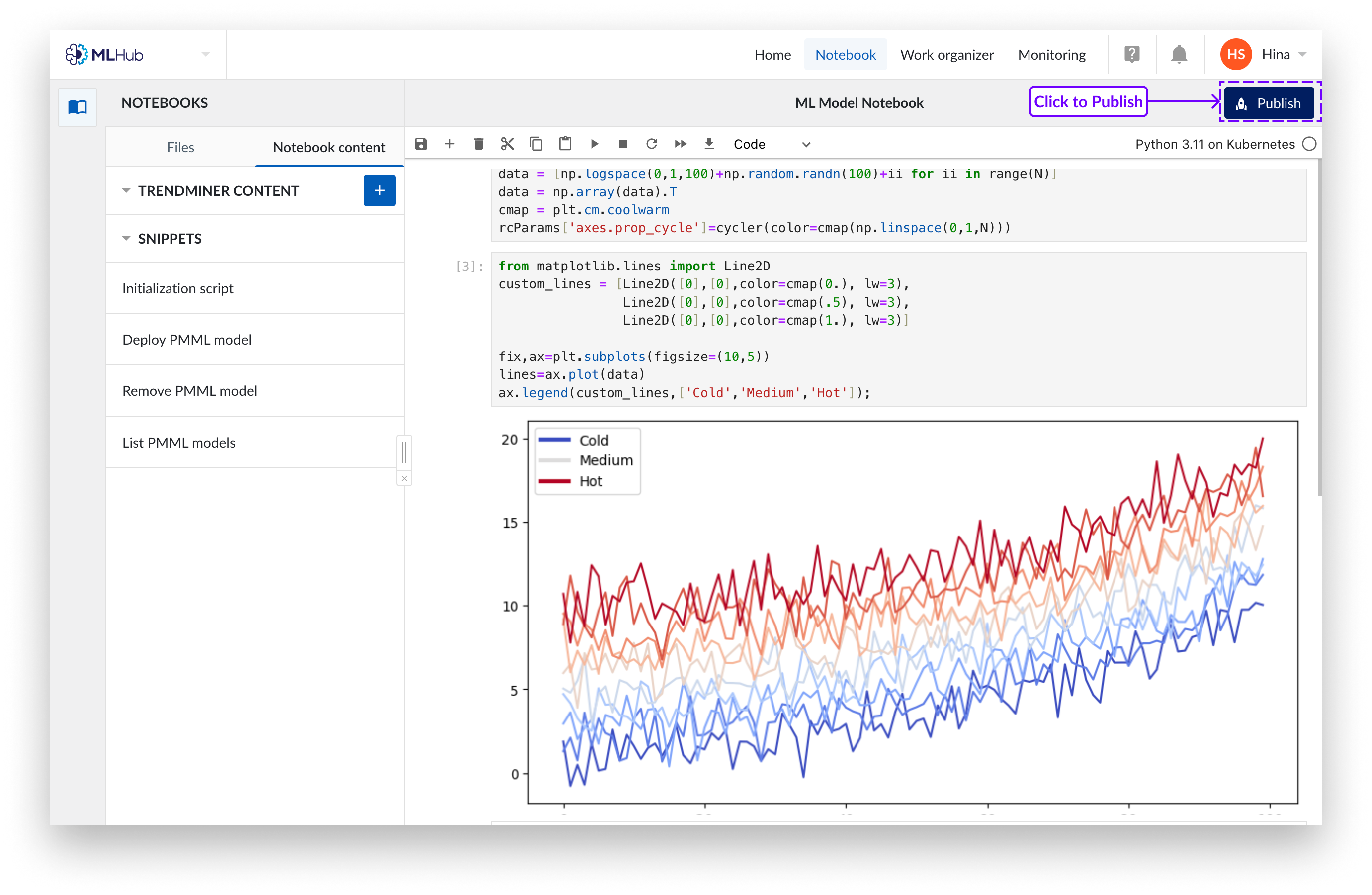

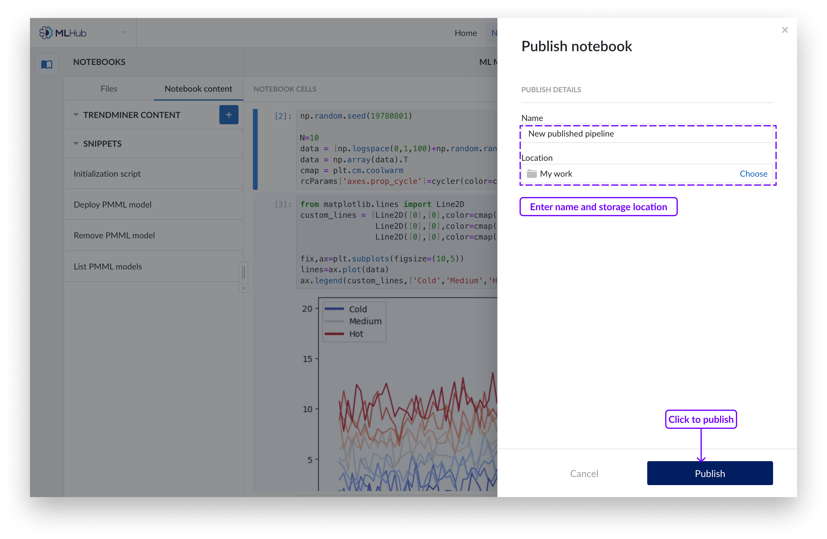

If you have a notebook output cell with an interesting result or visualization you want to share, you can publish it into a notebook pipeline object.
Steps:

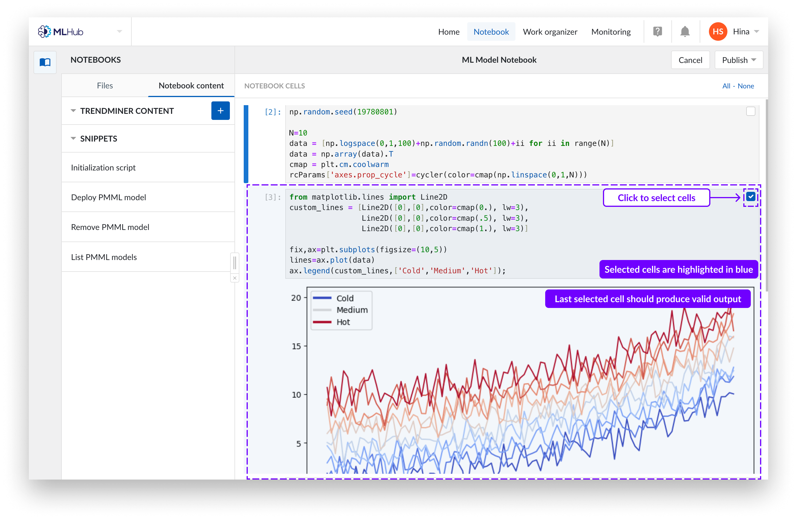

  1. Click the ‘Publish’ button in the top right corner.
  2. Select ALL cells that are relevant for the output you want to publish, including ‘import’ statements and variable declarations. Make sure the last selected cell produces valid output. You can select a cell by clicking anywhere on it, or use the checkboxes in the top right corners.

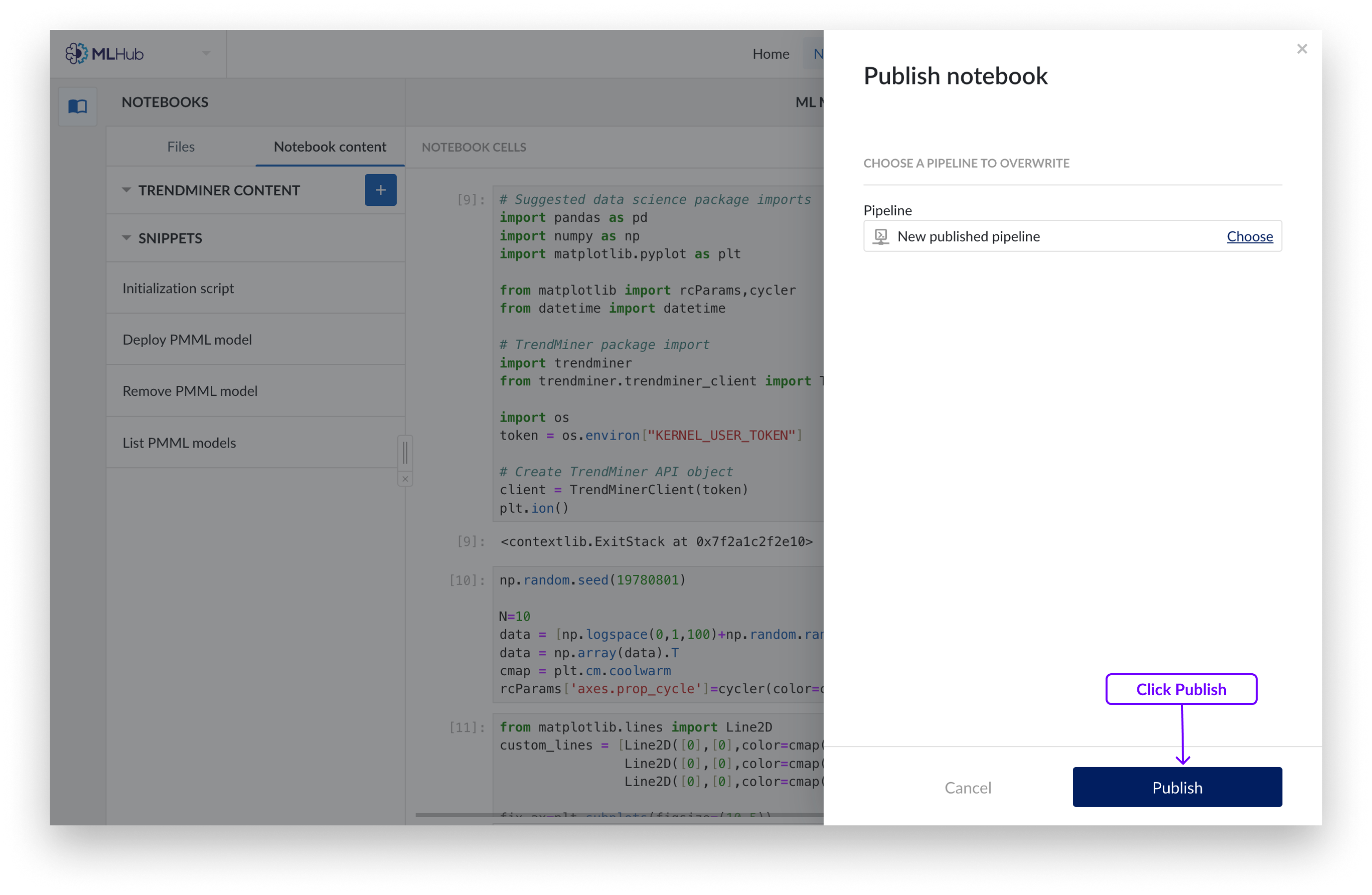

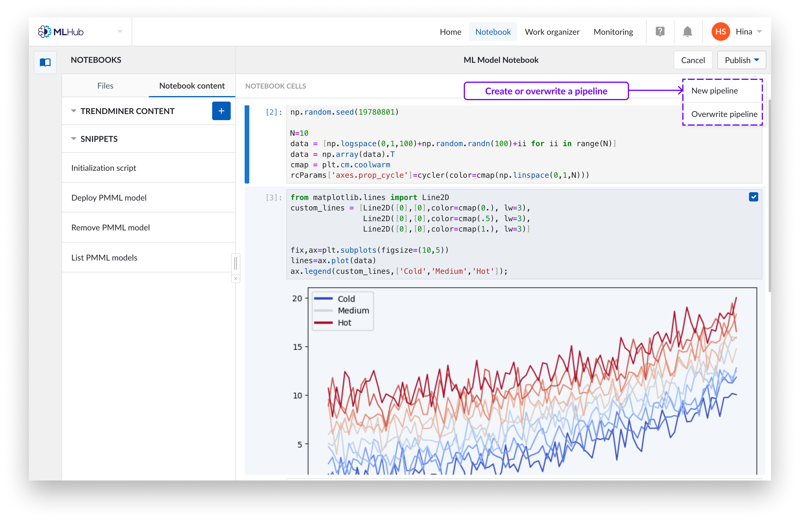

  3. Click ‘Publish’ again. You will see a dropdown to publish the notebook on a new pipeline or overwrite on an existing pipeline.
  4. To publish notebook on a new pipeline, fill in the name and specify storage location in the Work Organizer. Click “Publish” to confirm selection. This will create a ‘pipeline’ object, which is a mini notebook containing only the selected cells. Pipelines have no relation to their original notebooks, they are a separate entity.

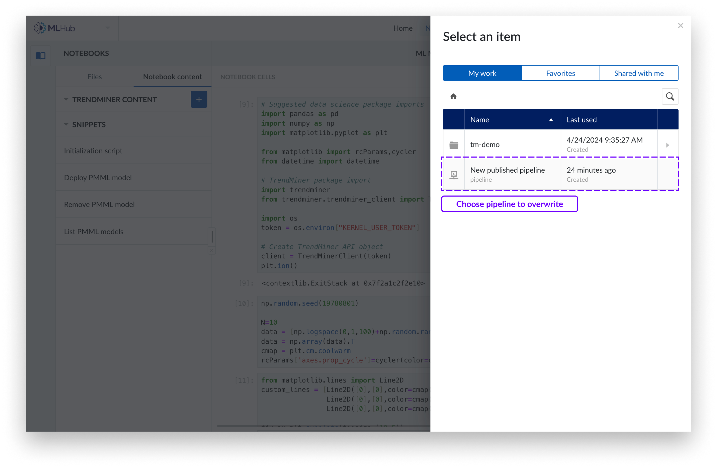

    If you update a notebook, you will have to create a new pipeline object as well.
  5. If you want to overwrite an existing pipeline choose the pipeline from the Work Organizer that you wish to overwrite and click ‘Publish’.
  6. You will now have a pipeline object containing the code of the cells you have selected.
