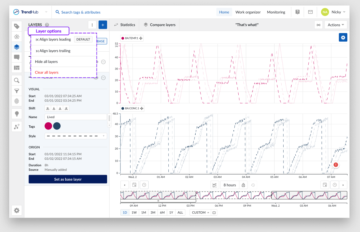

On the layers menu you have several options.
  • Align layers leading: With this option, which is selected by default, all active layers will be aligned with the same starting point.
  • Align layers trailing: This option will align the end points of all the active periods.
  • Hide all layers: The hide option will hide all layers except for the base layer.
  • Clear all layers: With this option, all layers except for the base layer will be removed. This action cannot be undone.
  • Exception: If a view is saved, unsaved changes will be triggered. The "discard changes" option can restore the deleted layers.

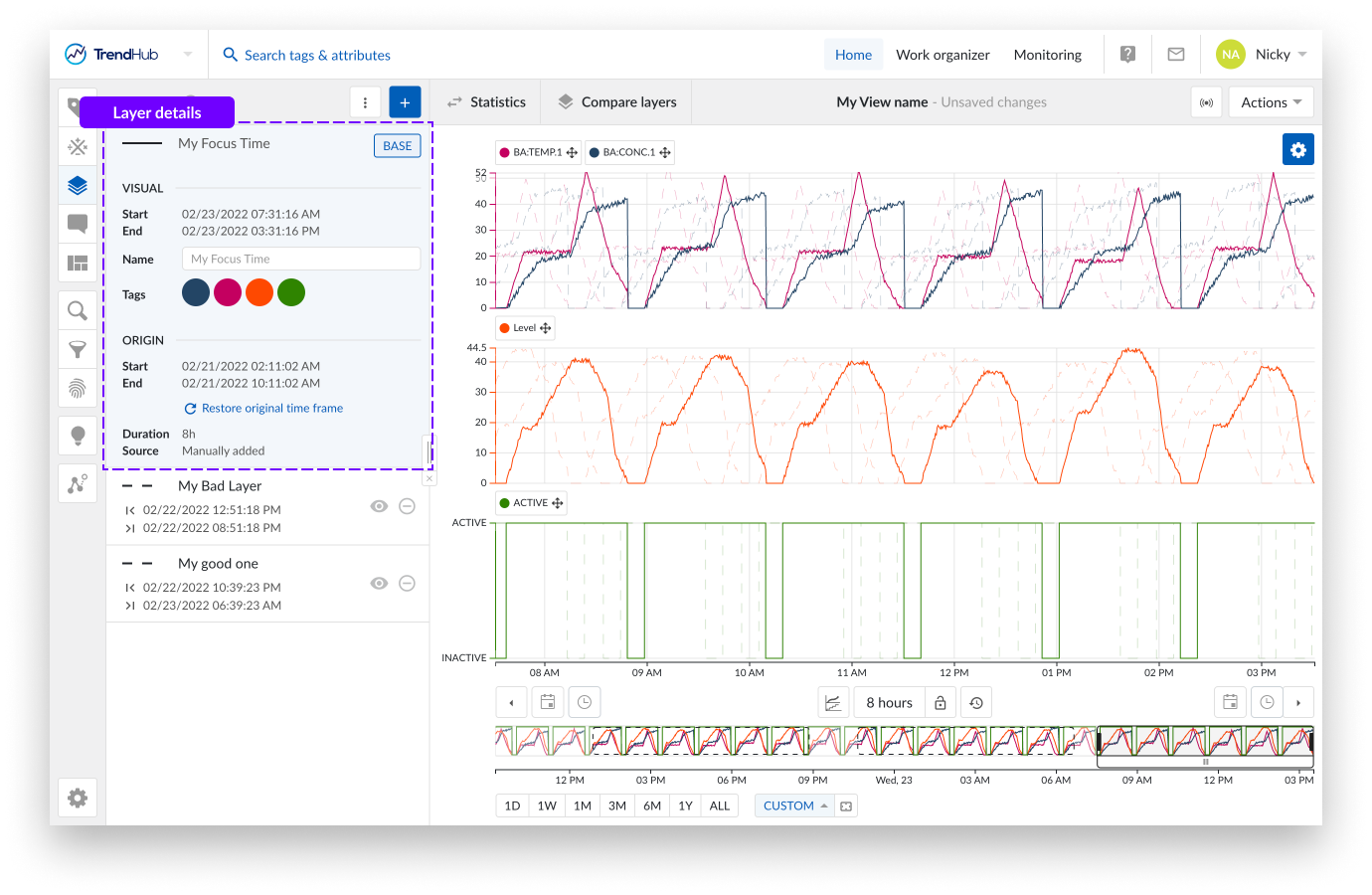

When a layer is selected (see image below) a details box appears that holds the layer's visual and origin information, as well as options to act upon the layer.
This visual information and actions include:
  • The start and end date and time of the period.
  • Shift options, to move the layer into the past or future (only available for sublayers).
  • Layer name input field.
  • Tag visualization option, to hide a specific tag (or attribute) in this layer.
  • Line style, option to make a difference between the layers (only available for sublayers).
The origin information and actions include:
  • Original start and end date and time of the layer.
  • The entered time stamps when creating a layer.
  • The original start and end date of the layers which were added through a saved view.
  • The start and end date of the search result.
  • Duration of the layer.
  • Source, the location where the layer originates from:
    • Manually added
    • Type of search
Once a layer is added, it is highlighted on the focus chart. This enables you to directly customize the new layer.
You can also do the same to existing layers. By clicking them once, the details are revealed.
You can shift layers if needed, by clicking the shift buttons. The outer buttons correspond to a shift of 5% of the current period and the inner buttons to a shift of 0.5% of the current period.
You can also move a layer around on the context chart by grabbing the periods grab handle, which appears after clicking the layer. Zooming in on the context chart makes it easier to move the layers to a more precise location.
Giving a layer a name helps distinguish them on other locations (E.g., Compare layer, in exports, etc.) This can be done after a layer is selected, by entering a new name into the input field and hitting enter to confirm. By default, each layer is named "Layer".
The tags option allows you to hide a specific tag or attribute on the selected layer. Simply click the colored dot to match the tag (or attribute) you wish to hide.
