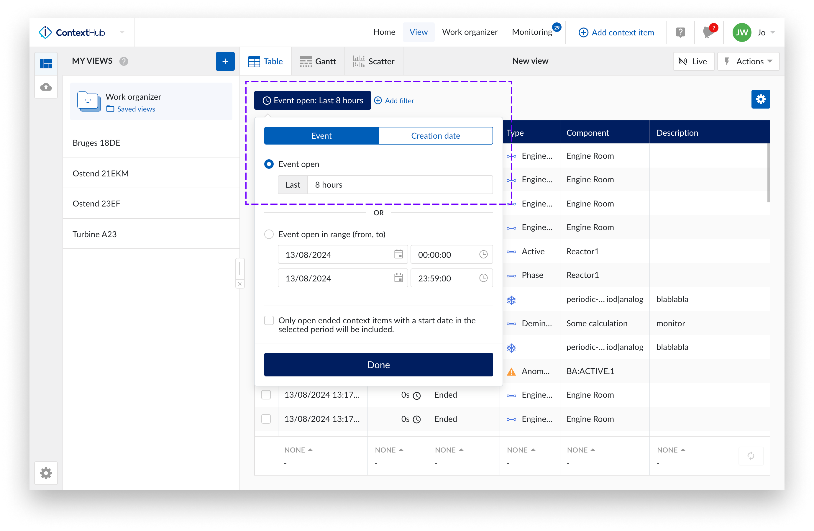

Goto ContextHub and create views ensuring that you select a period associated with the final hours of operation in ContextHub grid views and/or ContextHub Gantt views.
The "Enable live mode" switch pertains to the live mode of views in ContextHub and has no connection to any actions in DashHub.

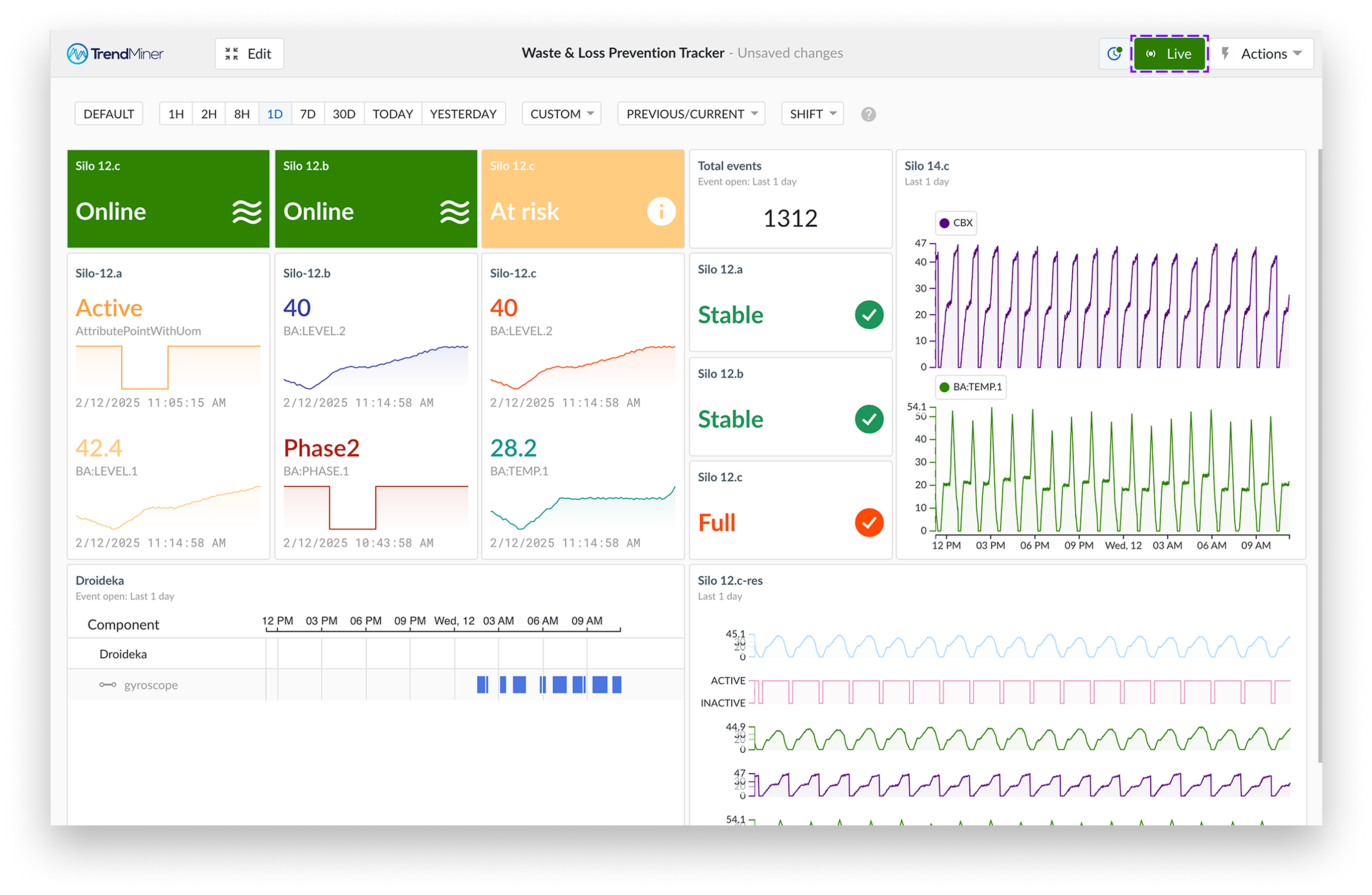

Go to DashHub and create tiles using your new TrendHub and ContextHub views, as well as any monitors you've set up.
Click on the automatic refresh mode button situated in the top right corner of your DashHub UI. When clicked, the button will turn, indicating that the mode is active.
