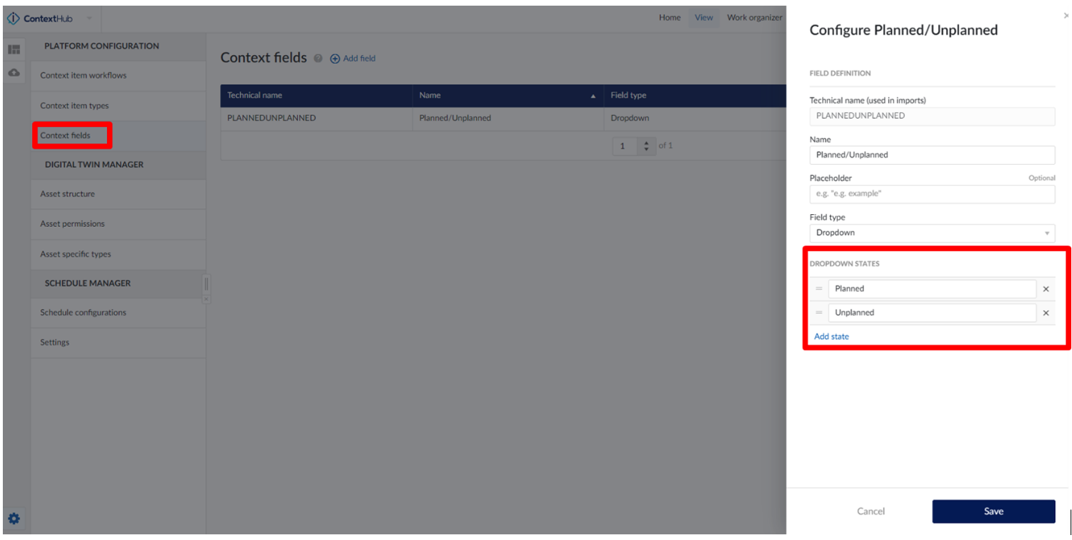

  • Context item field -> Use this option to add structured metadata to context items in the form of parameters. For example:
    • For batch records, context fields like; product type, input feed and final concentration.
    • For maintenance activities, context fields like; “planned/unplanned”, “long/short”.

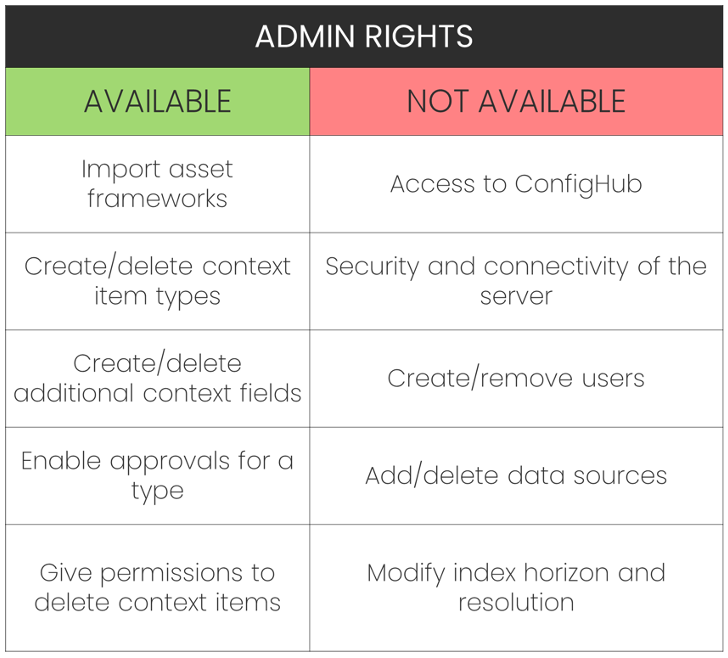

This is done with admin rights, via the configuration window of ContextHub.

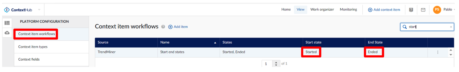

These events have a start and an end. To facilitate this, we need to ensure that there is a workflow with the states "start" and "end", associated to the Context Item type – “Start and states workflow“, by default in TM.
Finally, we need to define the extra categories that we want to be able to identify for this context item type. In this case, whether the shutdown was planned or unplanned.
In summary, the preliminary steps to implement the ContextHub system are:
  1. Verify that a Workflow exists or create one -> In this use case, with a start and an end.

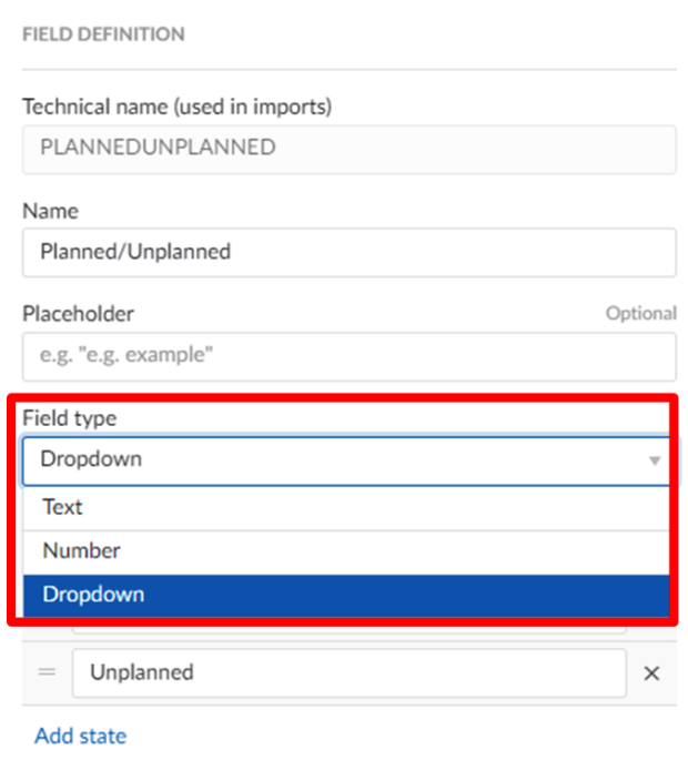

  2. Create the extra characteristics or context fields that we want to attribute to the context item type -> In this use case, "planned/unplanned".
  3. Create the context item type, with created workflow and the defined extra characteristics -> In this use case, "shutdown" context item type, associating it with the workflow “start and states” and the context field of "planned/unplanned".

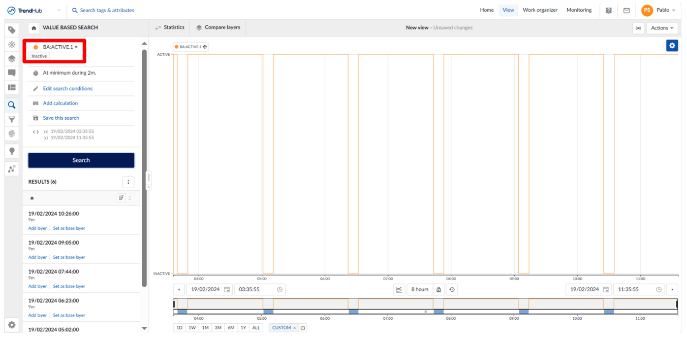

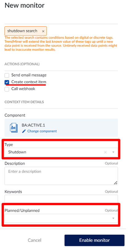

In this case, create a search with an associated monitor, eg:
  • Value-based search with a shutdown for more than X minutes.
In this monitor, the context item type "shutdown" will be specified. The context field "planned/unplanned" will be left blank, as it will be manually filled in afterwards.

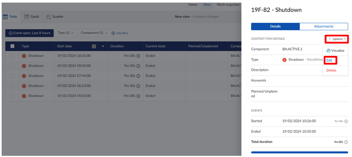

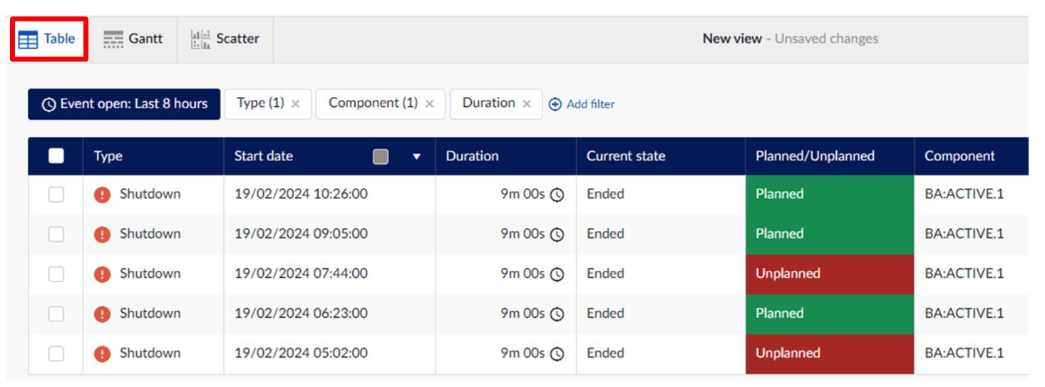

When a shutdown occurs, it will appear in the Gantt Chart or table created in ContextHub.
Consequently, the process expert can click and edit the context item. In the edit menu, all associated context fields will appear. The process expert will select the "planned/unplanned" context field and mark the corresponding option in each case, thus recording the nature of each shutdown according to the context and his criteria.
Color formatting can be added to differentiate between different types of shutdowns in a more visual and direct manner.

  • Use dropdown lists over free string fields: to minimize typos.

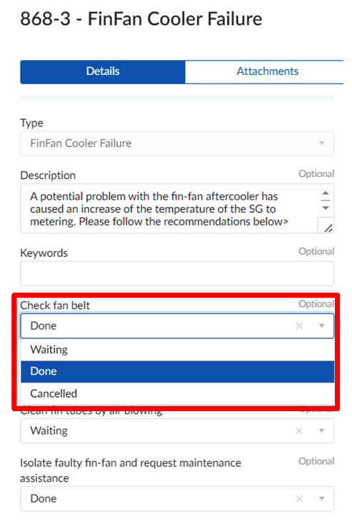

  • Utilize Enumeration Fields for Workflow Tracking: Use enumeration fields to guide context items through a series of calls to action. For instance, you can employ a monitor to create context items for anomalies with a default field value of "to be investigated." Subsequently, this field value can be updated to reflect stages such as "under investigation," "investigated," or "ignored." This approach facilitates the tracking of context items across workflows for engineers or operators.

  • Grant admin rights to key users: Provide admin rights to key users so they can manage these elements without relying on IT admins, streamlining the process and increasing efficiency.
