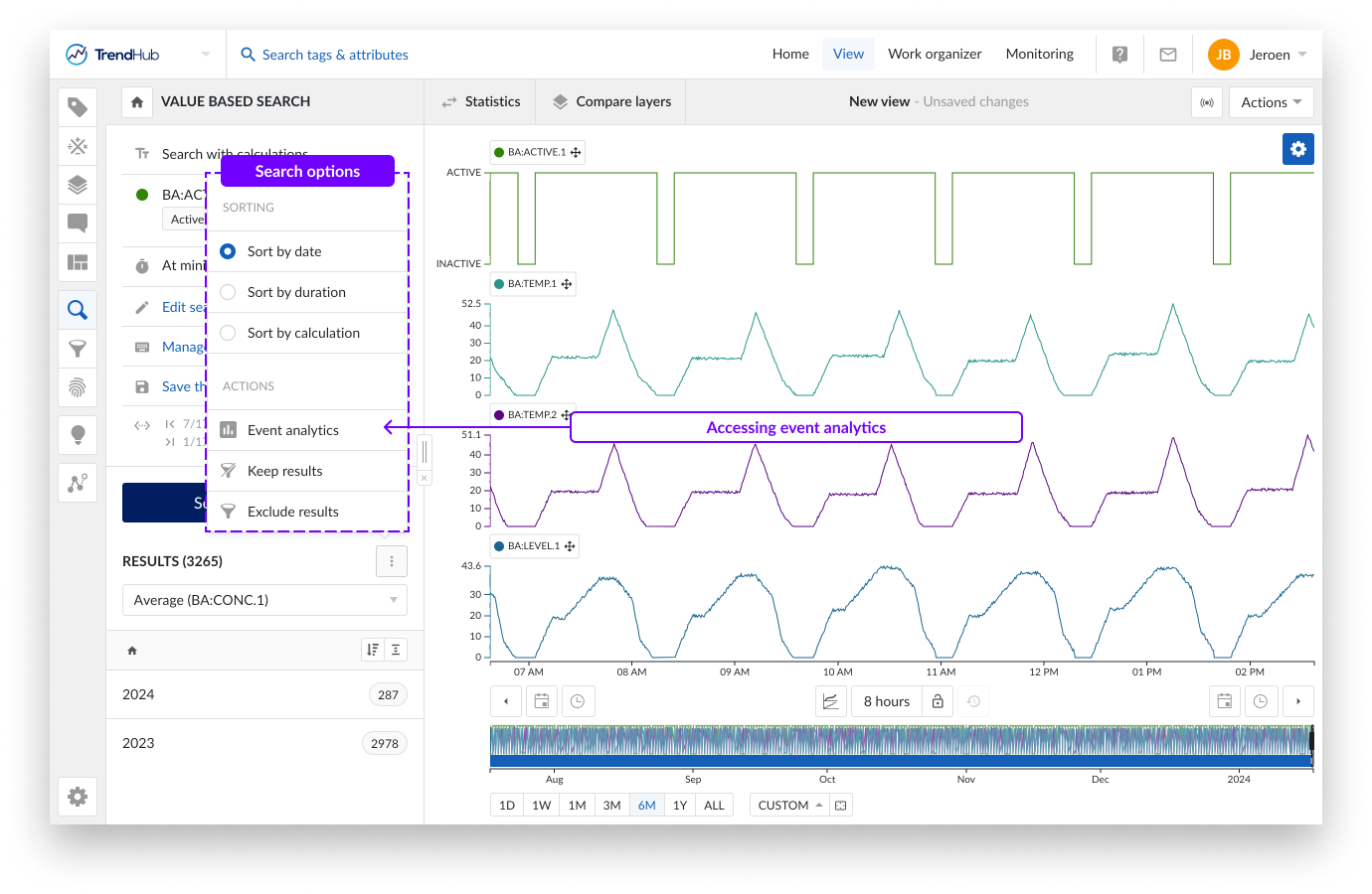

Le volet d'analyse des événements est accessible via le menu d'options des résultats de la recherche.

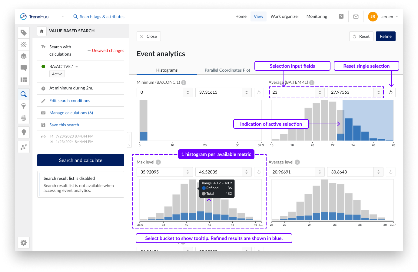

A subset of the data can be selected by making selections on histograms or by setting the ranges manually in the numeric input fields. Histograms with active selections can be identified by the blue shaded area. When selecting subsets, the remaining results are indicated in blue and reflected on all histograms. The number of refined results are also indicated in the tooltips.

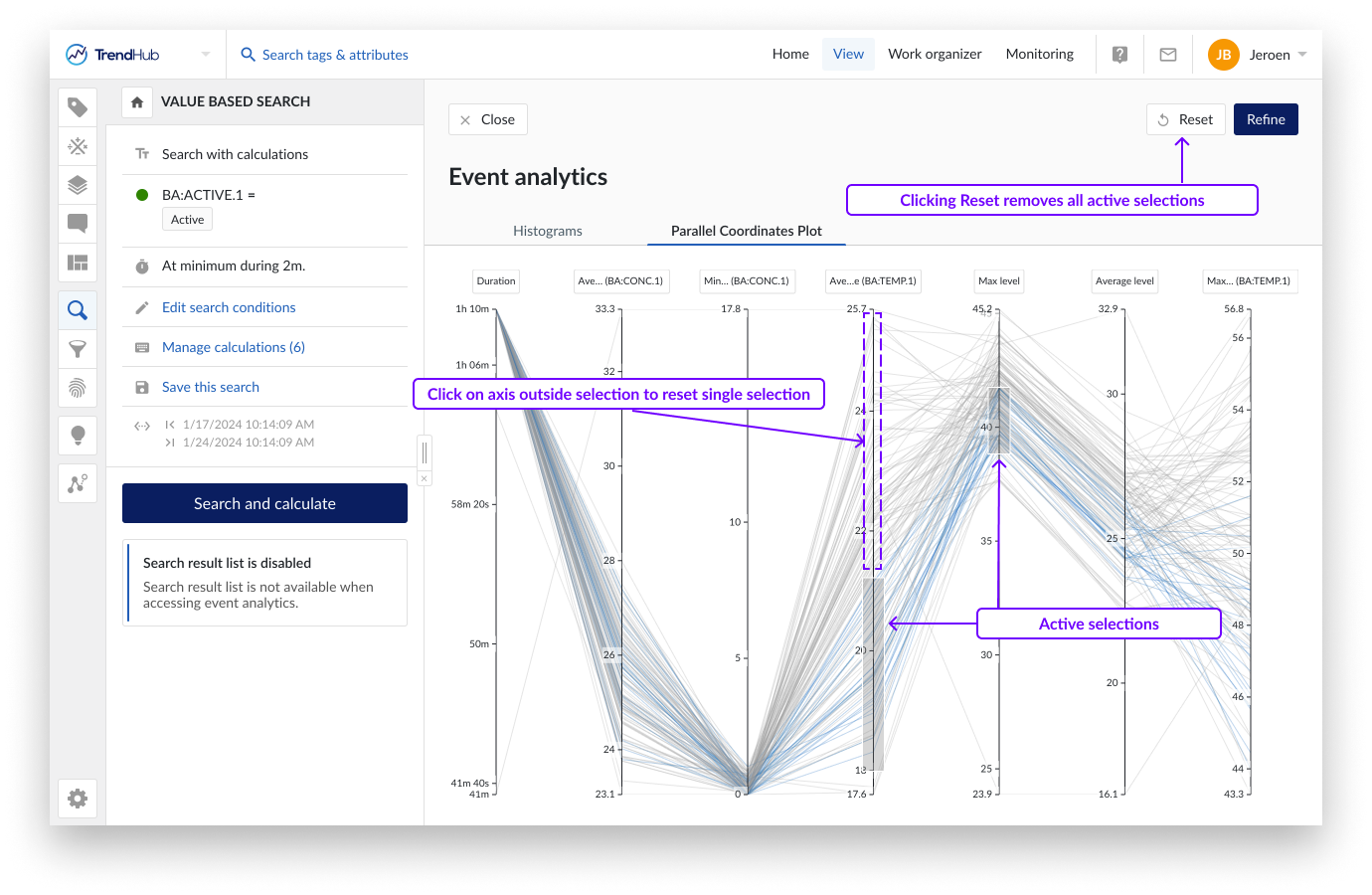

Tracé des coordonnées parallèles

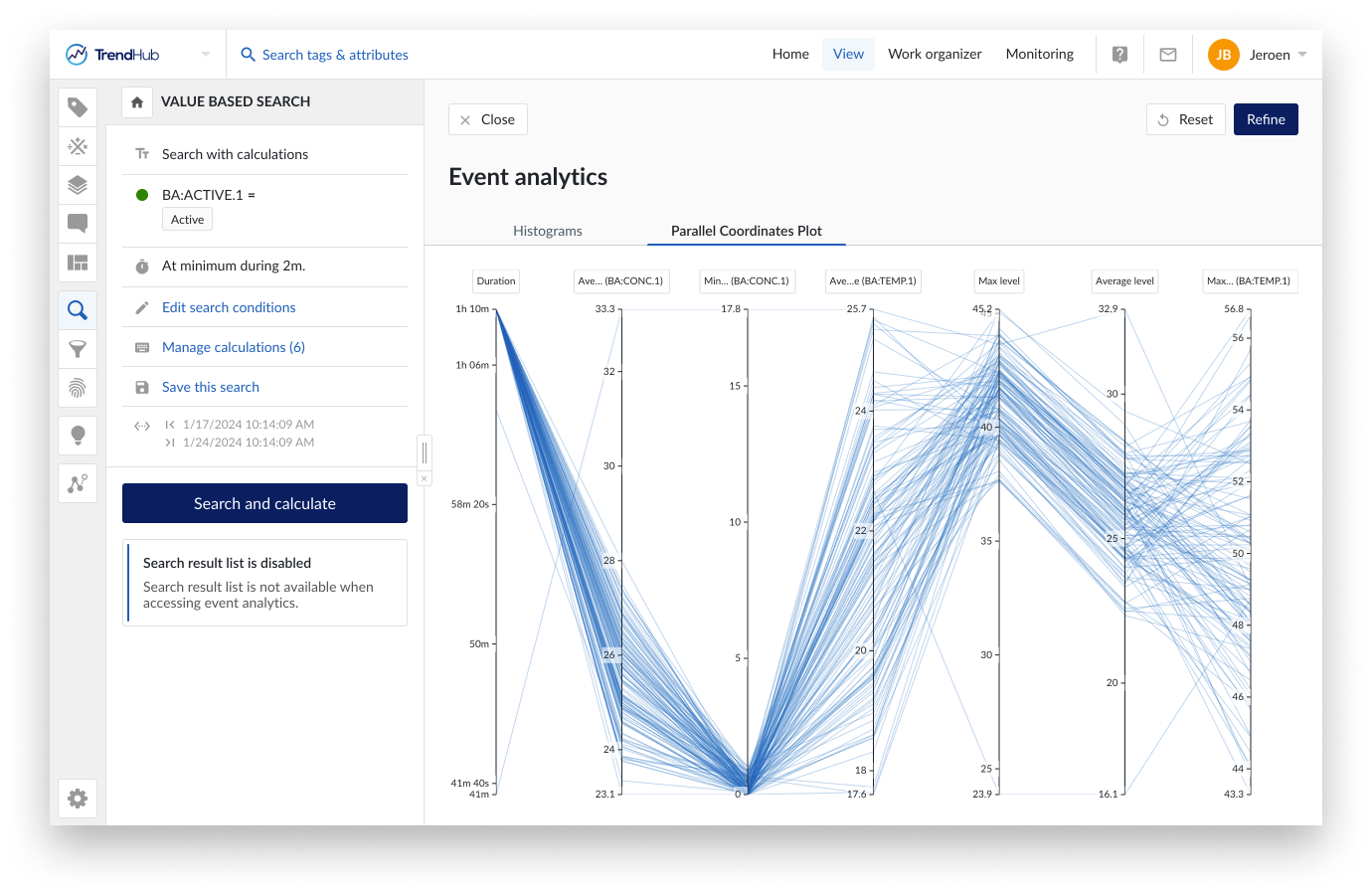

A parallel coordinates plot is a graphical method used for visualizing multivariate data. In contrast to the histogram visualization, the parallel coordinates plot shows every single search result. It consists of parallel axes, one for each metric (duration, similarity score and calculations on analog or discrete tag, and lines connecting the different axes. One blue, continuous line represents one search result. This type of plot is particularly useful for understanding the relationships and trends within the search results. Look for patterns such as convergence, divergence, or parallelism of lines. These patterns can reveal correlations, clusters, or outliers in your data.

A search result is only visualized on the parallel coordinate plot if all calculations have values. In case 1 of the calculations does not have a value (e.g. due to missing indexed data or infinite values), the complete search result will be omitted from the plot. This is a big difference compared to the histogram visualization.

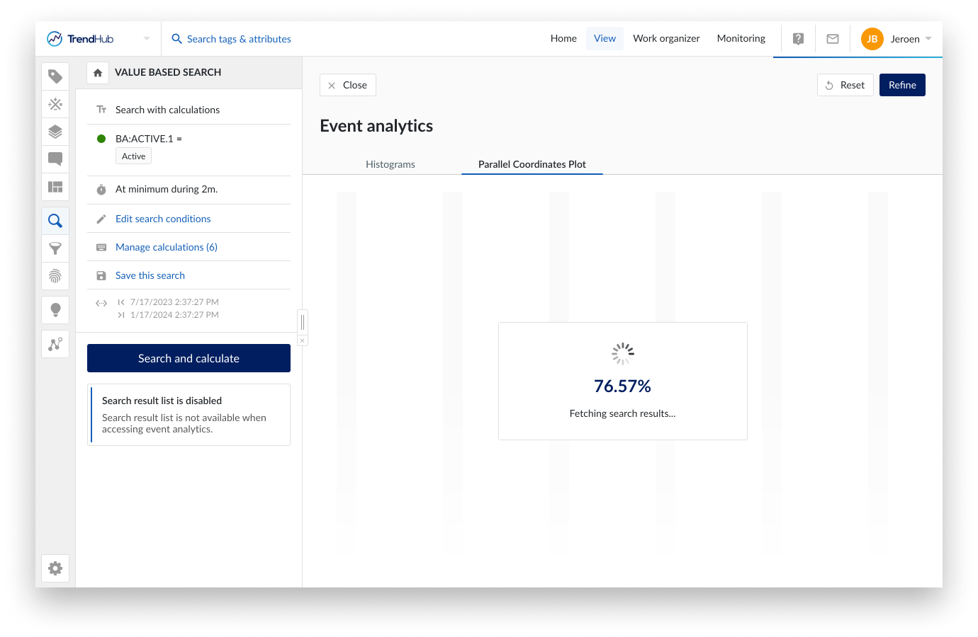

Étant donné que tous les résultats sont affichés sous forme de points de données uniques, le rendu initial du graphique peut prendre un certain temps. Un écran de chargement s'affiche pendant l'acquisition des données, puis le graphique s'affiche. À ce stade, vous pouvez basculer entre l'histogramme et l'onglet de tracé des coordonnées parallèles.
A subset of the data can be selected by making a selection on an axis (also called “brushing”). Remaining results are visualized in blue. Selections can be made on different axis to combine different criteria. By clicking on the axis outside of the selected region, the selection is removed. Clicking the Reset button at the top right, removes all selections at once.

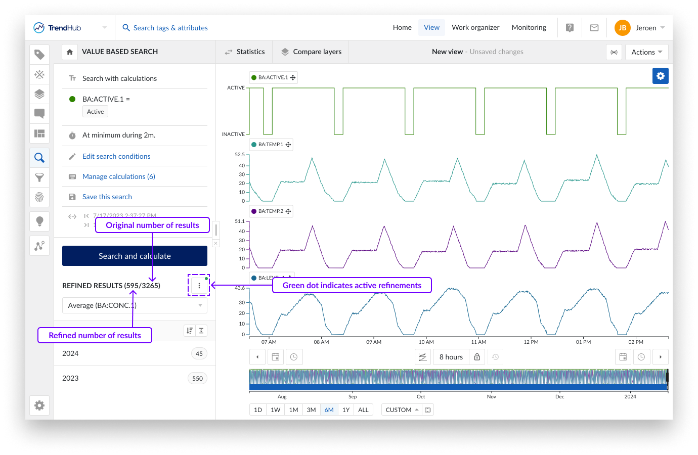

La visualisation de l'analyse des événements peut être utilisée pour une analyse ad hoc ou pour affiner la liste des résultats de la recherche. Cliquez sur "Affiner" dans le coin supérieur droit pour transférer les sélections ad hoc dans la liste des résultats de la recherche. L'en-tête de la liste des résultats de la recherche sera mis à jour pour indiquer à la fois le nombre de résultats affinés et le nombre total de résultats originaux. Un point vert apparaît dans les options de recherche, indiquant que la liste des résultats de la recherche a été affinée. L'ensemble des résultats affinés peut maintenant être utilisé pour poursuivre votre analyse dans l'univers des séries temporelles. Les options de recherche, telles que le filtrage, la création d'éléments contextuels et l'exportation, ne s'appliquent plus qu'aux résultats affinés.  Voir Cet article pour plus d'informations sur l'utilisation de la liste des résultats de recherche.
