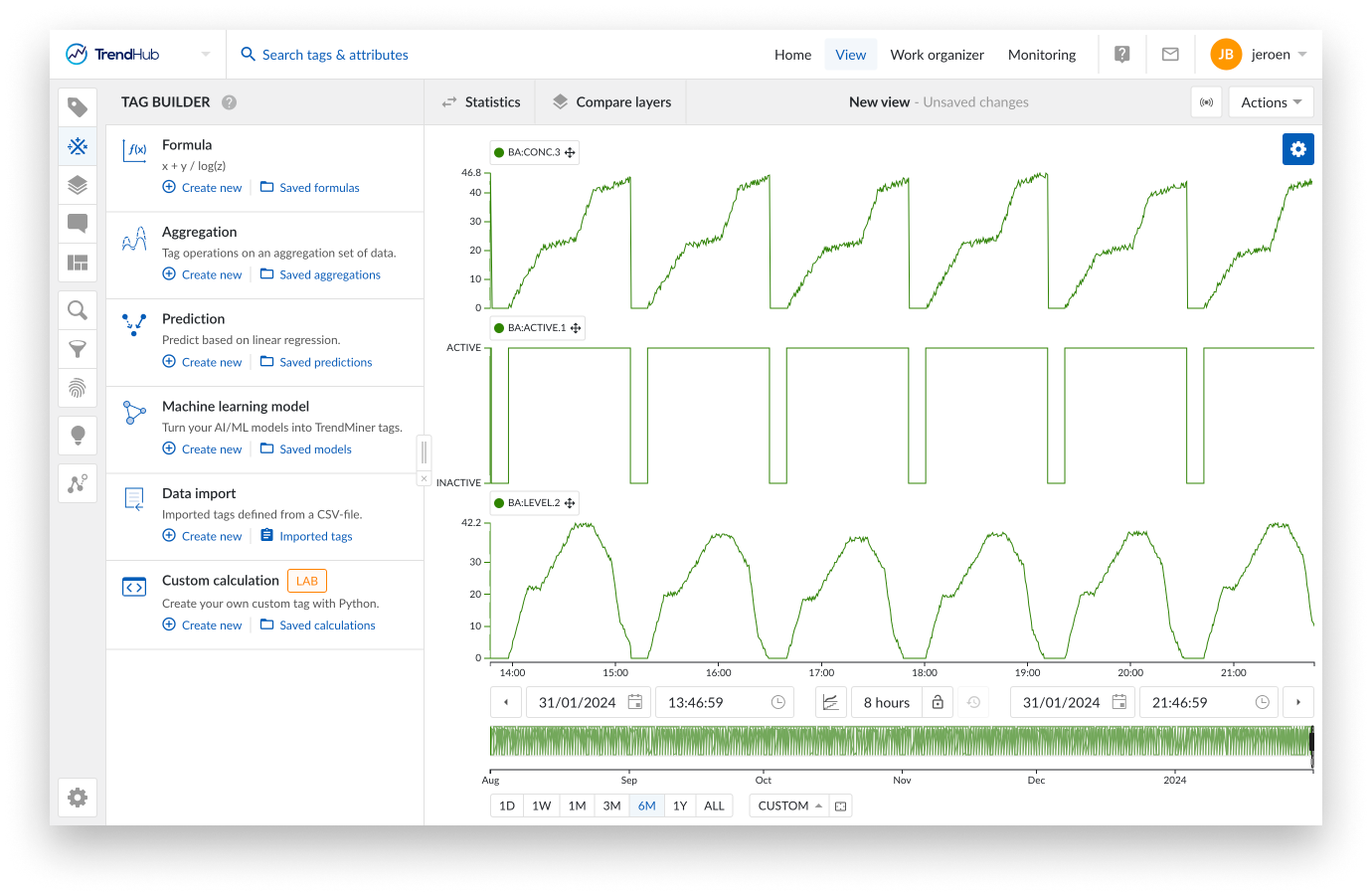

The general workflow of tag builder tags applies on custom calculations. An overview of these workflows can be found here. The configuration panels of custom calculation tags are set up differently to enable easy iteration cycles during the development of the script. This is achieved by providing a dedicated code editor and preview mode.
Script development panel
When entering the custom calculation menu, the focus chart is completely replaced by the script development panel, consisting of 2 tabs:

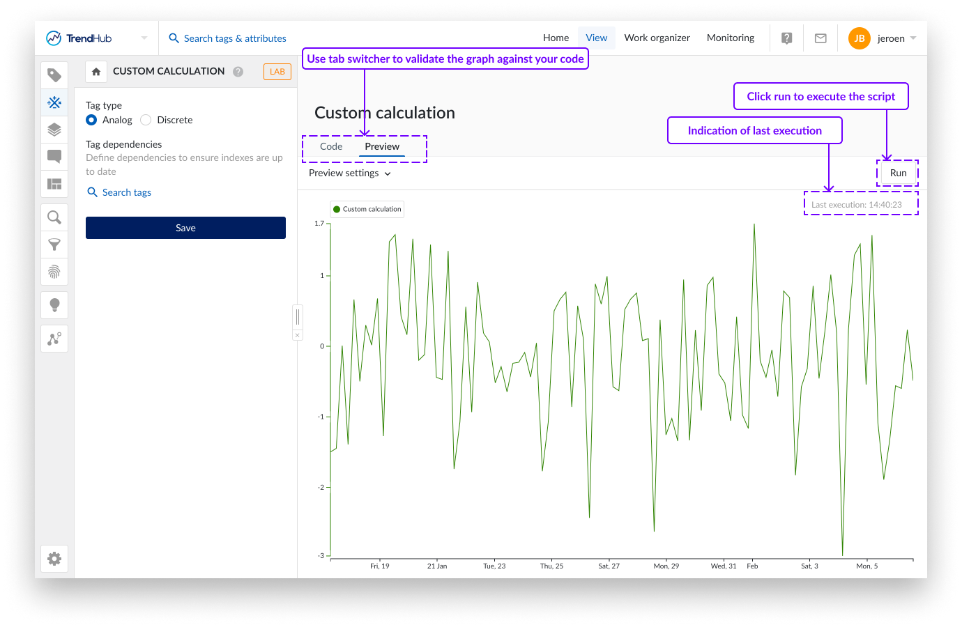

Your custom python script can be copied into or created from scratch in the editor on the code tab. Python syntax highlighting is enabled out of the box to increase the readability. Please refer to the next section to learn how a script should be set up to yield a usable TrendMiner tag. The run button on the right side can be used to execute the current script and will automatically open the preview tab. Although any script without graphical output can be executed, the main goal of this feature is to create a new tag, and so the set of time stamps and values should be provided . If they are provided, the preview tab will show a graph of the scripted behavior of the tag based on the applied start and end time in the preview settings.
You can switch between the code and the preview tab. The script will only be executed when clicking run. A timestamp is shown on the preview tab to indicate when the script was last executed.

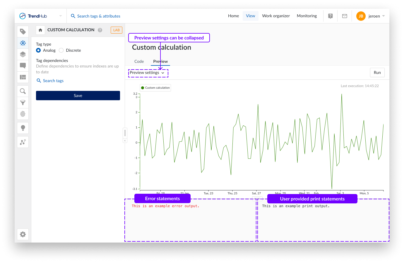

By default the preview settings span the last 8 hours. The start and end date can be modified to test a custom period of interest. The total time span of preview mode, however, is limited to 1 month.
Print statements can be added to the script to help during development. These print statements, as well as errors will be shown underneath the graph in case they are applicable. If no errors are present and no print statements are used, these text boxes will be omitted.
Notice
The preview settings and the indication of the last execution is provided in your local timezone. These timings are converted to UTC, which will be used in the script and shown in the print statements.

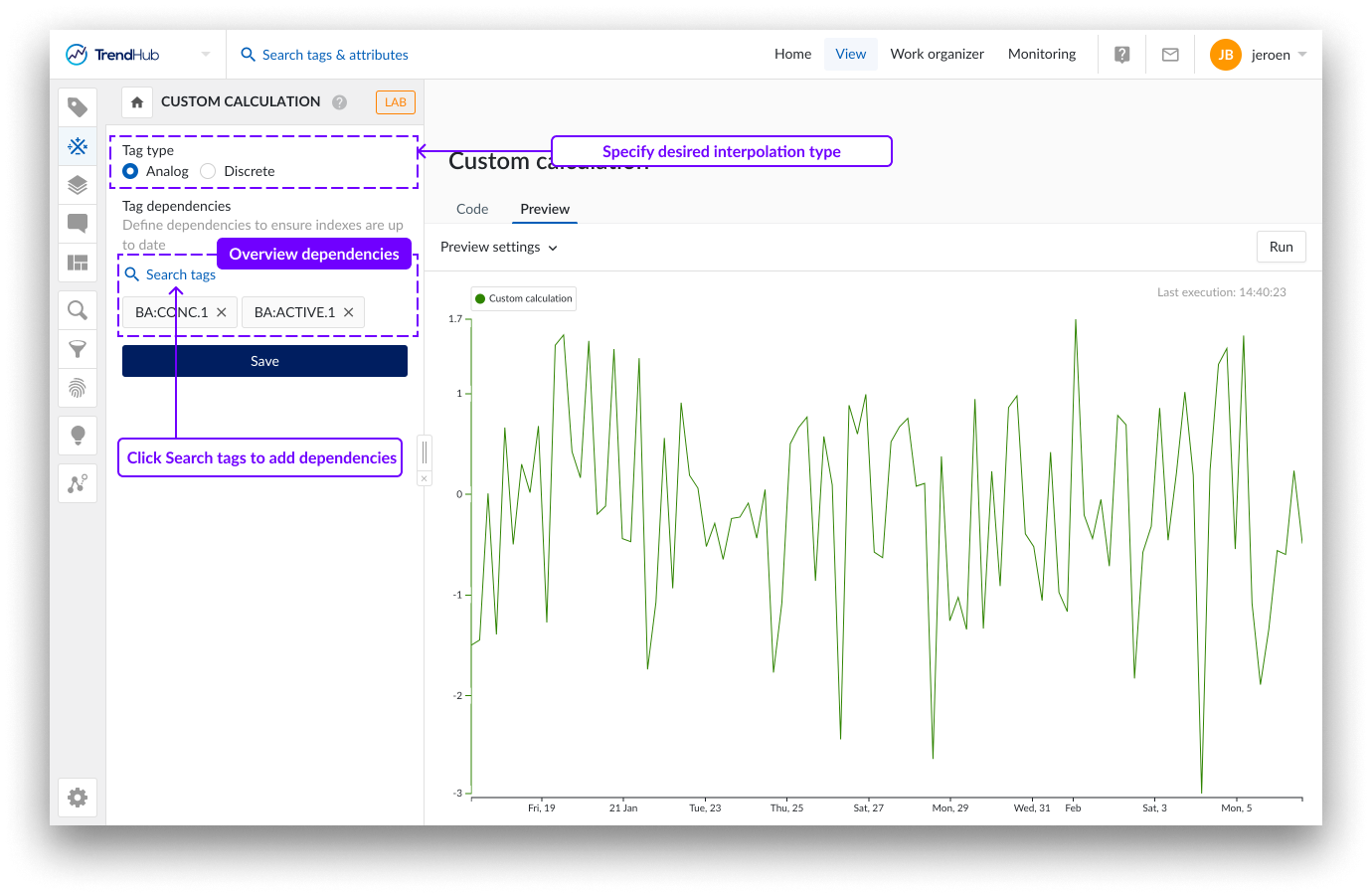

Although the main behavior of the custom calculation will be influenced by the script itself, there are 2 configurations that need to be specified in the left menu.
Tag type
The tag type determines how provided data of the tag will be interpolated. Data will be interpolated linearly (Analog tag), or stepped (Discrete tag). Being able to save the tag as a String or Digital tag is currently not supported.
Tag dependencies
In the tag dependencies section, you should select all tags that are being accessed in your script. This is different compared to all other tag builder types, where dependencies on mapped variables are automatically detected as part of the creation flow of a tag. With custom calculations, TrendMiner can not deduce which tags are being used. This information is crucial in case a custom calculation is used within a monitor. In that case, TrendMiner needs to make sure the index of the custom calculation as well as all the dependencies are up to date. The maximum number of dependencies for custom calculation is set to 50.
Warning
In case tag dependencies are not provided, monitor results will be delayed, or potentially not triggered if the indexes of the used tags do not exist.
