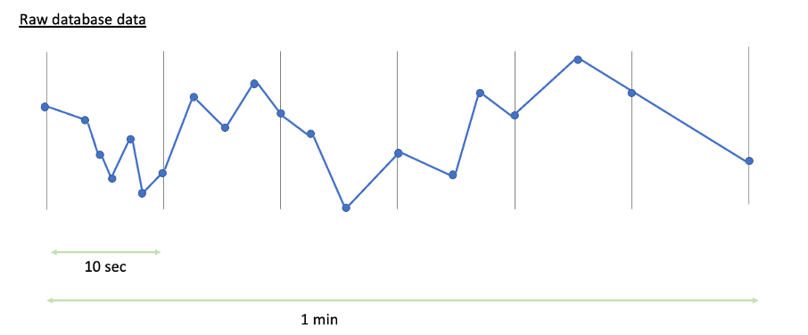

The pictures below provide a conceptual explanation of the indexing process of an analog tag, and how the resolution setting impacts the created index. In the first image below, the original data, as stored in the database, is visualized for a period of 1 minute. Every blue dot represents a value of the time series which is stored in the database (this might already be a compression, based on the storage settings of the database).

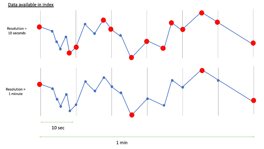

The configured index resolution will define how many datapoints TrendMiner will receive from the database. For a resolution of 10 seconds, TrendMiner requests data by intervals of 10 seconds. TrendMiner's historian connectors are designed to make sure you get the most significant data for these intervals. For an Osisoft Pi connector, this means you potentially receive 4 data points per interval (i.e. the start and end value, and the maximum and minimum value within the interval).
The big red dots in the images below indicate which data would eventually be available in TrendMiner's index for a 10 second resolution setup (top graph) and a 1 minute resolution setup (bottom graph).
Both the performance of the underlying databases as well as the configured index resolution will influence the speed of indexing. For a higher index resolution, the database needs to transfer more data points, hence the indexing process will take longer. Defining a resolution is therefore a tradeoff between data granularity and performance.
