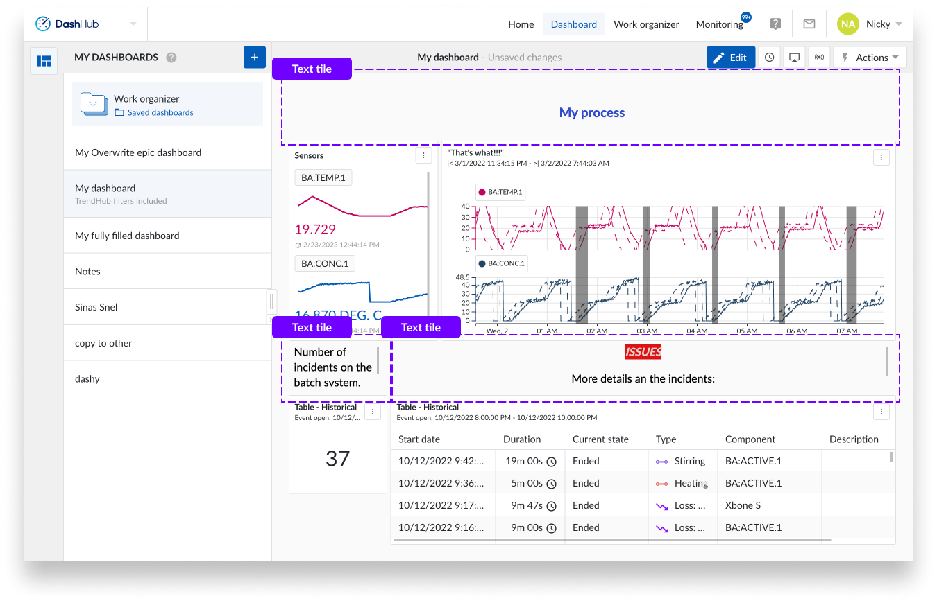

Text tile
The text tile is an important element of your dashboard. You can use it to display short or long texts, presented in a visually contrasting way. This tile type looks different from other tiles because it "loses" its background colour when in view mode. By doing this, maximum space is afforded to display tile content.

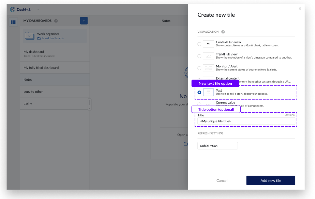

The text tile can be found in the list when creating a new tile.

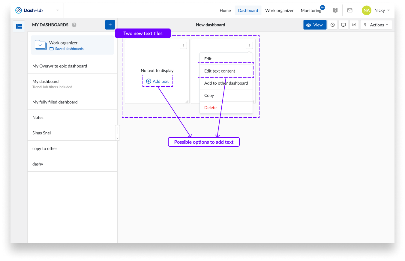

Once a text tile is confirmed in the side panel using the "Add new tile" button, an empty tile is added with some guidance to add text.
Clicking "Add text" in the tile or using the option "Edit text content" will show a modal where you can add, adjust and remove formatting.

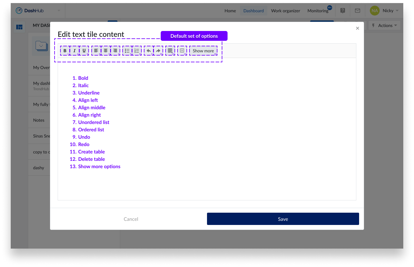

Basic options
Explanation
Bold
Set the selected text in bold.
Italic
Set the selected text with a slope to the right.
Underline
Adds a line underneath the selected text.
Align left
Align text with the left margin.
Align middle
Align text in the middle with the same space between the left and right margin.
Align right
Align text with the right margin.
Unordered list
Starts a list with no inherent order (bullets).
Ordered list
Starts a list with inherent order (numbering).
Undo
Reverse the effect of a previous action.
Redo
Cancel the undo action.
Create table
Start creating a table to be included in the tile.
Delete table
Remove a complete table.
Show more
Reveal more options.
Clicking on the "Show more" button reveals more options. Which can be hidden using the "Show less" button.

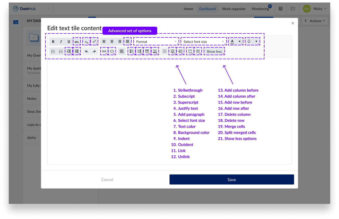

Advanced options
Explanation
Strikethrough
Add horizontal line through the text.
Subscript
Distinguish a symbol or text below and to the right of another character.
Superscript
Distinguish a symbol or text below to the above and to the right of another character
Justify
Space is added between words so that both edges of each line are aligned with both margins.
Paragraph
Change the format of the text that affects an entire paragraph including alignment, font type, font size highlighting and indentation.
Font size
Update the current font size.
Text color
Update the color of the selected text.
Background color
Update the background color of the selected text.
Indent
Adds a point under the previous point (bullet or number).
Outdent
Moves the point under the previous point to the previous level.
Link
Make a clickable link to another web resource.
Unlink
Remove a link that has been set.
Add column before
Add a column on the left of the column the cursor is located.
Add column after
Add a column on the right of the column the cursor is located.
Add row before
Add a row above the row the cursor is located.
Add row after
Add a row below the row the cursor is located.
Delete column
Delete the column where the cursor is located.
Delete row
Delete the row where the cursor is located.
Merge cells
Merge the selected cells together in one.
Split merged cells
Split merged cells into the original state.
Show less
Hide the advanced options.
Click the save button to add the text to the tile. When the dashboard is ready to go, you can press the blue “View” button with the text tile set for display.
