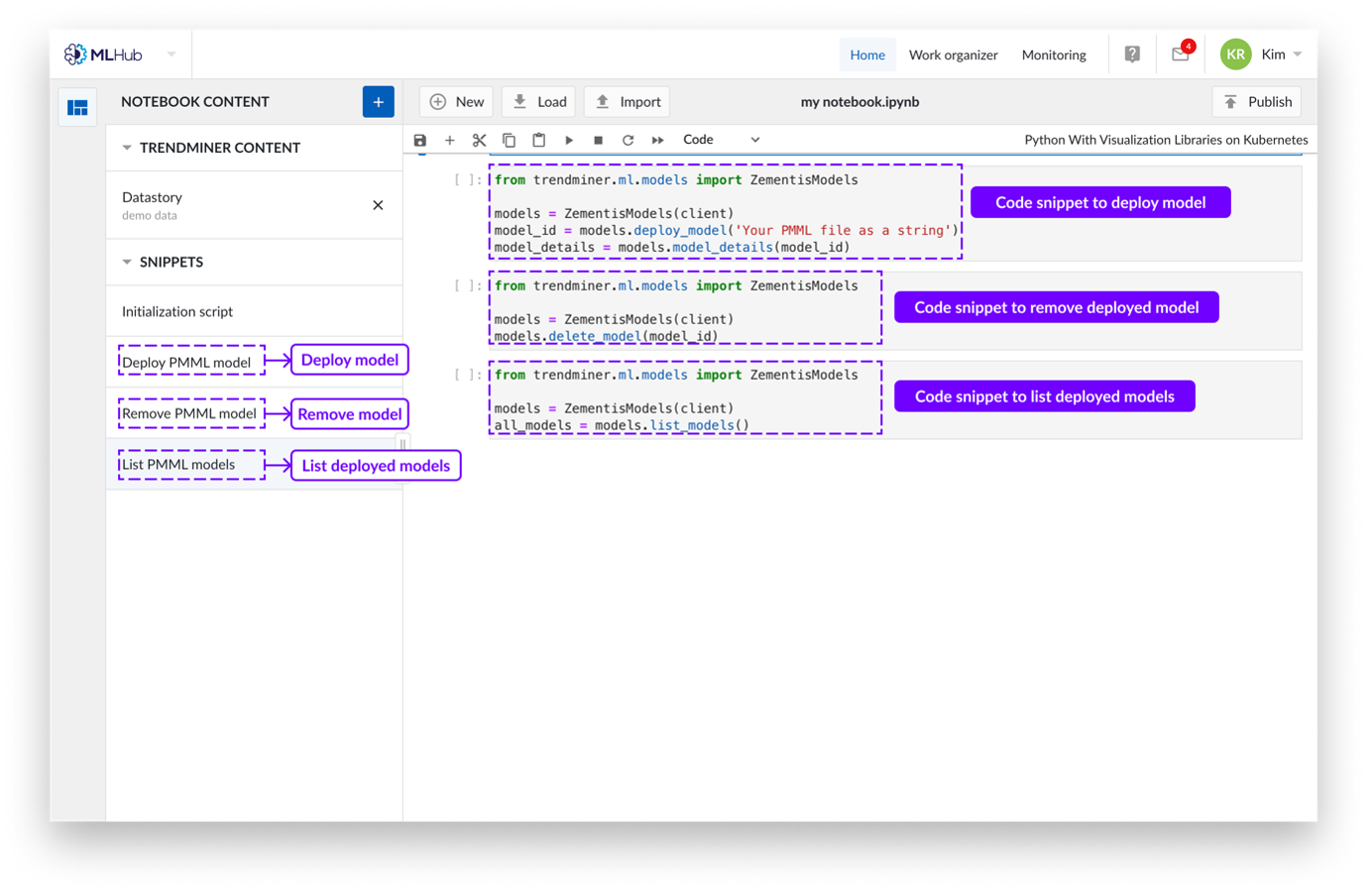

Snippets
Currently snippets are applicable in python kernels to deploy machine learning models.

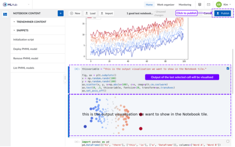

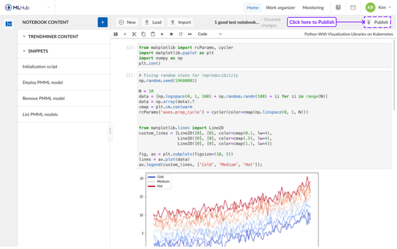

Click the ‘Publish’ button in the top right corner.

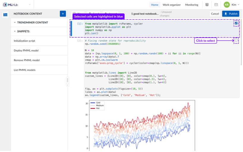

Select ALL cells that are relevant for the output you want to publish, including ‘import’ statements and variable declarations. Make sure the last selected cell produces valid output. You can select a cell by clicking anywhere on it, or use the checkboxes in the top right corners.

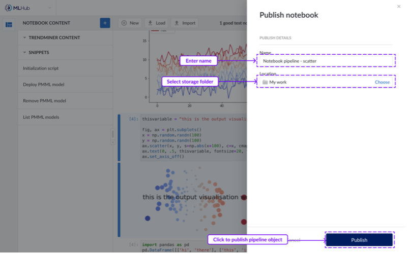

Click ‘Publish’ again. Here you can give the pipeline a name and specify a storage location in the Work Organizer. This will create a ‘pipeline’ object, which is a sort of mini notebook containing only the selected cells. Pipelines have no relation to their origin notebooks, they are a separate entity.If you update the notebook, you will have to create a new pipeline object as well.
Click the ‘Publish’ button in the bottom right.
