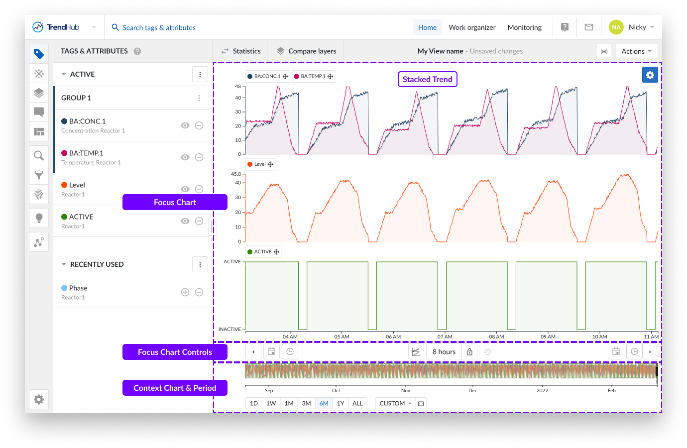

TrendMiner's easy to use time navigation will help you move quickly through all your data that is being visualized, to find trends that help you define a problem or to confirm a hypothesis.

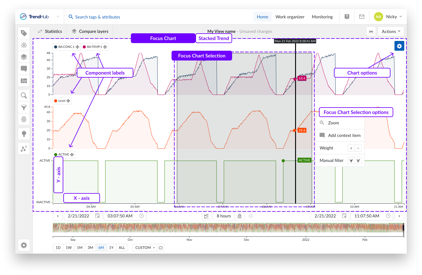

Data is visualized on the Focus chart and the Context chart. The Context chart sets the scene and defines the data on which specific searches and filters will be applied. The Focus chart represents the biggest part of the application and shows the time series data for the period of interest. Both levels can be used to navigate in time.
The focus chart itself offers various controls for time navigation.
Chart zooming (in and out) can be done in scroll fashion with your mouse or touchpad.

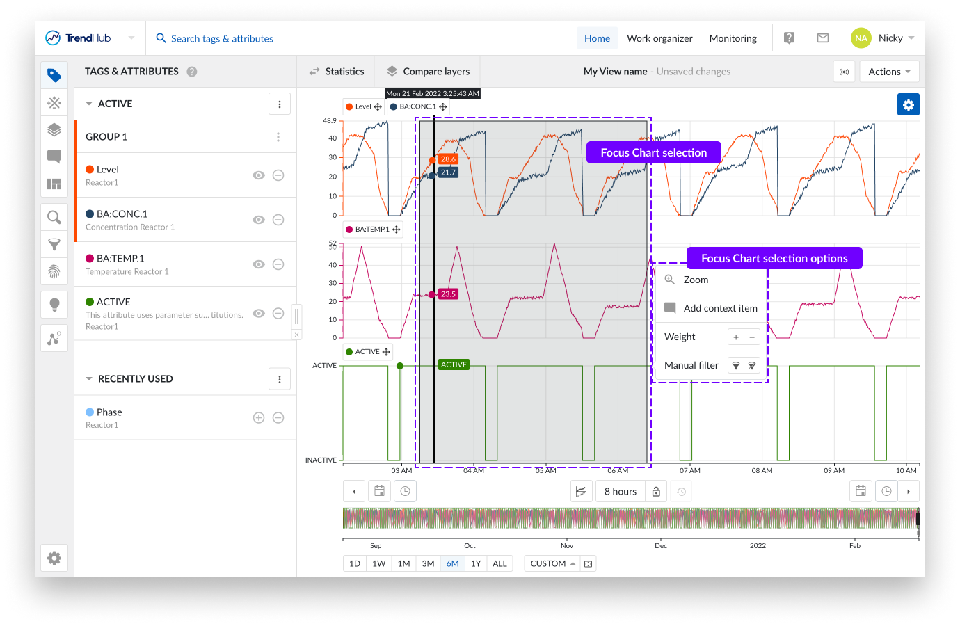

You can also zoom in on the chart when a selection is created on the focus plot. This is done by a click and drag action on the focus chart, creating a greyed selection. By doing this you are highlighting your interest in the period. When the area is selected, a selection menu appears including a zoom option.
The selection's options popup list hides after a brief moment in time when the mouse pointer leaves the selection or the options popup. Hovering over the selected area, visualizes the options popup again.

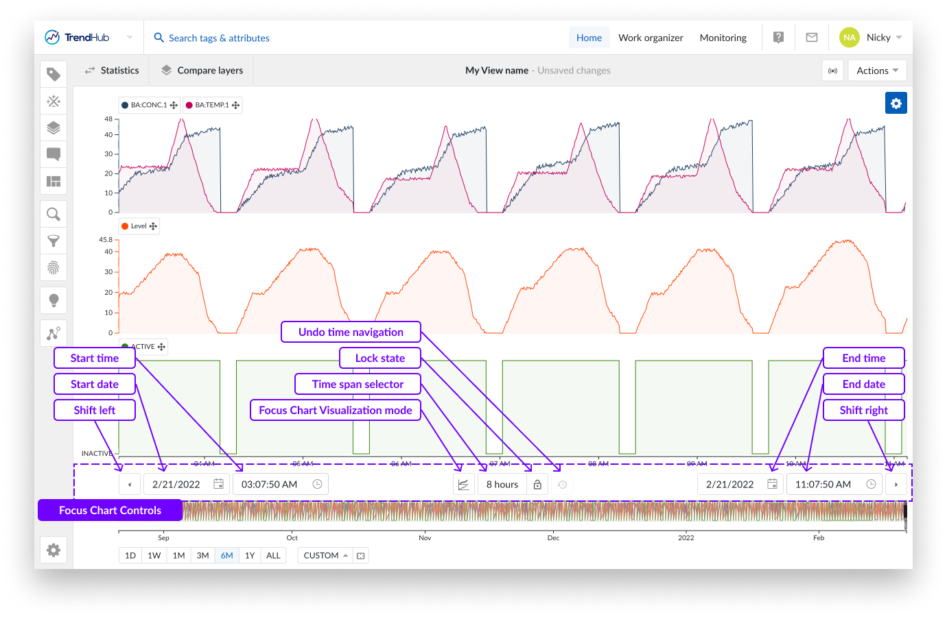

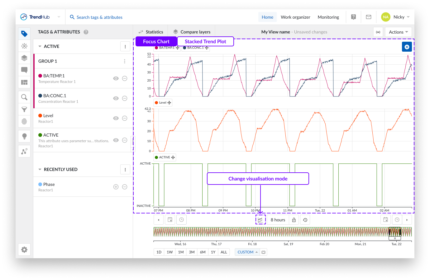

Below the focus chart there are options which give you the ability to move through the time on the focus plot.
The shift buttons (arrow buttons), the leftmost and rightmost buttons will shift the focus chart into their respective directions. The response here depends on the state of the lock button, mentioned earlier.
When the button is unlocked, both buttons will add 20% of the current window size to the period. When the lock button is locked, the buttons will move the chart to the left or right, by 20%.
Next to the shift buttons on the left and right, you will find the date and time pickers. Use these buttons to select the start and end time of the focus chart.
Between the date and time pickers you have further options. The focus chart visualization mode button provides a list of available chart visualizations. The options here include:
Trend: Trend line visualization for all tags and attributes in one swim lane.
Stacked trend: Trend line visualization with an individual swim lane per tag or attribute.
Scatter: (Multi) scatter plot visualization.
More information about the charting visualization modes can be found here.
To the left of the focus chart visualization button, sits the time span selection option. By selecting the time span picker, you open an option to apply preset time frames to the focus chart, enabling a quick and effortless way to frame the time span you wish to analyze.
The start time is updated when using this option, but the end date remains the same.
The following time frames are included: 1 - 2 - 8 hour(s), 1 - 7 - 30 day(s) or the possibility to enter specific time periods.
With the custom time period you can select the exact period you wish to see displayed on the focus plot. To input a period simply use y for year, M for month, w for week, d for day, h for hour, m for minute and s for second.
E.g.: for a period of 1 week, 2 hours, 2 minutes, and 10 seconds, simply input the following:
1w 2h 2m 10s, then press enter.
Once you press enter, the focus chart expands or contracts to the period you requested.
Clicking on the lock icon in unlocked mode will lock the current selected time span, as opposed to the predefined time span.
The lock button itself is located to the right of the time span selection button.
The final chart control button, is the undo time navigation button, located to the right of the lock button. This option is by default disabled but can restore any functional change to your current view regarding the previous state of the date and time settings, thereby undoing any time navigation action.

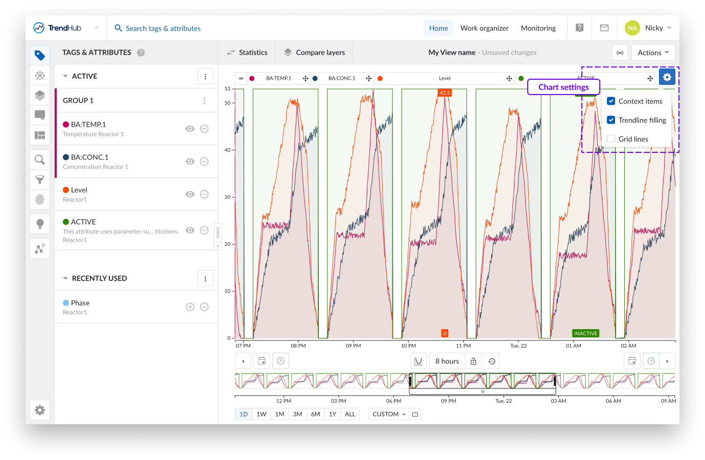

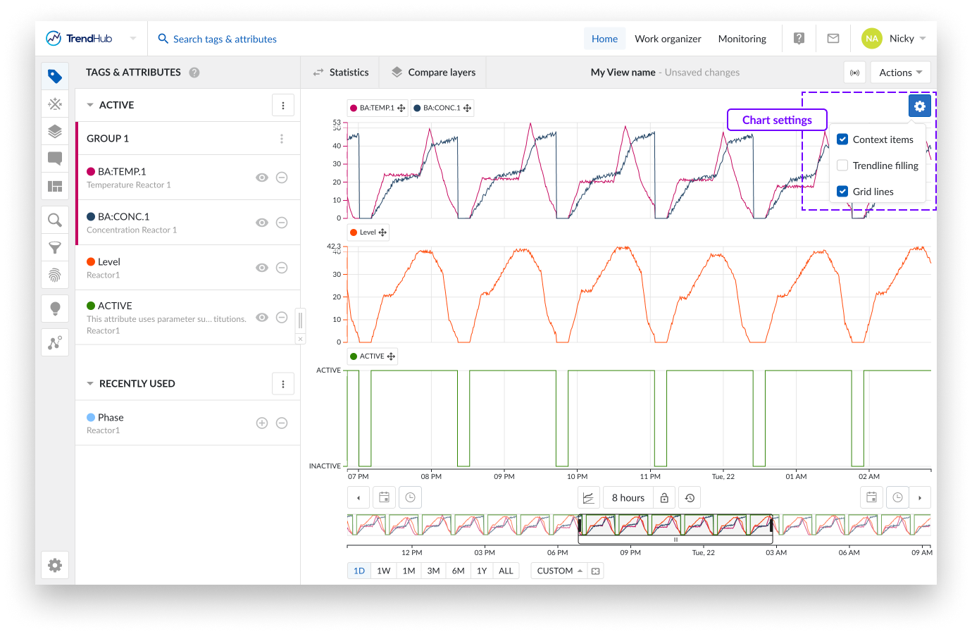

Located at the top right of the focus chart, you will find the settings button of the focus chart.
Per chart there are a couple of settings available to fine-tune the chart to your liking. For the 'Trend' and 'Stacked trend' chart, the following settings are available:
Context items: displays context items.
Trendline filling: fills the area under the trendlines.
Gridlines: enables grid lines on the chart.

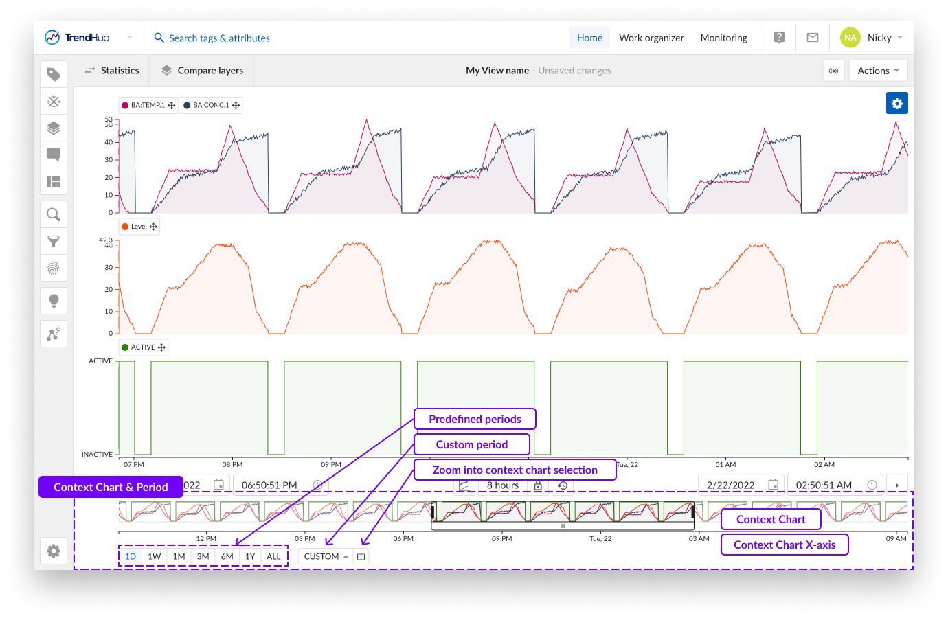

The context chart shows an overview of the relevant data to examine (applicable on searches and filters). Below the chart you will find tools that can help you set your context chart, and also help you understand the link between the context and focus chart.
The context period is the period that is visualized in the context chart and is the period that is used when performing searches or activating filters in TrendHub.
There are multiple ways to change the context period.
Each update with these buttons immediately adjusts the context period and chart. Any changes made can be reverted with the "undo time navigation" button.
The default value of the context period, when logging in to TrendHub, is set to 6 months.
Beneath the context chart, you will see options that indicate a period of time. The first group of options are predefined periods. Clicking these buttons zooms the context chart into one of the following periods:
One day (1D), now moment - 1 day
One week (1W), now moment - 7 days
One month (1M), now moment - 1 month
Three months (3M), now moment - 3 months
Six months (6M), now moment - 6 months
One Year (1Y), now moment - 1 year
All data (ALL), Start of index horizon to now moment
The months / year durations mentioned are effectively a month or a year. E.g.: 3 months --> from 2nd of January 2022 08:30:00 to 2nd of April 2022 08:30:00.

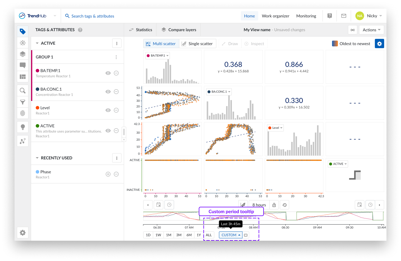

On the right of these predefined buttons, a "Custom" button, allows the setting of a customized context period.
With the first option "Context period range", you can enter a custom period which behaves the same as the predefined buttons. Meaning, you can set the desired last 'custom range' (E.g.: 5d 8h 50m 42s) which results in the now moment - entered value.
The second option "Custom context period" lets you define the start AND end date, and time for the context period.
When the custom button is set, the entered value will be displayed in a tooltip when hovering on the button.
Another way to update the context period is to use the button "Zoom context chart to selected area" which is located to the right of the "custom" button. Clicking this button will zoom your context chart into the period you have visualized on the focus chart.
As a final option you can adjust the context chart by dragging the time axis of the context chart. Similar to the focus plot, where you can increase or move the time axis depending on the state of the lock.

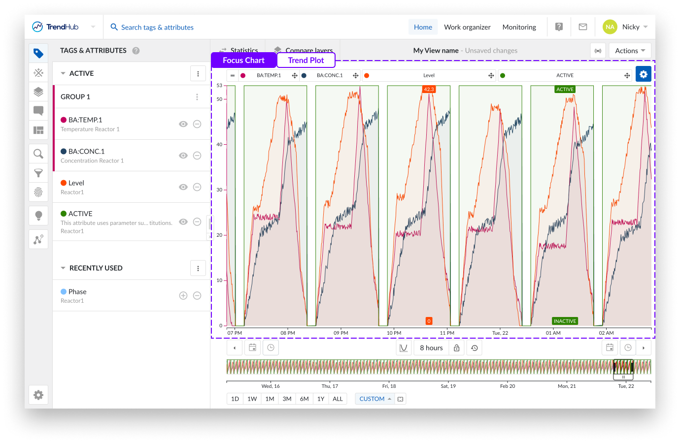

As soon as a tag or attribute is added and active, it is visualized on the focus chart. The focus chart can visualize your data in three different ways:
Stacked trend plot
Trend plot

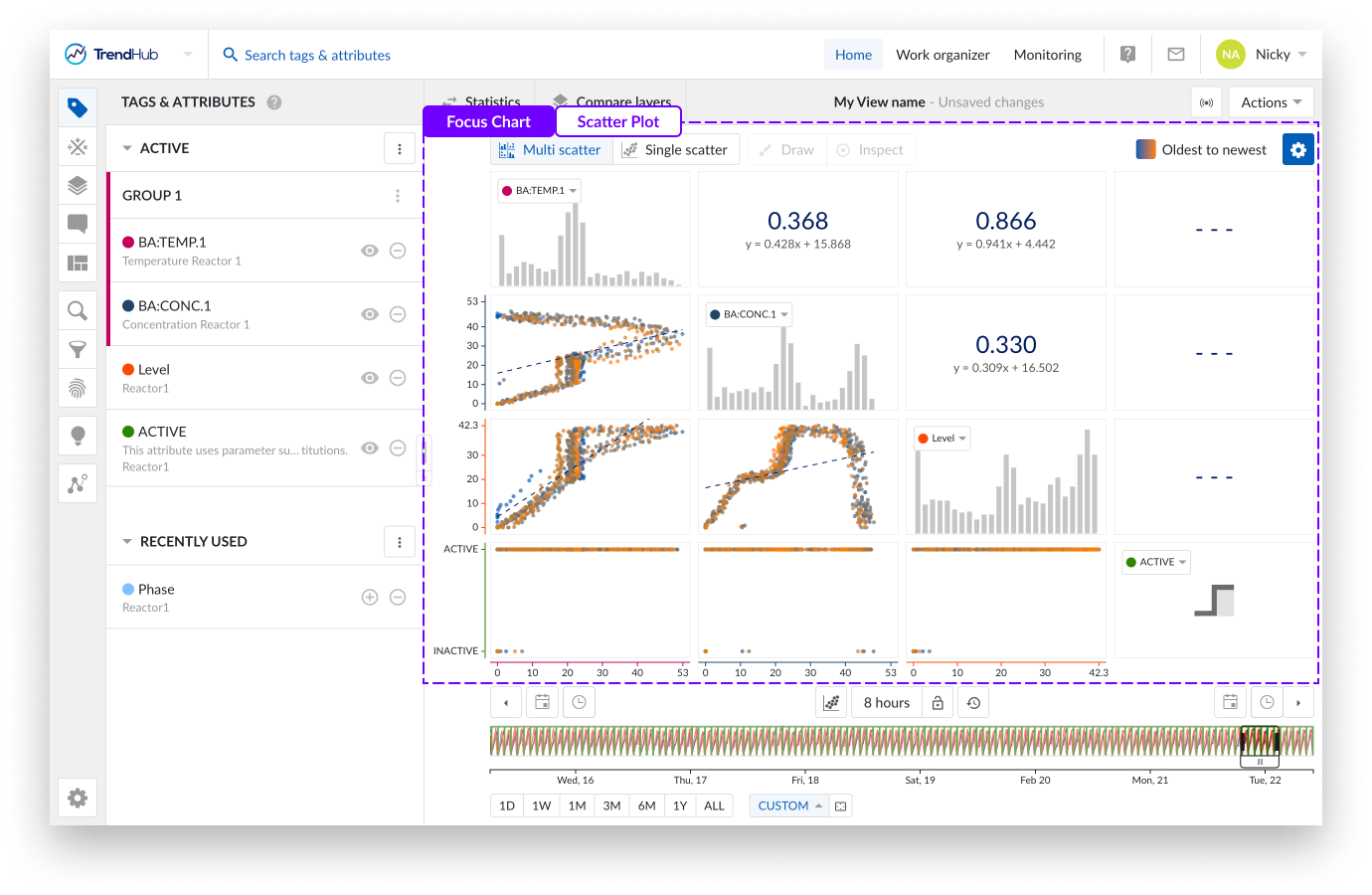

The visualization option in this document is focused on "Scatter" visualization. This option can be selected by clicking the focus chart visualization mode button option below the chart.
The image above shows an overview of what the multi-level scatter plot looks like.
The scatter plots visualize the correlation between the values of two tags and/or attributes, and can help identify operational regimes.
The histogram plots represent an approximate distribution, in bins, of the numerical data of the visualized tags or attributes.
Multiple levels of visualization are possible in the Scatter plot visualization mode. Depending on the number of visible tags or attributes, some 'levels' can be blocked and are not accessible until more data references are added.

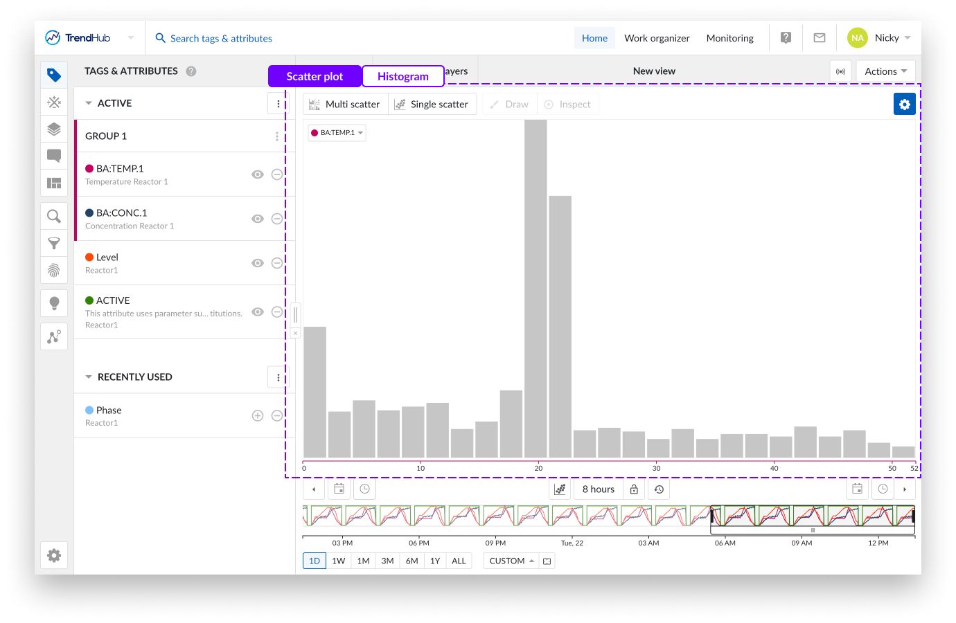

Single histogram plot: When there is only one visible tag or attribute present, and the scatter plot visualization is selected, a histogram is visualized.
In the following example, only a histogram can be visualized, and both navigation buttons are disabled.

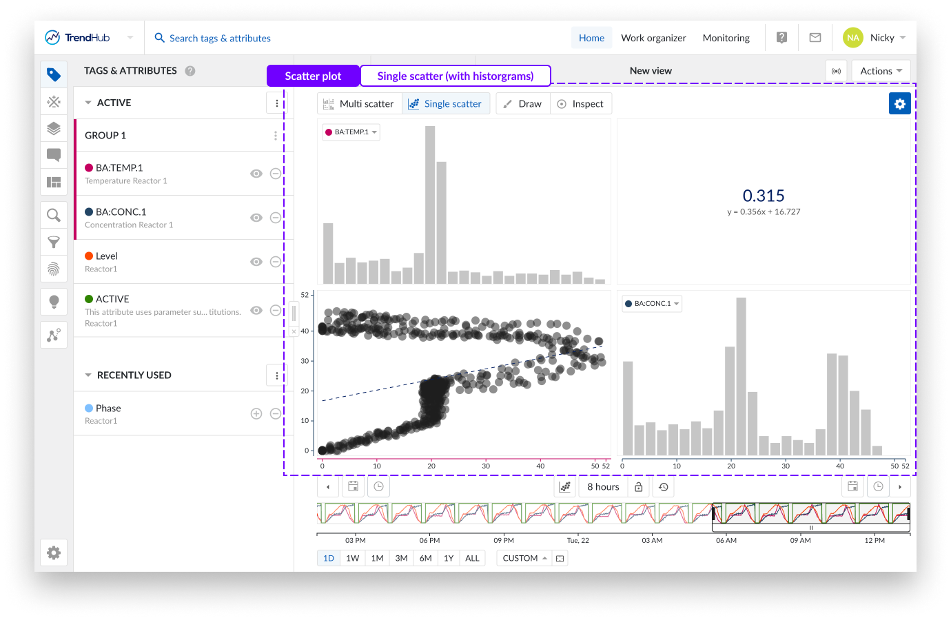

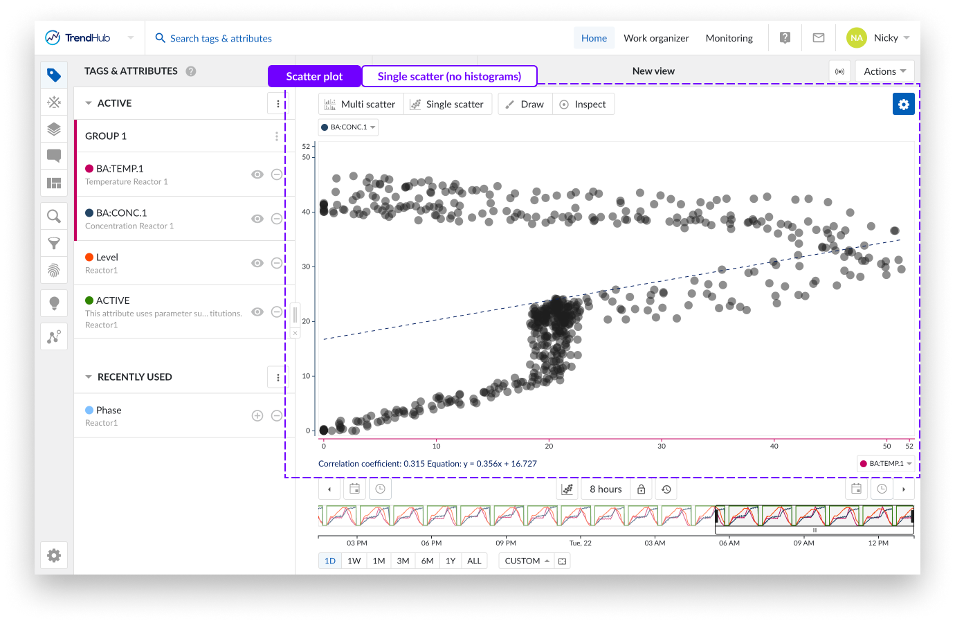

Single scatter plot : When the scatter plot is selected with two visible tags and/or attributes, a single scatter plot with two histograms is visualized.
As an indication, the "Single scatter" navigation button is highlighted when the single level is shown.
In this case, you can clickthrough to visualize any of the two histograms or to maximize the scatter plot on the charting plot. Returning to the single scatter plot with both histograms is done by clicking the navigation button "Single scatter".

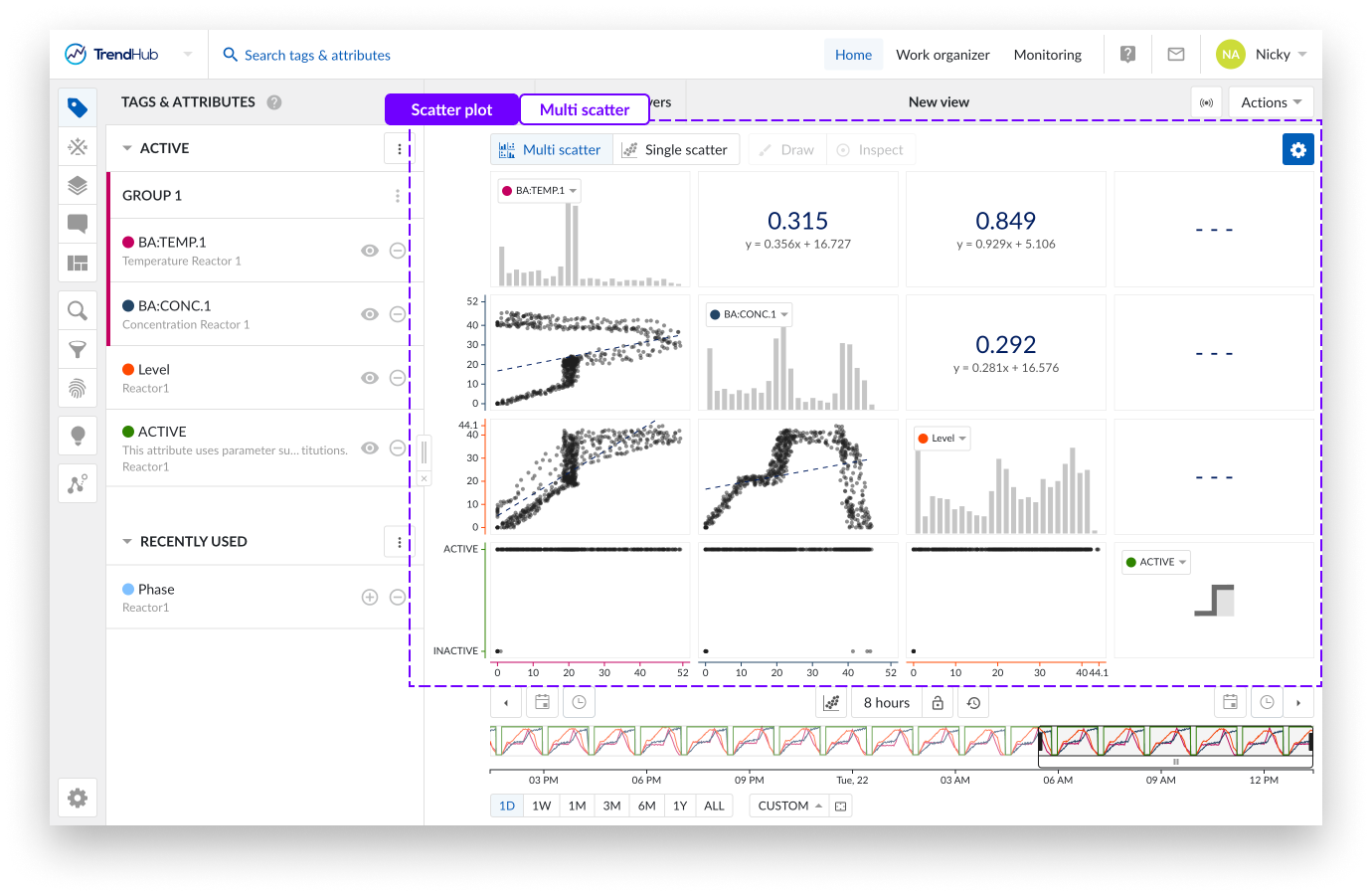

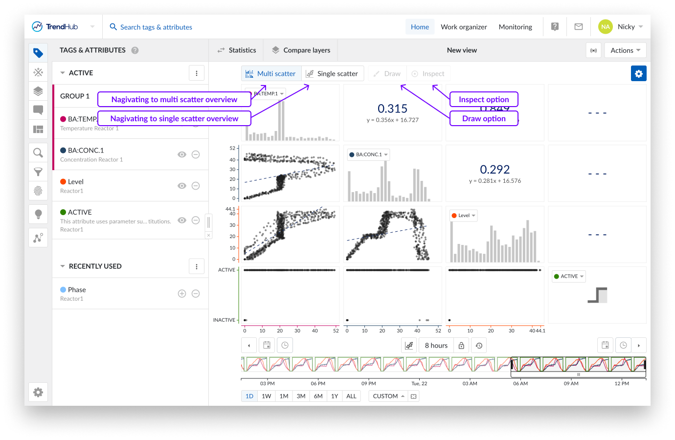

Multi Scatter plot: With two or more visible tags and/or attributes, a switch to scatter plot will visualize a multi-level scatter plot overview. As an indication, the "Multi scatter" navigation button is highlighted when the multi-level is shown.
In this overview:
Clicking on a histogram, navigates to a single histogram plot of the corresponding tag or attribute.
Clicking on a scatter plot navigates to a single scatter plot with both corresponding tags or attributes. On this level you can again navigate one level deeper into a single histogram or maximize the scatter plot.
Returning to the other overviews (single or multi-level) is possible by clicking any of the navigation buttons.
A tooltip will be displayed when hovering on a disabled button, to indicate the required actions needed to unlock that button.
At the top of the scatter plot multiple actions are available.
These buttons are highlighted when you are located at one of the scatter view types. Choose between multi scatter overview or single scatter overview.

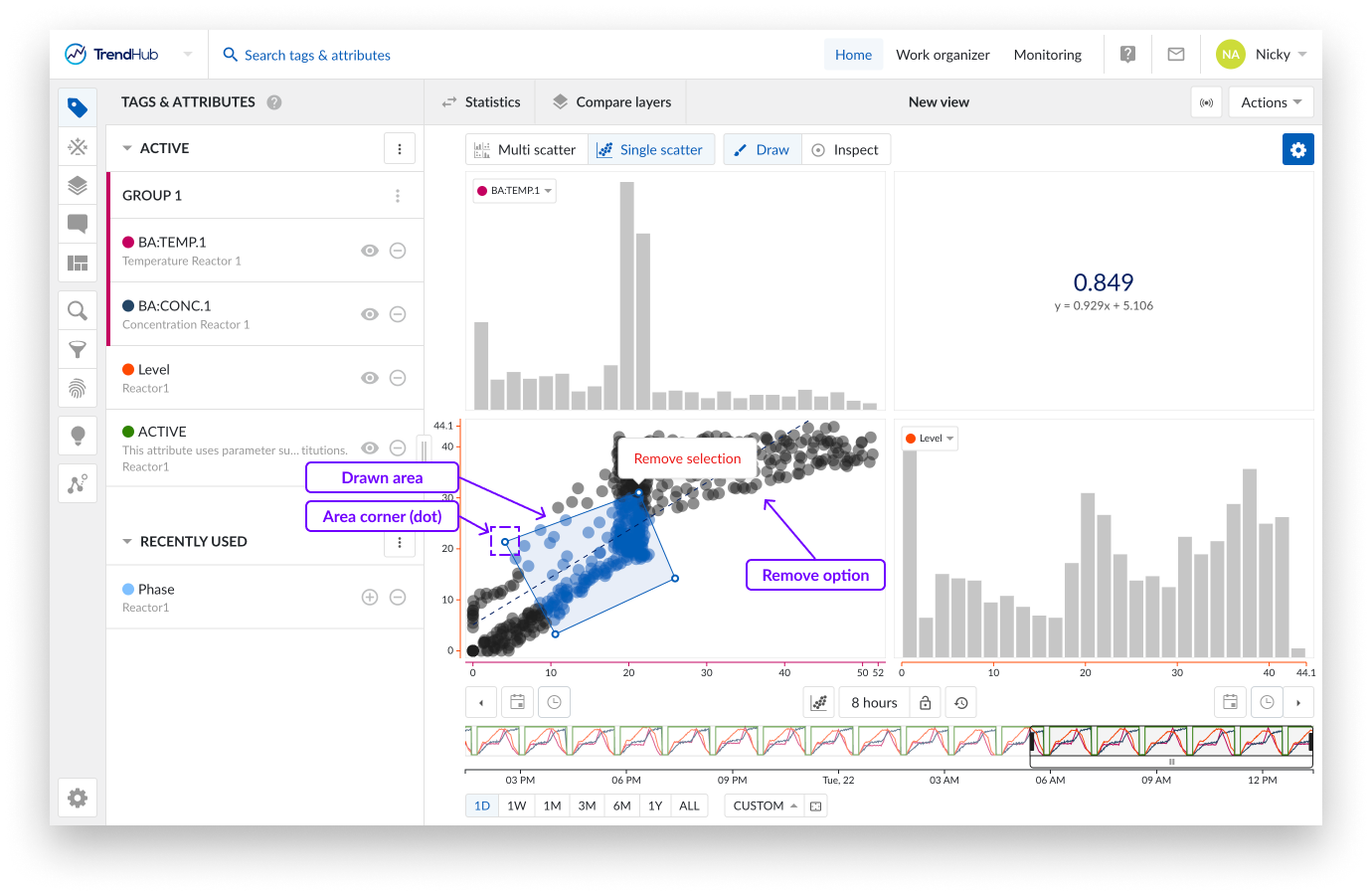

The Draw button gives you the ability to create, update or remove an area on a single scatter plot (with or without histograms), as long as the draw option is enabled (highlighted in blue).
Create an area by clicking somewhere on the single scatter plot. After the first click you will see a blue dot appearing, this dot (or corner) is connected to your mouse pointer with a line. The following clicks will place a new dot that interconnects with the previous dot and starts to form the area. To complete the drawn area, a double click is required. This will place a final dot and connects the first placed dot with the final dot.
Made a mistake while drawing your area? An area can easily be adjusted by dragging the corners of the area. While doing this, the dot (corner) will immediately move along and update the area. Once dropped, the area update is completed.
The area can also be moved to a better fitting location or for fine-tuning. This is done by clicking somewhere on the drawn area and moving it over to the desired location.
As a final option, you can also remove the drawn area and start creating a new one. This is done by hovering over the drawn area which reveals a popup with a remove option called "Remove selection".
For now, one area can be drawn at a time and can be used in the Operating area search.

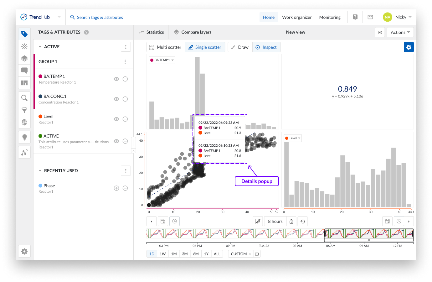

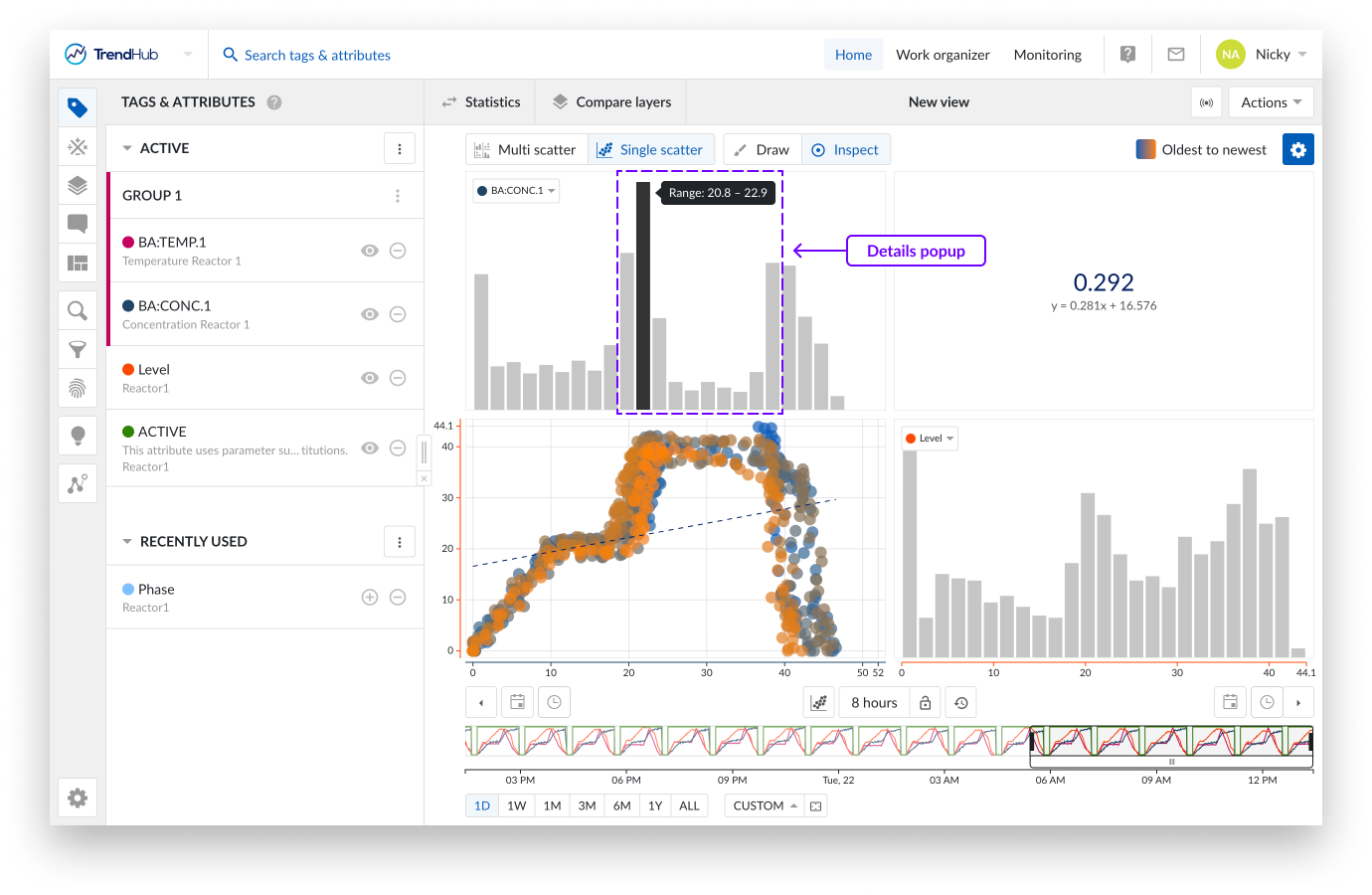

Inspect enables you to dive deeper into the details of the visible data points on single scatter plots (with or without histograms).
When this option is enabled, more detail and information is shown. On the single scatter plots, a popup is shown where you can see the values of both data references (tags and attributes) and the timestamp of occurrence for the point that is being hovered upon.
Hovering over a number of data points will trigger a popup that will contain information, in the form of a scrollable list, on all the data points in the area you are hovering over.
When your single scatter plot also presents two histograms, hover over the bins of the histogram to reveal bin range.

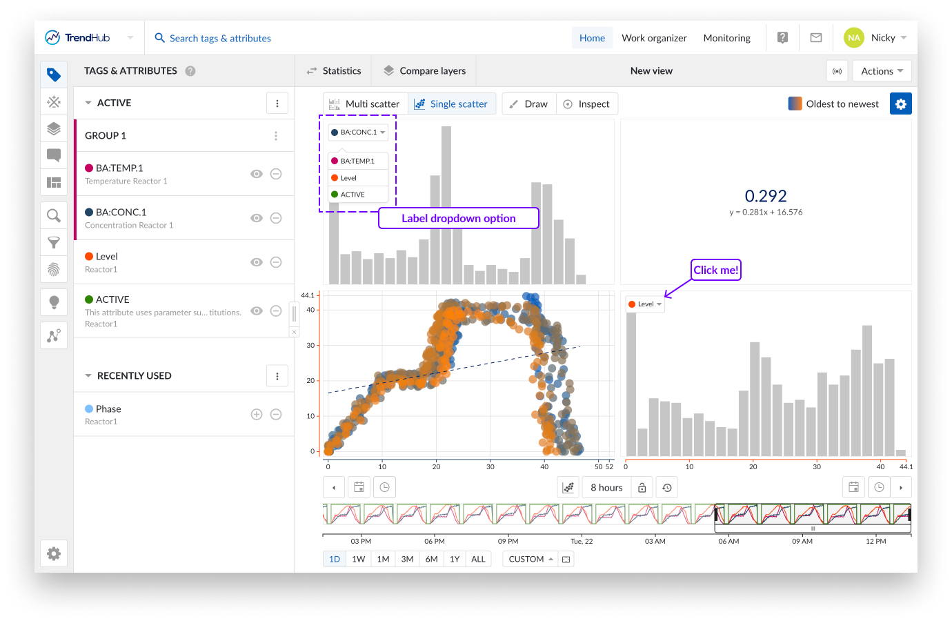

On the scatter plot update tags and/or attributes using their labels. This comes in handy when you have a single scatter plot, or a fully visualized histogram shown. In these cases, you can simply switch to another tag or attribute using their label.
Clicking on one of the labels shows you a list of all the other visible tags and attributes. Selecting one of the other data references in the list will update the current scatter plot or histogram with the data of the newly selected tag or attribute.

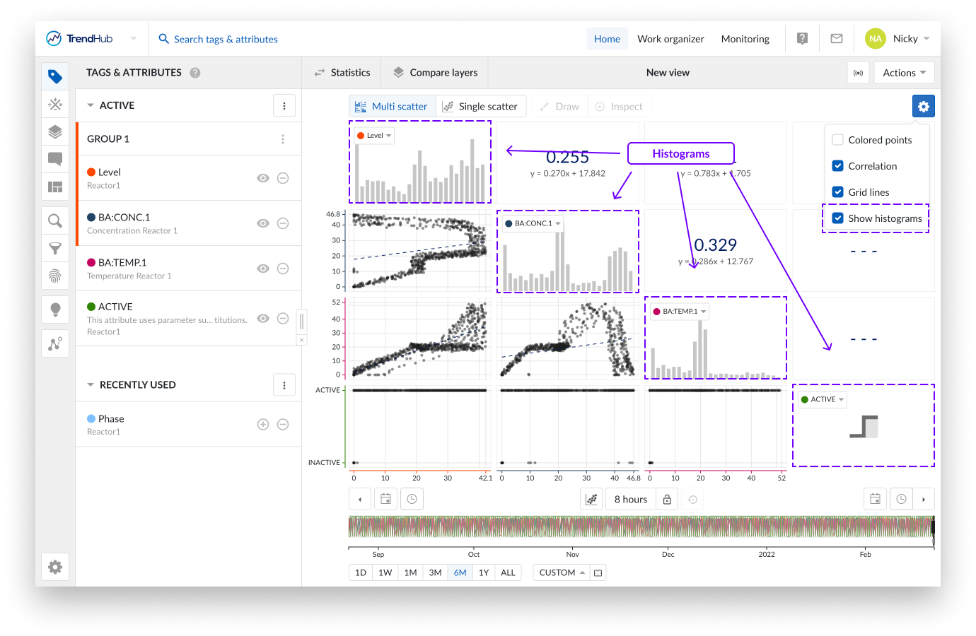

The settings are found at the top right of the focus chart under the blue settings button. For the Scatter chart we have the following available settings:

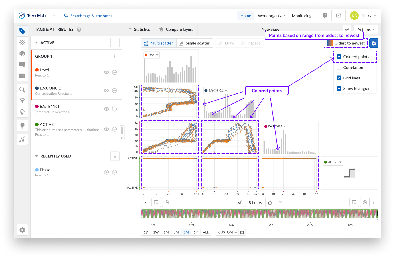

Colored points: When enabling the "Colored points" option, the color of the scatter plot data points are displayed in blue to orange, instead of the default grey/black color. The blue to orange color code indicates the transition from oldest to newest points in time.
This option is disabled by default.

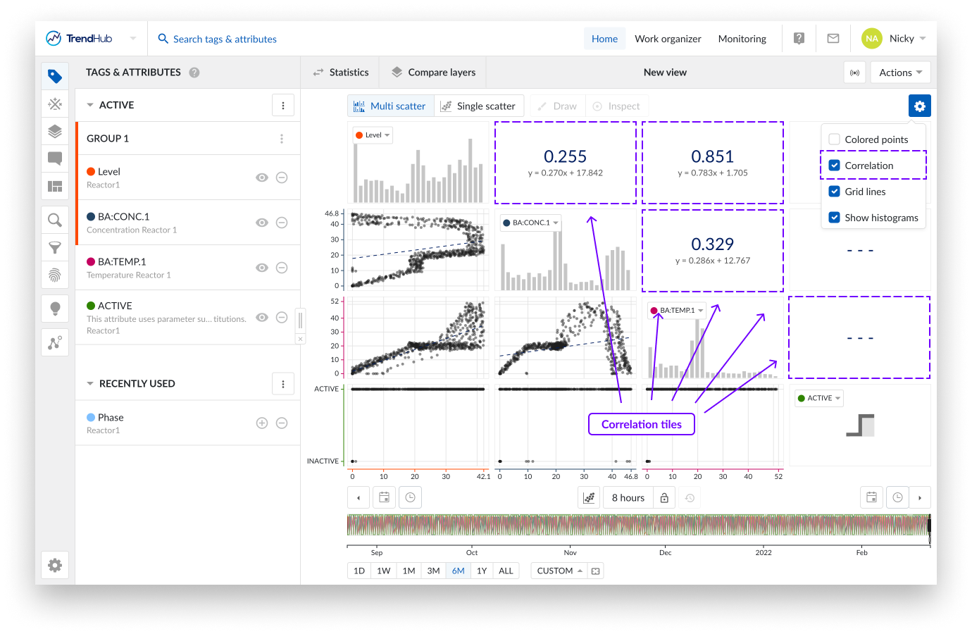

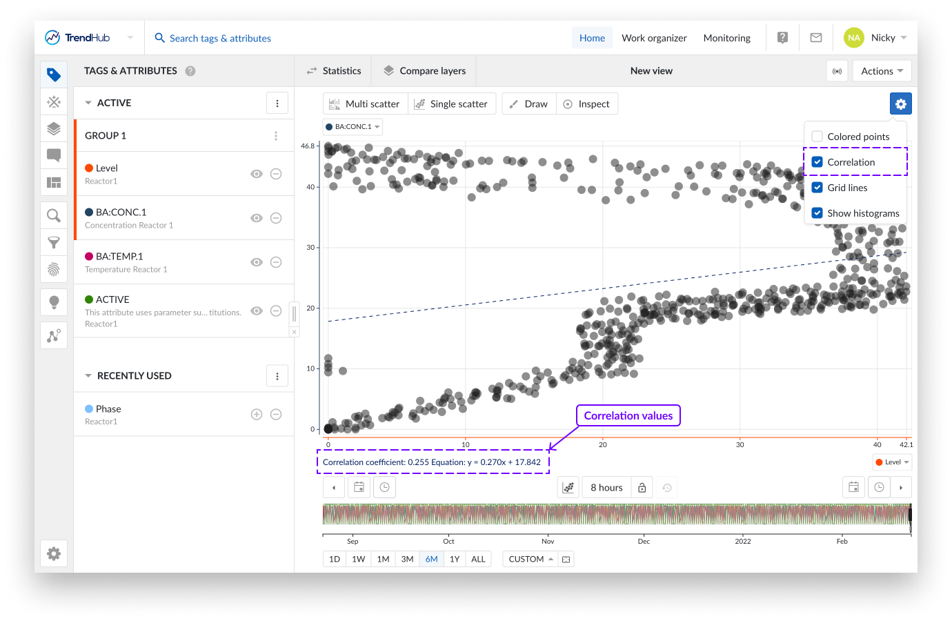

Correlation: When the option "Correlation" is enabled, additional tiles are displayed. These tiles represent the correlation coefficient together with its equation value for a specific scatter plot.
You can easily see which correlation tile is linked to which scatter plot by hovering over the tiles. The two linked tiles will be highlighted with a blue border.
When a single scatter plot without histograms is visualized, the correlation tile is not shown. Instead you can see the correlation coefficient and its equation value on the left below the chart.
This option is enabled by default.

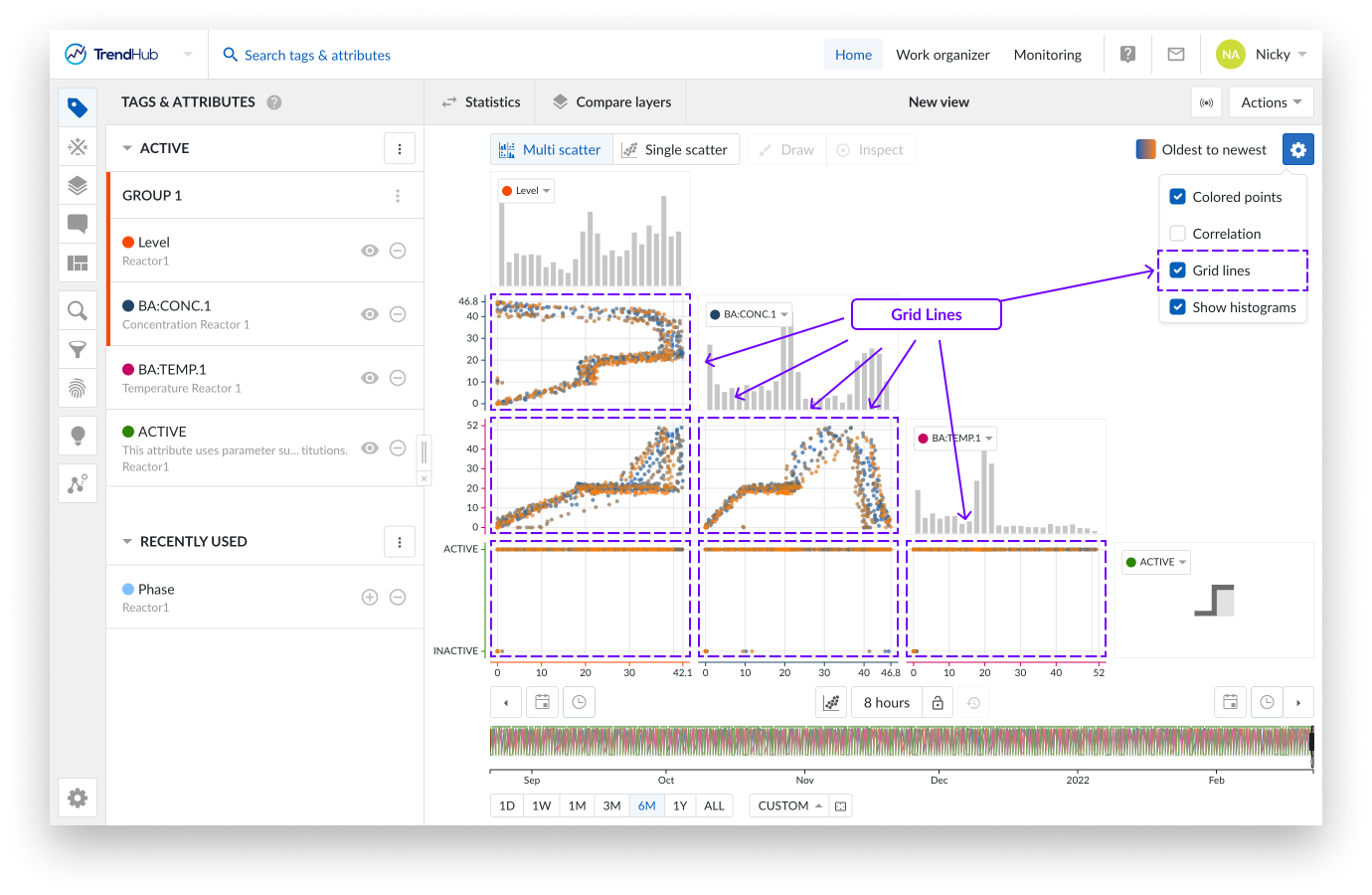

Gridlines: Once the "Gridlines" option is enabled, gridlines appear on the single scatter charts, making it easier to read values on the chart.

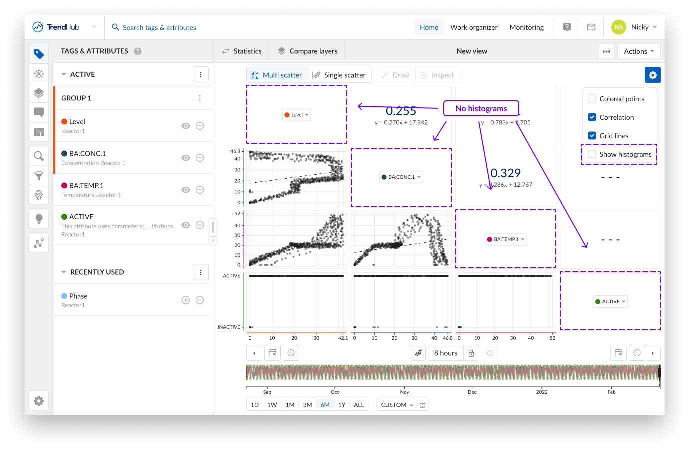

Show Histograms: The "Show histograms" option can show or hide the histograms.

The stacked trend plot is the default visualization mode. The mode can be changed by clicking the focus chart visualization mode button underneath the chart.
In stacked trend plot mode, each tag or attribute receives an individual swim lane on the chart to visualize its time series data.
As displayed on the image above, you can see three swim lanes. By default, each of these swim lanes represent one tag or attribute. On the left of each row, the y-axis is located. By default, the y-axis of each tag is set to the auto scale setting which makes sure all data is visible. The auto scale updates when needed.
The scale setting can be changed for each tag individually (auto or manual scale) and will be remembered for future sessions. Beneath all the swim lanes an x-axis is shown, which represents the date and time range of the visualized focus chart.
A second visualization option is Trend.
In the above image, you can see the equivalencies with the stacked trend. The main difference is that for this chart, all tags and attributes are shown in one large swim lane with labels set above the chart.
Another feature only available in the Trend plot is the ability to visualize (or hide) a y-axis for the second and following tags or attributes on the chart. This is done by clicking the label of that tag in the focus chart.
The third visualization option is the scatter plot. The (multi) scatter mode highlights correlations between the different visualized tags for the selected time period. More details about the scatter plot can be found on this link.

Per chart there are different settings you can modify to fine-tune the chart to your liking. The settings are found at the top right of the focus chart behind the blue settings button.
For the "Trend" and "Stacked trend" chart the following settings are available.
Context items: When enabling the "Context items" option, the context items associated with the period you have visualized will appear on the chart. This option is enabled by default for both time series visualization modes.
Many context items will impact the performance of the chart.
Trendline filling: By checking the "Trendline filling" option, the area under the curve of each tag and attribute will be filled with a shaded color. This option is enabled by default for the Trend charts.
Gridlines: Selecting this option places gridlines onto the chart, making it easier to read the values. This option is disabled by default for both time series visualization modes.
The settings of the different visualization modes are saved separately for your user, which means you can have one setting enabled for one mode while that same setting is disabled for the second mode. The options will be saved and reused in your next session.

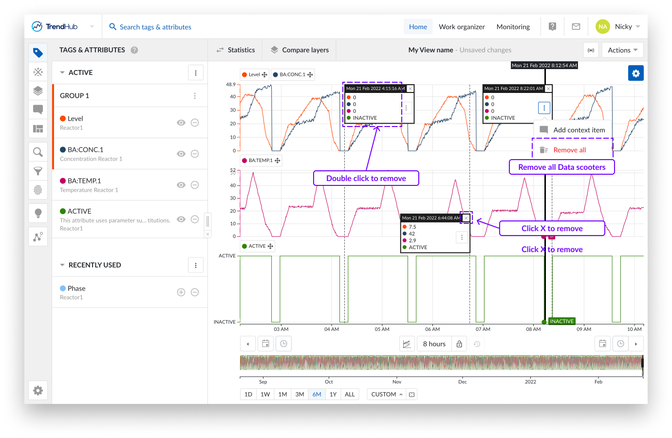

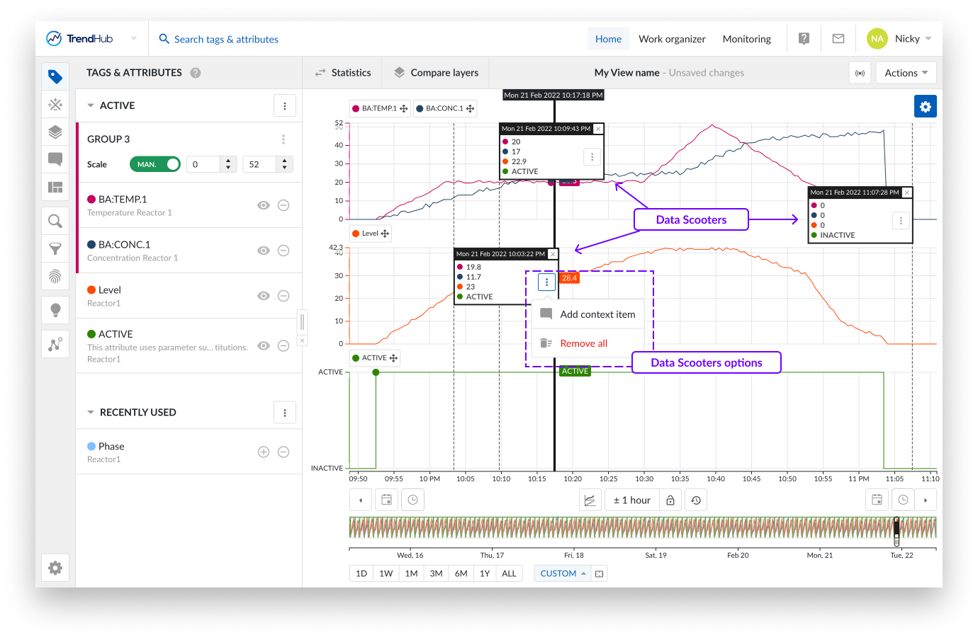

Data Scooters
Data scooters are boxes on the focus chart that contain the values of all the visible tags and attributes at a specific time on the base layer.
For analog tags, values are linearly interpolated. For discrete, string and digital tags, the value of the last recorded point is displayed.
You can create an unlimited number of data scooters to compare your values of the base period at every moment in time.
Adding data scooters is done by double clicking anywhere on the focus chart (Trend and Stacked trend plot).
A data scooter with the wrong timestamp can be frustrating. Because of this reason each data scooter can be grabbed and dragged to another position on the focus chart.
When a data scooter is created, you will see the three vertical dots button. Clicking this button reveals the options for the data scooter:
Add context item
Remove all
Is a data scooter showing the start of something that is going wrong? Mark it with a context item. Clicking the data scooter's "Add context item" button will start the creation of a context item.
The advantage of creating a context item in this way is that the start date and time are automatically filled out for the context item you are trying to create, after entering a context item type. An end date and time can be set after the creation of the context item.
More information about the creation of context items can be found here.
A single data scooter can be removed in two ways. Double click anywhere on an existing data scooter, or click on the cross button in the top right corner of the data scooter.
It is also possible to remove all data scooters at once. To do this, click on the three vertical dots button in any of the available data scooters, which reveals the data scooters option list. Click the "Remove all" option to remove all data scooters.
When data scooters are used on large zoomed out periods with rapidly varying data, the accuracy of the values displayed on the data scooters are limited. Best results are obtained by zooming in on the desired period.
You can create a selection on the focus chart by dragging and dropping your mouse over the focus chart. While doing this you can immediately see a grey box appear on the top left corner of the length of period you are creating.
Once completed, you can see a "highlighted" period, and a popup that provides you with actions that can be applied to the highlighted period.
You have the following options:
Zoom: This option will zoom into the selection on the chart you have created.
Add context item: Did something happen in the selected period? Mark it with a context item. Clicking this option will start the create context item flow.
The big advantage of creating a context item in this way is that the start / end date and time are automatically filled out for the context item you are trying to create, after you enter a context item type.
Weight: Increase the density of the tags and attributes in that period. Weights are used in similarity searches, to increase the importance of that selected period.
More information about weights and similarity search can be found here.
Manual filter: With this filter option, you can exclude the selected period (or include it again). Filtering out periods removes them, ensuring that they are not used in any subsequent analyses in TrendHub (e. g., statistics / compare layer table, searches, etc.)
Filtered out period settings can be saved, meaning you can use them in later sessions.
More information about filters can be found here.
