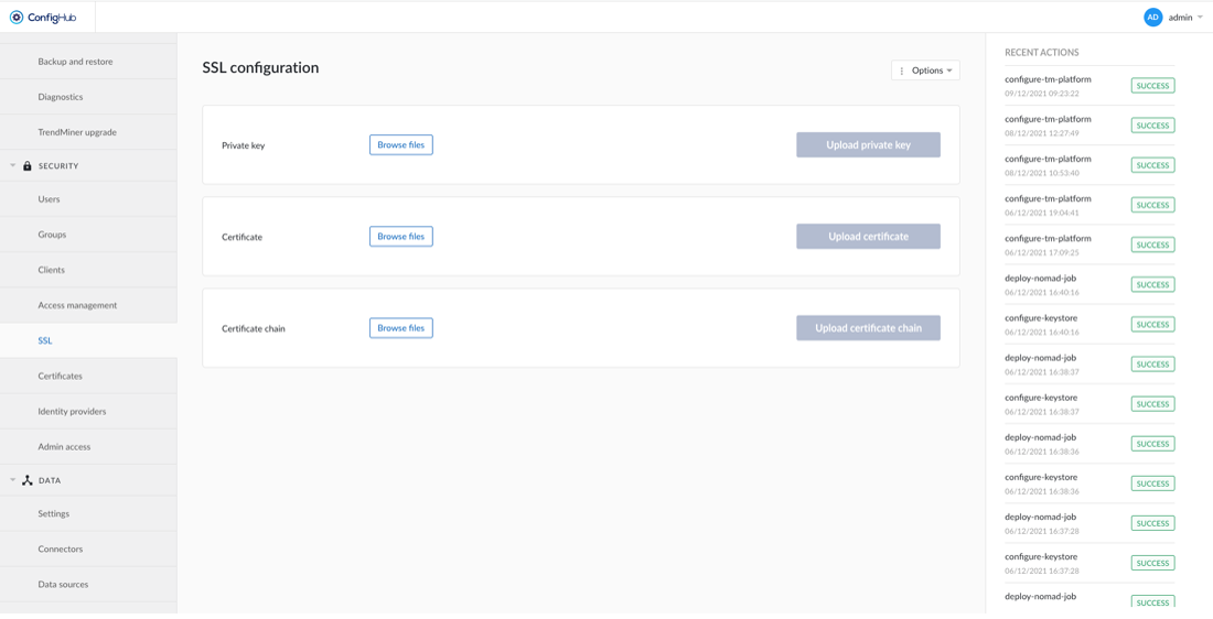

  • Private key
  • CSR for that private key
  • Certificate chain
Generating a CSR is the responsibility of the customer. It's not feasible for TrendMiner to do this.
The web server software (Apache) only supports PEM certificates. OpenSSL can be used to convert certificates in a different format to PEM.
Once these prerequisites are fulfilled, HTTPS can be enabled via the "Options" menu on the top right.
For a more detailed guide of what is, why and how to use SSL in TrendMiner, please look to this document.SSL configuration

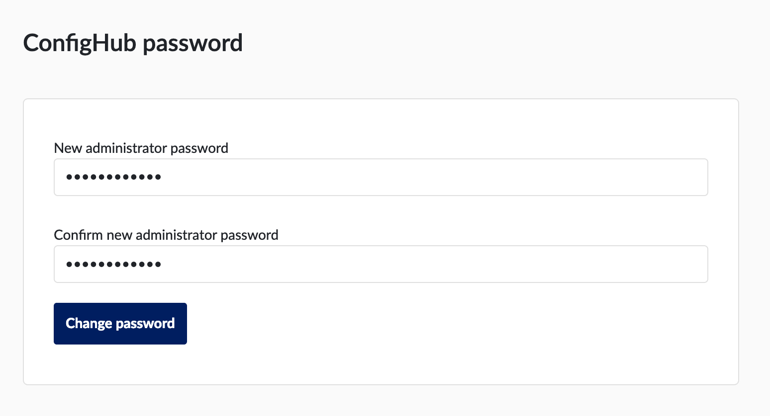

Via Admin Access the password for the ConfigHub admin user can be changed.
To change the Administrator password of ConfigHub, navigate to the security menu and click ‘Admin access’. Enter the new password twice and click ‘Change password’.
