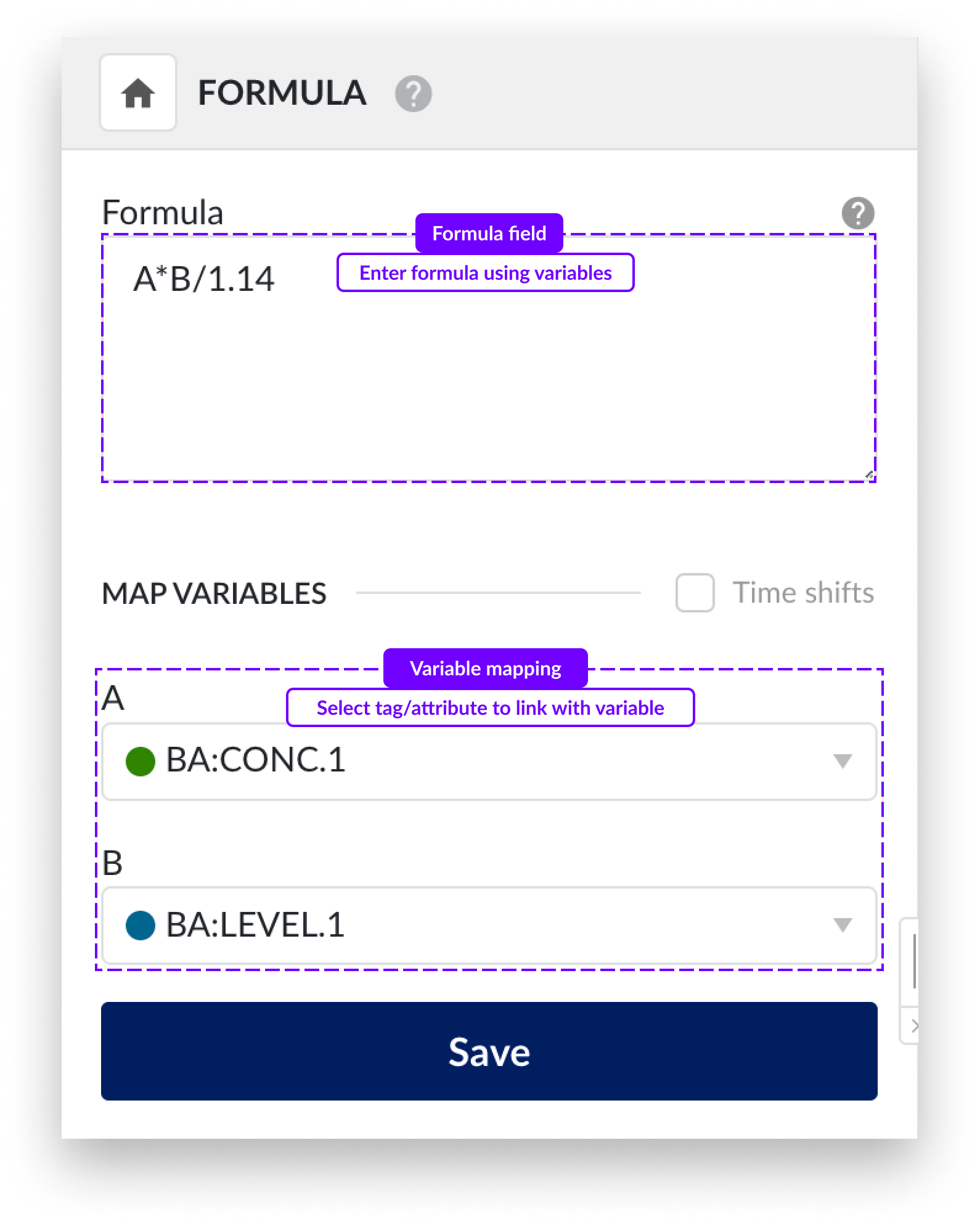

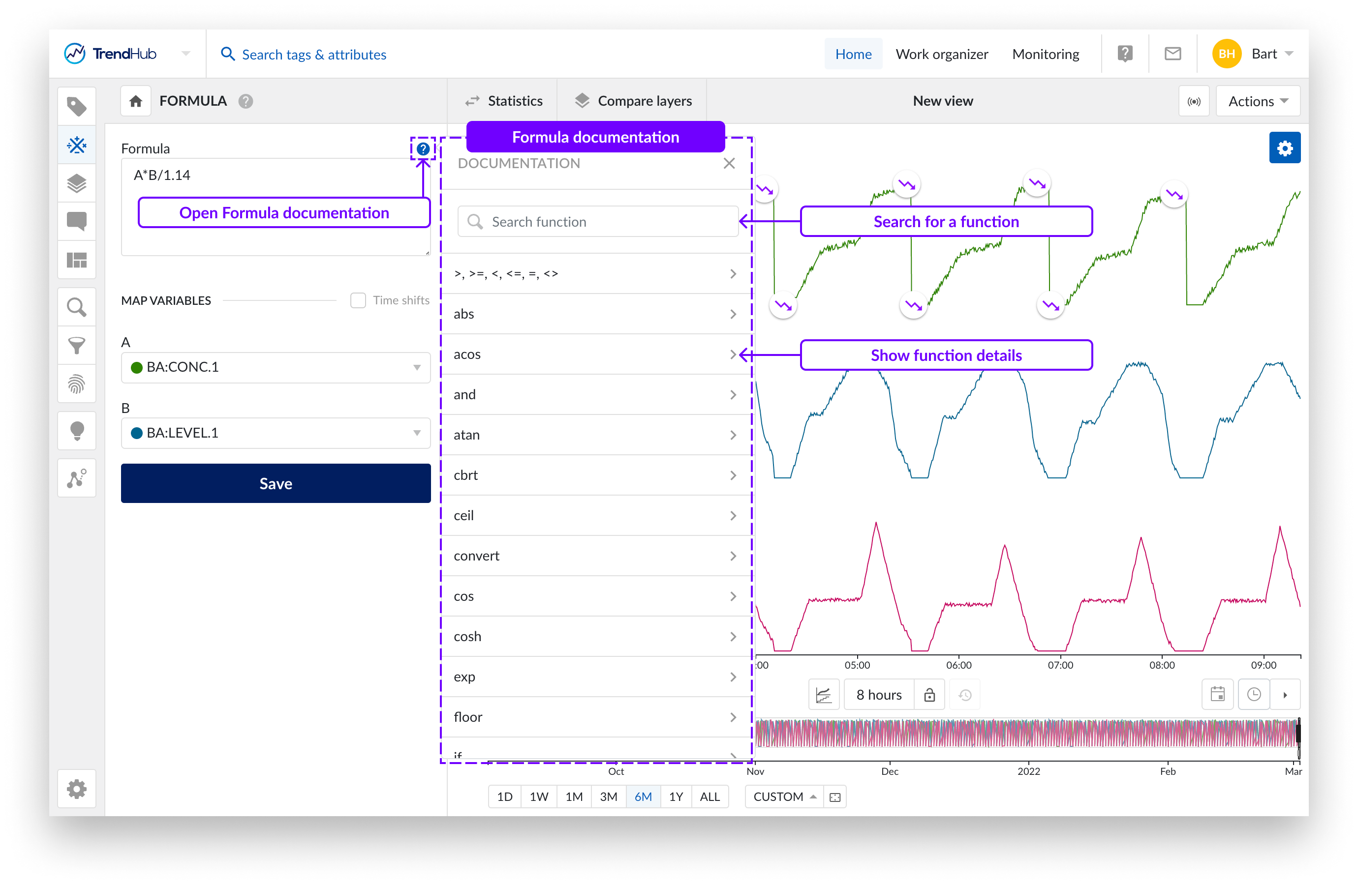

Formula-field: In this field you can enter your desired formula using variables. Any entered variable will show up as a "Map Variable"-field in the section below.

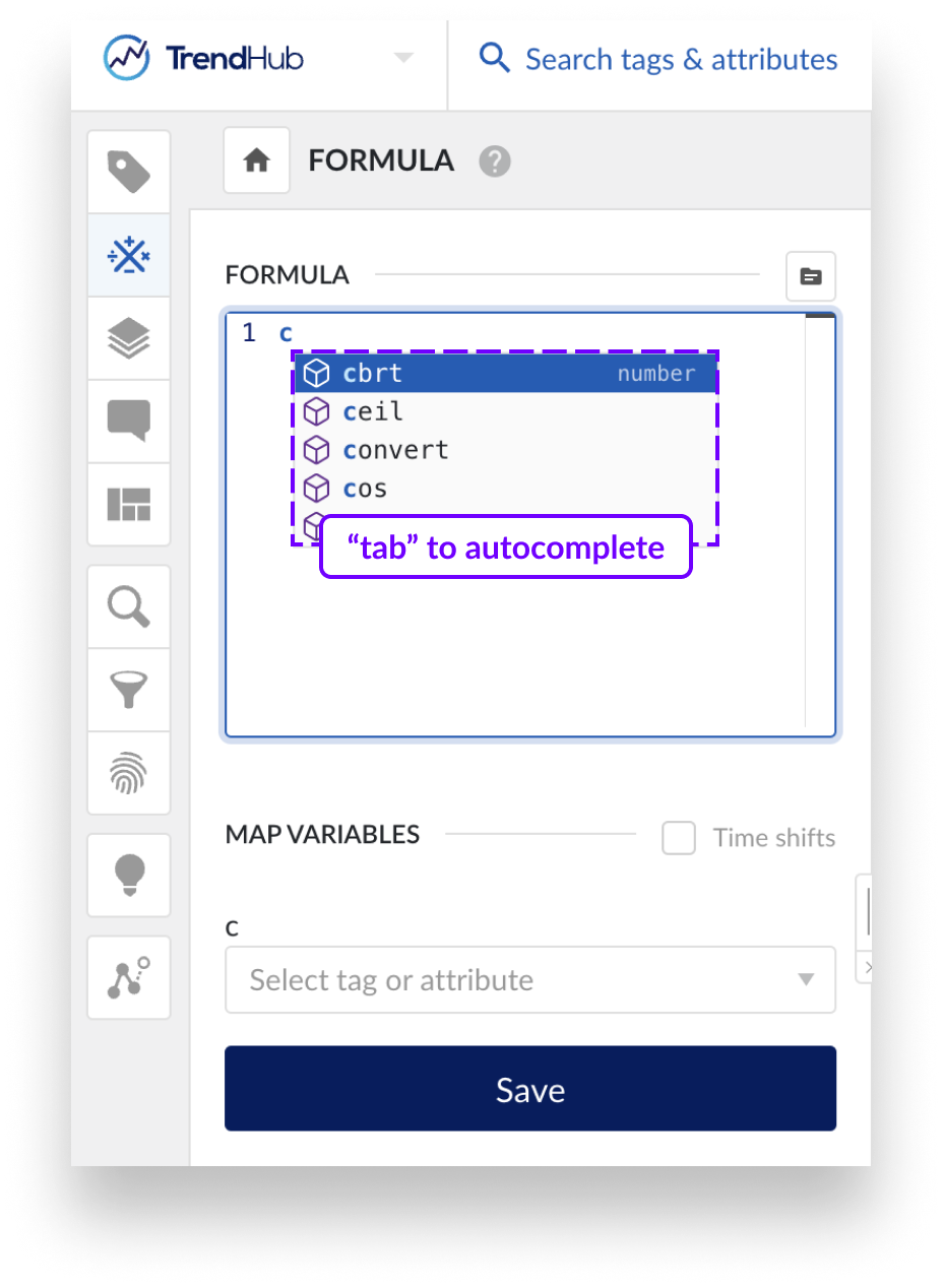

Next to variables the field also accepts pre-defined functions you can use, see "Functions" below for more details. Autocompletion of functions are also supported. Pressing the "tab"-key on your keyboard will fill out the selected function.

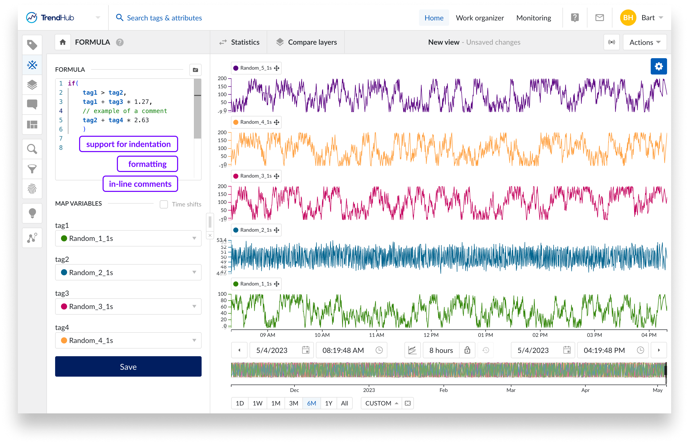

The formula field supports the formating of your formula like a code editor. This allows you to indent and even add comments to your formula.
Clicking a variable, function, will also highlight other occurrences inside the formula. For parentheses, only the matching parenthesis is highlighted.

Map Variable: As soon as a variable is entered in the formula-field, you can map the variable to any existing tag in TrendMiner. The mapping-field allows you to quickly select a tag from your active list or to search for any tag.
Currently a maximum of 10 variables can be mapped.

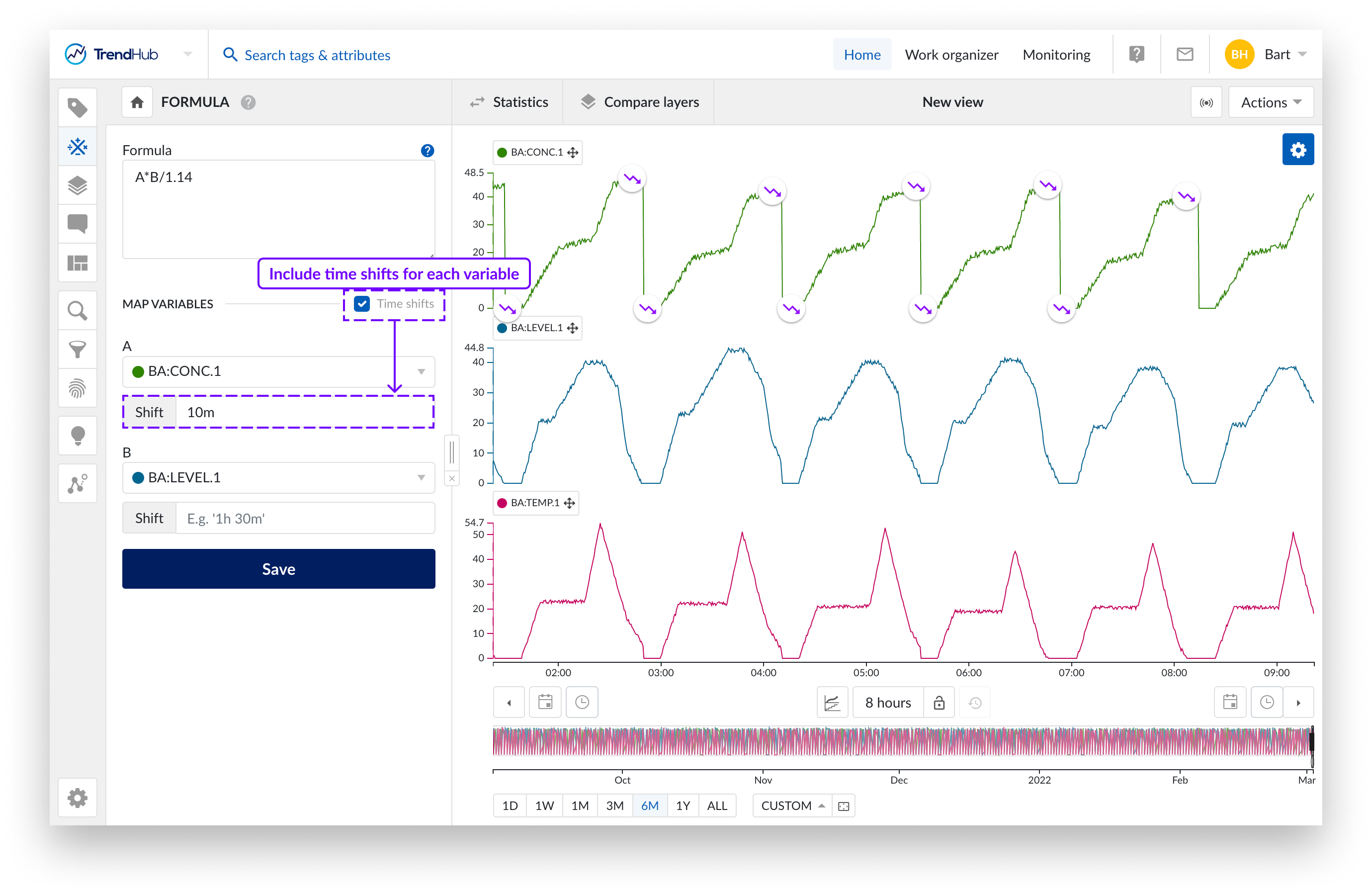

Timeshifts: This checkbox allows you to include timeshifts for any mapped value. The default behaviour of the formula computation is to take values at the same timestamp for all mapped values.

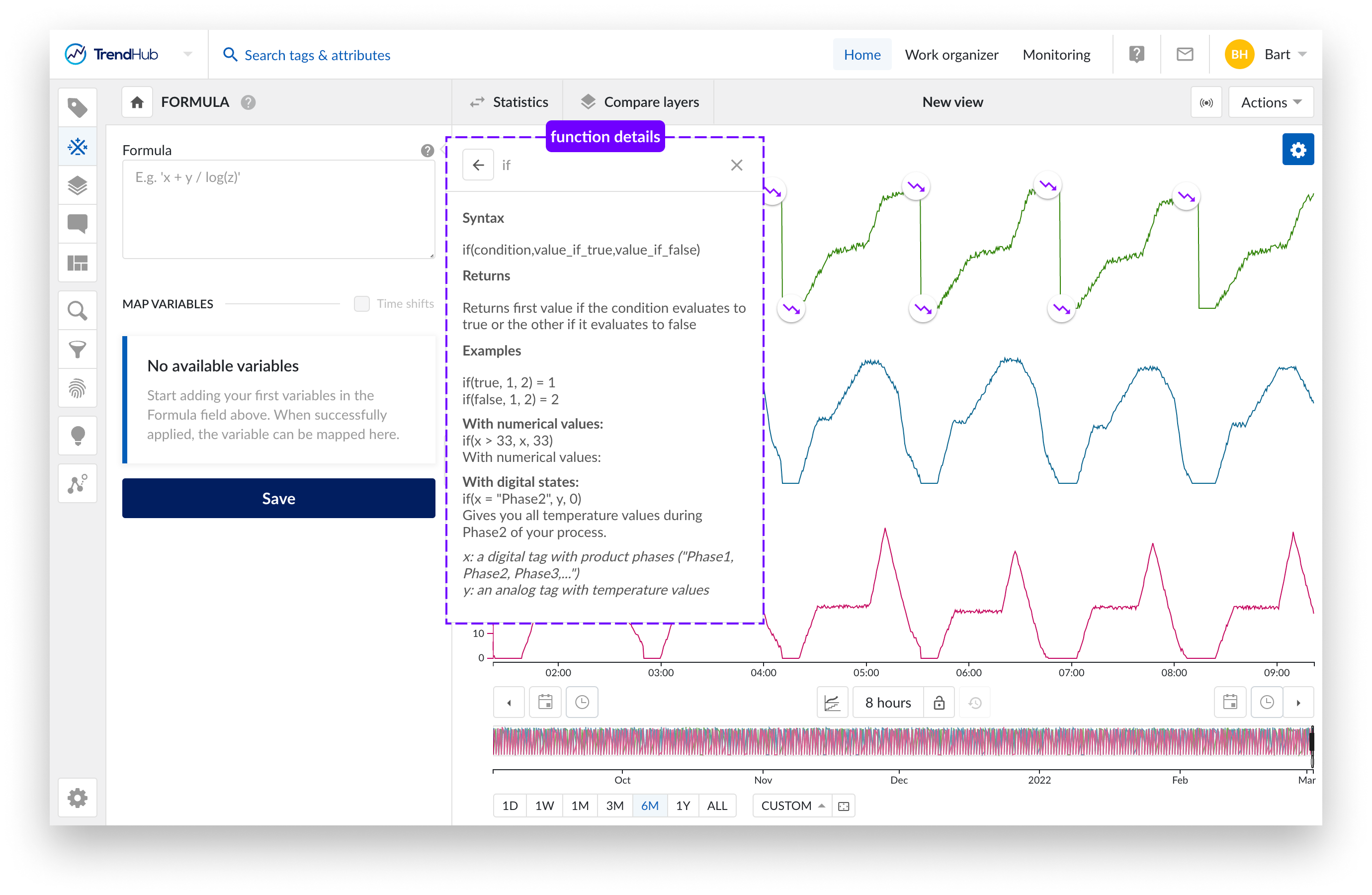

You can enter certain keywords in the formula-field that act as a predefined function. Click the "?” spot to open the documentation of the built-in functions. Here you can see all the available functions and learn how to use them.

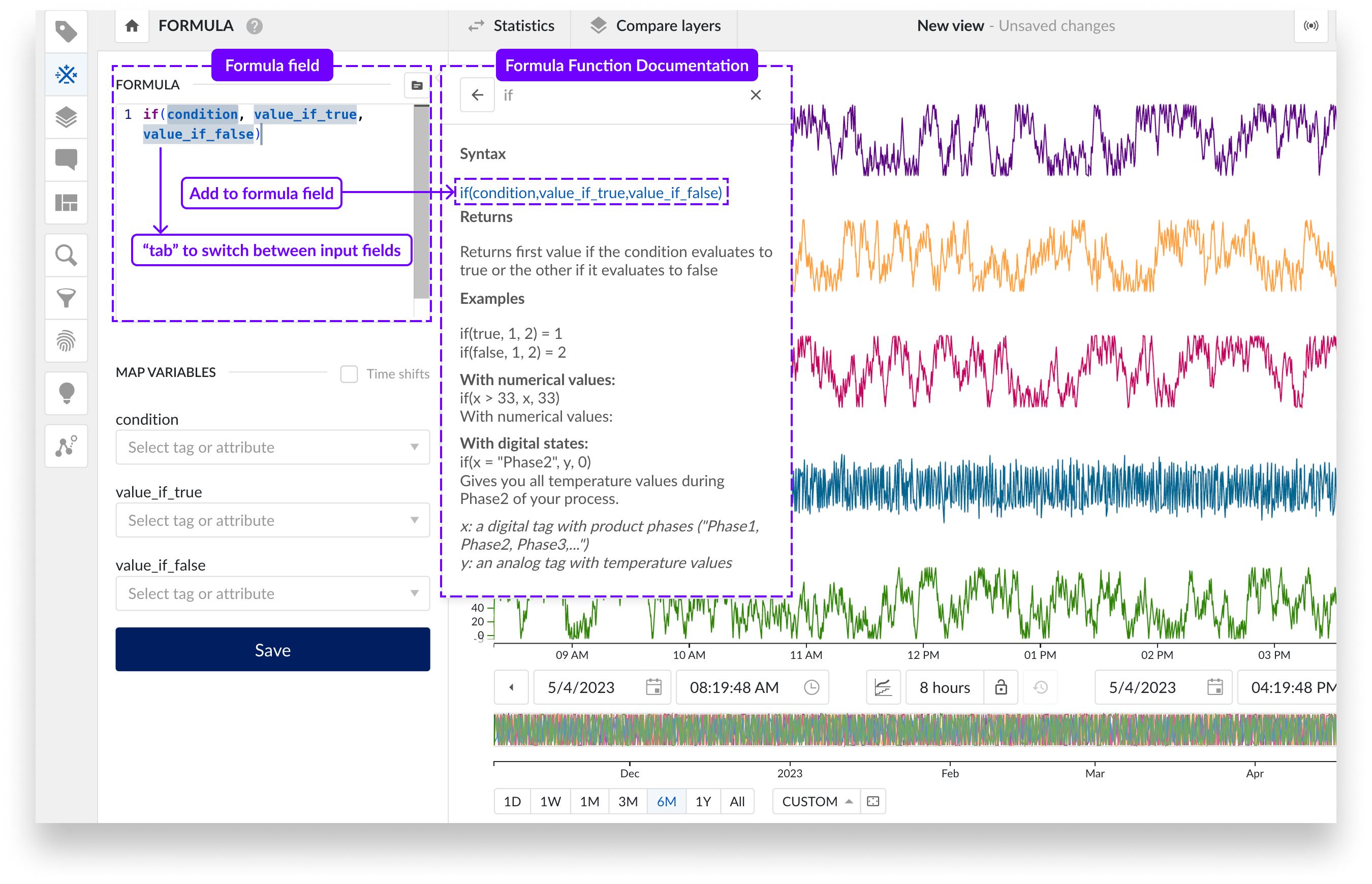

From the function details documentation, you can automatically add the function to the formula field by clicking the syntax example.
When adding a function from the documentation, the input parameters and expressions for the function are included as a placeholder. These placeholders can be replaced by directly typing in the desired info and pressing "tab" via the keyboard to switch between the different parameters and expressions.
For functions that accept two or more inputs, only the first two parameters and expressions placeholder are added. For example: the max() function can accept up to 10 different inputs, but only two placeholders will be shown.
