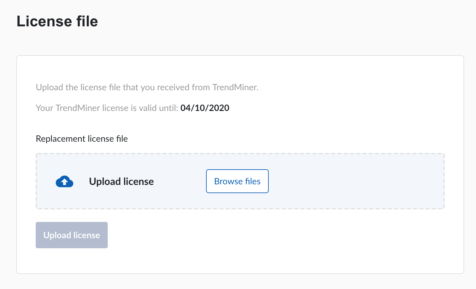

Updating the license can be achieved by clicking the “Browse files” button to select a file from your file-system, and then clicking “Upload license”.
Contact the TrendMiner Customer Success team for more information concerning your license.

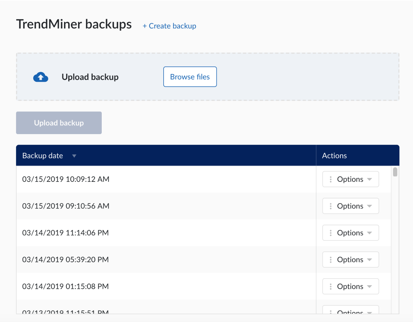

The TrendMiner Appliance automatically creates a backup before an update. However, we always advise to take a backup manually when changing important configuration such as the configuration of an external identity provider or doing an uninstall.
It is also advised to periodically create and download a backup manually in case major system failures render the system unusable.
With the "+ Create backup" link located at the top, a manual backup can be created. Backups that are created, are stored on the system until they are removed (available as "Delete backup" under the options menu of that backup). Backups can be downloaded with "Download backup" in the options menu of the backup.
To restore a backup, click ‘Restore backup'. Old backups can be uploaded to the TrendMiner Appliance by clicking the ‘Upload’ button having selected the backup to upload.

Uploading a backup does not restore that backup immediately. To restore a backup, click ‘Restore backup’ in the options menu.
Warning
Always check the available disk space when uploading or restoring a backup. Restoring a backup will fail when there is insufficient disk space left. The available disk space must be at least the size of the backup after extraction. We recommend having at least the same disk size as the installation the backup originates from in case of doubt.
The original backup date/time is not part of the backup itself. The date and time of the upload will be used to identify the backup.
The time displayed for the backup is always server time.

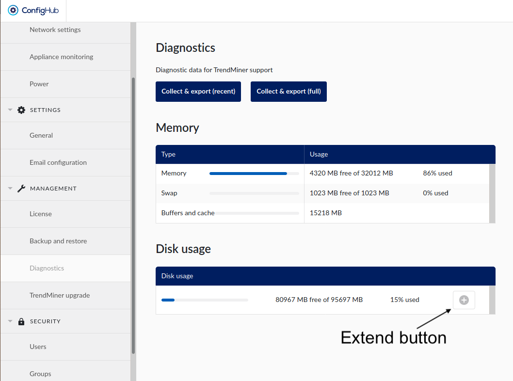

When opening support tickets, extended logging information should be provided. Press the ‘Collect &amp; export’ button in the Diagnostics section to download this.
The Memory menu option shows information on the appliance memory usage.
After a fresh TrendMiner install, the disk space needs to be extended via ConfigHub because TrendMiner does not block the needed disk space by default in the beginning. Please check out minimal system requirements for the exact disk space which needs to be reserved.
Once the first disk is filled up completely. The original disk can never be extended because TrendMiner cannot change the partition table of the disk containing the root filesystem. A second virtual disk needs to be added to the TrendMiner appliance first. After adding a second virtual disk, the disk space for TrendMiner can be extended via the 'Extend' button on the interface.

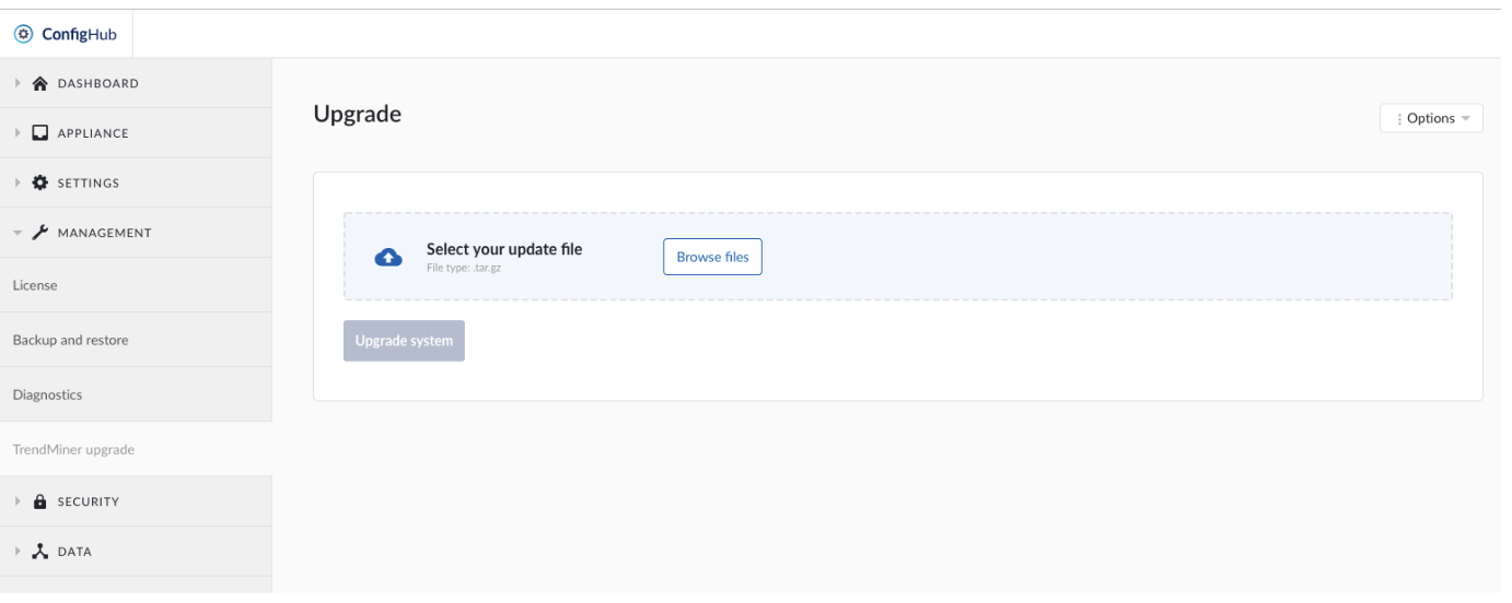

The TrendMiner Appliance can be upgraded through ConfigHub. The majority of TrendMiner updates will be distributed this way. However, when large back-end changes have been done, updating may require a new appliance into which the old data is imported. Please check release notes and update guide before starting an upgrade.
We highly recommend taking a backup before upgrading
Use the 'TrendMiner upgrade' section in ConfigHub to select an upgrade package from the file system. Click 'Upgrade system' to apply the upgrade.
To restore a previous version of the application, also use the upgrade functionality as this will replace the current TrendMiner version with the one contained in the update archive. If a previously working TrendMiner version fails to function, this is most likely caused by an incompatibility in the data formats. Restore an old backup to resolve this issue.

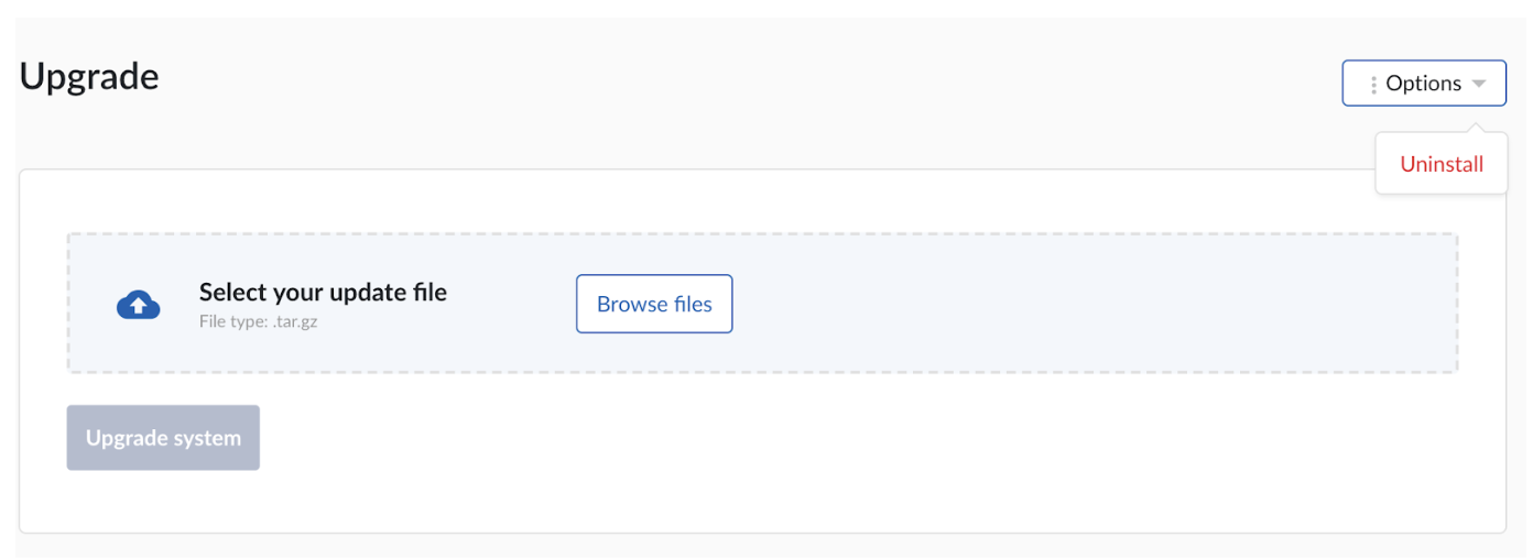

Under the options menu on the top right an "Uninstall" option is available. This uninstall will remove all services except the ConfigHub service and allows the performance of a downgrade.
We advise never to do a downgrade without contacting our support at support@trendminer.com as sometimes ConfigHub itself will not downgrade and might be incompatible with other downgraded services.
Always create and download a backup of your installation before performing an uninstall.
