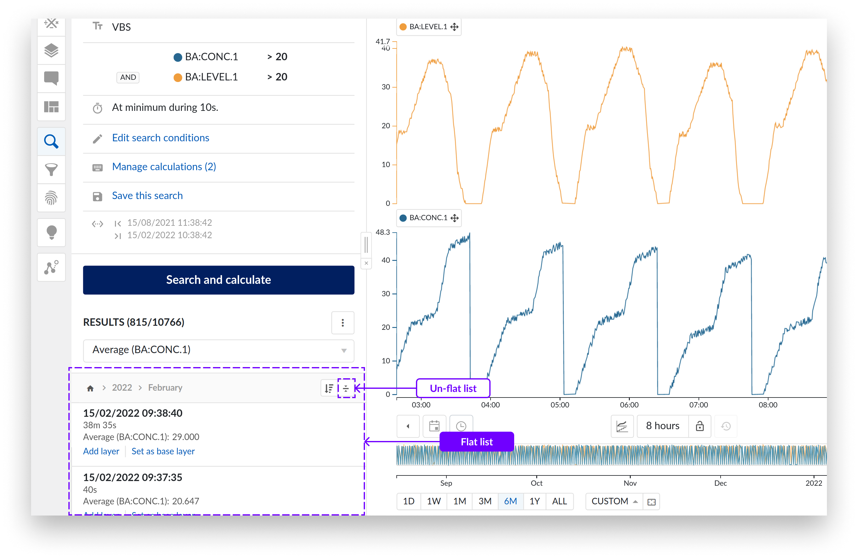

To visualize the search results at a specific bin level in 1 long list, click the flattening icon shown in the next screenshot. The flattening action will be applied to the bin and its sub-bins you are currently visualizing.
E.g., If you click the flattening button while you are in the February bin, all results of February will be visualized in 1 list.
To see the February bins again, click the flattening button.
  • You can scroll the list until you find a period of interest. You can then select the results within the bins and explore the data graphically within the focus chart or perform other actions with the selected results, see Performing actions with the search results below.
To move up in the results list, use the navigate up icon at the bottom right of the results.

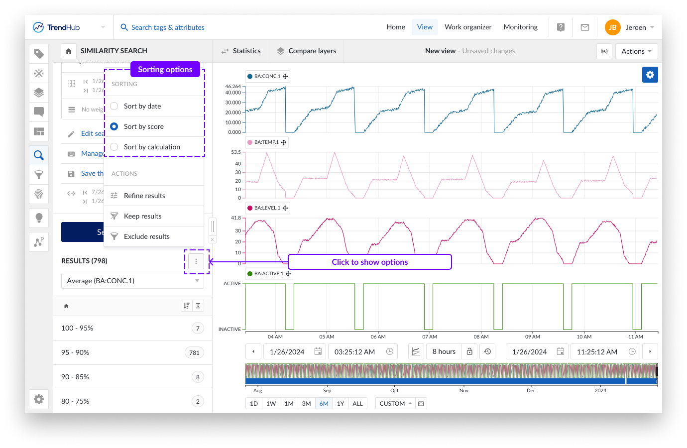

Sorting search results
To change the sorting mode of the results, click the three vertical dots icon situated at the top right corner of the results list. Depending on the search dimension, different sorting options are available:
  • Similarity search: sort by score or date.
  • Value based search: sort by date or duration.
  • Digital step search: sort by date.
  • Context Item search: sort by date or duration.
  • Operating Area search: sort by date or duration.

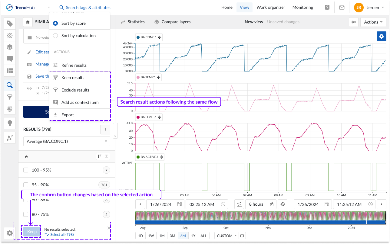

Besides the sorting options, the following actions are available for the search results when clicking the three vertical dot icon.
Refine results
This option provides the possibility to visually refine your results based on aggregated values of the search results (i.e., the duration, score, and available calculations).
How to refine results is explained in detail in this article.
Keep results / Exclude results
With this option you can filter out specific search results or keep certain search results.
This is done by creating filters for the periods between the search results (Keep results) or to create filters for those search result periods (Exclude results).
Add as context item
With the "Add as context item" option, you can create context items for all the selected search results.
Export
As the final option, you can also export all search results into an Excel file.
All of these actions use an analogous way of working. Once an action is selected, you can start selecting the desired search results for the action that you have selected.
At any moment you can see how many search results are selected and can easily select all search results in the current bin in one click. This is done by clicking the "Select all (...)" option in the footer on the right of the confirm button.
The "Clear selection" option appears once all search results are selected.
Once the desired search results are selected, clicking the blue confirm button will execute the action you have selected.
For the keep/exclude result options you will notice that the filters are being created and added to the unsaved filters section.
For the context item option, a side panel will appear to perform a bulk creation of context items. To complete this option, the side panel needs to be completed and confirmed. The bulk creation of all context items is then triggered.
A notification message will be added to the notification center once the bulk action is completed.
Additional information about the context item creation can be found in this article.
For the export action, a message is displayed to indicate the creation of the export has started. Once the creation of the file is completed a notification center message will be shown. Clicking on this notification will download the export file.
