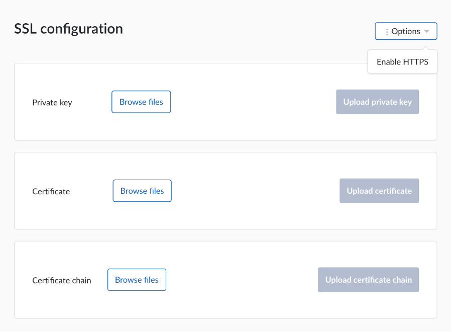

How to enable SSL in TrendMiner
Private key
Certificate
Certificate chain
Typically, your IT department will be able to provide these. A (temporary) solution to create a certificate is offered in the next section, but make sure to align with your IT department first.
The web server software (Apache) only supports PEM certificates. OpenSSL can be used to convert certificates in a different format to PEM.
You can use the openssl tool on a Linux system to convert the certificate to the correct format:
Convert x509 to PEM
openssl x509 -in certificate.cer -outform PEM -out certificate.pem
Convert DER to PEM
openssl x509 -inform der -in certificate.cer -out certificate.pem
Convert PFX to PEM
openssl pkcs12 -in certificate.pfx -out certificate.pem
Convert PKCS7/P7B to PEM
openssl pkcs7 -print_certs -in certificate.p7b -out certificate.pem
Once these prerequisites are fulfilled, browse to ConfigHub and make your way to the Security ==> SSL menu to upload them. After uploading, HTTPS can be enabled via the "Options" menu on the top right.
Enabling HTTPS will temporarily render ConfigHub unusable until the service restart has completed. A manual refresh of ConfigHub is necessary. Press F5 to try to load the interface again. Retry until this succeeds.
