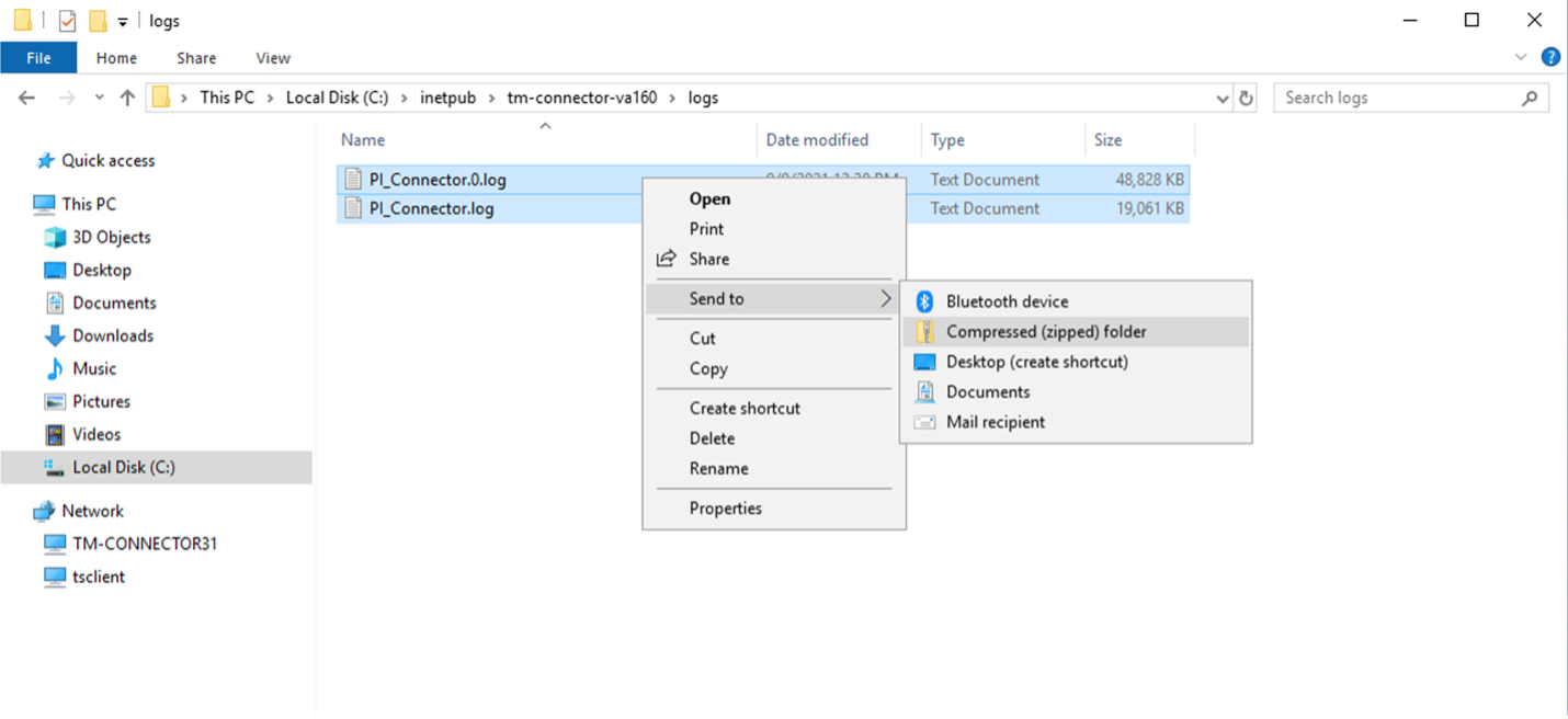

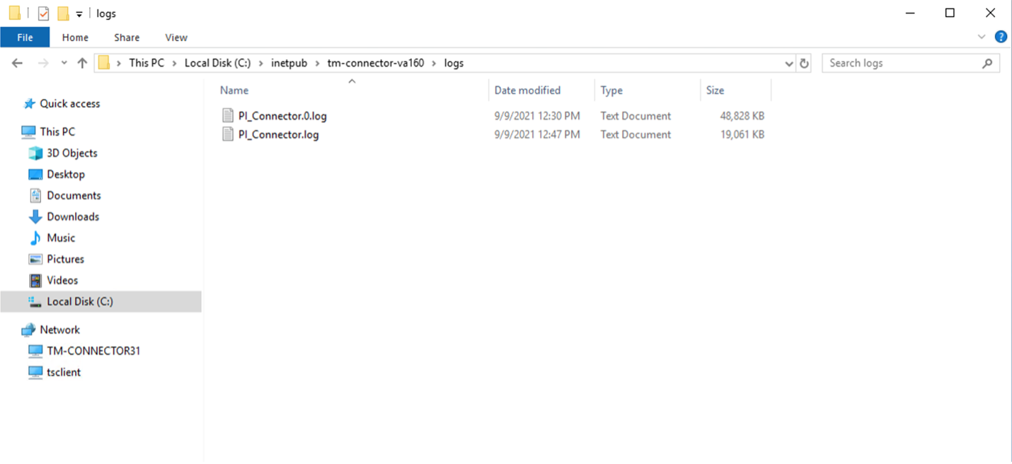

Open the folder 'c:/inetpub/myconnector/logs'
Select all .log files and compress them into a .zip file.

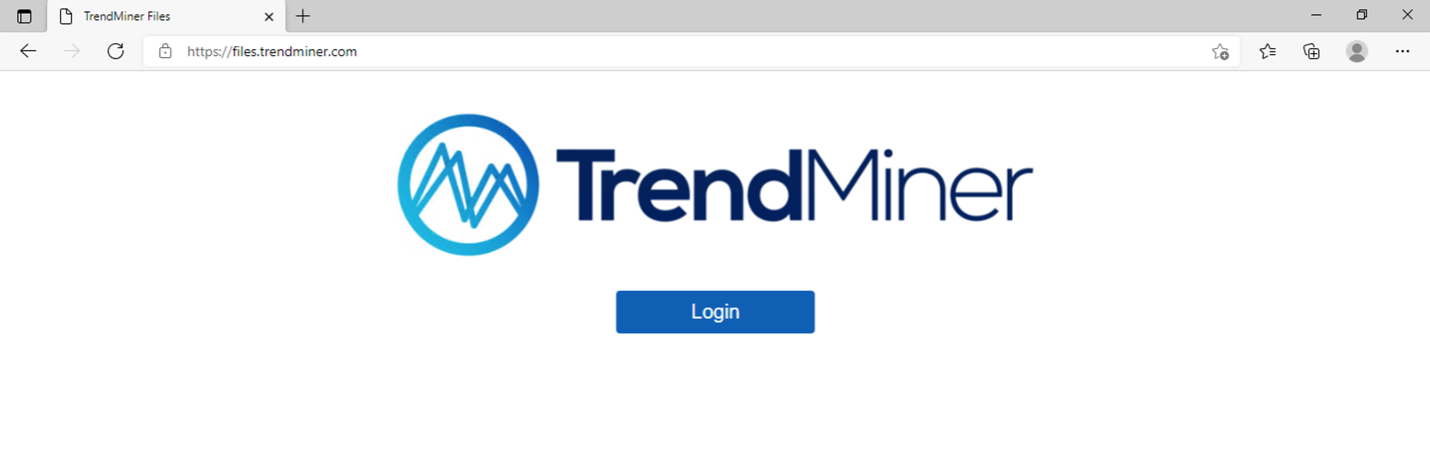

Open the browser and browse to https://files.trendminer.com

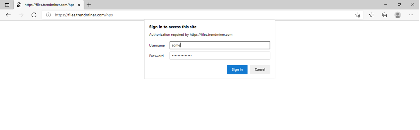

Log in using your TrendMiner file server credentials. If you don't know these or your credentials are not working, please contact your TrendMiner Customer Success Manager or send a support request to support@trendminer.com

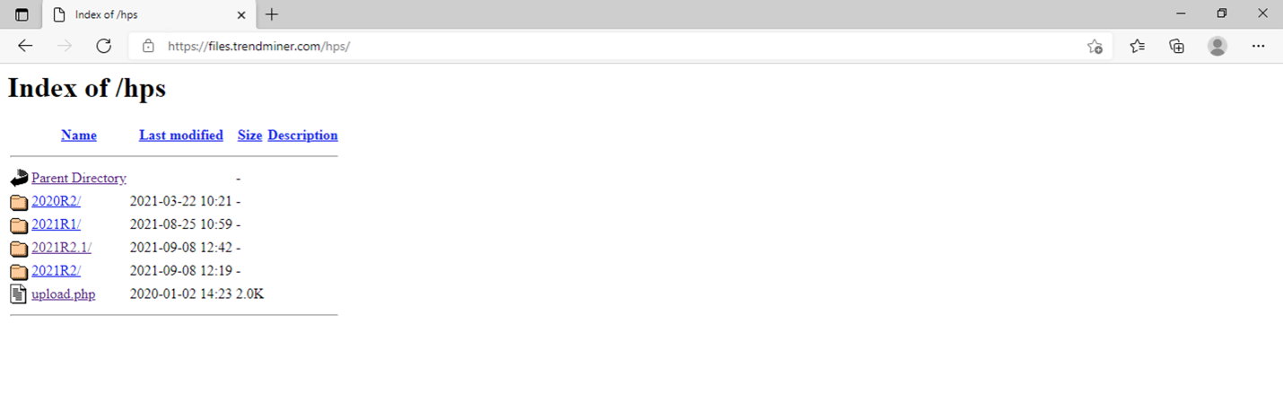

Click on upload.php
