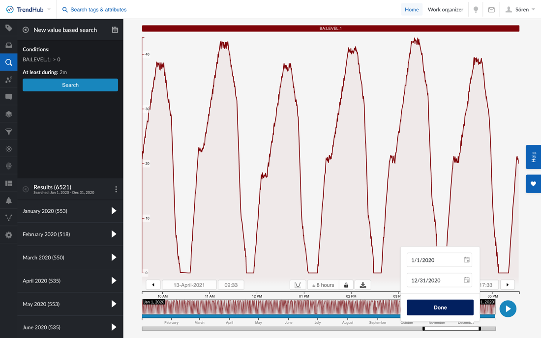

The historic timeframe for search results can be changed in the double slider which can be found on the bottom right of your screen. By default, the double slider covers the most recent 6 months. If you want to search through the process data older than 6 month the double slider setting needs to be adjusted. This can be done by clicking on the white bar and select the desired start and end date of the historic time frame.
The selected historic time frame for search results is shown in the header of the search result list once a search is performed.

Search results in 2020 (adjusted double slider settings)
Search conditions:
Value based search
BA:LEVEL.1 > 0
At least during: 2 min
Search was performed on April 12, 2020
Search results:
The date format in this example is MM/DD/YYYY based on English (US) as browser language. To change the date format the browser language needs to be changed. Most European languages will result in the format DD/MM/YYYY.
