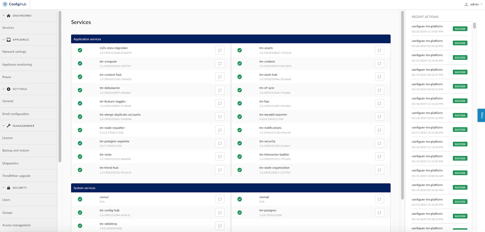

Dashboard
Services
System administrators can easily get an overview of all TrendMiner services, including their version and actual health-status. The restart of (unhealthy) services is also supported via the ConfigHub-interface.
Healthy services are indicated by a green checkmark.
To update the health status of services a manual refresh of ConfigHub is necessary. In most browsers, press F5 to try and load the interface again.
The recent actions panel on the right shows the status of the restart and is updated live (no refresh is needed).
Restarting tm-config-hub will temporarily render it unusable until the restart has completed. A manual refresh of ConfigHub is necessary. Press F5 to try to load the interface again. Retry until this succeeds.
