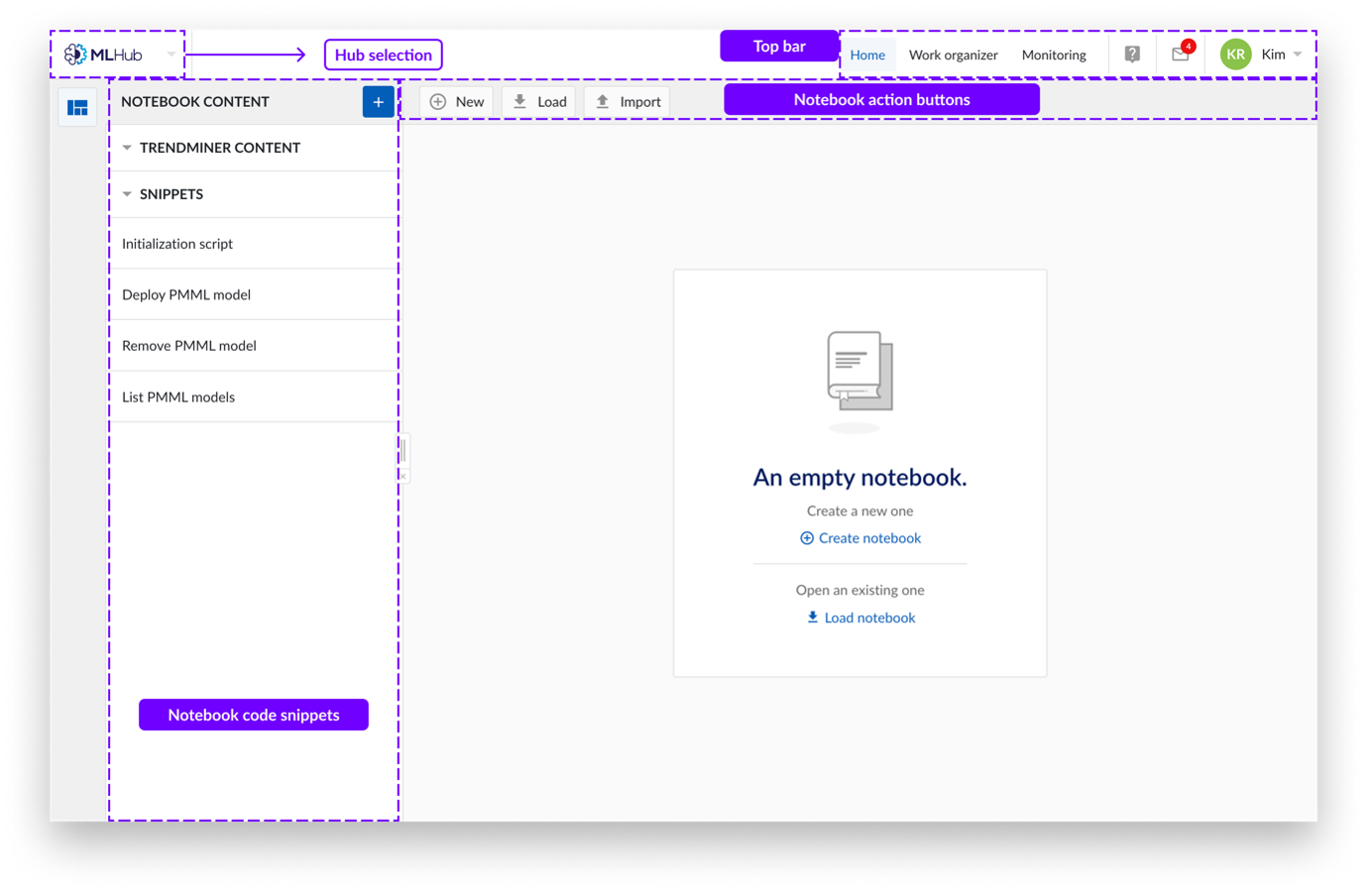

In the top left corner of the TrendMiner environment you find the Hub selection button. Here you can select to which hub you want to navigate.
Click on the "MLHub" button.
In the top right corner, you find the rest of the top bar. This remains the same in all TrendMiner hubs.
Just beneath the top bar, the notebook action buttons are present, to create, load and import notebooks.
On the left side of your screen estate, you will find notebook snippets. These are predefined code blocks to use in your notebooks. See “code snippets” below.

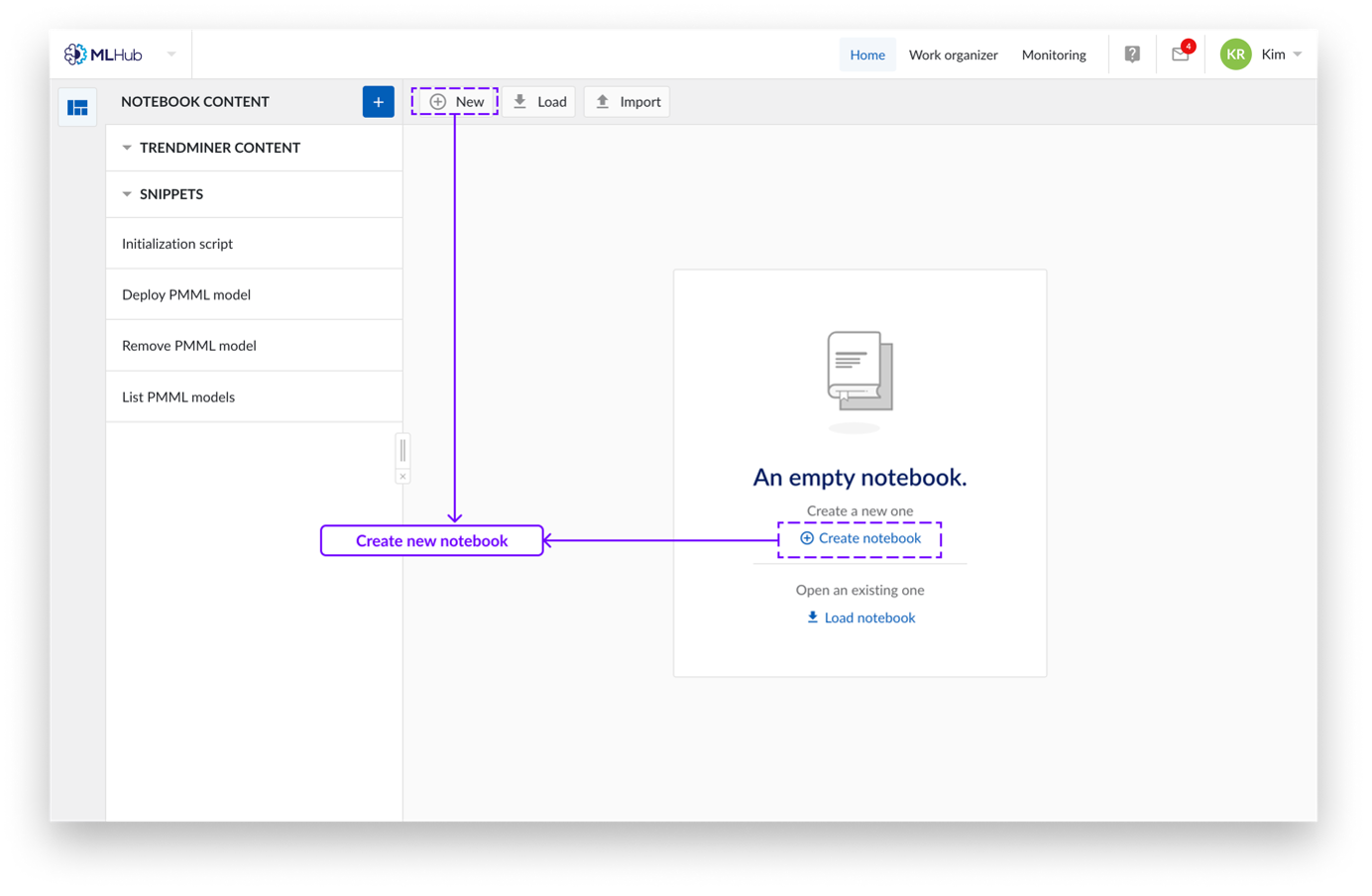

On the Homepage of MLHub, you can either create a new notebook, load or import an existing note. A new notebook will be always empty.
  1. Enter the Home page of MLHub.
  2. Click on the "New" button or on the “Create notebook” indication. A panel appears from the right of the screen.
  3. Populate the open fields and select a work organizer folder to store your new note.
  4. Click on the "Create" button.
  5. Select the kernel configuration you would like to launch.
We offer kernels including preinstalled visualization packages. We recommend you launch with the “Python with Visualization Libraries on Kubernetes” kernel.
  • Confirm your selection by clicking “select”.
A new notebook will open onto which you can write your python code. You may like to introduce our boiler-plate code which loads highly recommended packages, as you will need it to read in the TrendMiner content. You can add this code by clicking the snippet button  “initialization script” from the snippet menu on the left.

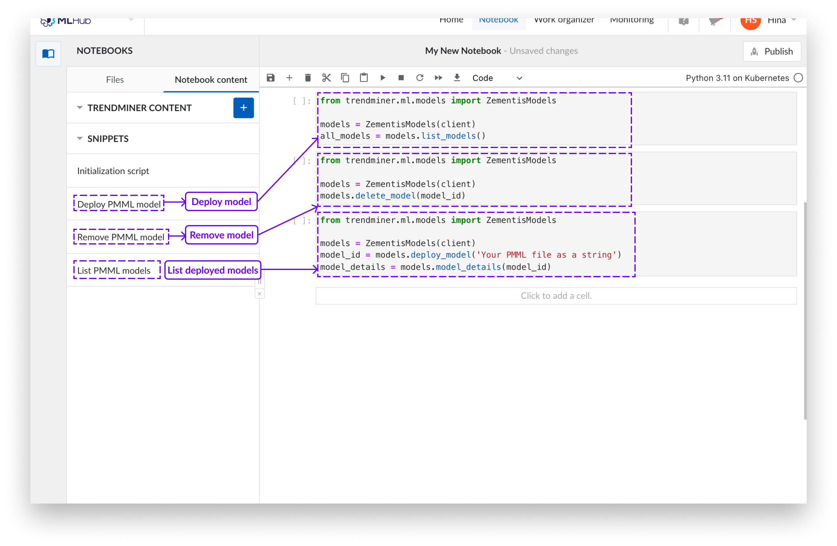

Snippets
Currently snippets are applicable in python kernels to deploy machine learning models.

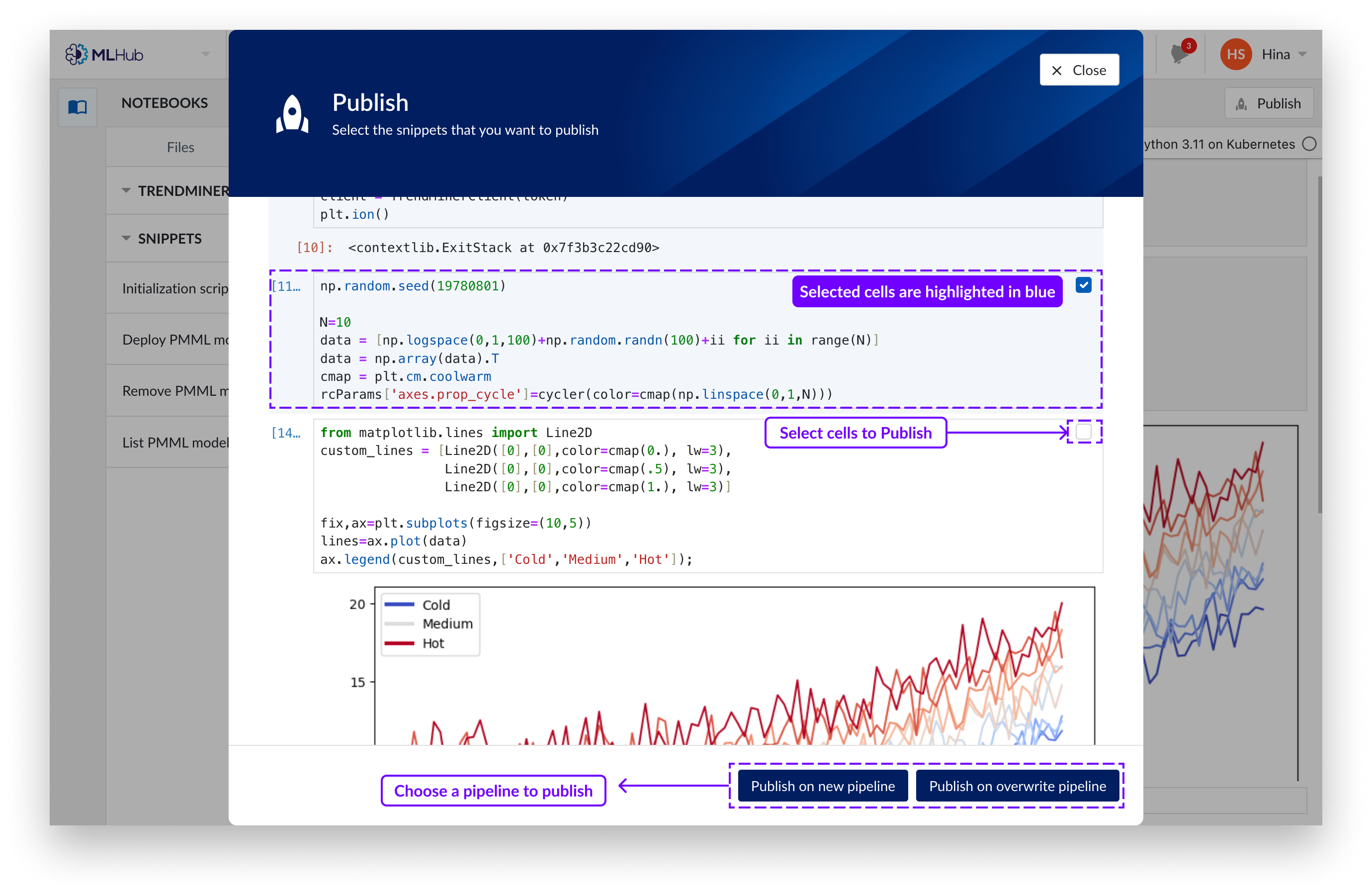

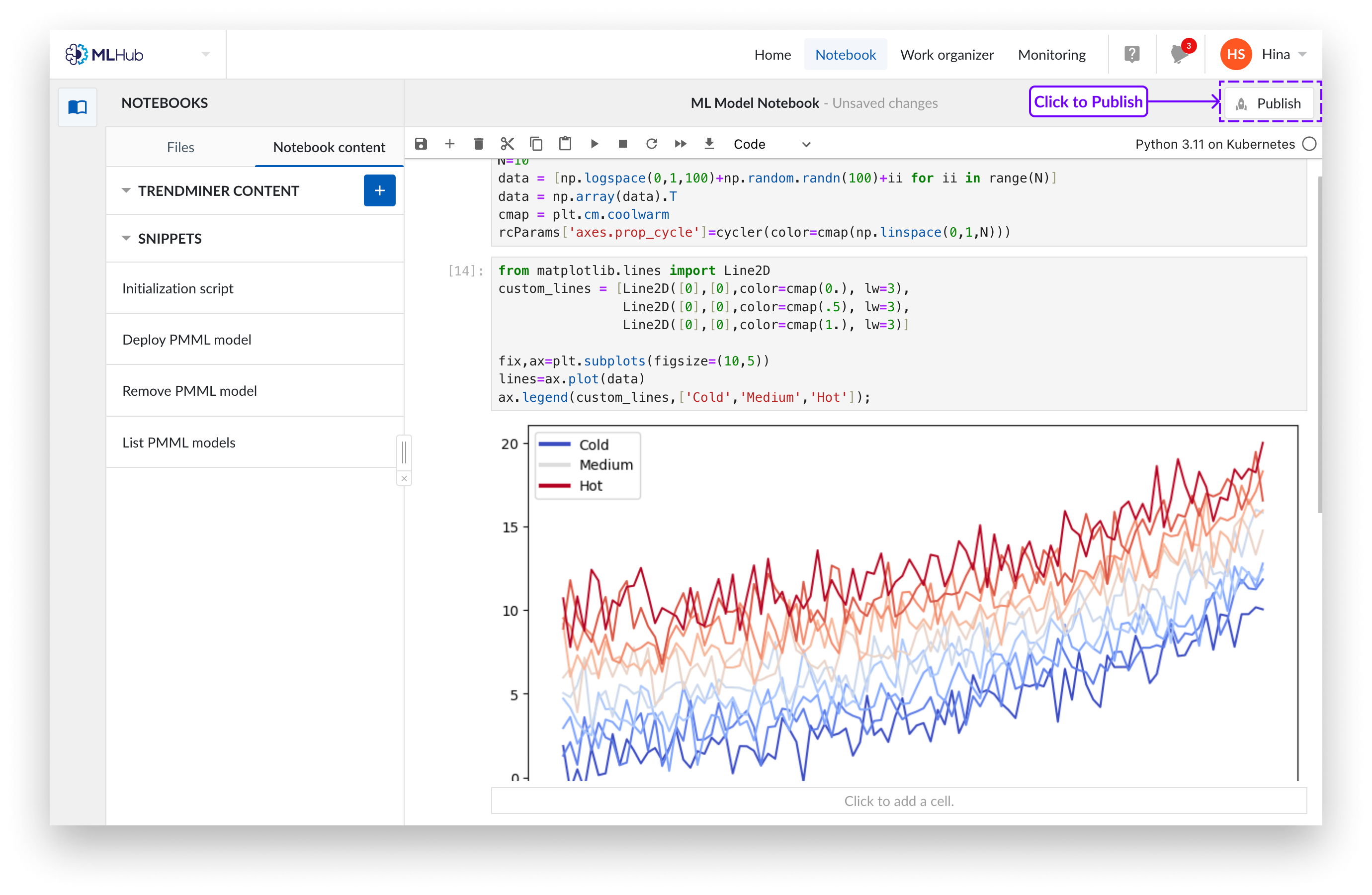

If you have a notebook output cell with an interesting result or visualization you want to share, you can publish it into a notebook pipeline object.
Steps:
  1. Click the ‘Publish’ button in the top right corner.
  2. Select ALL the cells that are relevant for the output you want to publish, including ‘import’ statements and variable declarations. Make sure the last selected cell produces valid output. You can select a cell by clicking anywhere on it, or use the checkboxes in the top right corners.

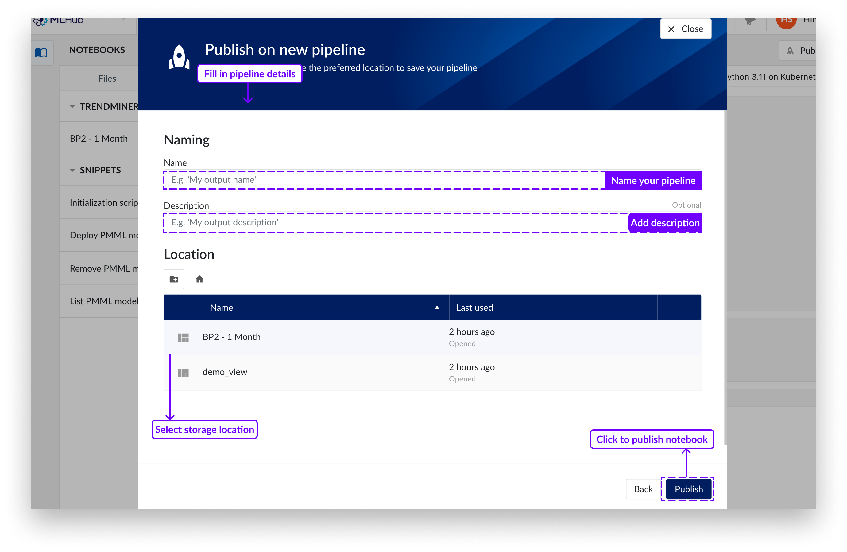

  3. You can publish selected cells of the notebook as a new pipeline or overwrite an existing one.
  4.  Clicking on “Publish on new pipeline” will open a window where you can give the pipeline a name and specify a storage location in the Work Organizer. This will create a ‘pipeline’ object, which is a sort of mini notebook containing only the selected cells. Pipelines have no relation to their origin notebooks, they are a separate entity.If you update the notebook, you will have to create a new pipeline object as well.
  5. If you choose to “Publish on overwrite pipeline” , fill in the optional descriptionand choose a pipeline in the Work Organizer that you wish to overwrite.
  6. Click the ‘Publish’ button in the bottom right. This will create a pipeline object containing the code of the cells you have selected.
