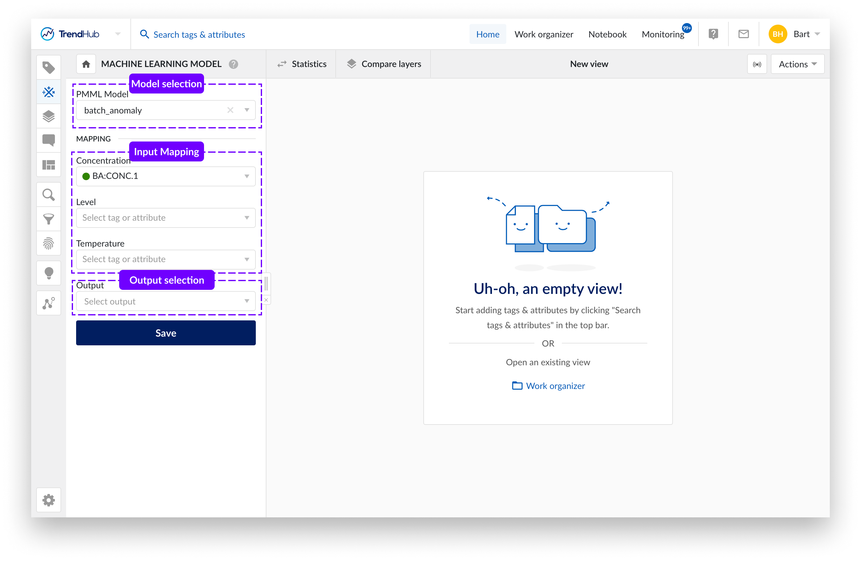

PMML model: In this field you can select any of the models that are deployed on TrendMiner. The models can be deployed from the TrendMiner's Notebook tool, the platform where Python scripts can be converted into PMML models. Read here for more information on the Notebook tool.Machine Learning Hub and Notebooks
Only PMML models with 10 or less input variables will be shown in the dropdown field.
Mapping: Here you can map your tags/attributes to any required input for the model.
Only analogue inputs are supported.
Output:  Models can have multiple outputs. With this field you specify which output should be used to create your new tag.
Only analogue outputs (integer, float, double) are supported.
A maximum of 10 variables can be included for mapping of each MLM tag. Only models with 10 or less input variables will be show
Only analogue inputs and outputs (integer, float, double) are supported.
