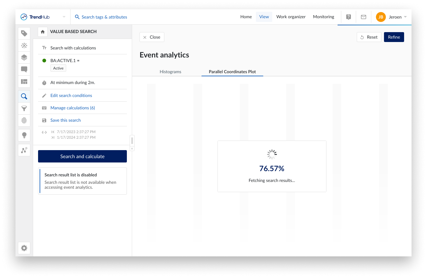

Since all results will be shown as single data points, the initial rendering of the plot can take up a bit of time. A loading screen will be shown while fetching all the data. As soon as this is completed, the graph will be shown. Afterwards you can seamlessly switch between the histogram and parallel coordinates plot tab.
