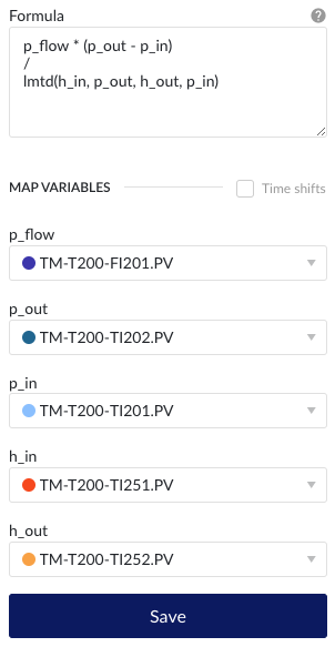

Figura 2. Heat exchange coefficient calculation
[en] Heat exchange coefficient calculation
The heat exchange coefficient, calculated from product and hot water flows and in/outgoing temperatures. For heat exchange, we can use the built-in function for logarithmic mean temperature difference. Note that if would like to have the resulting tag in SI units (W/m2/K), we would need to include a correction factor in the calculation.
