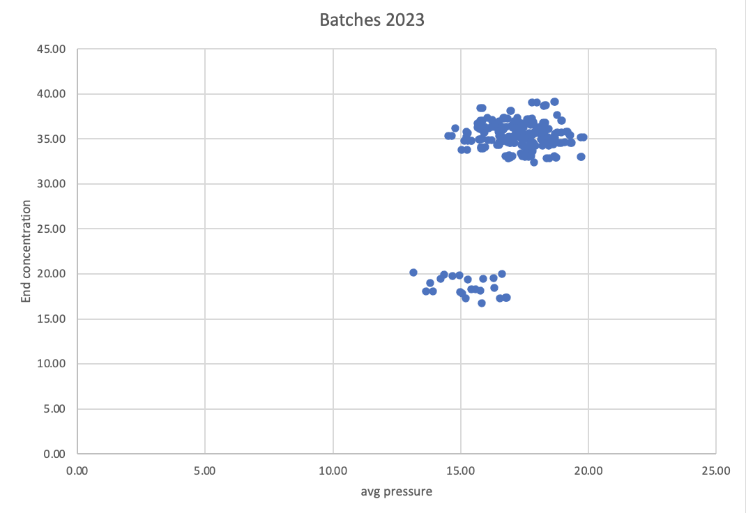

To test our hypothesis that a lower pressure during a batch leads to a lower end concentration of our product, we search for all batches of this year and add the average pressure and the end concentration as search calculations. Exporting to Excel and creating a scatter plot shows most batches fall in a group of high pressure, high correlation, but there is another group with significantly lower pressure and concentration. We could say our hypothesis is confirmed, though we should note that within one group, there seems to be no further correlation between pressure and concentration.
