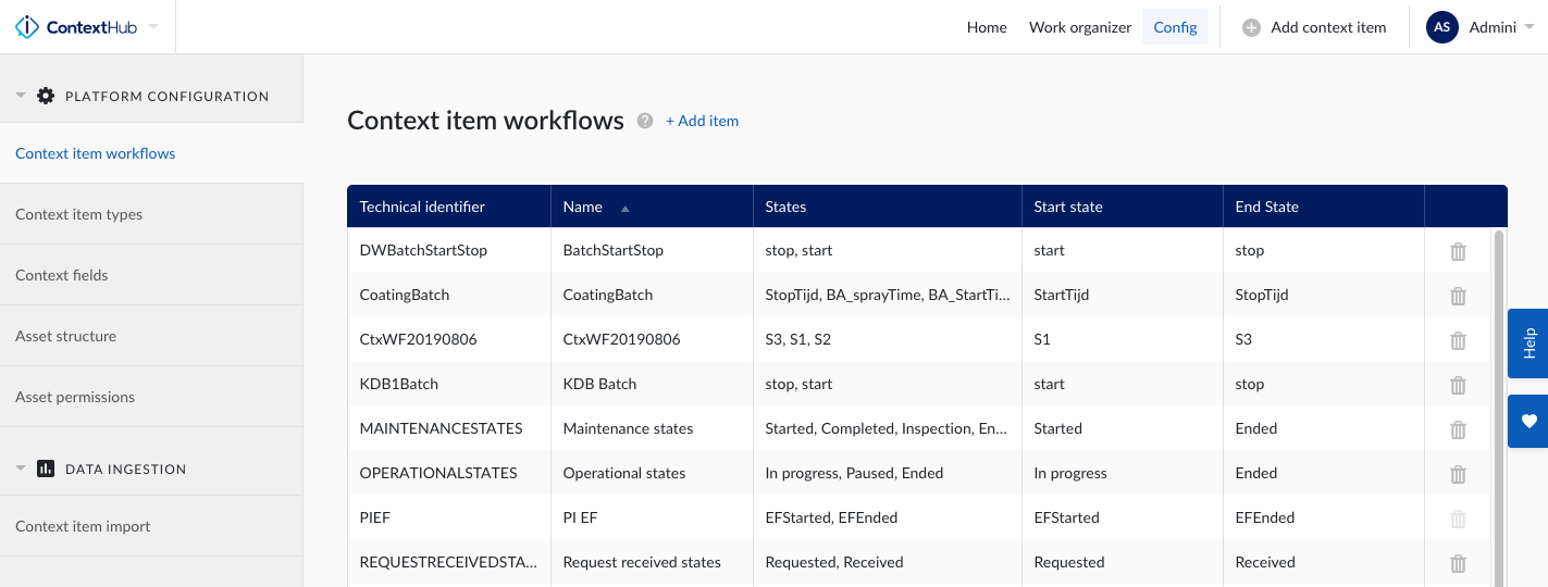

  1. Click on "Config" located in the top bar of ContextHub.
  2. Go to the PLATFORM CONFIGURATION menu.
  3. Select "context item workflow".
Your new workflow will be added to the workflow configuration table.
Search for a specific Context Item Workflow using the search bar located at the top right of the screen.

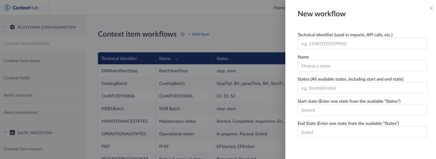

  1. Click on the "+Add item" option highlighted in blue above the configuration table.
  2. A new workflow config side panel opens. Fill in the fields of this panel. In this panel you can enter the states and substates of your workflow. However, the states list must include a start and end state.
  3. Enter the start and end state where requested in the panel.
  4. Once the panel requirements are completed, click on the "Save" button.

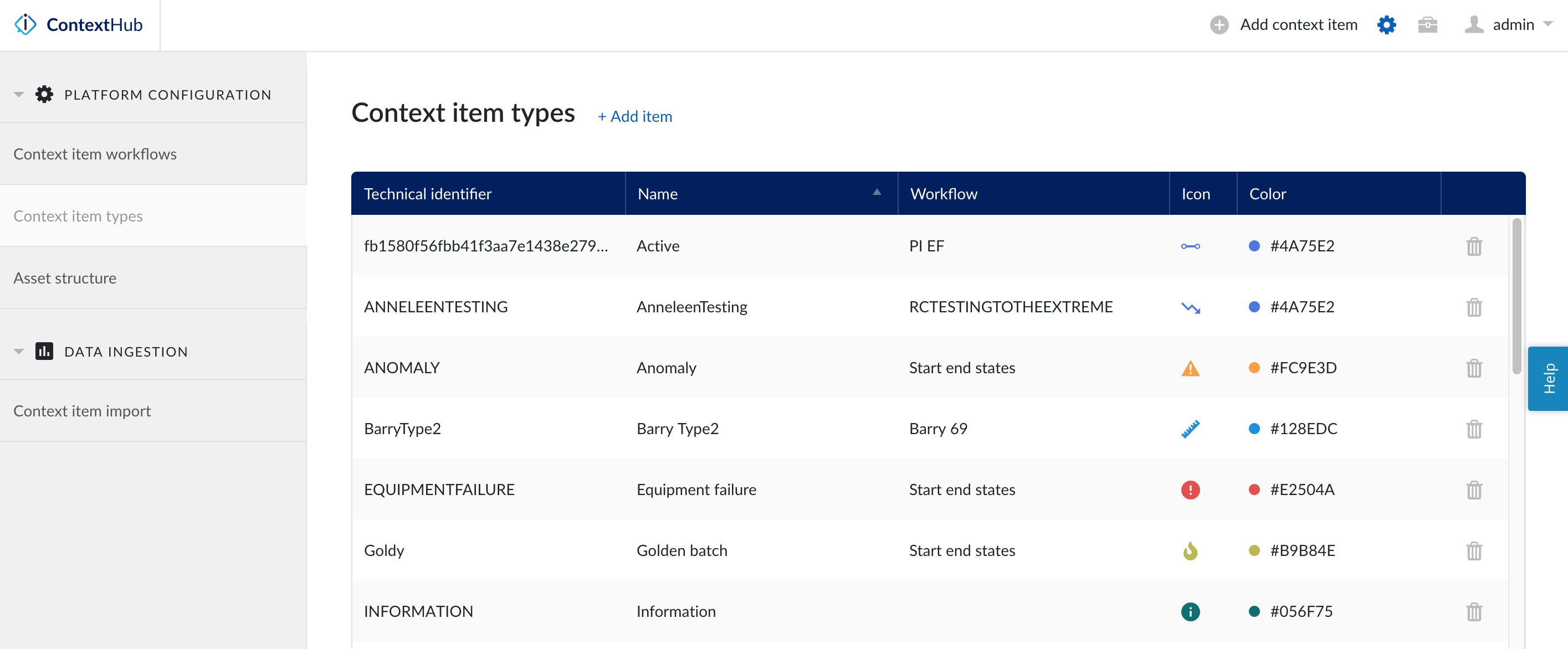

  1. Click on the gear icon present in the top bar of ContextHub
  2. Click on "context item type" in left panel. A table view of all context item types available is shown.
  3. Select the context item of interest. A panel will open from the right of the screen, providing detail of the context item type selected.
  4. Edit context type fields within the panel. These fields include: the identifier, name, states, icon and color.
  1. Click on the gear icon present in the top bar of ContextHub.
  2. Opens the context item types config page.
  3. Click on the "Add new Context Item Type" option to create new context item type. A panel will appear from the right of the screen.
  4. Populate the panel with a name, workflow (A-Z), icon and color.
  5. Click save.
Search for a specific context item type by using the search bar located in the top right of the screen.

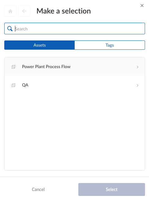

When you select the "Add a component" option, a mini asset browser appears.
  1. Search for or identify a component from the list.
  2. Click on the icon directly to the left of the component name so that a green tick appears.
  3. Click on the "Select" button.
The component is now added to your components list as a bubble. You are free to add more components as you wish.

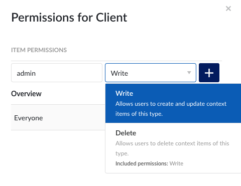

  1. Create a new context type in the normal way.
  2. Identify your type row on the ContextHub grid, and click the three vertical dots situated far right of the row.
  3. Click on "Edit permissions".
  4. Type in the name of user under "ITEM PERMISSIONS".
  5. Select between "Write" or "Delete" options.
  6. Click on the plus button.
