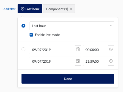

  1. Click on the time filter situated above the grid chart.
  2. Click on the check "Enable live mode".
  3. Click on "Done".
  4. Click on the "Actions" button (top right of the ContextHub UI) and click "Save" in the drop down menu.
Once live mode is engaged, you can see a small icon on the time filter above the grid that signifies the fact you are working in live mode. The bubble also turns green.
