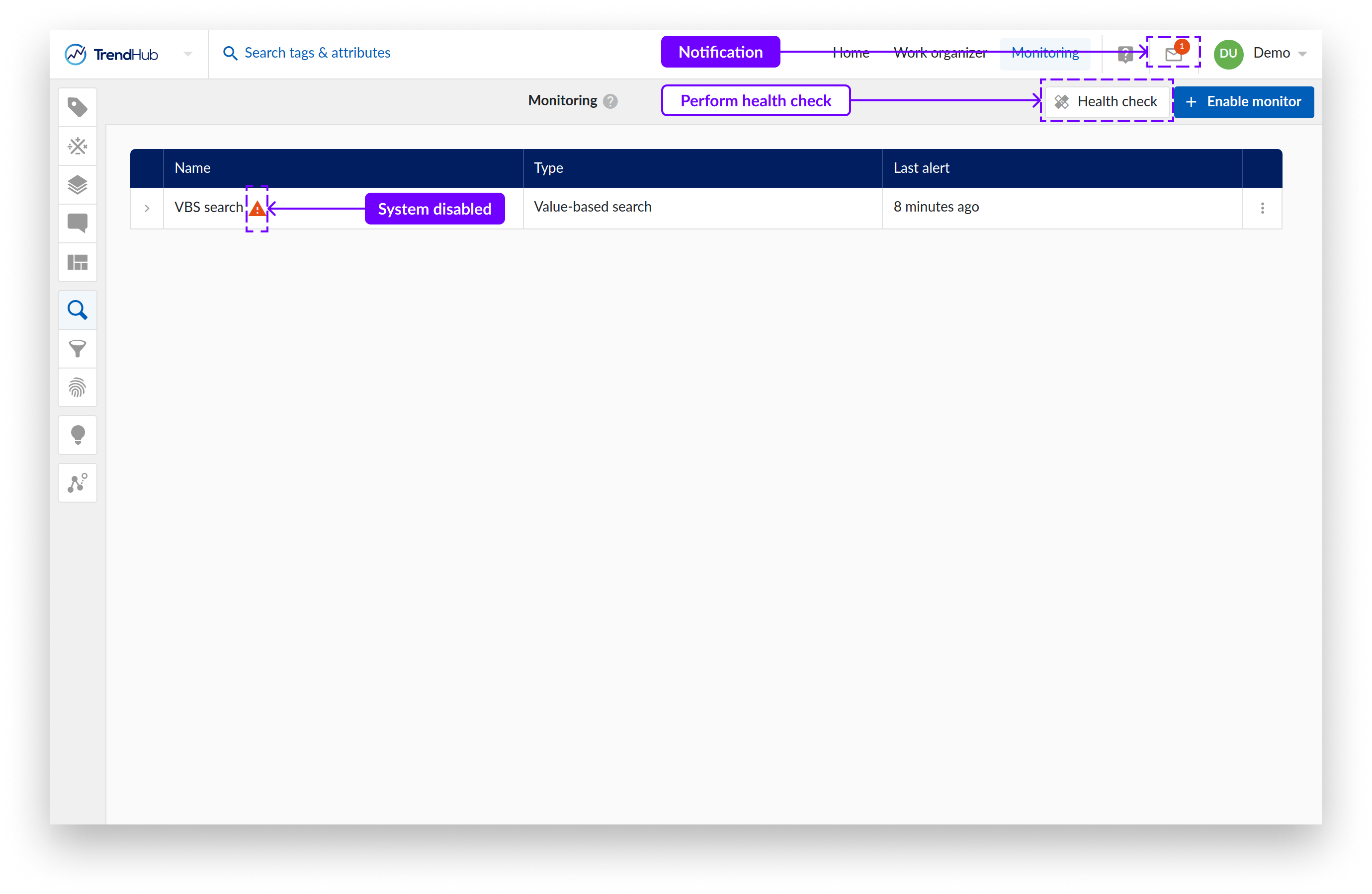

Whenever issues are encountered during the automatic monitoring process the respective monitor will be set to system-disabled, which is indicated in the monitoring overview by a red warning icon.

Whenever tag accessibility issues are restored or the failing monitor is edited to use a valid and existing context type, you can re-enable all system-disabled monitors at once by clicking the health check button in the header of the monitoring and alert overview page. When the health check is finished, a notification is sent out indicating the number of monitors that could not be enabled.
