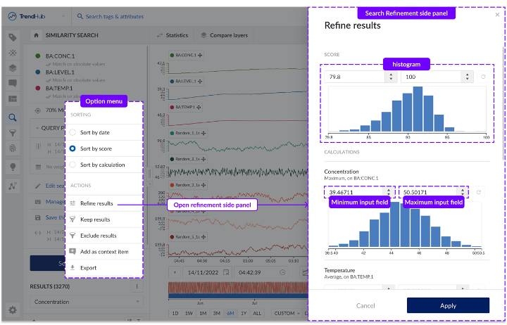

  1. Click the search results option button.
  2. Choose the "Refine results" option. This will open a new side-panel on the right.

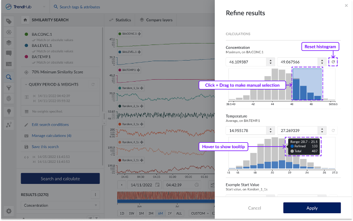

  3. Apply your refinement settings by:
    1. entering the minimum and/or maximum value in the input fields, or,
    2. manual selection on each histogram.
    After you have set refinements, all histograms will be updated to show the data adjusted by new settings in blue. The total results will still be displayed in grey. The number of results by bin (both refined and total) can be seen by hovering over the corresponding bin of the histogram.
  4. To reset any refinement setting you can:
    1. click the refresh button to apply the starting situation,
    2. enter any value in the minimum/maximum field outside the current range. The value will automatically be reset to the correct minimum/maximum value.

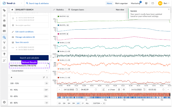

  5. Click "Apply" to update the search result list with your refined settings. The results title and a green badge will be shown on the options-button to indicate that refinements are applied to the results of your search conditions.
