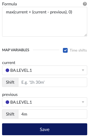

A linear extrapolation tag is a very simple estimate of what the future value of a tag will be by taking the current value of the tag and adding the increase over the last x time. For example, if a tag currently has a value of 10, and the value 5 minutes ago was 8, then we would extrapolate that the value in 5 minutes will be 10 + (10-8) = 12. An obvious requirement is that the tag behaves somewhat linearly within the scope of our use case. Below are some examples where we could use such a tag.
  • Predict that a tank will be empty in the next hour
  • Predict whether performance will drop below a threshold the coming week
Abbildung 3. Linear extrapolation example
[en] Linear extrapolation example
We estimate what the level will be 4 minutes. Since we know the level cannot be negative, we use the max function to have 0 as the lower limit.
Linear extrapolation will always be a simplification of your process. If you think a more custom formula can predict future values better, don't hesitate to try that.
