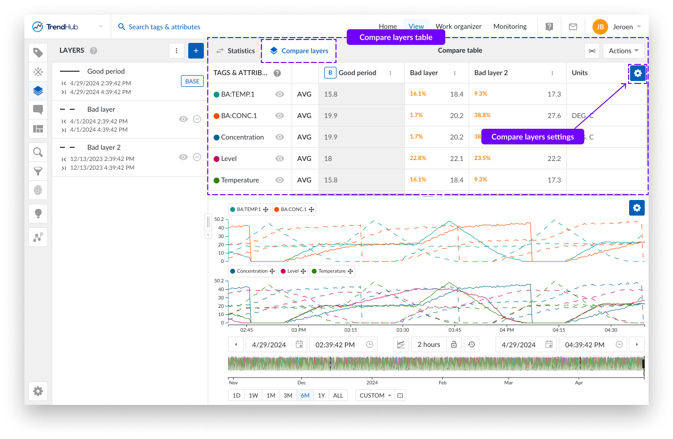

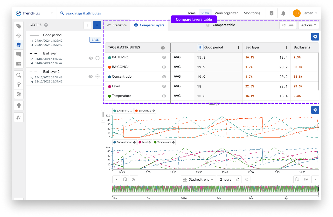

The Compare layer table option can be found on the left side of the view bar next to the Statistics table.

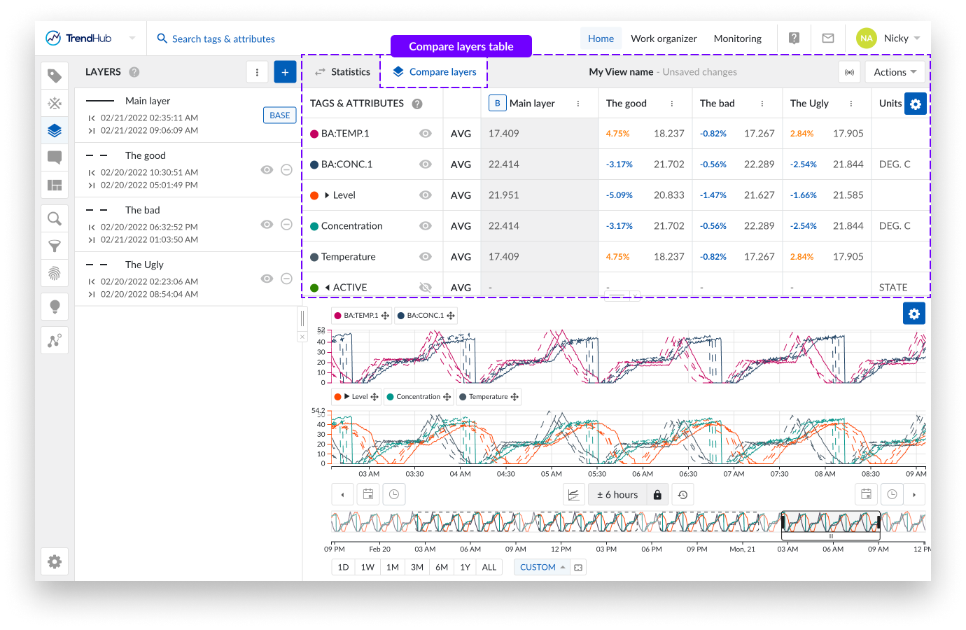

Once a tag or attribute is added and is active it can be visualized in the compare table. The table shows, by default, the average value of all active tags. The compare table can be opened when there is only one layer, but the main value of this table is to easily compare different layers.
When additional sublayers are present, statistical values are calculated for all layers. The sublayers are compared to the base layer, and the comparison is done by providing a relative difference for all sublayers compared to the base layer, i.e.:
difference = (Value_sublayer – Value_baselayer) / |Value_baselayer|
Negative differences are indicated in blue, while positive differences are indicated in orange.
You will also notice that the compare layer table is automatically updating the selected parameter when a change to the focus chart is detected.
The values in the table are automatically updated when making any time related change on the focus chart.

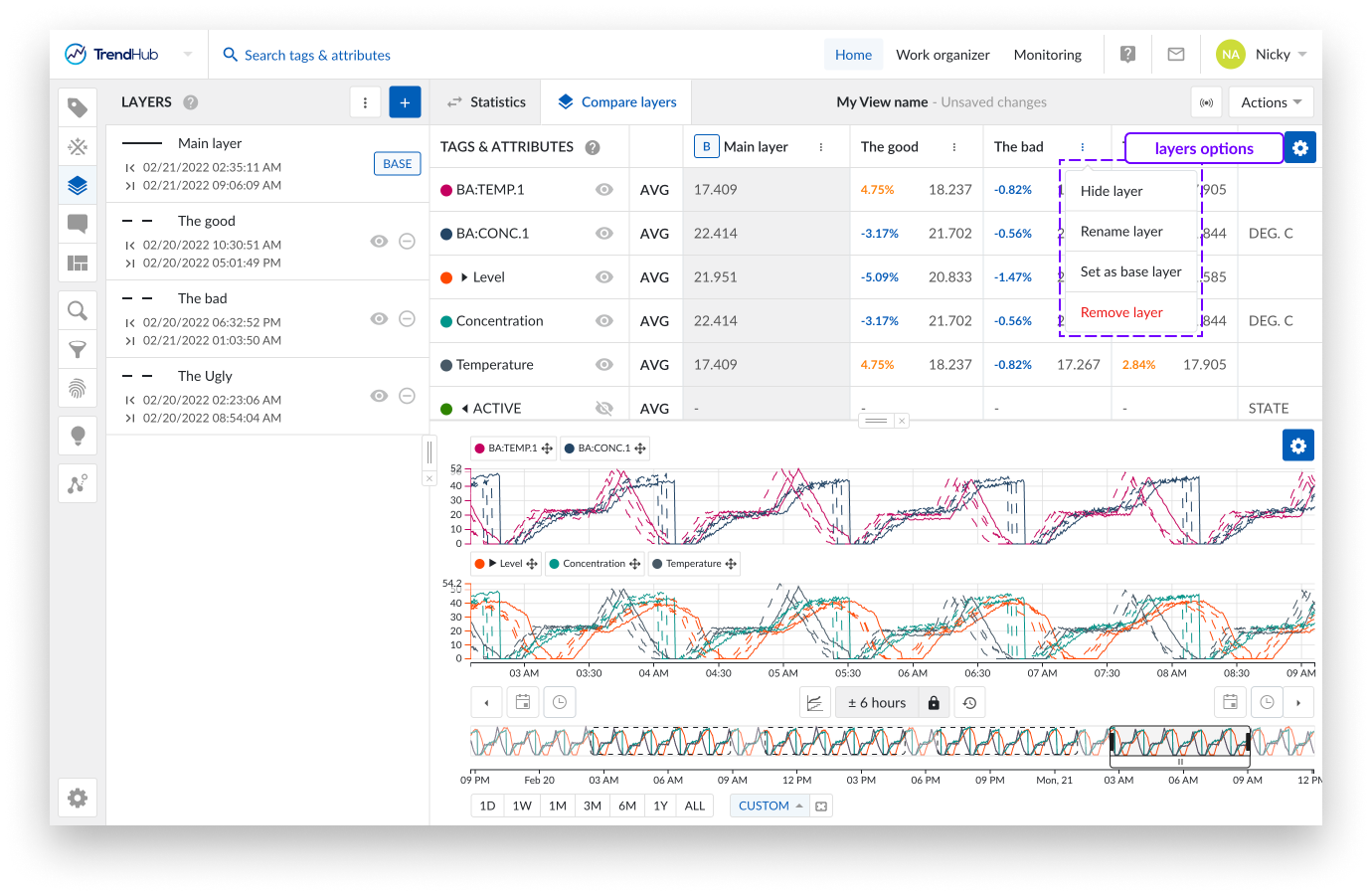

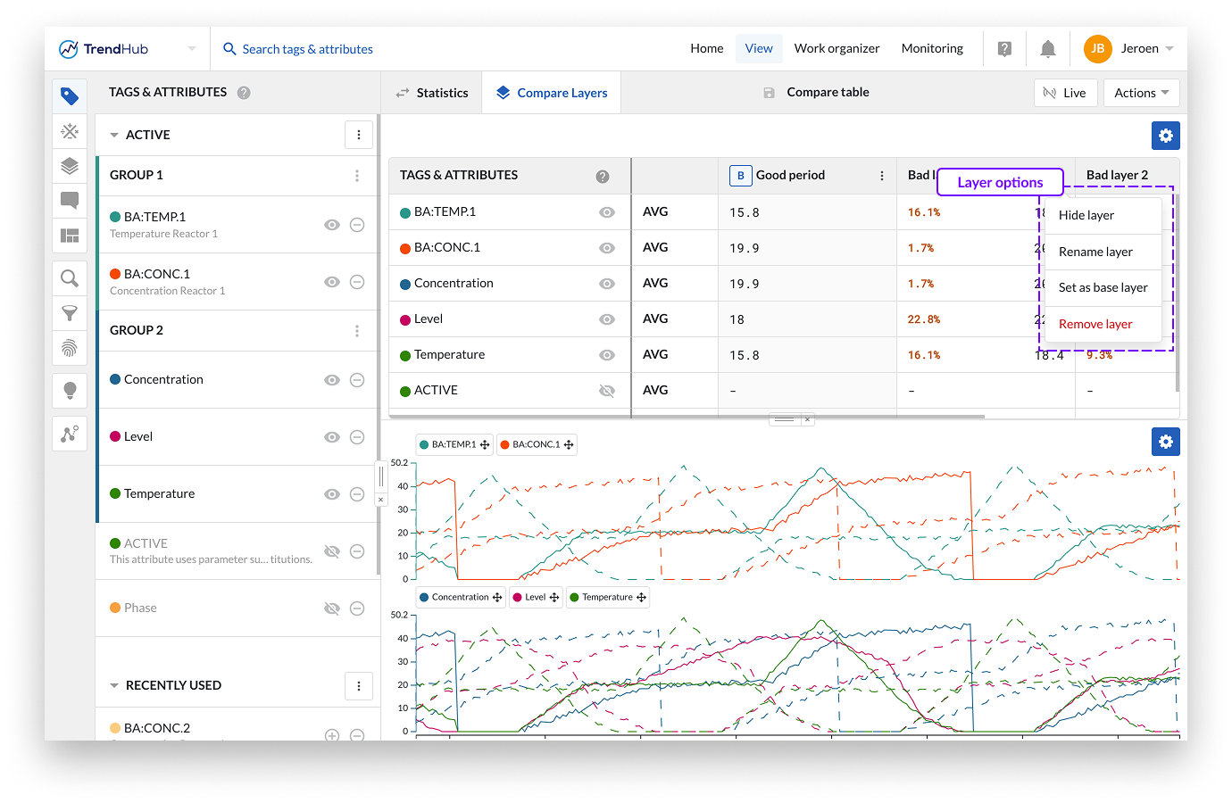

Multiple options which are accessible in the layer menu can be performed directly in the compare table as well.  The following actions are available:
  • Hide / Unhide layer

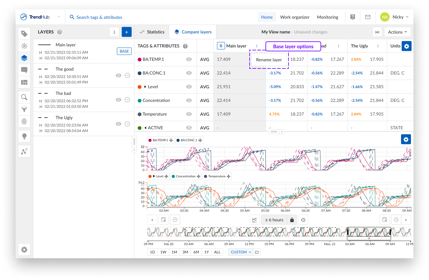

  • Rename layer (option only for the base layer)
  • Set as base layer
  • Remove layer

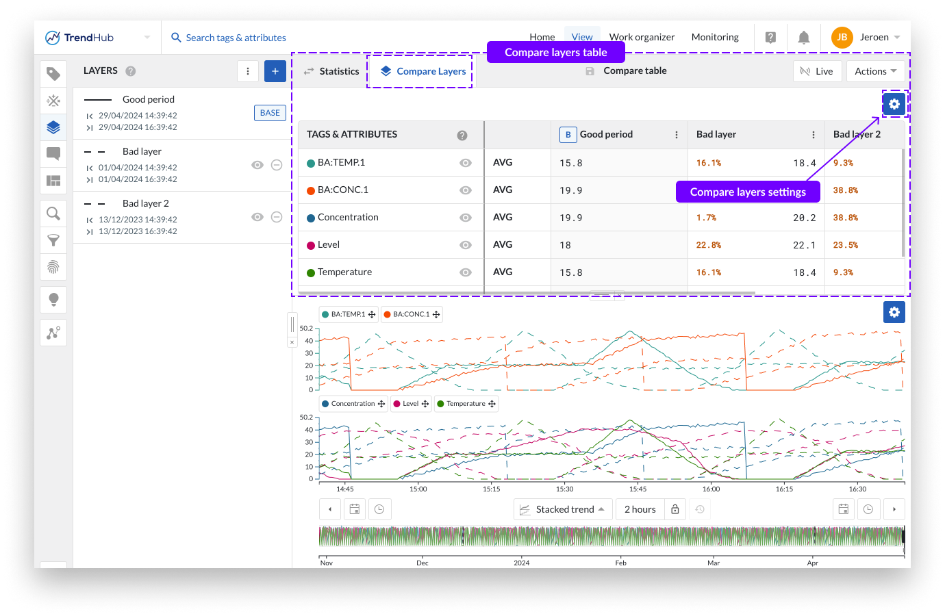

The compare layer table has a couple of settings that can be updated. To open the compare layer table settings panel, click on the blue settings button on the top right of the table.

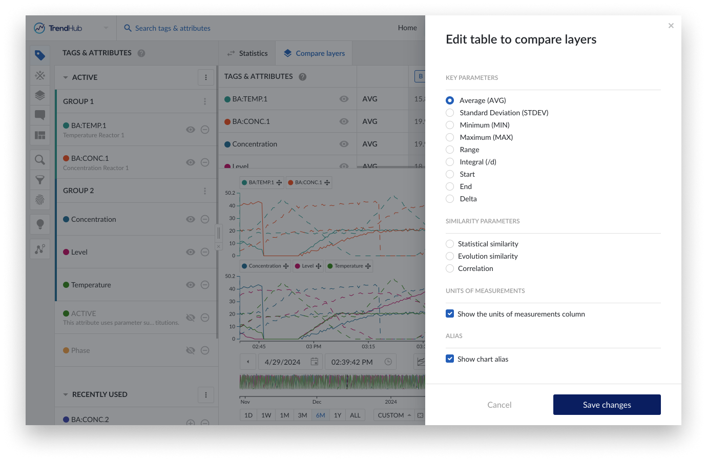

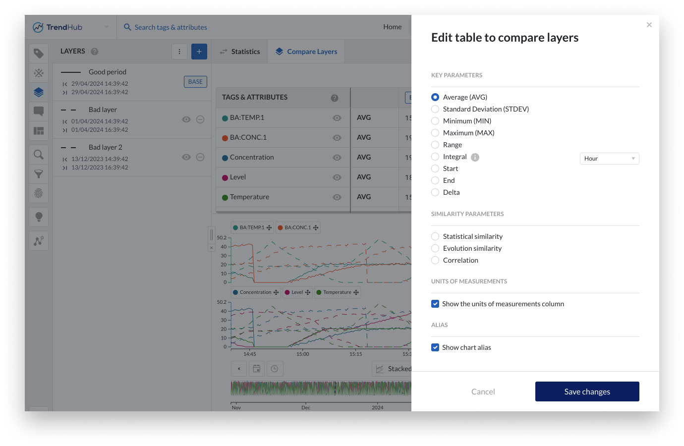

On the "Edit table to compare layers" panel, you can select the statistical parameters which are of interest to you. In addition, you can choose to always show the units of measurement and the chart alias instead of the tag name.
By default, the "Average (AVG)" statistic is enabled for the compare layer table. This statistic can be switched to any of the other key parameters, including similarity parameters.
Most statistical parameters for comparing layers are available in the statistics table. More information about key statistics can be found on the statistics table article.
These parameters are specifically used to compare active layer values with each other. Below you can see some more details about these extra parameters.
  • Statistical similarity: The statistical similarity is a calculation which compares the distribution of the data between layers. The value is returned as a percentage. The higher the value, the more likely both layers have the same distribution.
    This similarity score is based on the Kolmogorov-Smirnov test statistic.
  • Evolution similarity: This parameter measures the evolutional similarity between the layers in function of the base layer, which results in a percentage value. The higher the value, the more similar the evolution throughout the layer.
  • Correlation: This parameter is a measure of linear correlation between the layer in question and the base layer. The parameter corresponds with the Pearson correlation coefficient.
