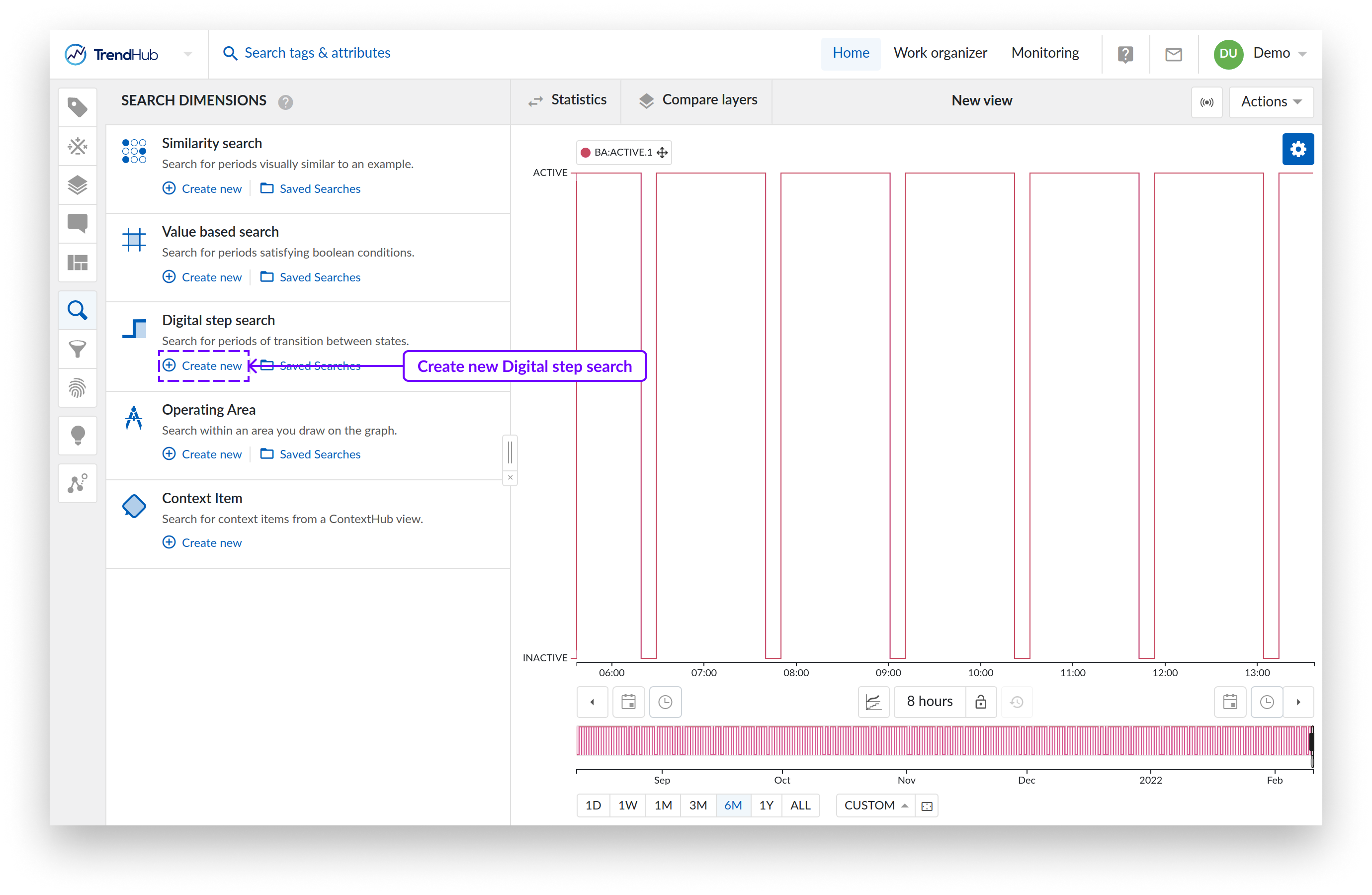

  2. From the search menu, click "Create new" under the Digital step search option.

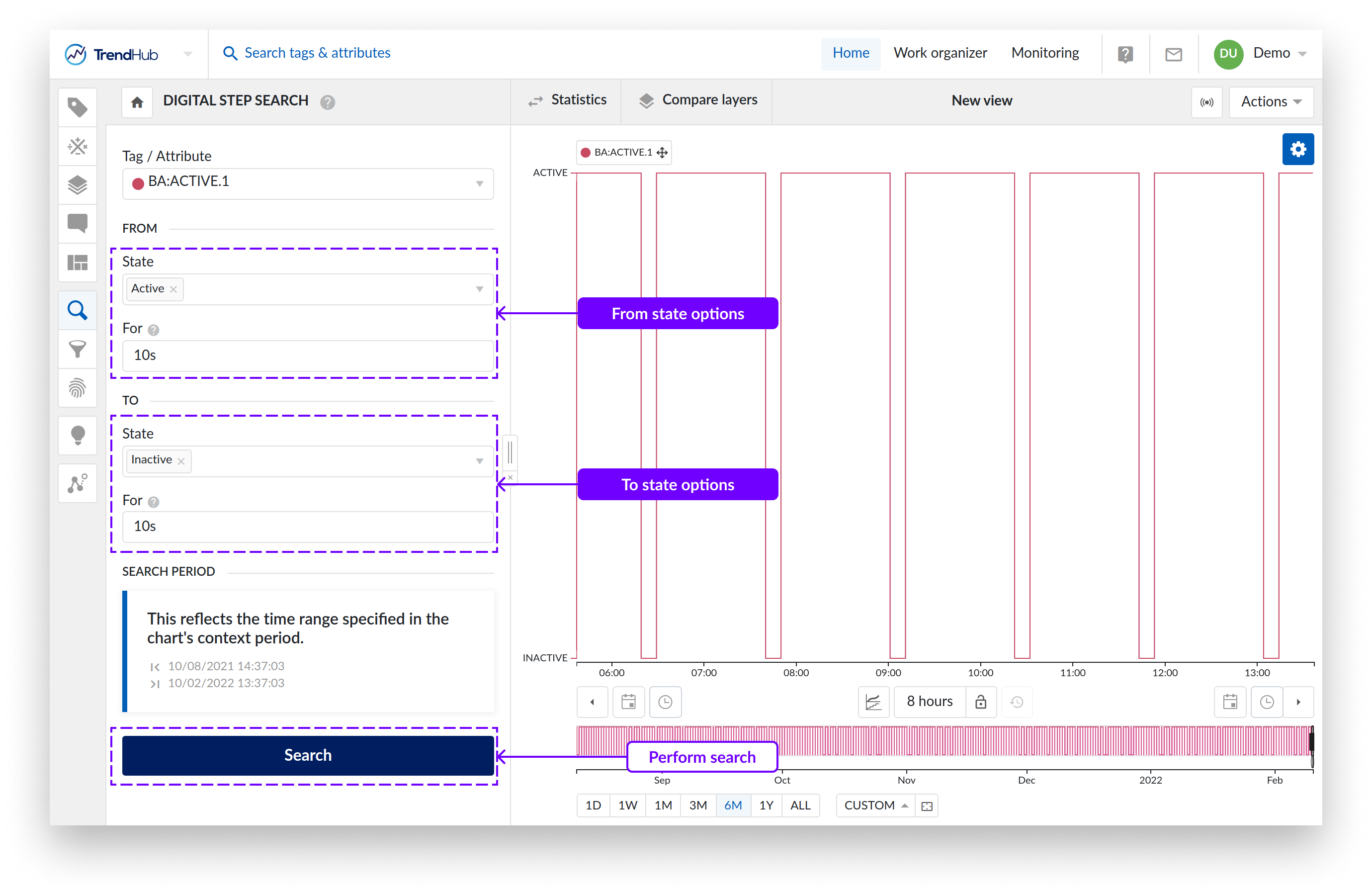

  3. Select the digital tag of interest, and a 'FROM' and 'TO' state from the dropdown menus. The state selected in each field must be different.
  4. Set the desired time durations.
  5. Press the "Search" button to start the search.
  6. Wait for the result list to appear. By default, the results are sorted and grouped by date (see working with the search result list), to change the order of the results).

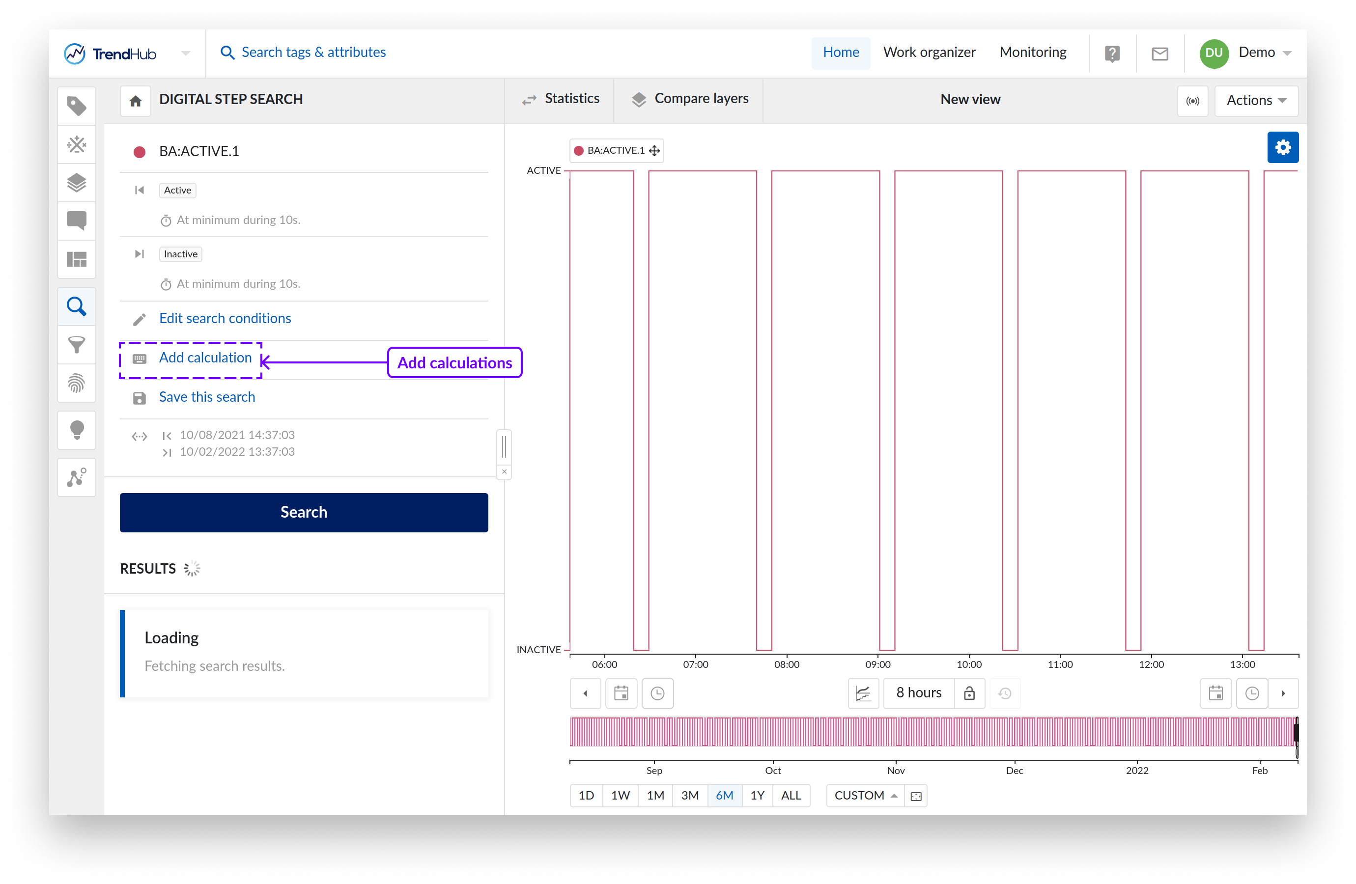

It is possible to add one or multiple calculations to the search results and the search definition, by clicking on the "Add calculation" link. Please refer to the Calculations on search results article for more information about calculations.

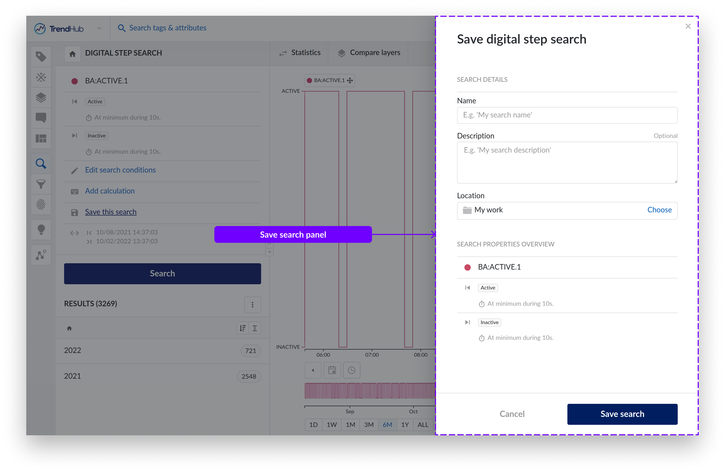

After creating or editing a search, save it by following the next steps:

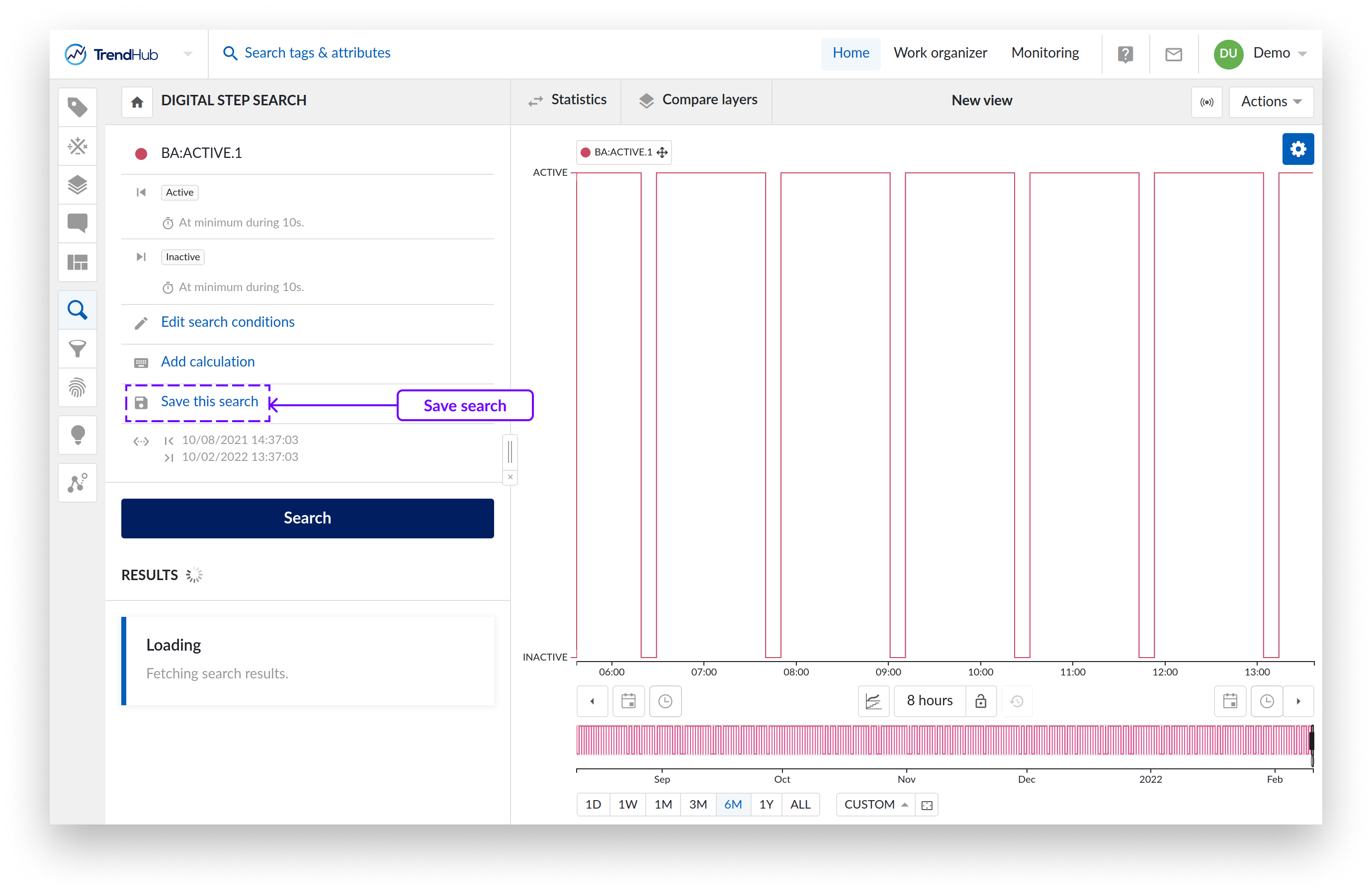

  1. Click on the link "Save this search" on the search summary.
    This action will open a panel, where you can specify:
    • The search name
    • A description
    • The location in the Work OrganizerWork Organizer
  2. Click on the button "Save search" on the panel.
