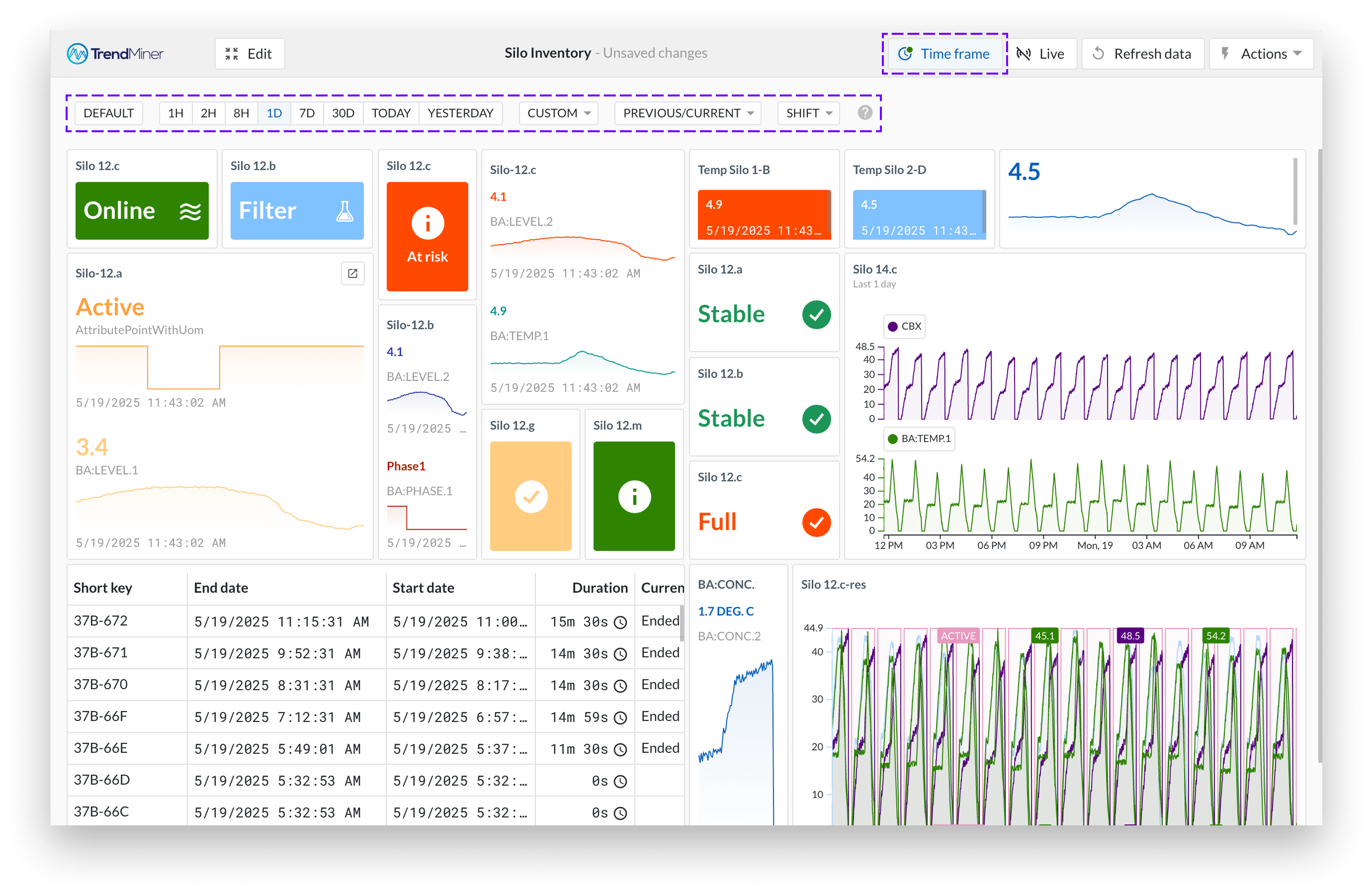

The global time frame feature allows you to set a single time context for all tiles on a dashboard. When a time frame is selected, it is applied uniformly across every tile, keeping the entire dashboard synchronized. You can access the global time frame settings by clicking the time frame button.
Once selected, the chosen time frame takes effect immediately and updates the view for all dashboard tiles.
Quick Selections
A set of predefined time ranges is available for fast selection: 1H, 2H, 8H, 1D, 30D, TODAY, and YESTERDAY
Custom Time Frames
For more specific needs, open the CUSTOM tab. Here you can define a personalized time range by choosing from:
Fixed range, where both start and end times are defined.
Fixed start time, where the start is fixed and the end updates dynamically.
Custom period, a fully flexible time window.
Predefined Previous or Current Periods
The PREVIOUS/CURRENT tab provides calendar-based options, letting you select from: Workweek, Week, Month, or Year, either as the current or the previous period.

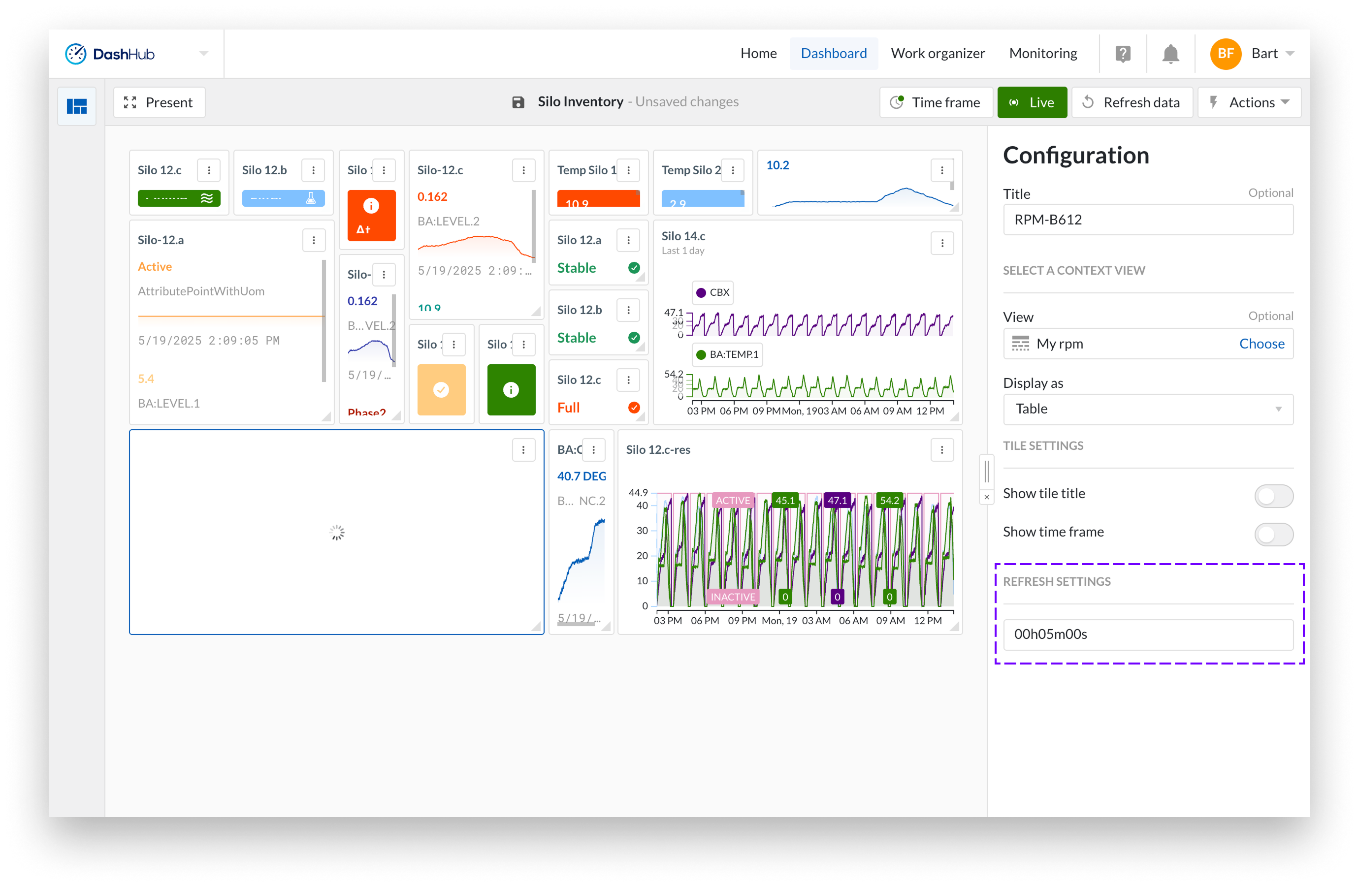

Refresh settings
The refresh rate for each tile can be configured individually under the refresh settings. By default, the context view tile and the TrendHub view tile refresh every 5 minutes, while the monitor tile and the current value tile refresh every 1 minute.

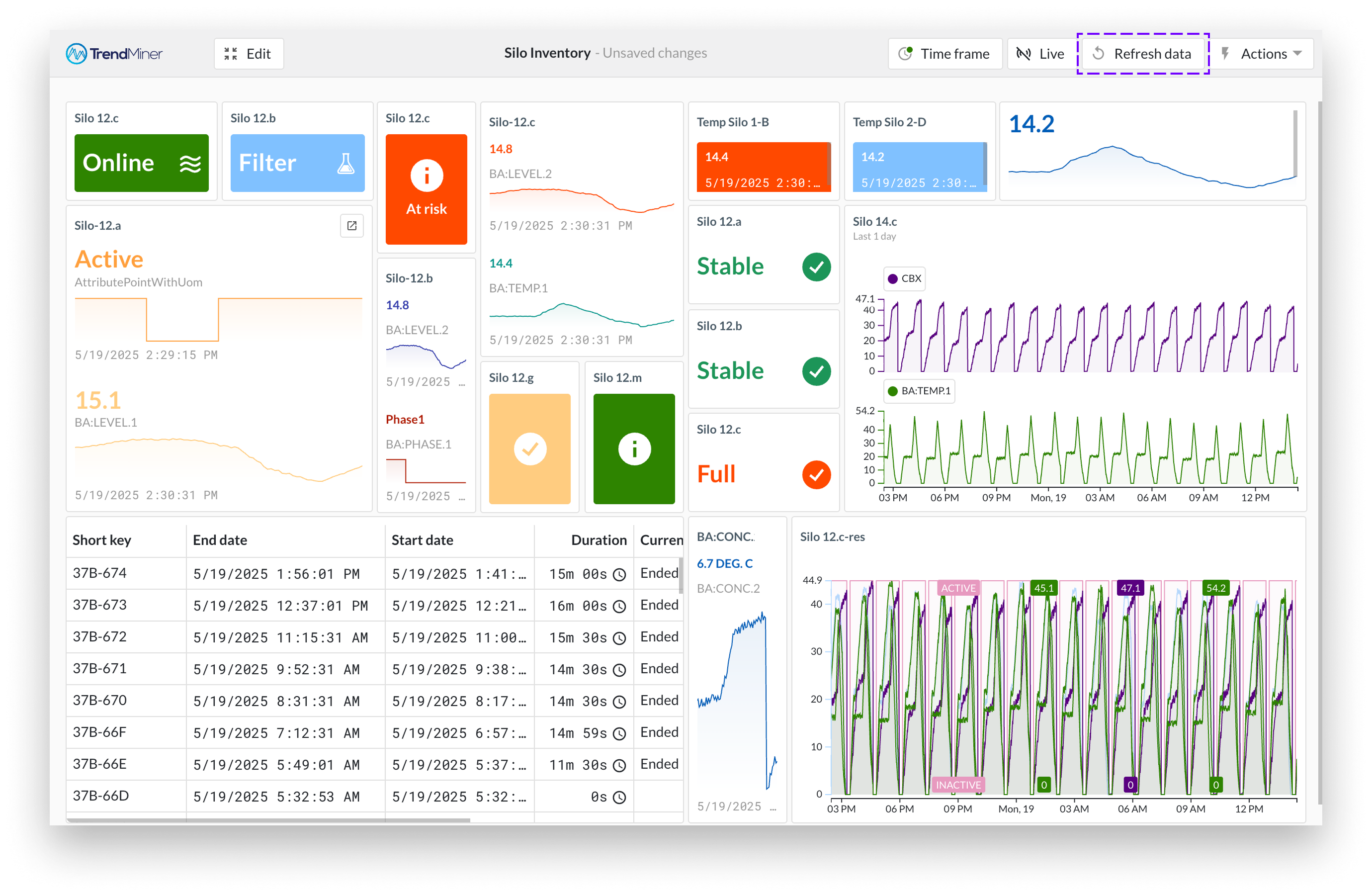

The Refresh data button lets you manually update the data shown on all tiles in your dashboard at once. It refreshes the tile content but does not affect any settings. This button is available in the top bar.

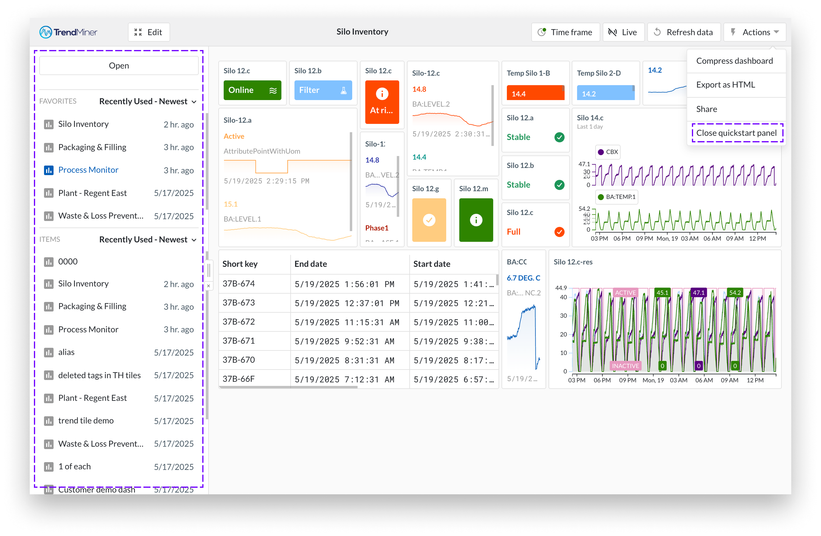

The Open quickstart panel option is available in the actions menu and allows you to keep the quickstart panel open for easy navigation through your dashboards. This is especially useful for operators who want a quick overview of the plant status without being locked into edit mode.
The setting is saved with your user preferences, so you don’t need to re-enable it each time you switch modes or log back in.

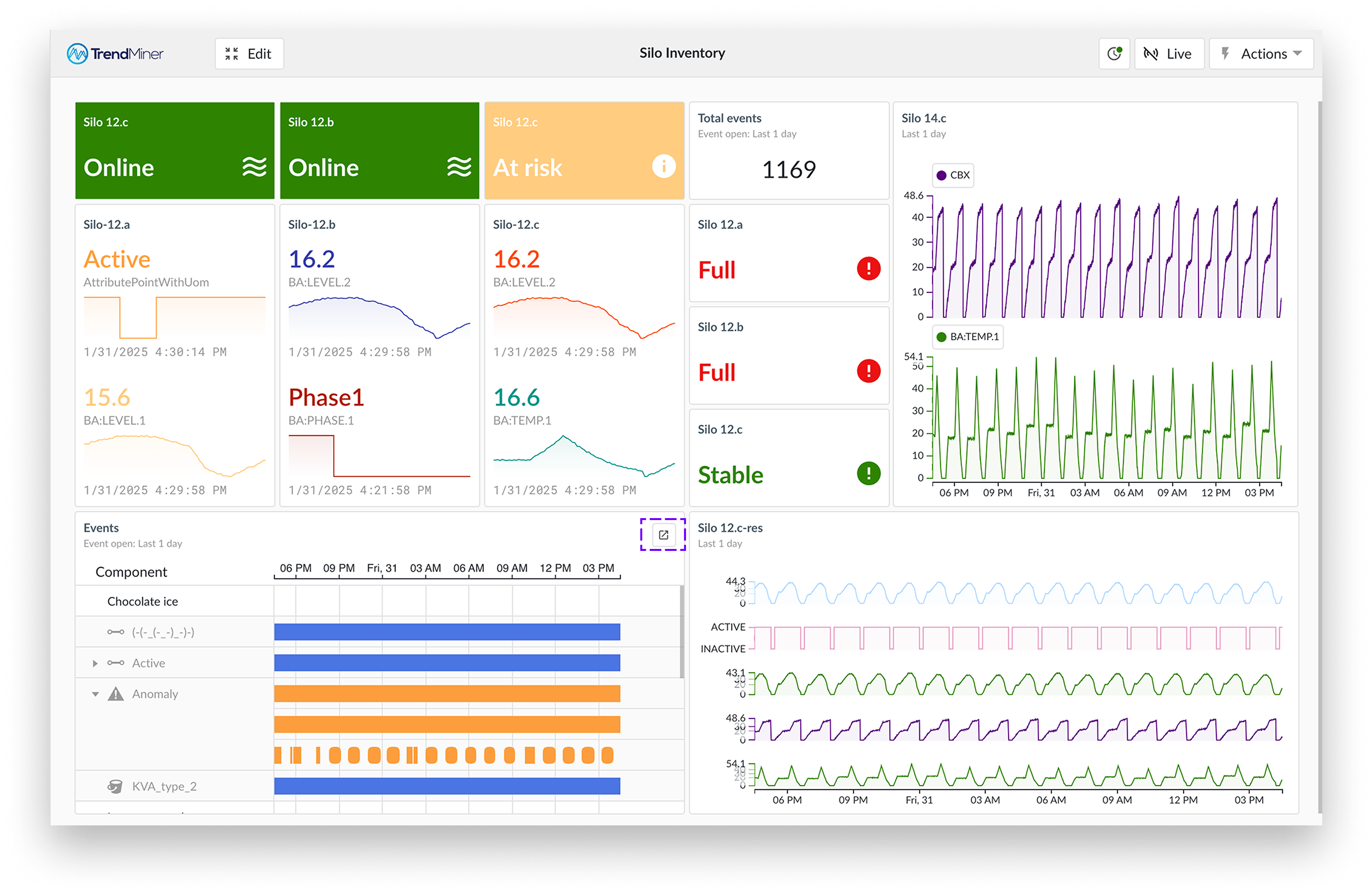

The Dashboard Export feature allows you to generate an HTML report containing only the context items shown in Context view tiles on your dashboard. This is particularly useful for creating summaries, such as shift handover reports, based on the contextual information displayed.
You can find the Export as HTML option in the Actions menu located at the top of your dashboard. The report includes details of the context items shown in Context view tiles.
The Dashboard export will only export the context item information. Other information on your dashboard, like trends, monitors, text tiles, will not be included.

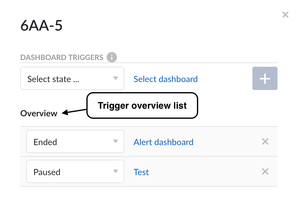

The dashboard trigger can be created in ContextHub. It requires a workflow to be setup so that you can create the "states" necessary to trigger the delivery of a dashboard report based on your tile status. These triggers fire automatically when your chosen state has been met. Your trigger requirement could be a shift change, the end of a process run, or a paused process.
Create a context type as normal.
Identify the context item type in context item type grid, click the three dots at the far right of the row.
In the drop down, select "Edit dashboard triggers".
A panel will appear from the right, select a state on which the trigger should activate.
Click on "Select dashboard" and identify dashboard of interest.
Click on the + sign to add your new trigger to the overview list. This list provides an overview of your preset triggers.
Your trigger is now set to create a report automatically, at your preselected time(s).
